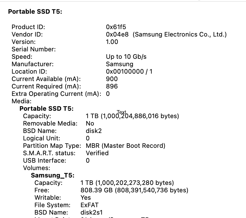

But @Fomalhaut is claiming his T5 runs at 10Gb/s, whereas mine doesn't. Are you suggesting that Samsung changed the bridge chip in their T5s at some point?
I don't think so. Usually they don't change those. But it's probably the firmware. Which is usually upgradeable. . my Strix Arion with ASM2362 has been upgraded last year.
So we'd need to know what f/w @Fomalhaut has on his T5. I'm running the latest from Samsung, but my T5 has only run at 5gb/s on my Macs since I've had it, across several f/w versions.
Fwiw I don't think it's a f/w issue; I think that Apple have a quirks plist (or equivalent) in place that for some reason downgrades certain USB chipsets to 5gb/s operation, and that they just don't publicise or acknowledge the fact.
It would be good if Fomalhaut gets back with more details of his setup and confirmation of his 10Gb/s.

Yes, this is correct. I'm predicting that when other T5 Mac users actually look at the connection speed in System Report their T5s will all be running at 5Gb/s. If not, my Quirks theory is wrong and the issue is more subtle than we think...!

Any chance you could test and confirm 100%? As none of this is documented/acknowledged by Apple, we're somewhat groping around in the dark trying to nail the issue, so hardware / os details and confirmation via testing are especially useful.
Here it is on my MBP16. I'm travelling at the moment so can't test on the M1 Mini, but I'm pretty sure it connects at 10Gbs. I may have posted images on an earlier post in this thread; let me check!
[Edit: It's entirely possible that I'm wrong about the T5 connecting at 10Gbps directly on the M1 Mini, because I often use it via a TB3 hub..which does connect at 10Gbps. The Samsung T7 definitely connects directly at 10Gbps.

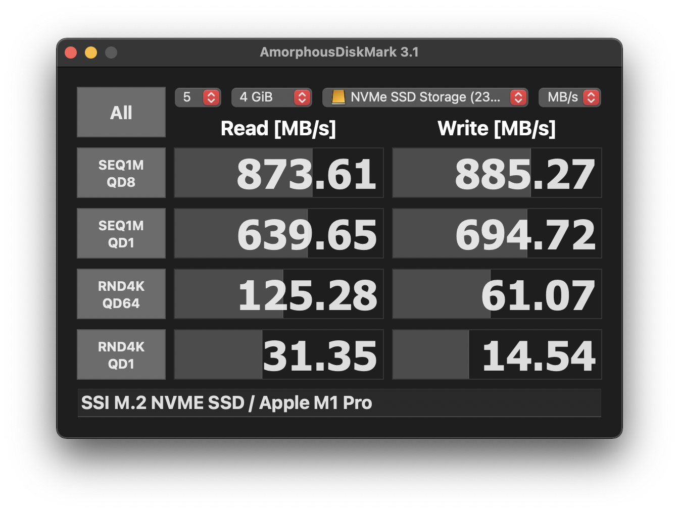

Here's my speed using Asus ROG Strix Arion NVMe Enclosure (ASM2362 chip inside) with an Addlink S70 1TB SSD (Phison E12S Controller) tested on the MacBook Pro 16" 2021 with M1 Pro.
Pretty good speed IMO. Also if you're wondering why it says the device is SSI M.2 NVME SSD, It's because the latest ASM2362 firmware has the naming things broken. So on the firmware flasher program even if i set it to match the Asus ROG one like before it won't change the name.. The firmware is good and stable though so i think it's fine.
Also another note, that Asus DOESN'T provide regular firmware updates for this enclosure !! But, since it's using the same ASM2362 controller like others. It works just fine on the Strix Arion.

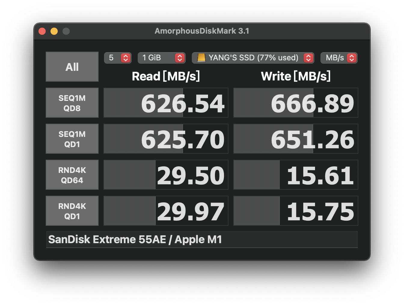

I'm using a M1-chip MBP and to test it with Sandisk E61 directly attached (see pic 1), the actual speed falls into between 630-650MB/s both on read and written.
Sandisk E61 supports USB 3.2 gen2. So I guess the issue hasn't been fixed yet on M1 machines to date?

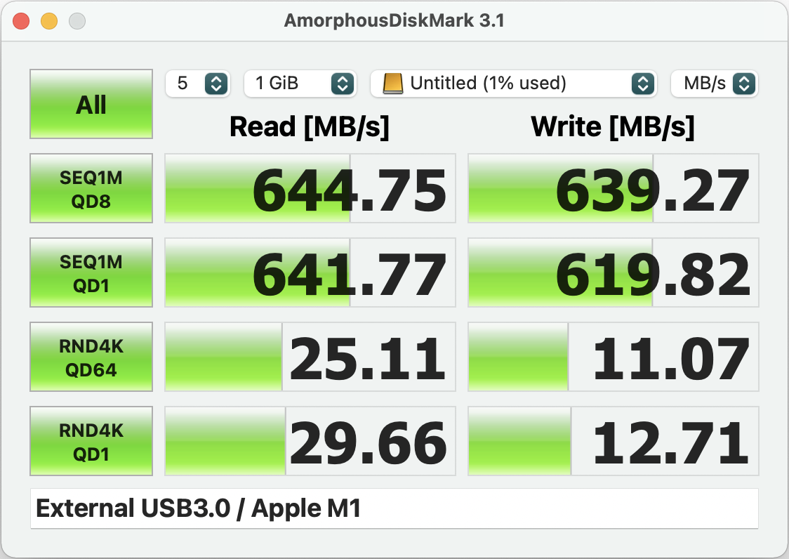

Completely in the dark here and reading many threads has just frazzled my brain and not sure what I am looking at, new thread or drop this Q in here?
M1 iMac.
I have now, a Crucial P2 2tb in a Orico USB3.1 Gen 2 case (TCM2-C3). (plan was to pick up a TB one when I see a deal).
If I use the Apple supplied C-C cable it is way worse. This is the cable as per Orico box. System report says 10gbs connection (up to).
What have I done wrong is the first question. This I the same on any port on the rear.
Edit. By the power of grey skull!
Re formated, encryption off this time.
External USB3.0 : Apple M1.png

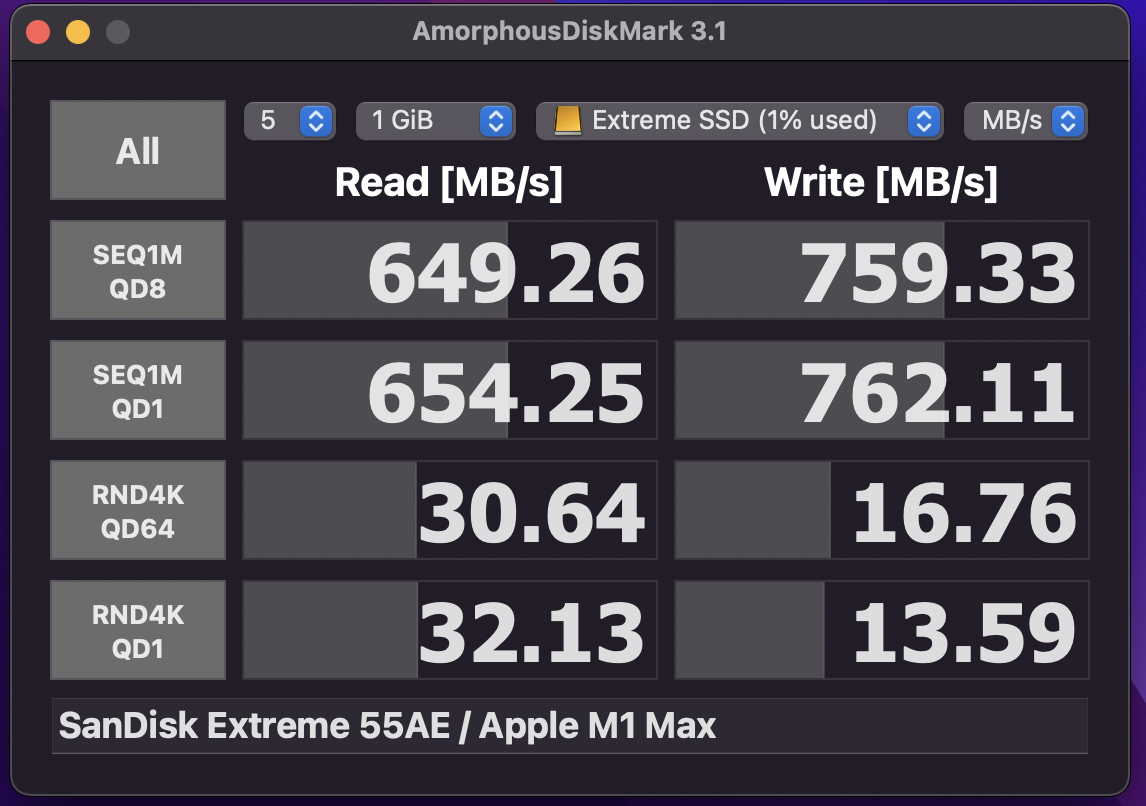

Seems this issue hasn't been discussed in all those Youtube Videos covering the M1 Pro / Max..

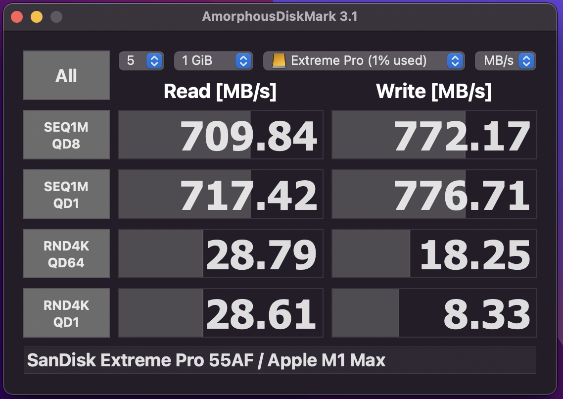

I've got the SanDisk portable SSD, 2TB with 1050MB/s and the 2000MB/s version each. The 2000MB/s version isn't much faster on the M1 Max...
1050MB/s Version:
2000MB/s Version:
Will post some Intel comparison later.
1050MB/s Version:
2000MB/s Version:
The 2000MBps version is a USB 3.2 Gen 2x2 which has already been reported no supported by apple. Hence the reason why the 1050MBps is almost the same as the 2000MBps version.
Reactions: Fomalhaut
Thanks for the heads-up on that. Didn't know that, thought USB4 includes this.. in my use case the speed is no problem.
