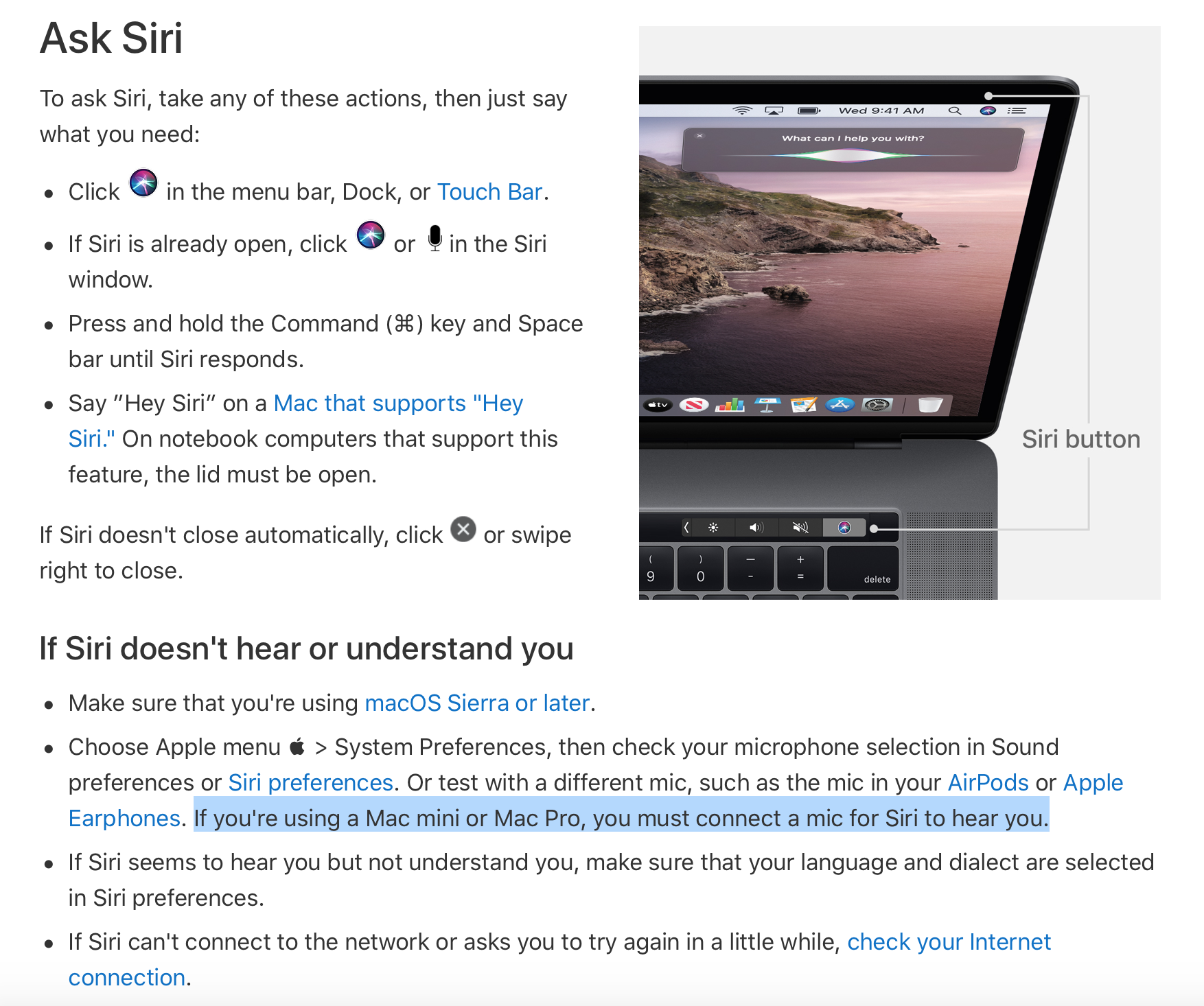

Mac Pro has been added to this Siri page with November 04, 2019 publish date:
Link goes to page that does not (yet) exist:
[automerge]1573076946[/automerge]
That one has been up for a few weeks.
The previous version of the page also mentioned the Mac Pro, you can see that here:
Both the 2013 and the cMP would need an attached mic as well.
