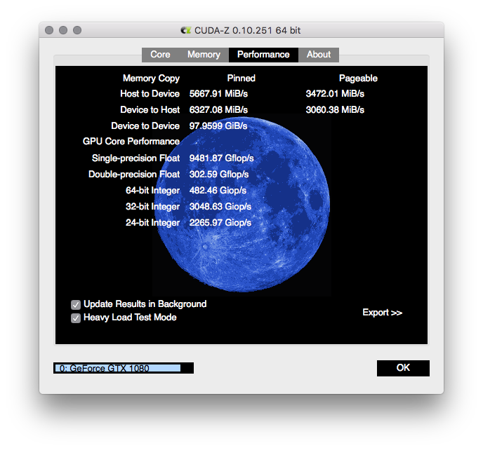

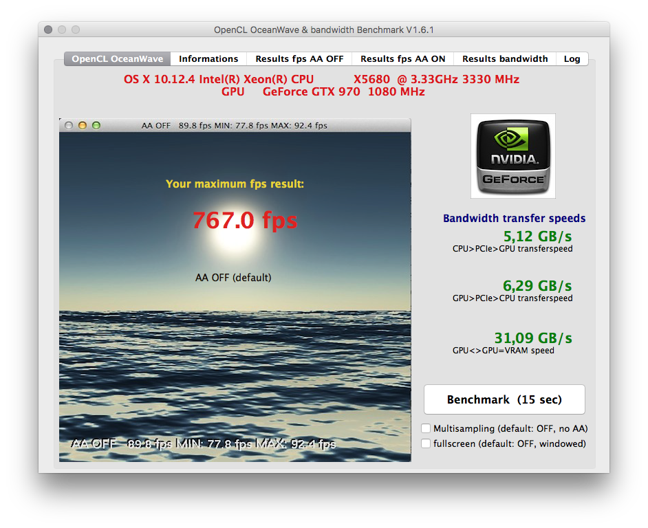

hi all,
i just bought my gtx1080 but i dont get PCI 2 speeds with OpenCL OceanWave benchmark on ( EVGA GeForce GTX 1080 SC GAMING, 08G-P4-6183-KR, 8GB GDDR5X, ACX 3.0 & LED) Can be a bug with OpenCL OceanWave benchmark?
My original 680 mac edition and unflashed GTX970 gives me full PCI-2 speed.
With CUDA-Z i see totally different numbers, which one should i trust? Cuda-Z shows full pci-2 link speed right? am i reading numbers wrong?
What do you guys have for PCI link speed on gtx1080 on cMacPro 5,1?
Can you guys confirm this? first one is GTX-1080 and the second screenshot s from GTX-970. Are you guys getting same link speed? Or should i return my card back? Or should i just trust CUDA-Z and stop to complain'? :D
