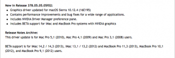

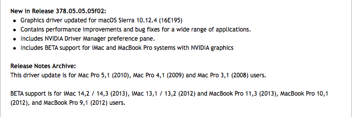

Does nvidia have release notes/changelogs anywhere for these releases? I've poked around but can't seem to find them.
Just this:

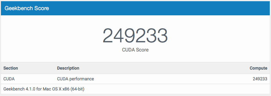

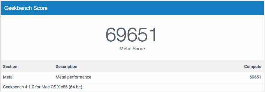

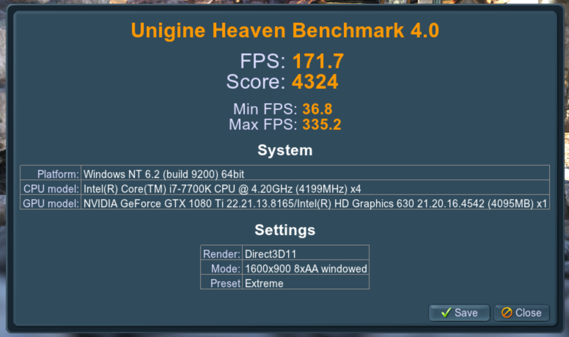

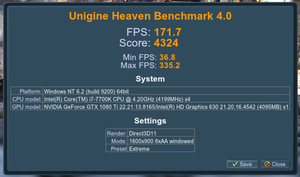

Here are two results from my 1080 Ti in a 12c 3.46GHz cMP:
But the irony is thick. Metal is Apple's latest and greatest and CUDA is de facto compute standard in many things. But since my OpenCL performance is more like a train wreck, my situation kind of sucks anyway:
FCPX is worse than my RX 480, the DaVinci Resolve version I use (MacAppStore) doesn't support CUDA—and that actually came as a very unpleasant surprise. Maxwell Render 4 does use CUDA to accelerate rendering, but the Mac version is "experimental" and I found it buggy.
All in all it's sort of a face palm moment and I'll probably return the card after the weekend if I can't diagnose the real issue and fix it.
