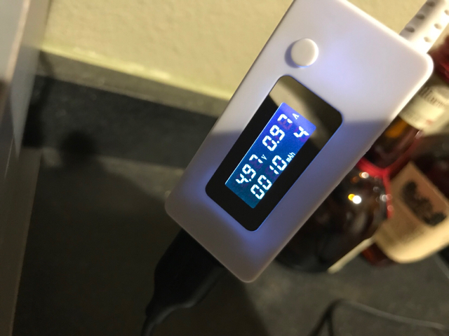

The output of the (this and probably a lot of others) wireless charger is either 5V/1A or 9V/1.1A - therefore you cannot get anything higher than 5W with an iPad 12W charger which uses 5V. Only 9V/1.1A could go higher.
The adapter itself can output 5.2V/2.4A (~12W) or something...but the charger will accept input of 5V/2A and output 5V/1A=5W.
QC2.0, 3.0 adapters support both voltages.
P.S. Update - output of the charger is 5V/1A, input from adapter is 2A... why does the multimeter shows 1A where it is between the adapter and input to the charger - I don’t know :) In any case, as I said, I believe on 5V can not result in output more than 5W on this charger.
...Hope I did not wrote a mistake :)

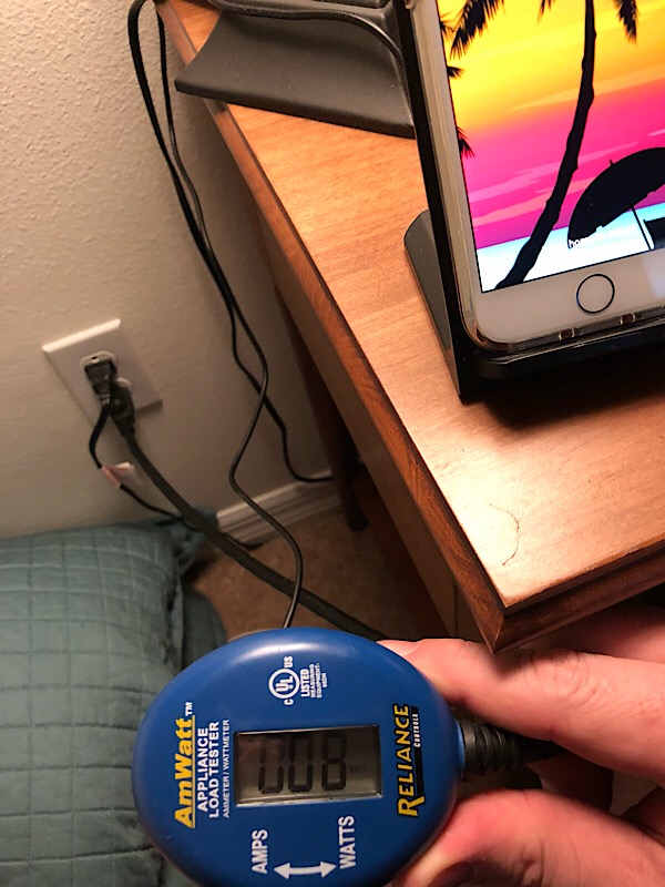

This is incorrect, just tested my cheap Amazon Qi stand, and got 7.5w with the 11.2 update. Only got 5w prior to the update.
Can anyone please corroborate this?? Everyone’s non mophie or non Belkin wireless chargers are about to be much less worth their cost of Apple truly locked down the fast charging to their Authorized chargers.
