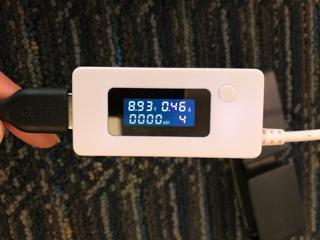

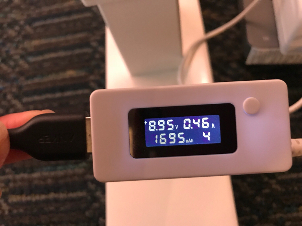

Looks like Anker 10W with Samsung adaptive charger. Is still pulling at 5W.
*I'll run the battery down under 50% and test again. This is at about 80% charged.
The only real way to test for fast charge to have the phone battery under 50%. I believe the iphone X only uses fast charge to get them to 50% after that I dont think they will go up to 7.5w at all

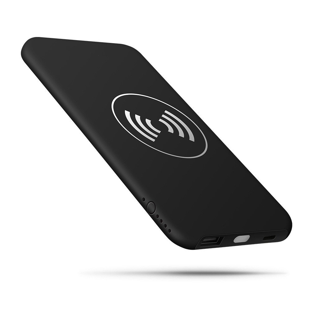

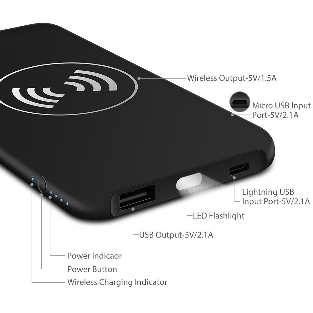

Came in the mail yesterday...
NO Ox Qi Power Bank
It's not Fast Charger but not a deal breaker for me. The selling point is that it is also a Power Bank.
Word of advice, make sure it's a power bank that says it can charge at least an iPhone 8. I purchased a similar looking wireless power bank but it would not charge my iPhone X.
