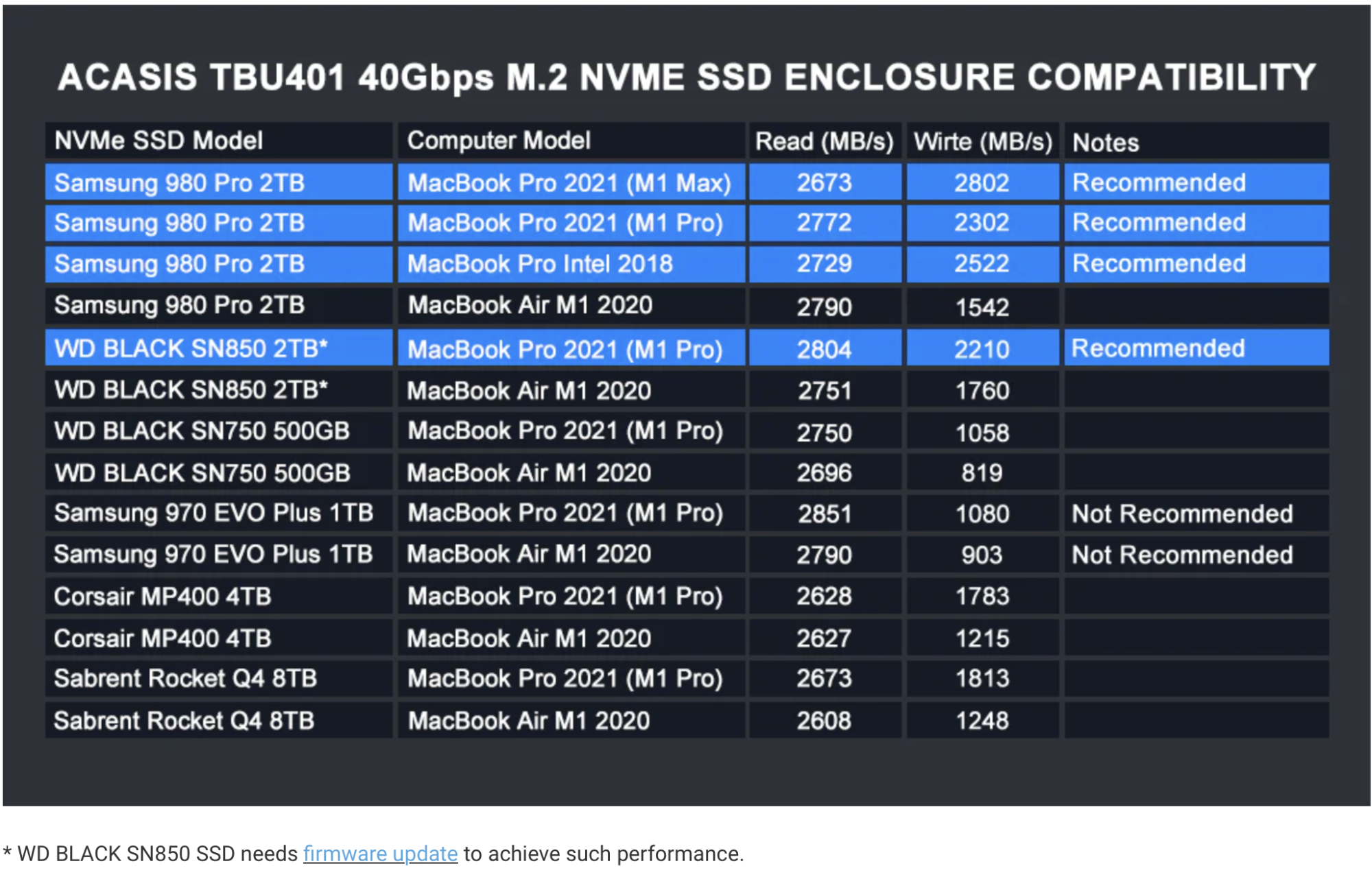

For ~$450-$600 you could roll your own moderate-speed (~2500 MBps) 4 TB Thunderbolt 3 drive that's about as fast as the $900 Samsung X5:
Enclosures:
[some say the above enclosure is noisy]
Budget 4 TB NVME drives:
There's also a TB3 enclosure from OWC, but it's limited to ~1500 MB/s

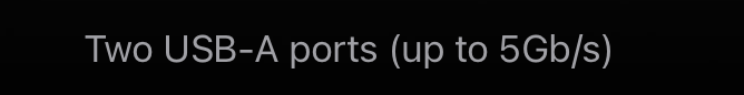

I think I see the confusion. These sorts of complex discussions are much easier in person...
By the way the USB A ports on the Mac Mini are gen 2, not gen 1, so they should be no bottleneck anyway.
Actually, the USB A ports on the Mac Mini (both M1 and Intel) are gen 1. Here's a screenshot from Apple's product page:
And when you wrote this,
Mind you, M1/2, for some reason, will reduce the speed of both gen 1 and gen 2 by about 25% compared to Intel Macs / Windows.
Thunderbolt / USB 4 is not slower on M1 instead.
I thought you meant the gen 1/gen2 USB-A ports on M1 Macs were reduced in speed relative to the specs, but the TB4 ports weren't. [But in fact, you weren't referring to the configuration of the ports, you were referring to the configuration of the attached drives.]
[Also, it turns out no Macs, including the Studio, offer USB-A with gen 2.]
Thus, when I suggested a workaround of using a TB4 dock (I added the suggestion of the dock, under the assumption that the OP might have his TB4 ports filled driving monitors), I meant a workaround to avoid the reduced-speed USB-A gen 1 ports. But when you said you found no gain from the TB4 dock, I now understand you didn't mean no gain vs. a direct USB-A connection, you meant no gain vs. a direct TB4. Whew!

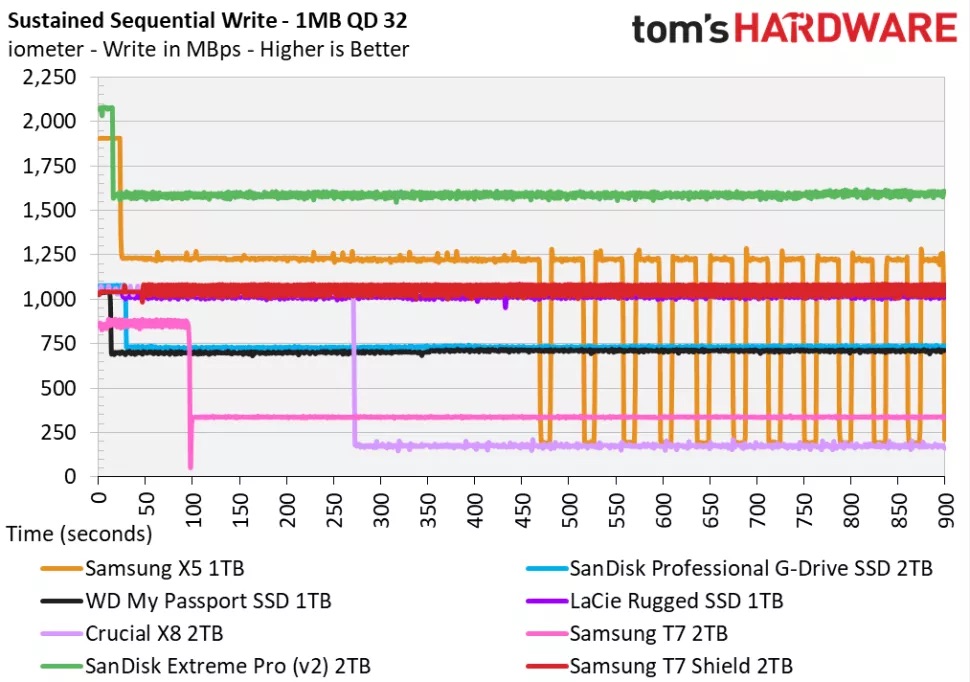

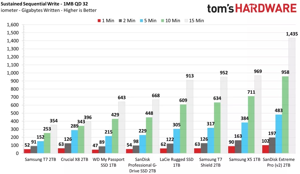

If you're looking at USB pricing (and don't want to deal with the heat from high speed Thunderbolt SSDs), then one of the best drives IMO is the Samsung T7 Shield. It gets sustained transfer rates of around 1 GB/s.
As you can see here, the Samsung T7 Shield holds its own against the Samsung X5 Thunderbolt SSD.
Plus the Samsung (and other name brand) pre-built drives don't have the power issues that some of DIY Thunderbolt and DIY USB drives have.

No, in that case you don't get a reduced speed with the Mac. About the fastest you can get with an NVME TB4 external drive is ~2500 MBps, with both AS and Intel devices. Specifically:
Digitalguy tested USB 3.2 drives plugged into the Mini's TB4. With those, he gets a max of 700–800 MBps = 5.6–6.4 Gbps. That is reduced relative to Intel. However, if you were to take a fast NVME drive, and put it in one of the fastest available TB4 enclosures (or buy one of the fastest ready-build TB4 drives, e.g., the Samsung X5), you could get up to ~2500 MBps. In summary thus far:
PORT-------- DRIVE----------- SPEED
USB 3.1 ---- USB 3.2----- ?
TB4 ----- USB 3.2 ----- 700-800 MBps*
TB4 ----- NVME/TB4----- UP TO ~2500 MBps**
*This is specifically for the AS Macs; Intel devices (both Windows and Macs) are faster.
**Table of NVME drive speeds in Acasis TB4 enclosure. With the 980 Pro, the Intel and AS Macs perform the same (within testing variabilty):

Cool, you're getting the same speeds as digitalguy for the TB4 port -> USB 3.2 drive. Did you also find a speed difference between Intel and AS when the T7 is connected to the USB A port?
Updating the table based on your report :).
USB 3.1 ---- USB 3.2----- 350 MBps
TB4 ----- USB 3.2 ----- 700-800 MBps [for AS Macs -- Intel devices are faster]
