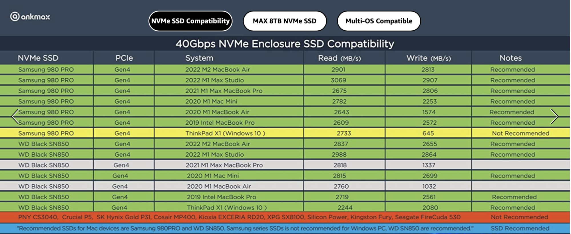

Anybody know if the Sam 980 pro with thunderbolt external drives are running faster with the newer m2 (non pro)???I know they run faster in the m1 pro..I have a reg m1 and wondering if it pays to go to m2
Mac-ra
I'm curious too since a couple (or more?) of the enclosure manufacturer's are showing that the M2 does not throttle the speeds at all like the M1 does. Here's a table from the Amazon listing for the Ankmax UC4M2 40Gbps enclosure which shows quite a speed boost (especially the write speed) for the MBA M2 vs. M1 w/ the 980Pro (and the Siliking SK405 enclosure also on Amazon has a similar table with the same results)...who knows if it's true?:
Thanks a ton..If this is true then I am selling my M1 to get an M2....I mean its only a 2 hundred dollar difference from selling my m1 to buy a new m2 ...Hopefully the M2 doesnt have quirks ..U know apple
In Acasis TBU401E Samsung 980 Pro 2TB on MacBook Pro 13 inch M1 real life test is 2,6GB/s read and write, after SLC cash (~200GB) drop down to 1,6GB/s write. Its basic max what can you got from Thunderbolt 3 or 4 or USB4 😀 The M2 Pro or M2 Max will be the same speeds in real life.

The USB speed limitations of Apple Silicon do not affect Thunderbolt, but only UBS C gen 1 and 2 (2X2 is not supported)
So you should have exactly the same speed.
My results with my Acasis enclosure are around 2.8GB/s read and 1.6GB/s write for both the 980 pro (1TB) and the WD SN850X (4TB). 2.8 is the limit of Thunderbolt, so it won't go any higher.
Is the USB C 3.2 2x1 changed in the m2 macs to 2x2 ?I know they are not getting the speed they should in the M1
