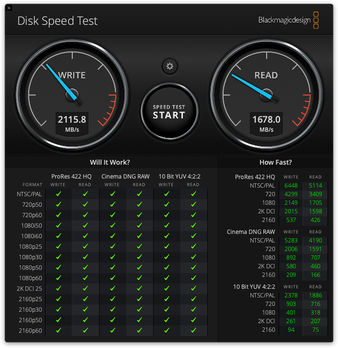

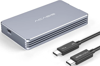

Just got two of these enclosures and put two of the below 1tb SSD into them. instead of paying Apple £600 to replace the base 512gb with 2tb, I’ve saved £140 and will now have a total of 2.5tb. I know the speed on the external ports is less than internal, but just ran the speed test on one of the drives using my M1 13” MBP and i think this will be fine for my use.
USB4.0 Mobile M.2 Nvme Enclosure... https://www.amazon.co.uk/dp/B08X9YTWJC?ref=ppx_pop_mob_ap_share
Samsung (MZ-V8V1T0B/AM) 980 SSD... https://www.amazon.co.uk/dp/B08V83JZH4?ref=ppx_pop_mob_ap_share

I've tested out several difference external enclosures and right now the absolute fastest you can get is the Acasis USB4.0/TB3 NVMe enclosure. On my 16" M1 Max MBP I get 3100 MB/s Read and 2900 MB/s Write speeds--more than enough for editing 4K/8K footage. I use older PCIe 3.0 NVMe drives as you can't get the benefits of PCIe 4.0 with TB/USB and they're cheaper. A 4TB Sabrent TLC NVMe drive is less than $600, so for about $700 all in you get very fast and very portable external storage.
