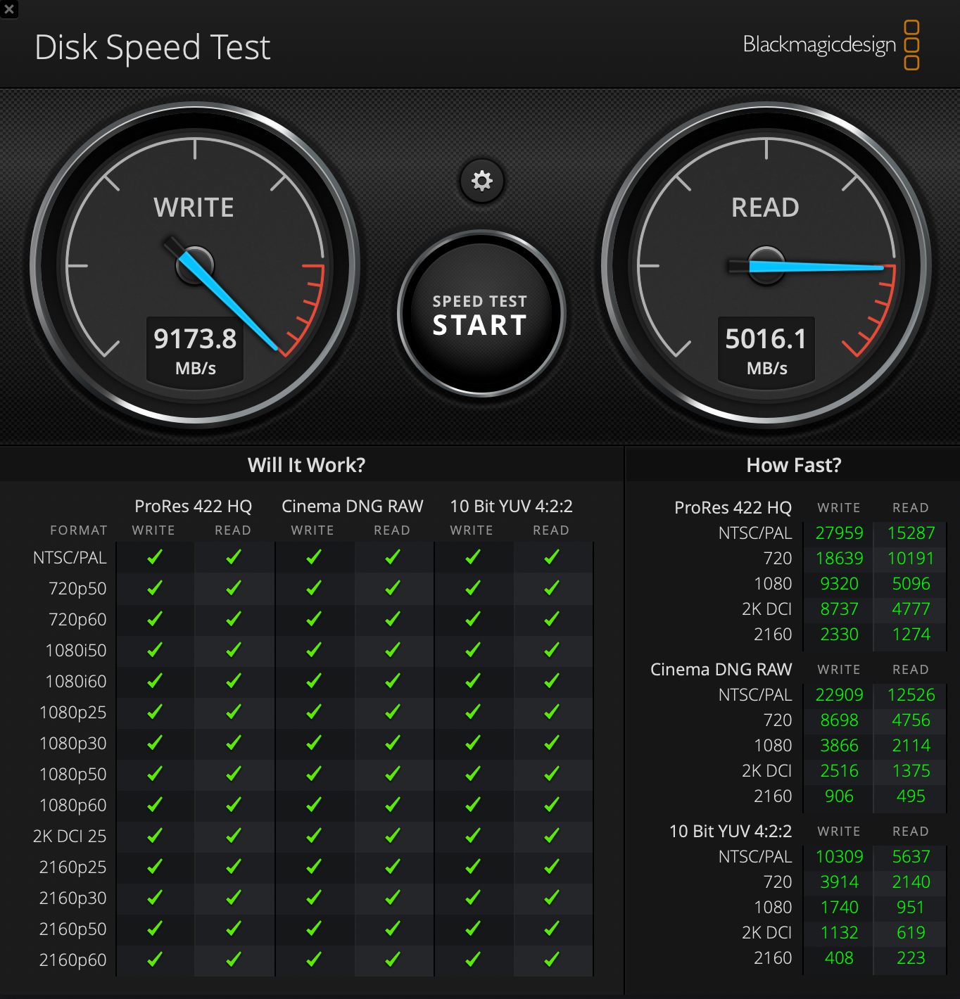

Quick update: I just changed all the cables from Thunderbolt3 to Thunderbolt4, now read/write speeds have improved!! Amazing :D
That is fast! But I wonder why the read speed is lower with 4 drives than with 2 (with 2 drives you had a read speed of 5,800 mb/s.)
Sorry I was wrong, with 2 drives the 5,800 mb/s was only for write speed, read was 3,900 mb/s. So it makes sense the improved speeds!

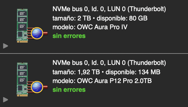

Ok, I've been investigating a bit. The first 2 Thunderblade units I bought last year have inside Aura P12 Pro disks, and the 2 Thudnerblade units I bought last week have inside Aura Pro IV disks... In OWC website you can see that the new Aura Pro IV disks are much more faster... see attached images. I am not sure now if my bottleneck is due to mix both type of disks... maybe if I had the 4 units with the Aura Pro IV disks, I would get even higher read/write speed results... Although we are still limited to the max speed you can get via Thunderbolt4 ports, so I am not sure if I would benefit or not, or the bottleneck is just the Thunderbolt4 limitations... any thoughts??
