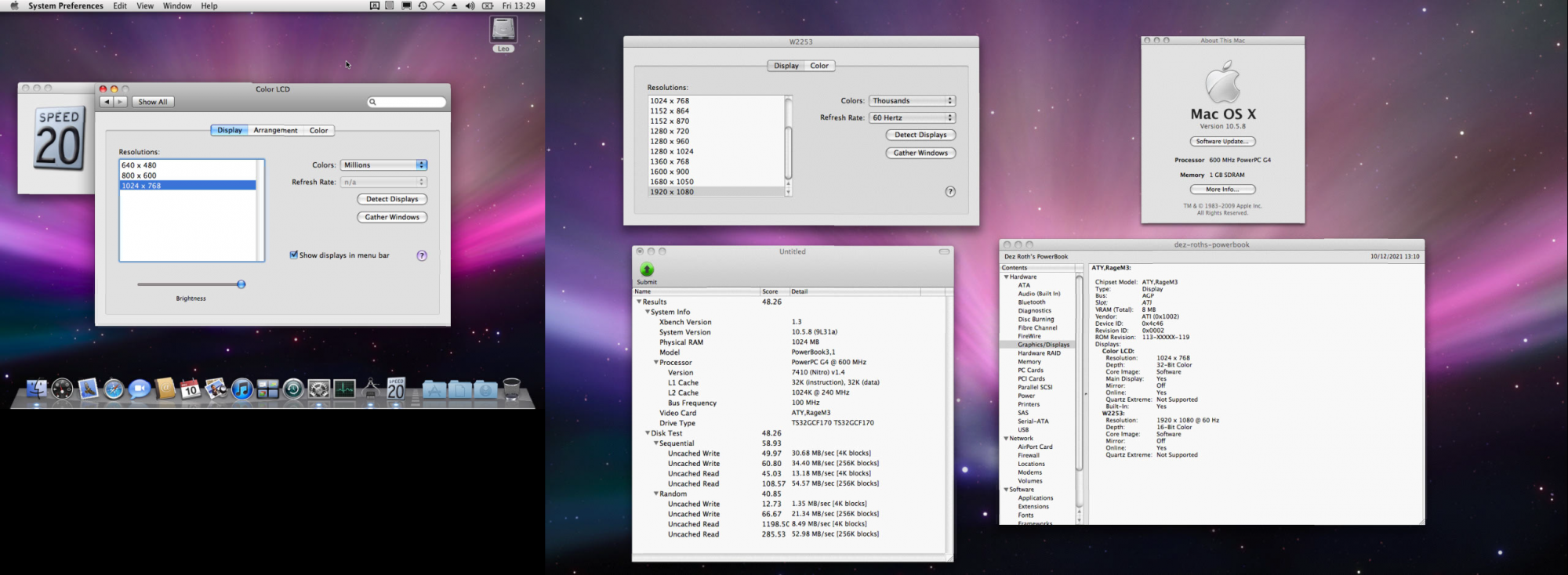

I wonder what Leopard does if you have a setup that “necessitates” a 256-colour mode, such as this one. (You'd either need a G4 upgrade in that particular laptop or e.g. an original PowerBook G4 which also has a GPU with 8 MB VRAM.)
you called? :)
sadly I dont have any other VGA capable monitor on hand with a higher resolution then 1080p
(also shown is an xBench benchmark of one of 2 Industrial 32GB CF cards I managed to get my hands on :) primarily got these for windows stuff as they show up as fixed disks on an ATA bus and not removable disks like consumer CF cards do which upsets windows, but just had to test one out in the Pismo while I had it out :) )
