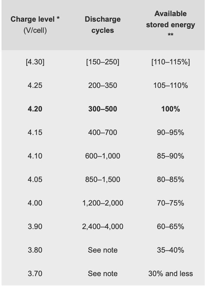

Isidor's book - https://www.amazon.com/dp/B071NJZCGF - actually talks about this - within the first 100 cycles, batteries can actually increase a little in capacity. I guess this is especially true if they're treated nicely (not at 0, 100% extremes).

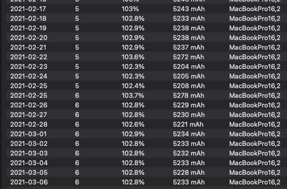

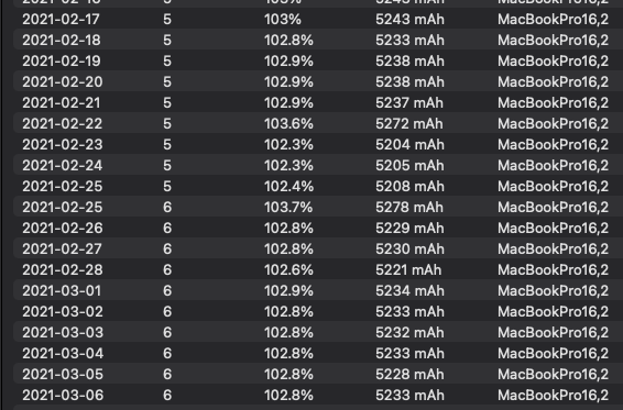

My MBP, vs my 2017 MBP is seeing some really nice battery %s after 6 months. See attached for 1-5 months. Below is 5-6 months.

Wait what? Charging only to 80% most definitely does reduce capacity loss over time.
Second, there's no way to fool Apple's readings into making people think they have a good battery when they don't. That's not possible. ????
After 5 years a battery stored at 100% is going to have a LOT less capacity than a battery stored at 50% or even 80% over 5 years.
Tesla even does this by trying to discourage the use the full 100% by recommending not charging to 100%. This is a fundamental of li-ion/poly batteries - if you only use a tiny % of the capacity, it's going to SIGNIFICANTLY extend the life of the battery. Satellites operate on this principle and use batteries for decades this way.

My 2017 MBP I had plugged into the wall most of its life. My 2020 MBP I've got set to 70-80% Al Dente. Comparing the two with coconutBattery over time is showing a significant difference even after just 6 months. My 2020 MBP has almost the same capacity it had (Apple's own reporting) the day I bought it.

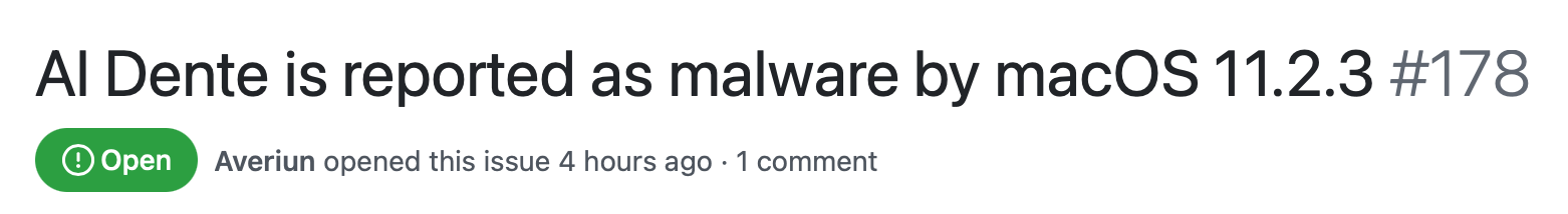

Help. Just restarted my Mac, and kept getting the repeating “AlDente.app” will damage your computer. You should move it to the Trash. pop-up. I did command-I and checked "Override Malware Protection," which stopped the pop-up—but when I try to open the app, I get You do not have permission to open the application “AlDente.app”.
Help. Just restarted my Mac, and kept getting the repeating “AlDente.app” will damage your computer. You should move it to the Trash. pop-up. I did command-I and checked "Override Malware Protection," but when I try to open the app, I get You do not have permission to open the application “AlDente.app”.
Wow really? ! Oh my.... did Apple add that app to their malware detection list? My wife and I run this app and we haven't gotten that yet. Though we don't restart much.
https://github.com/davidwernhart/AlDente/issues/178 Looks like someone reported it on the GitHub.
Yes, I deleted and reinstalled, and again had to check the override malware button. Still says I do not have permission to open.
