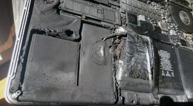

Lithium batteries can catch on fire. But that has nothing to do with how you charge it. It happens because there was a defect in manufacturing. I am sure we've all read about that other company's phones catching on fire on flights or smoking. They weren't connected to chargers and they were banned on most airlines. There was also a similar problem with a particular year of Macbook Pros. None of those issues had anything to do at all with charging. If there is a defect in how the battery was manufactured, then you will end up with screenshots like you have included, no matter what apps you use and how you take care of your cycles and whether you perform a voodoo ritual every time you connect your computer to a charger.

Modern devices are designed with the thought that users will not take ideal care of them, and the results are not bad at all. These problems do not occur at a very high frequency, but they do occur.
In the case of my other laptop, if the cell pack was defective, I would have experienced failure very soon after buying it, and not after two years, so I achieved the failure through stress and not because of a defect.
I'm not saying people should sleep with one eye open around their tech - I am saying that telling them to not consider taking better care of their devices will do no good to anyone and might do harm to some. Nobody is saying you should freak out about this, nor is this any type of fear-mongering.
This is simply stating the facts - batteries are not toys, they pose risks and treating them badly COULD end up badly. Or it couldn't. But more importantly - it could.
