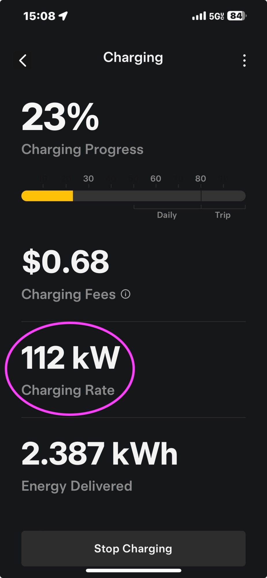

My Ford EV (400V) at Tesla Superchargers will max out around 120 kW.

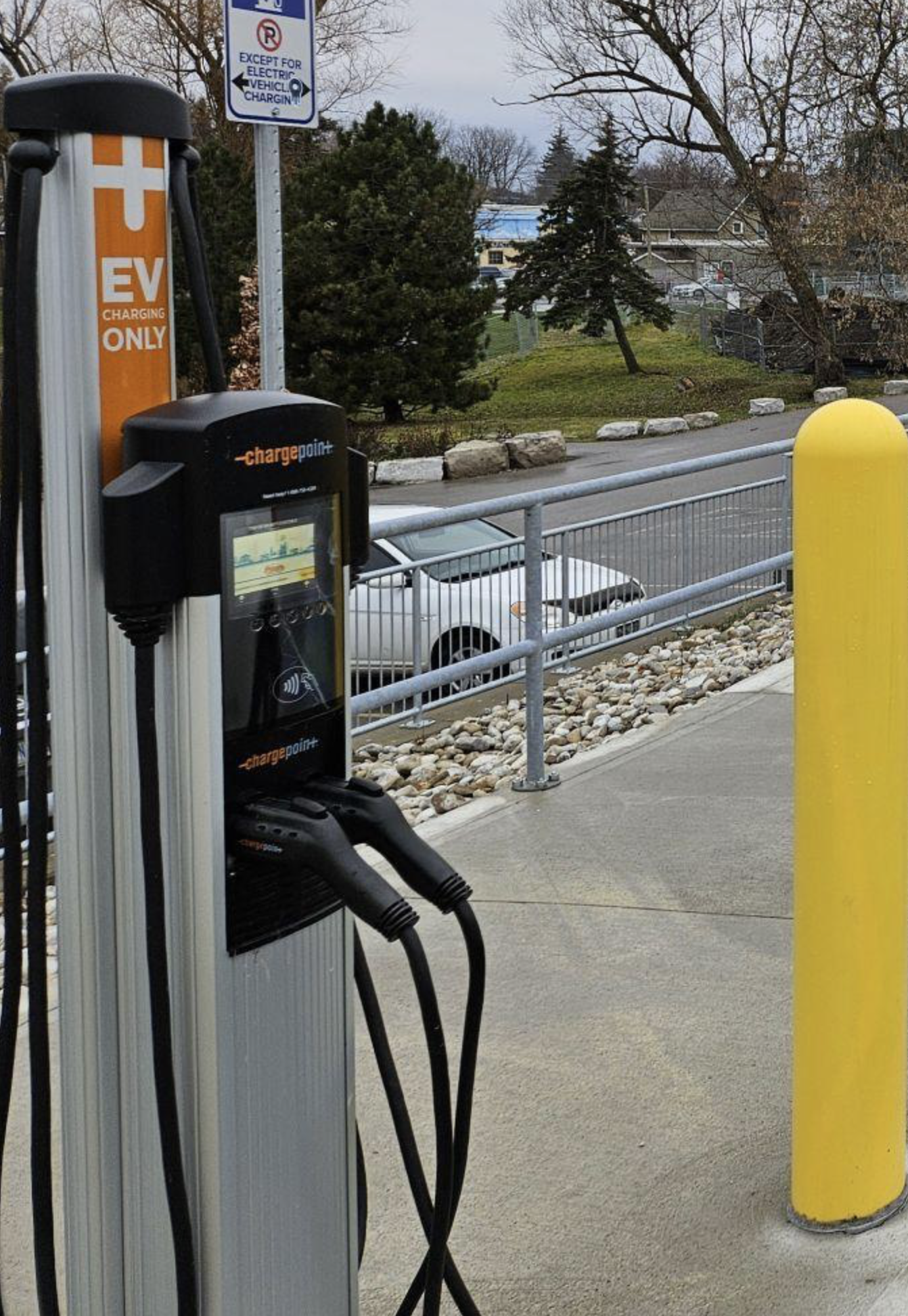

I am in Canada. I was asking because I have 2 charging stations up the road from me. They are not Tesla branded charging stations. In some googling it looks like you get an adapter with a Tesla that covers most charging stations in N. America. If things go through at work and I get a Tesla Y, we would have the faster home charging station at the office, so I would generally just charge there and at home if I am in a pinch I could charge up the road. I live in a small town and from looking online I can see how many times those charging stations have been used, which is a total of 8 times in almost a year, so no real concerns about availability.

Sounds like you have access to L2 public chargers which use the top half (AC part) of a CCS1 adapter known as J1772 (round part, without the bottom oval DC plugs). Teslas do come with a J1772 to NACS adapter that you can use. Just so you know how long this takes, I use 30% of my battery in my 2021 TMY LR AWD a day, it takes me about 2.5 hrs at L2 40 Amp charging at home.
With a L3 Tesla or 3rd Party CCS1 (using my adapter that I purchased from Tesla) with a properly preconditioned battery, I could do that same 30% in about 10-15 minutes.

going to be a different way of thinking for sure going to EV from a regular car. I checked online and they charge $1 an hour for charging. Not sure how fast it goes, I would basically be wanting to get enough charge relatively quick to get me about 80kms to get to work, with some wiggle room. If I needed faster charging there is a Tesla charge station about 25 mins away. Again I think it will just be a different way of thinking as a quick fill up is not a thing anymore

going to be a different way of thinking for sure going to EV from a regular car. I checked online and they charge $1 an hour for charging. Not sure how fast it goes, I would basically be wanting to get enough charge relatively quick to get me about 80kms to get to work, with some wiggle room. If I needed faster charging there is a Tesla charge station about 25 mins away. Again I think it will just be a different way of thinking as a quick fill up is not a thing anymoreView attachment 2386024
So that’s looking like a L2 charger which typically gives you around 20-25 miles/hr of charge, so appr 35 or so km.

If you get the Chargepoint app, you can look up info on the chargers you pictured. You can usually see the max kW charging. I'm going to guess it is between 6 kW and 10 kW (I get 9.X at home on my 220V 40 amp charger).
