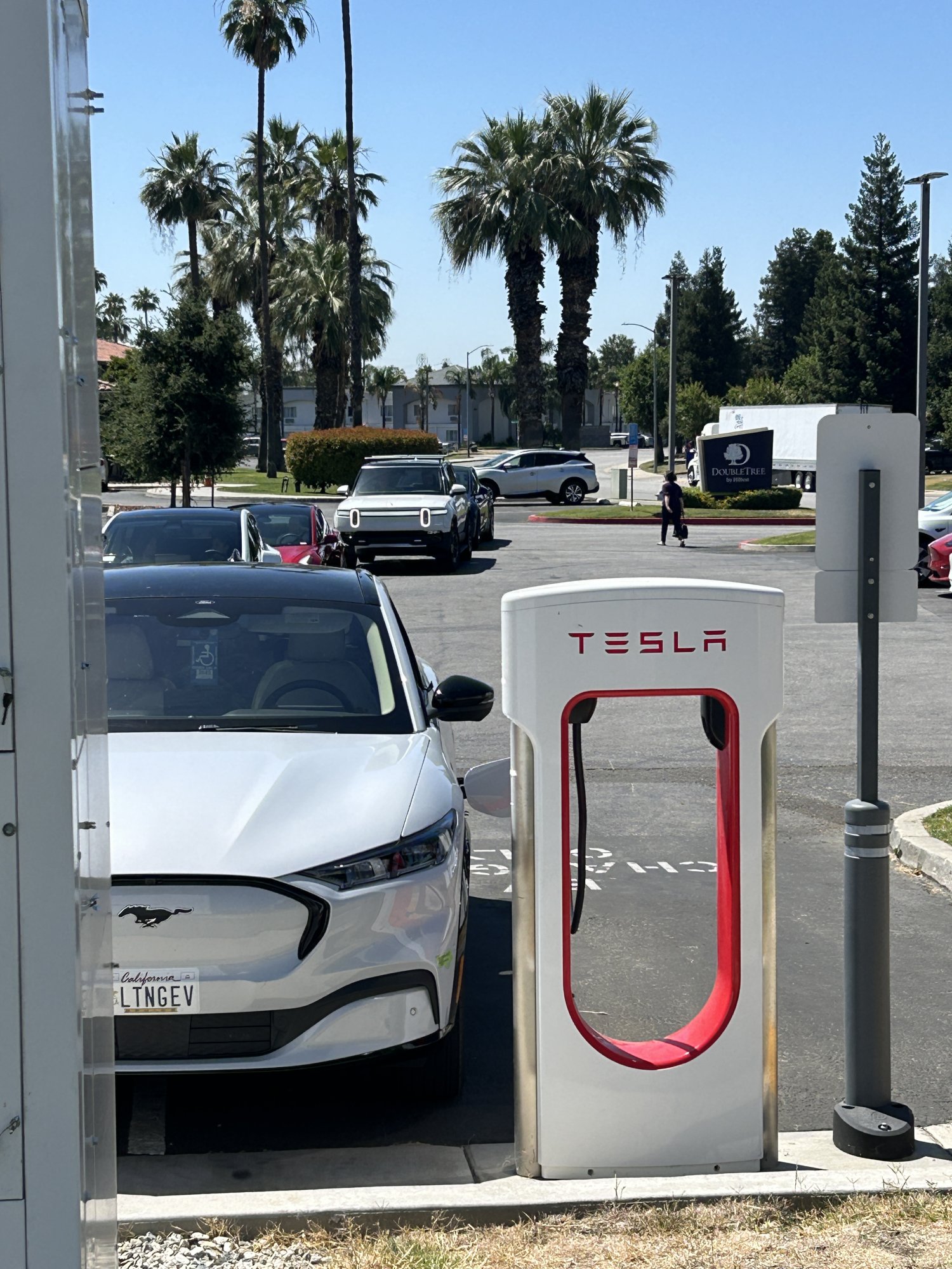

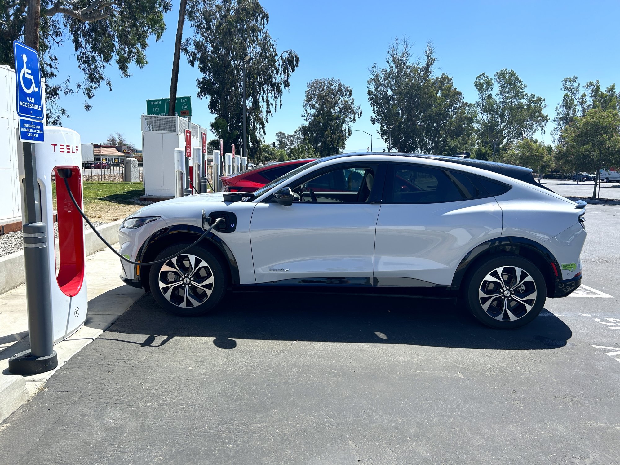

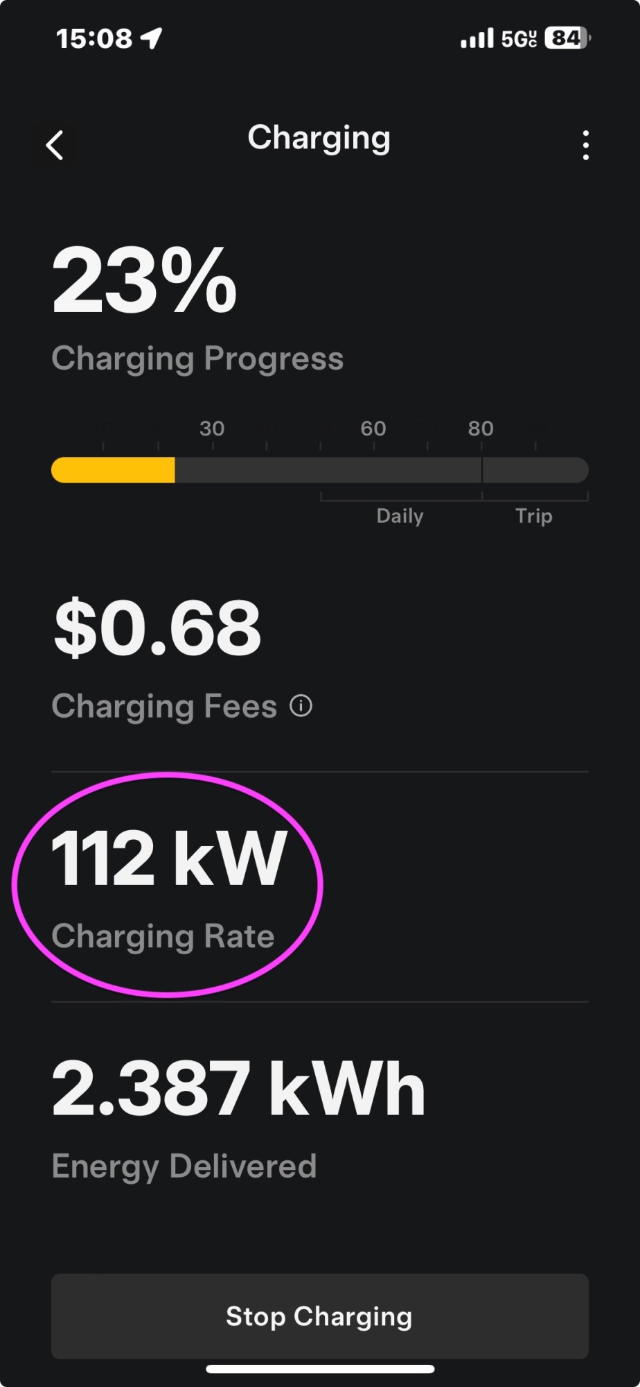

Most EVs are 400V architecture so won't take in more than 150kW.
My Ford EV (400V) at Tesla Superchargers will max out around 120 kW.
Next EV will look at getting an 800V battery car like the Porsche Taycan....
Does Ford show the Wattage and Amperage when DC Fast charging? Your Ford should be seeing ~200kW if it accepts the full 500A.
No, Fords only show the kWh rate.
Ford F150 Lightnings have been seen to max out around 150kWh rate for a short period.
I do notice that Tesla's Superchargers are much quicker to charge than the CCS1 DCFC of other brands.
Maybe it's because of the shorter, thinner, liquid cooled cables of Tesla chargers ???
