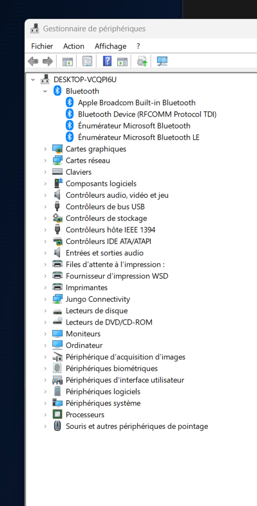

Good news !
I have audio now on my cMP 5,1 after installing Realtek Audio driver R2 83 ! 🙏🏻
On the contrary, Bluetooth host adaptor : no driver for my Broadcom updated module 😥
Reactions: JedNZ
Good news !
So the 7,1 bluetooth drivers did not work for you? You have an upgraded card?
Try these:
P.S. I read in the signature - BT 4.2 BCM943602CDP and gave you drivers for it. Then I realized that you need drivers for Bluetooth 7.1 )))
  • AppleBluetoothBroadcom64.zip
Finally, BT works perfectly !
Thank you for your help :)
Reactions: Sergey-Galan

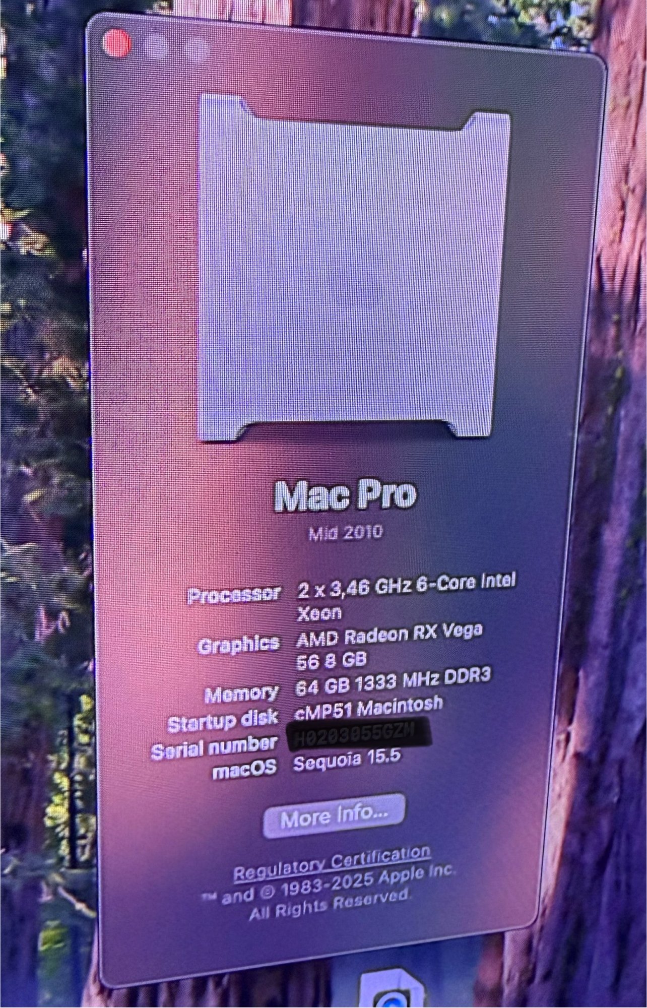

Hello guys,
My mac pro 5,1 3,46Ghz 64Gb Ram bt+wifi 4,1 (still on hdd :rolleyes:) runs sequoia like a charm
Thank you so much all!
My issue is win 11 i can not manage to after install get into windows
I’ve tried using dism, windows install and normal (ruffus) install, all methodes i could find but nothing works (ps: it does not brick the mac pro, 1hdd macos+partition for oclp , 1hdd win11) windows is not creating the efi partition there is only one folder named boot that contains efi folder inside
Does anyone have any thoughts and or considerartions?
(Yes i need win11 for work, my imac 27” 2010 with s7100x bt4,1 works perfect)
Thank you!

did you install windows 11 via the OCPL boot picker ?
Also look at upgrading to SSD's your system will run much faster and boot quicker.
the only HDD i have in my cMP 5,1 is a 2 TB HDD in Bay 4 for storage of app installers and so forth
formatted as EXFat so MacOS and windows can both write to it.
found a quick fix for getting your Mac keyboard volume keys to work in win 11.
all i did was install apple software update then run it,
Still have to hold Fn key to use F1 to F11 but all i needed was the volume keys to work
The upgrade is on the to do list, started to upgrade the imac first hehe
I think so but will do it again been extra carefull and make sure to use oclp to pick the usb install
Thank you!

I hope you backed up the firmware, before experimenting with various Windows installations.
Have you checked, if you got certificates? If not, you can use my Dumper (link in signature).
Signatures do not brick the Mac Pro instantly, but they wore out the firmware chip as they fill it with a large, not deletable junk variable, forcing garbage collection run more often than necessary.
how can i overcome this? how to make sure that windows is properly installed?
ps: dumb question I'm using the HDMI exit on the Vega 56 can that be the problem? i mean should i use one of the other 3 DisplayPort's?
