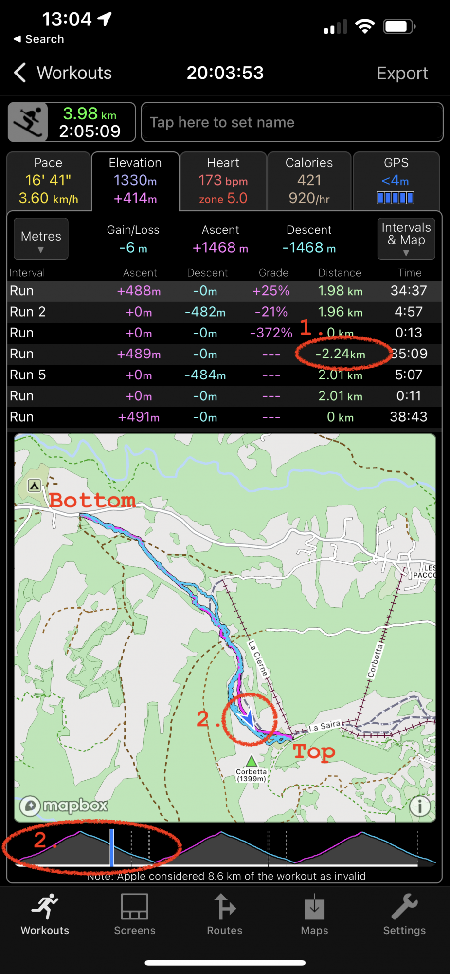

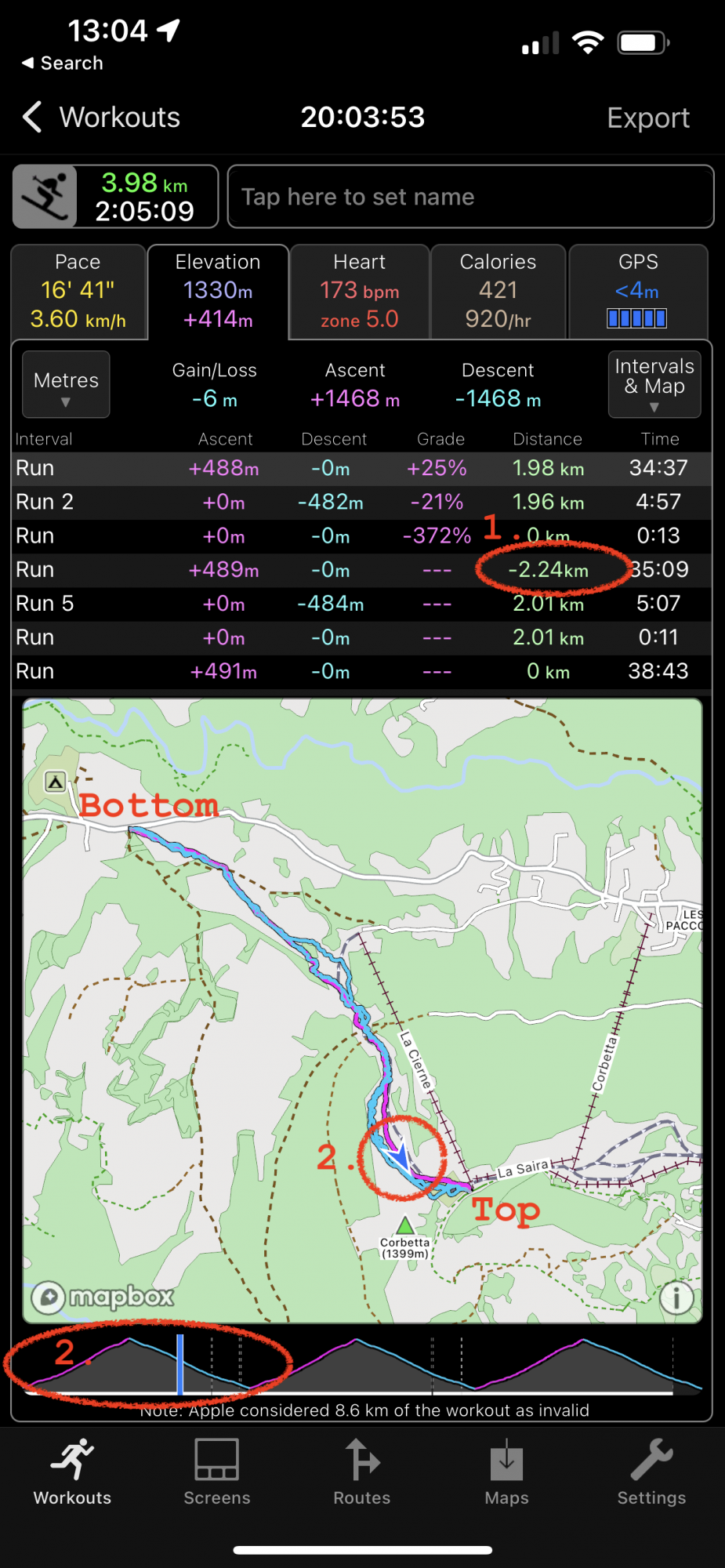

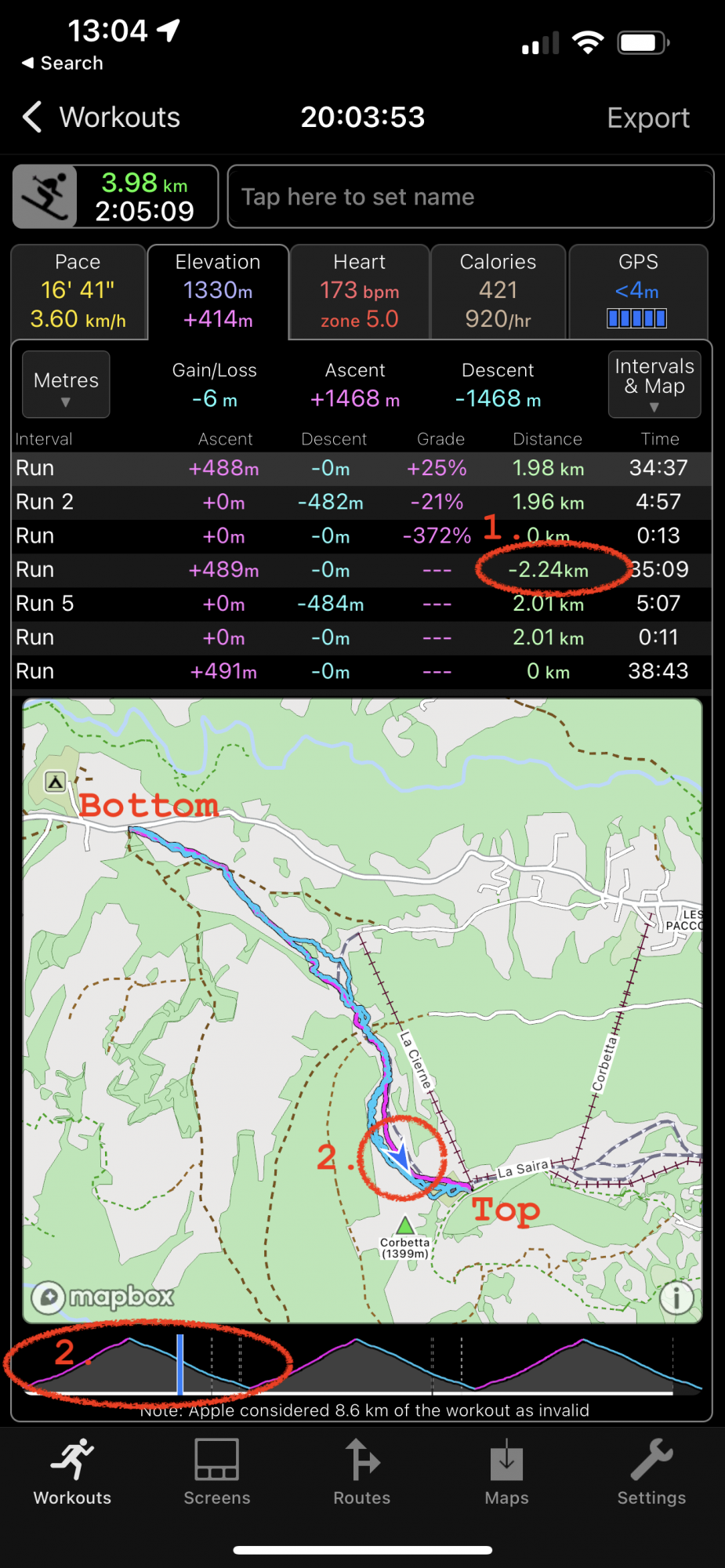

Recently I started using it for ski-mountaineering (walking up using skin under your skis, and skiing down). As there is no activity type for it, I have been recording under the ski activity.
I have a couple of questions / suggestions
A. Would it be possible to have a dedicated activity for skimo (ski-mountaineering) ?
B. A very useful metric in skimo is the VAM (Vertical Ascent in Meters per hour). It is also a useful metric in trail running for the uphills. Would it be feasible to have it displayed in the workout page (per interval / per lap) ?
C. Yesterday I recorded a tour (on the map, from bottom to top x3), and used manual intervals to split the workout between ascents and descents (I set the auto-lap to off as I wanted to see metrics for the different uphill laps).
However in the workout page, it looks there are a few issues. (tcx and gpx files attached here)
  1. The 2nd ascent has a distance of -2.24 km, and the 3rd ascent a distance of 0km. The total distance is incorrect as well (3.98km, Strava shows 12.6km) (number 1. on the image)
  2. The elevation graph seems incorrect. On the image bellow, I was still going uphill, but the elevation graph shows downhill. (we can see the dashed interval lines that correspond to top and bottom) (number 2. on the image)

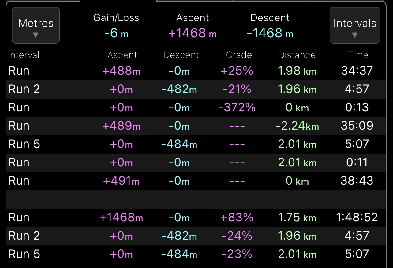

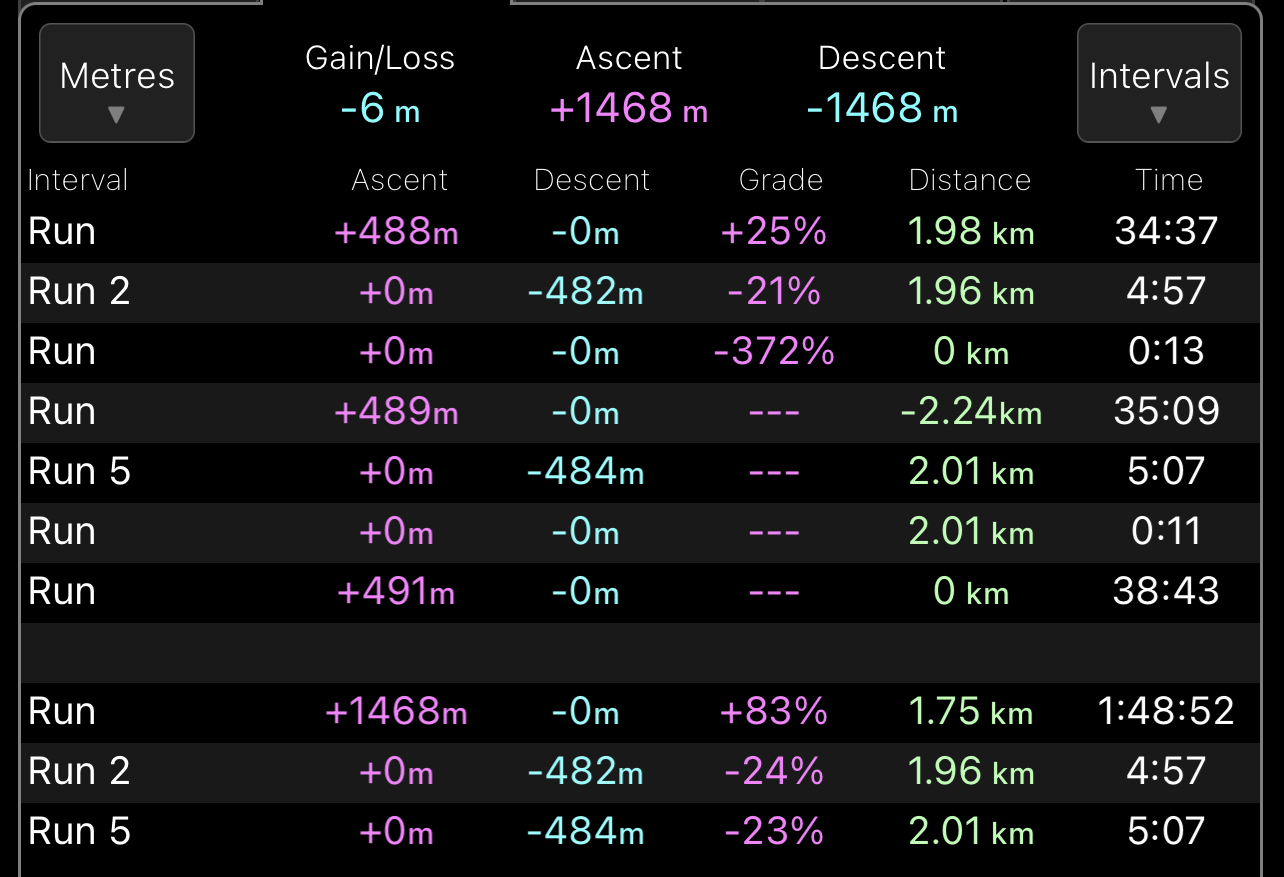

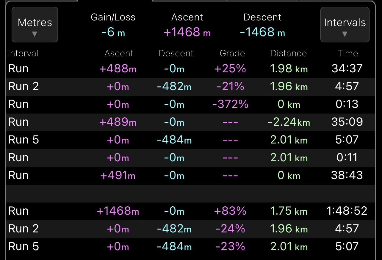

  3. The last 3 intervals displayed (in the 2nd image) don't really make sense (the 1st is the whole workout, and 2nd and 3rd are duplicated). Moreover the last interval downhill is not showed, although we can see the dash line on the elevation graph.
View attachment 1963785 View attachment 1963786
Sorry I have only just seen this. I have never seen strange intervals like that before but it is probably being you are using the Skiing workout, which is designed for downhill skiing. It uses Apple's run detection system to detect runs and then creates intervals for each run. So my guess is that algorithm is probably being very confused by ski-mountaineering. You could switch off the detection in the settings or just ignore the intervals.
I don't think Apple offer a ski-mountaineering activity so I can't add one to the app. If you don't want to use Skiing then you could use the Other Outdoor activity instead.
In terms of vertical ascent speed the app has vertical speed metrics that uses relative elevation but not one for ascent. I will add it to my ToDo list but it won't be high on the list because I think you are the first person to ask for it. Sorry about that.
To be honest I could release the beta now but there are a couple of issues that I want to sort out first.
