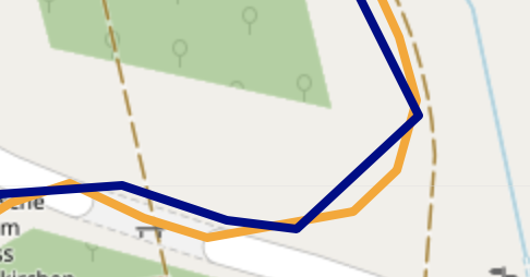

The current version of the app does export slightly fewer points to save memory, but certainly not a third of the points, so something else must be causing that.
To check that, I repeated a run I did a week before. 10.5 km (1:02) and compared the exported GPX-files.
Run with Stryd app: 3754 points
Run with WOD: 1280 points
So my guess with about 1/3 of the points was quite right. Stryd seems to record 1 data point per second.
Good example that shows the corner cutting is here (yellow is Stryd app, blue is WOD):
Can you send the link to mygpsfiles if you want to compare the runs. Btw, the runs have almost the exact same distance which is great.

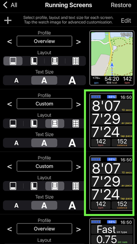

Another question, might be newbie, but I can't figure it out.
Configured six screens and my screens 2+3 are custom. Whenever I edited one of the screens, I end up both being the same and only of them is displayed in WOD.
So I first had screen 2 with metrics about distance, time, etc. and screen 3 about paces. Result: had only screen 2.
Found that screen 3 showed the same metrics as screen 2. Corrected screen 3 again to show paces and now screen 2 shows the same as screen 3.
Hope my question is clear, I screenshot my WOD app:
Most probably I do not understand what "Profile" means.
Yes, there is only one configuration for a combination of profile/activity/layout/text size. As those screens have the same combination then changing one will change the other.
This gets pointed out surprisingly rarely. I remember thinking that it could be confusing when I coded it many years ago, and that I may have to work around it, but I think you are only the second or third person to ever mention it.
Reactions: NME42
Thanks. That explains it. Changed my second screen to profile Pace.
But still don’t get what semantics a profile has. Nevermind.
