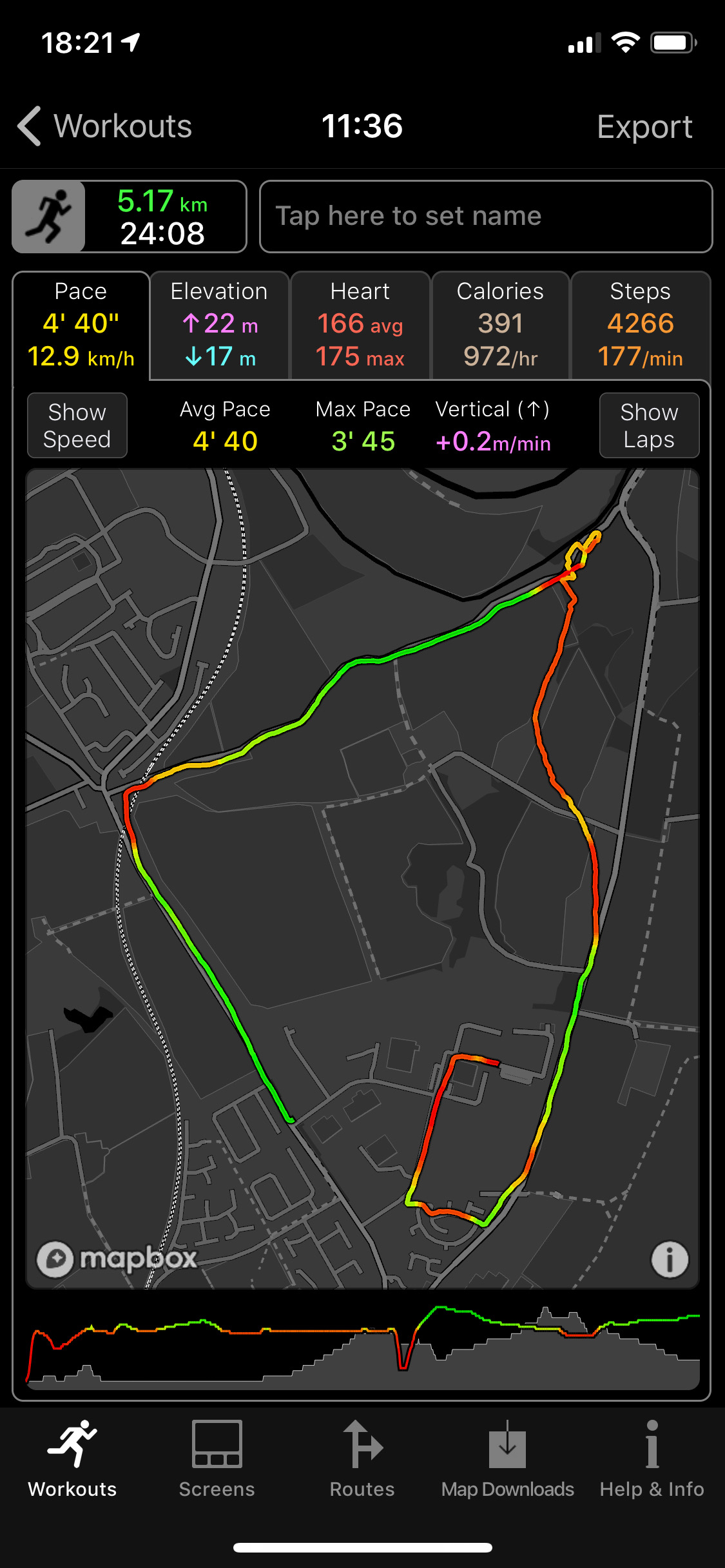

The reason I mention this first is that it affects the pace figures that you are seeing for each position when touching the graph. These pace figures are instantaneous figures reported by Apple at each point of the workout. Instantaneous pace is much harder to calculate than average pace over a lap or workout because the period is much shorter.
I understand problems with instant calculations, that's clear. For example. I week ago I ran 4 km with target pace at 5'50". Your app was grate! Instant pace was showing all the time ~ 5'30" +/- 30". It flawlessly had shown my distance and time ahead. I've even tested instant pace graph and it worked beautifully. When I'd speed up - it showed me a live update on the graph instantly. Same when I'd slowed down. It blown my Garmin Fenix 5 away. The problem is only in the review on the iPhone. Avg pace of that run is 5'35". I remember going below 5'00" (it was on AW screen) but on the iPhone graph is showing me 5'33" at the highest point and the rest between 6'10 - 7'00". Thats the problem.

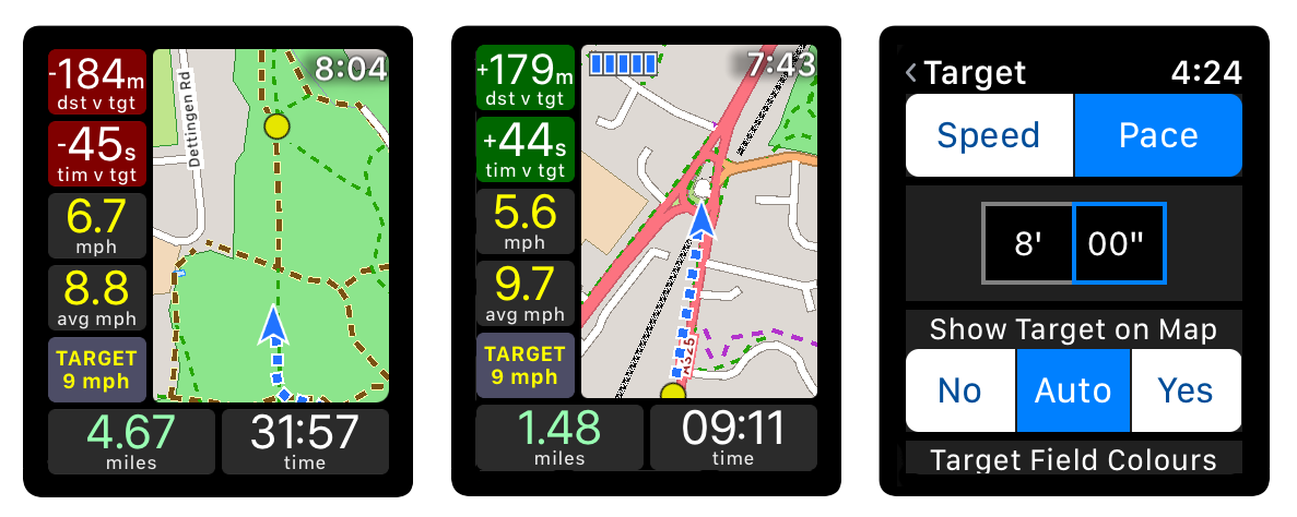

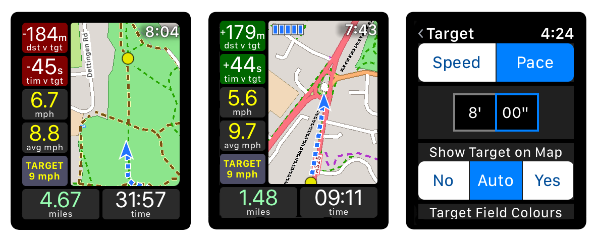

That's interesting. So the instantaneous pace on the watch app was correct but the values in the iPhone app afterwards did not match it. I will investigate to see if there is a problem.
I am glad to hear that you like the target pace feature. Out of interest so you use the map with the real-time yellow dot showing the position of someone moving at the target pace? I find that seeing it catch me up, or me catching it up, motivates me even more than the distance/time ahead/behind metrics.
Yes, that's exactly what is happening. I'll test it in a couple of hours. I've reinstalled the app and now I see it in Motion & Fitness so cadence is working. Maybe that was the problem.

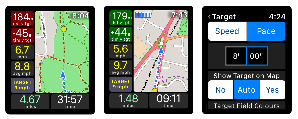

I didn't know about that! I just used target screen with distance and time ahead. I understand I have to run on GPX route to see that? I will test that and happily give You feedback but right now I can say that seeing its "right around the corner" is more motivating than 50 m 🙂
Reactions: cfc
You don't need to load a GPX route. You just need to set a target pace in the settings. To do this press the watch screen hard and select Settings. Then select Target Pace and set it to the pace you wish to see.
I plan to add the ability to set the target pace from a GPX file from a previous workout in the future, but at the moment it is just a fixed speed or pace.
I've found it. I didn't have a map on the target screen and overlooked it. Target pace from a workout is great. I often use it on Garmin to race with myself. Looking forward to that and thanks for the help! If my problem with pace on the iPhone continues to occur I will contact You via support.

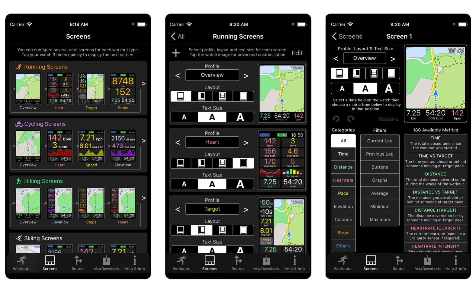

The new version of WorkOutDoors adds many new features to make it the most powerful and configurable workout app for Apple Watch (IMHO), as well as being the only app that shows a fully functional vector map to aid navigation.
This new thread is all about the new workout features in version 3.0. To read about the existing mapping and GPX route features check out the website: http://www.workoutdoors.net/Maps.html

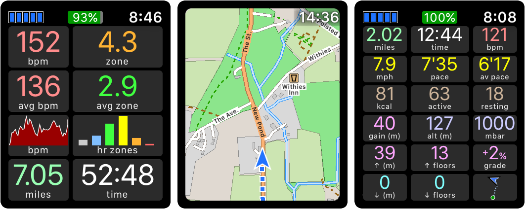

The new workout features include:
- Completely configurable screens with 4 layouts and 3 different text sizes;
- over 160 live data metrics to choose from, including mini-graphs and buttons;
- ability to define multiple screens and cycle through them during the workout;
- interval alerts for distance, time, steps, ascent, and descent;
- maximum and minimum limit alerts for pace, heart rate, speed, and cadence;
- set a target pace and display the distance and time ahead or behind target;
- show a live icon on the map representing someone moving at target pace;
- manually start new laps or use automatic laps with configurable intervals;
- lap splits available for many metrics and at any time during or after the workout;
- many heartrate zone metrics with user configurable zones;
- much improved analytics screens on both the Watch and the iPhone;
- 3 separate rolling pace metrics with user configurable distance or time windows;
- improved geocaching capabilities including display of groundspeak extensions;
- new workout types: Cross Country Skiing, Paddling, Skating, Surfing, and Golf;
- improved settings screens, all with ability to jump straight back to workout by force pressing;
- now able to lock the screen and/or the crown, to avoid accidental touches;
- tapping a field now shows a full screen description of that field;
- can configure shortcut operations for triple-tapping, quadruple tapping or pressing both side buttons;
- new optional on-screen battery meter;
- many more new features and improvements
These features are detailed in the following posts.

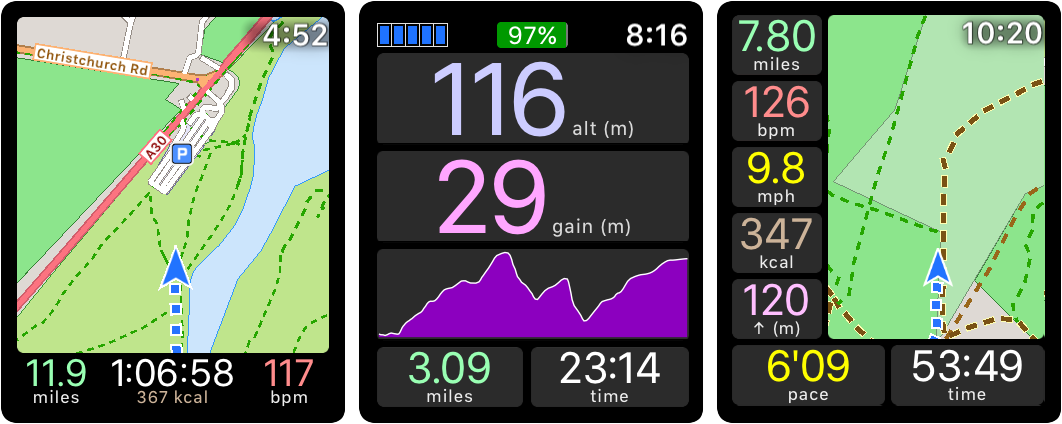

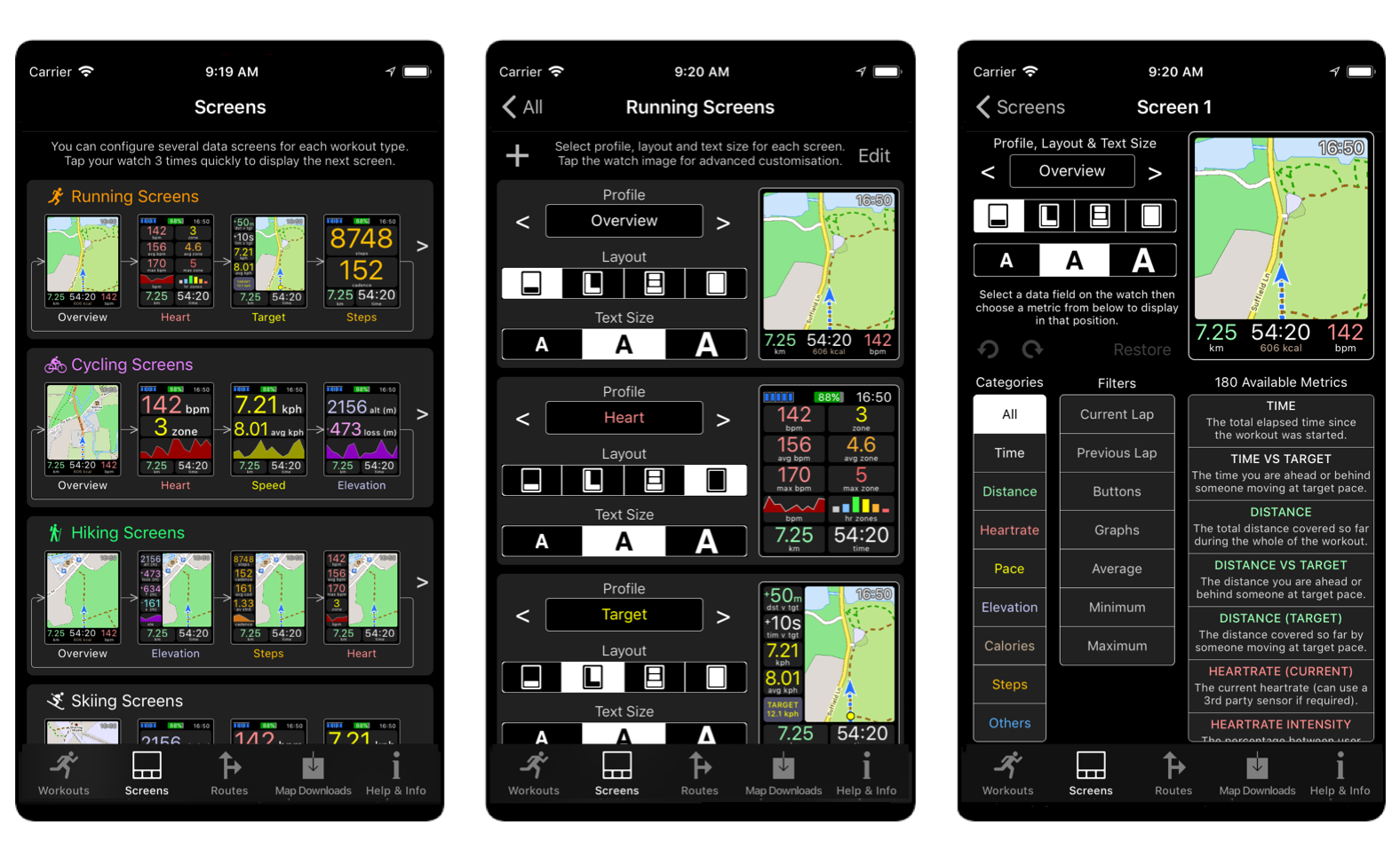

[doublepost=1535620387][/doublepost]New Screen Layouts

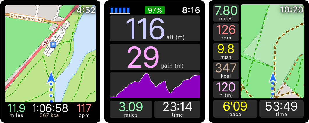

You can now choose from 4 screen layouts:
Bottom: Data below the map (as before);
Tower: Between 2 and 4 full width data fields above 2 or 3 data fields (no map);
'L' Shape: Data below and also on the left side of the map;
Grid: 2x4, 2x5 or 3x6 data fields (no map).
Each of these formats can be displayed in 3 different text sizes. The smaller the text then the more fields that can be shown and the larger the map (if present). As before, you can always double tap to see a full screen map, and double tap again to see the data again.

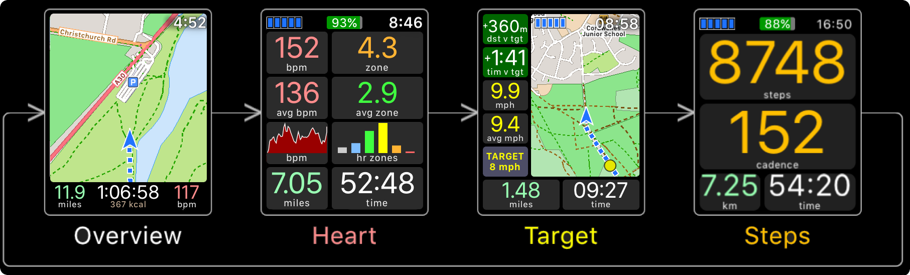

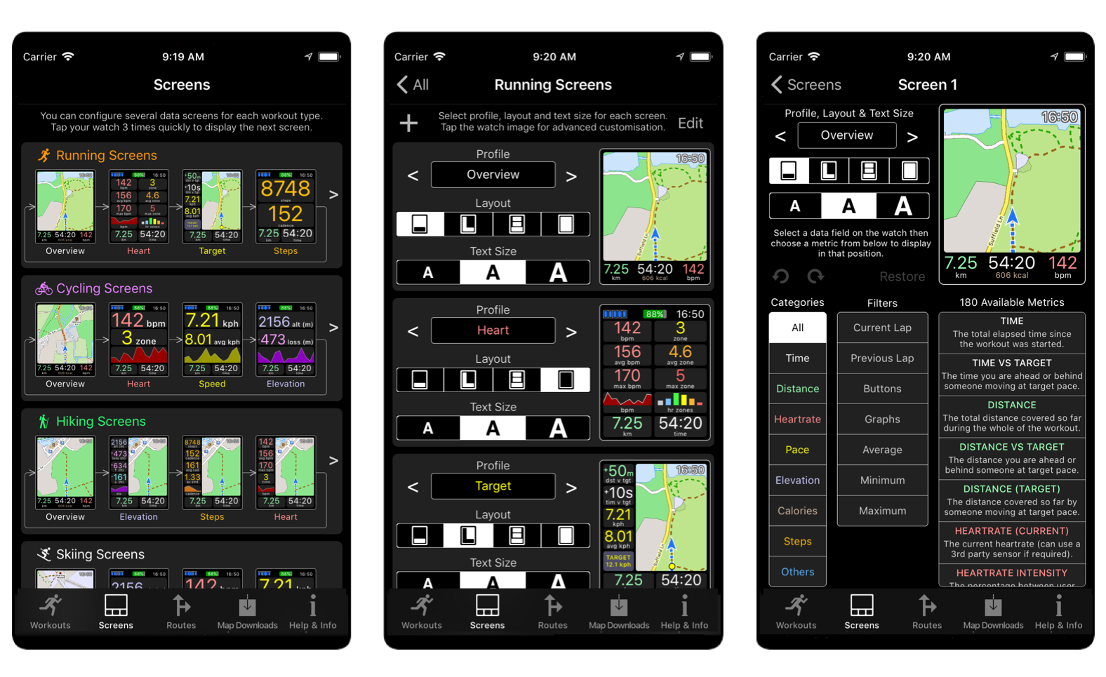

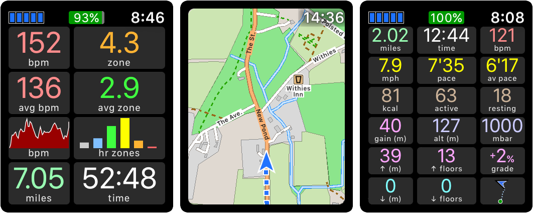

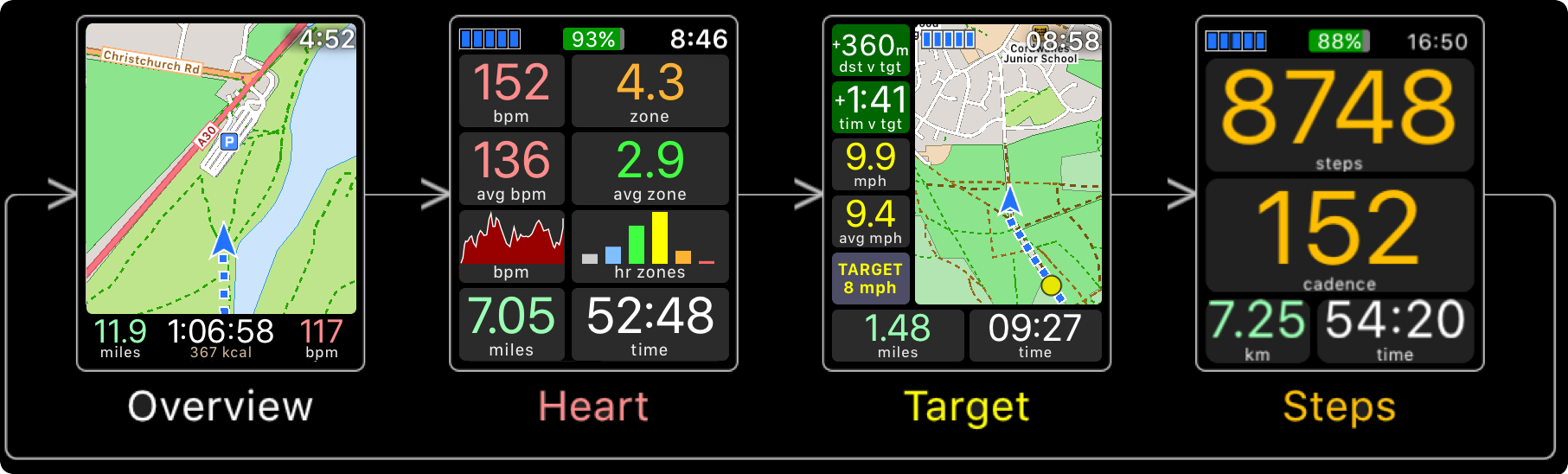

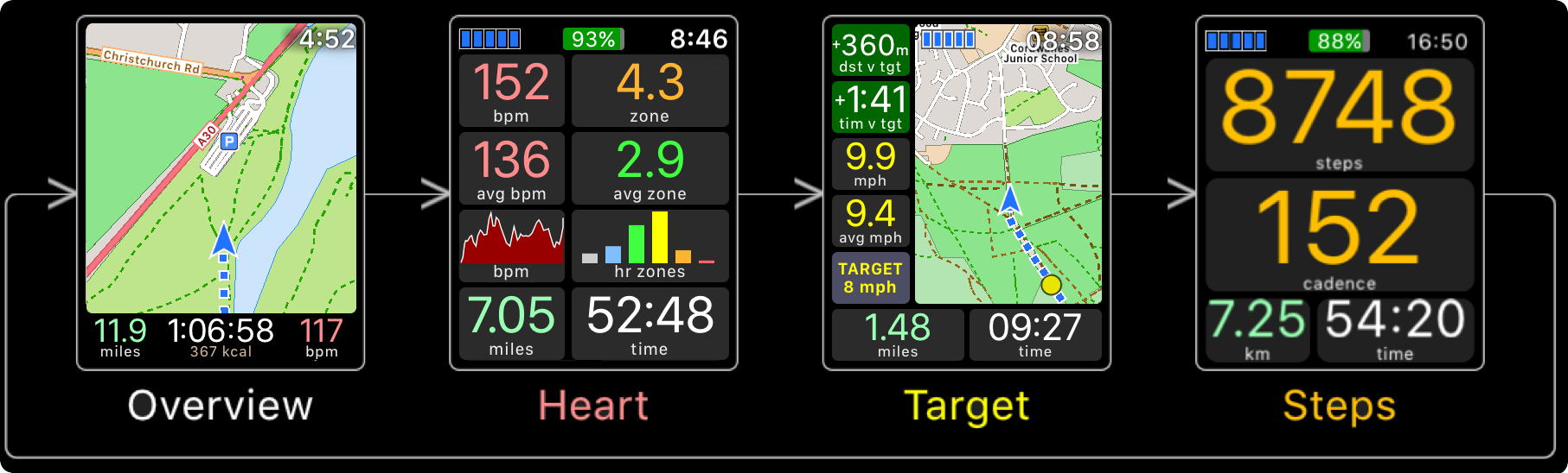

[doublepost=1535620569][/doublepost]Configurable Screens
Each activity type has a set of data screens that can be cycled through during a workout by triple tapping anywhere on the display. So for example the default running screens are as follows:
- Overview (data at the bottom)
- Heart Rate (grid layout with no map)
- Target Pace ('L' shape layout)
- Steps (Tower layout with 2 full width fields and 2 smaller ones at the bottom).
The screens can be easily modified on either the iPhone or the Watch. For example it is very easy to delete the Steps screen or change it to show Elevation information. Or to add a new screen showing the Activity Ring information.
If these screens are not quite what the user wants then they can be customised to show exactly the metrics they require from a pool of over 160 different live fields. These metrics include many types of graphs and charts. The customisation can be performed on either the iPhone or the Watch app.
The metrics also include buttons that provide shortcuts for various operations, including direct access to settings screens of interest. For example the Target screen has a button showing the target pace. If you touch that button for more than 1.5 seconds (to avoid accidental touches) then it displays the target pace settings screen, where you can quickly change the target pace. This is much faster than going via the Settings menu to find that screen.

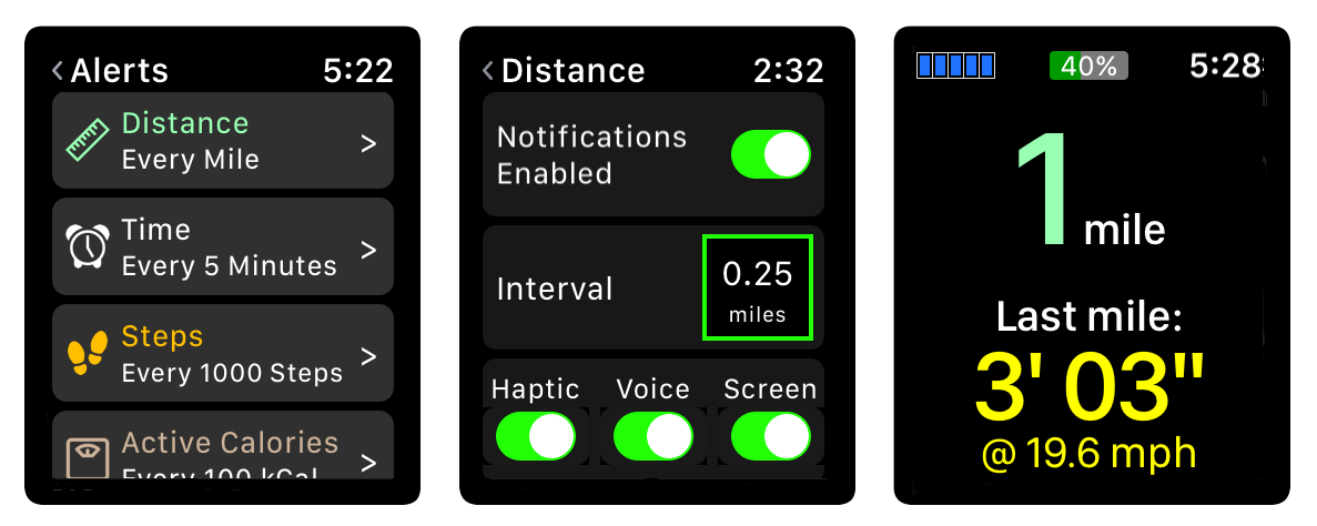

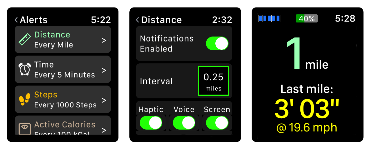

[doublepost=1535620633][/doublepost]Interval Alerts
You can now configure interval notifications for various properties, such as distance (e.g. every mile), time (e.g. every 5 minutes), steps (e.g. every 1000 steps), calories (e.g. every 100 calories), and distance ascended or descended (e.g. every 100m).View attachment 778646
In each case you can control the length of interval (e.g. every 0.25 miles instead of every mile) and also whether or not the notification includes haptics, voice feedback, or on-screen messages when you raise your wrist within a few seconds of the haptic/voice.

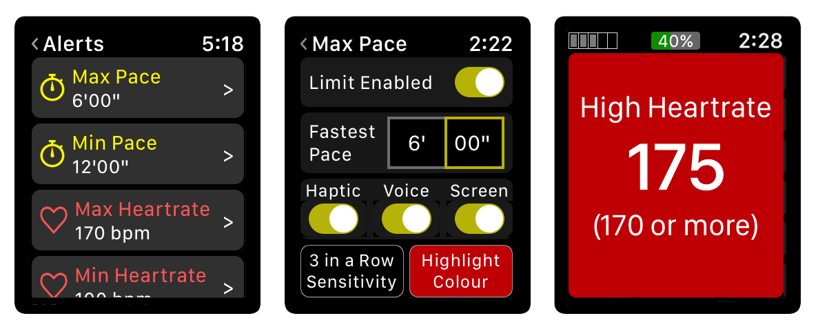

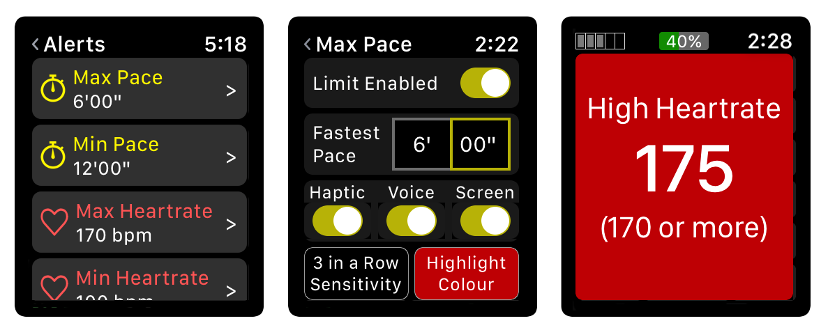

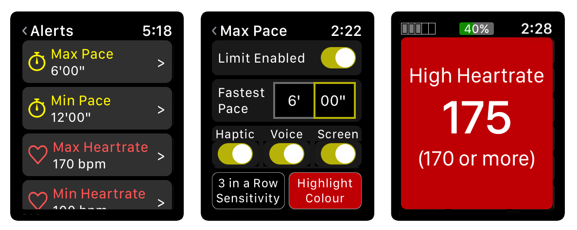

[doublepost=1535620697][/doublepost]Limit Alerts
You can also now configure maximum and/or minimum limits for various properties, such as pace, heartrate, cadence and speed. As with notifications you can control whether or not the limit alerts use haptics, voice feedback or on-screen messages.
You can control the sensitivity of each limit, in terms of how many consecutive breaches are required before the user is informed. For example if you have a maximum heartrate of 170 configured with a sensitivity requirement of 3 consecutive breaches then 169, 172, 171, 168 will not result in a notification, but 169, 172, 171, 175 will do. You will also get notifications when the property has returned below the limit (or above the limit for minimum limits).
You can also specify the colour that a property is displayed in when a limit is breached. By default these are red (hot) for maximum limits and blue (cold) for minimum limits. This is the background colour in the notification and also in the data fields, which makes it easy to spot limit breaches amongst other data fields.

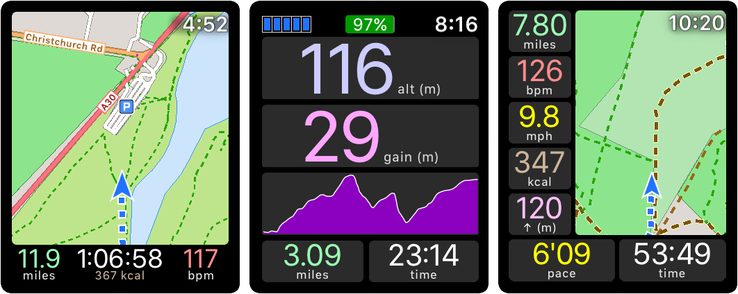

[doublepost=1535620774][/doublepost]Target Pace
The app now has the ability to set a target pace or speed. The user can then display fields such as the time or distance that you are ahead or behind someone who is moving at the target pace. When you are ahead of the target pace then the fields are shown in green, and when you are behind then they are shown in red. Both of these colours are configurable.
You can also display a yellow circle on the map, indicating whereabouts you or a competitor would be if running at that target pace. By default the yellow dot is shown only if you are viewing a screen configured with the "Target" profile. This is considered Auto mode. The Target Pace settings screen also allows you to switch the dot off, or make it always visible for any profile.
When in auto-rotate mode the GPS location arrow is positioned towards the bottom of the screen to show more of the map ahead of you. However if the target pace dot is displayed and the target is behind you, then the blue arrow will be positioned further up in order to show the chasing target. It will never be displayed higher than the centre of the screen.
I have found this much more useful than I expected. There is something about watching a dot catching you up or moving away that is much more effective as a motivator than just seeing the numbers for the distance or time difference.

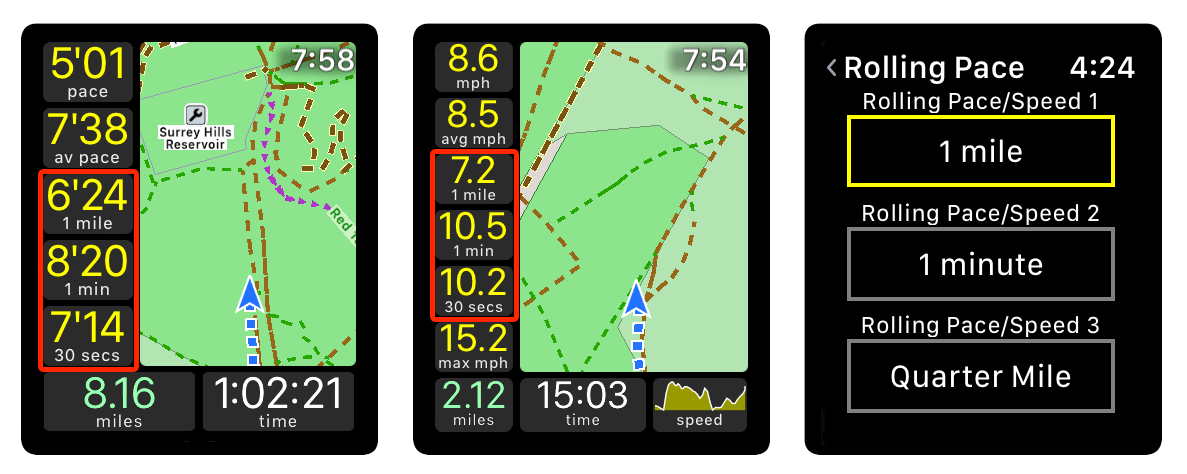

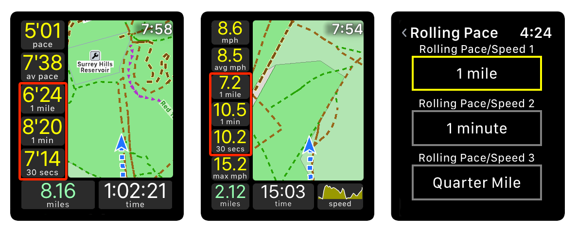

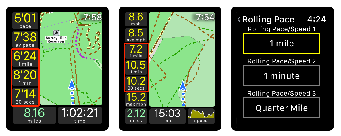

[doublepost=1535620848][/doublepost]Rolling Pace
There are three new Rolling Pace and three new Rolling Speed fields. You can configure the periods for each of the fields in the Rolling Pace settings, which are under the Workout settings. These periods can be either time or distance and default to 1 mile / 1 km; 1 minute; and 0.25 miles / 0.25 km.
View attachment 778649 Generally the longer the period then the more accurate the value, whereas the shorter the period then the more responsive it is to speed changes.
These fields were added when I saw that Apple had included Rolling Mile Pace in the Workout app in watchOS 5, but I figured it would be handy to choose the period. There are 3 fields so that users can compare 3 different periods and decide which one is the best for them.

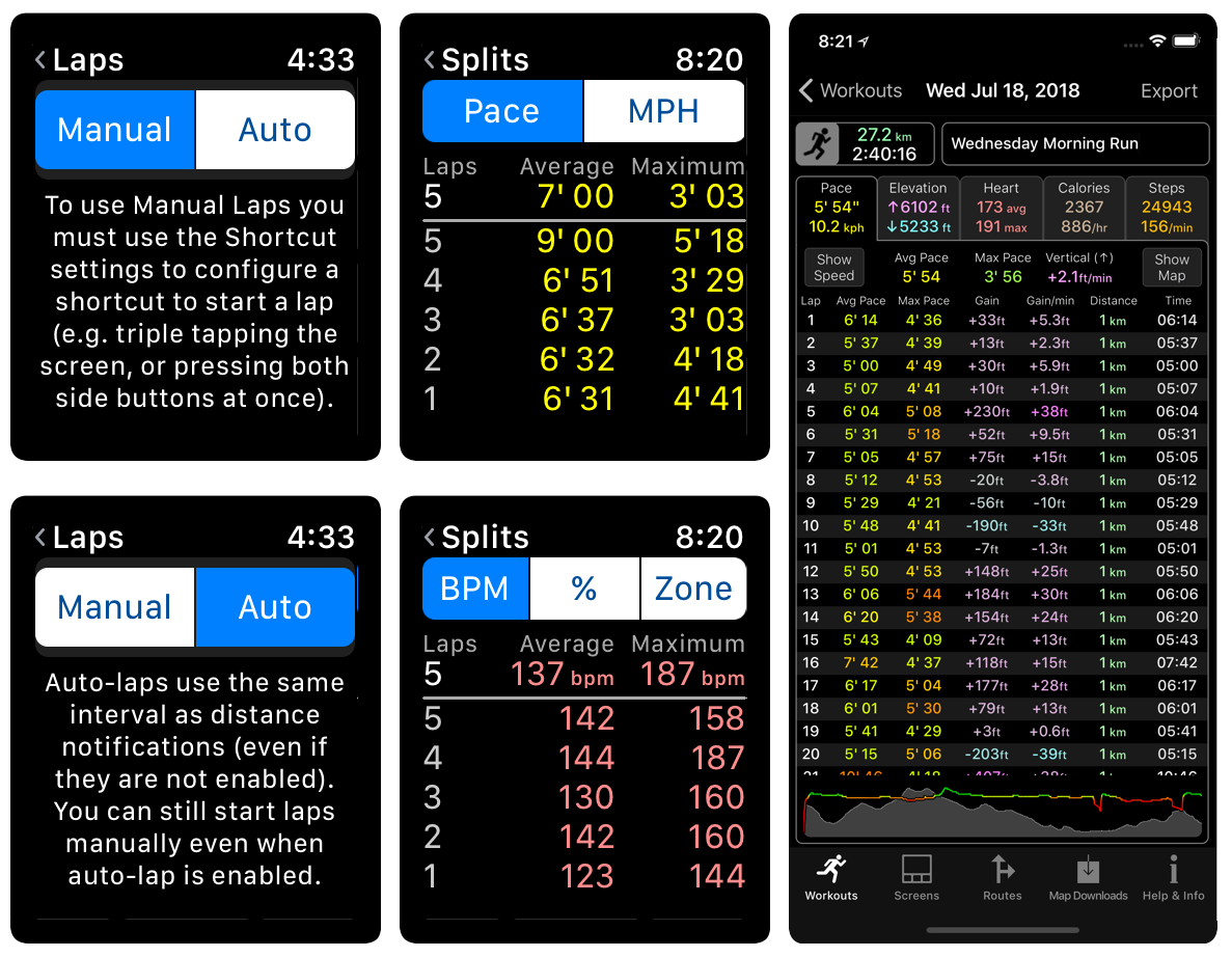

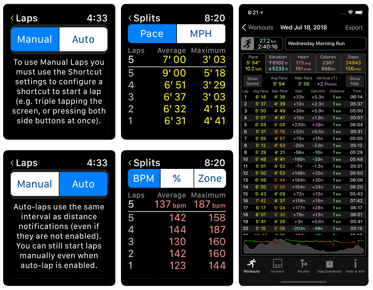

[doublepost=1535620905][/doublepost]Laps
The app now supports both manual and automatic laps. By default laps are automatic and use the same interval as distance notifications (which default to 1 mile or 1 kilometre). There is a "Laps" option in the Workout menu of the Settings that allows you to choose between Manual or Auto laps. If you select manual laps then you should configure a shortcut (for example pressing both side buttons) to start a new lap. Although if necessary then you could include a "new lap" button on the screen.
There are many metrics for laps. Practically every metric that covers a time period will also have versions for the current lap and for the previous lap. For example there are average pace metrics for the whole workout, for the current lap, and for the previous lap.
Lap splits can be shown on the watch at any time during the workout by force pressing and selecting Info. This shows a summary screen and a "Pace Splits" button. If you tap a different field on the summary screen (e.g. heart rate) then the button changes to show a "Heart Splits" button. This is explained in more detail in the Watch Analytics section.
The iPhone app allows extensive analysis of lap splits for many different fields, as explained in the iPhone Analytics section.

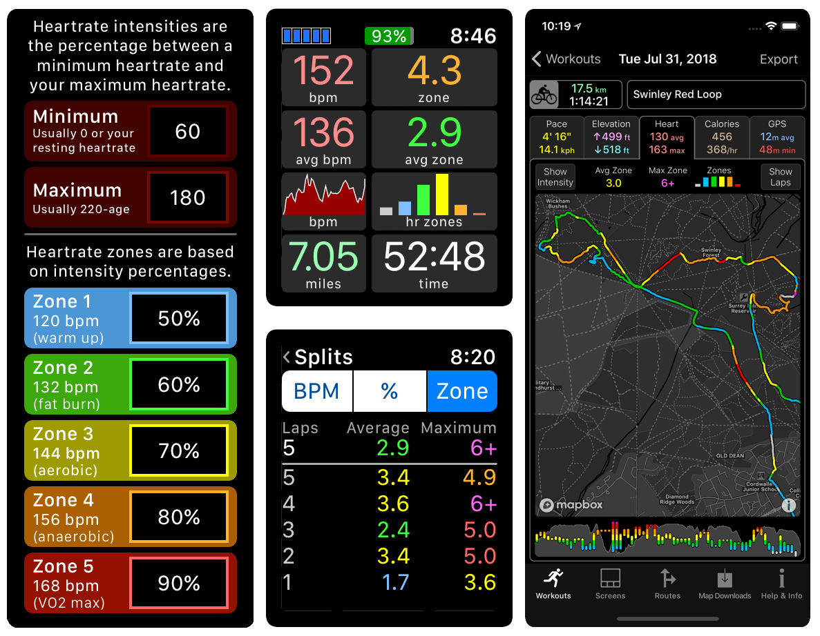

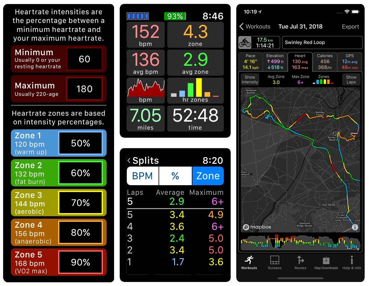

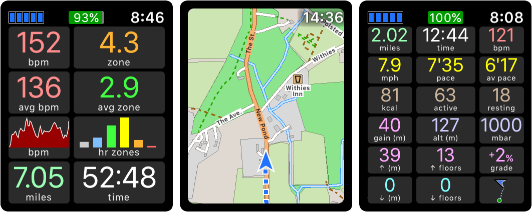

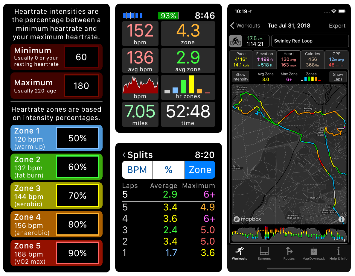

[doublepost=1535620972][/doublepost]Heart Rate Zones
The new version has two new ways of representing heart rate: intensity and zone. All heart rate values can now be displayed as bpm, intensity or zone.
Intensity is the percentage between configurable minimum and maximum heart rates. These default to 0 and 180, but can be changed by the user on either the iPhone or the watch. For example the maximum is often set to 220 minus the user's age, and the minimum could be changed to the user's resting heart rate if they prefer.
Heart rate zones are based on intensities. The idea is that the body is doing different things in each zone. For example zone 2 is considered the best for burning fat; zone 3 is the best for improving aerobic endurance and zone 4 is for anaerobic endurance. By default zone 0 is below 50%; zone 1 is between 50% and 60%; zone 2 is between 60% and 70% etc. However these values can also be configured by the user.
There are also new fields showing the percentage of the workout (or current lap or previous lap) in each zone. For example if you are interested in weight loss then you would be aiming to have a high percentage in zone 2, whereas if you wanted to improve your aerobic fitness then zone 3 would be better. These percentages can be shown as numbers, or as a bar chart showing the amount of time spent in each zone.

Sorry that you lost your settings when upgrading the phone. In theory watchOS should preserve them but sometimes it doesn't. In the future if it doesn't preserve them then change a screen setting on the phone and it should send all the screen configurations to the watch.
To get the voice alerts again press the watch screen hard and tap Settings and then Alerts. If you are not running a workout then select the workout type (e.g. Running). Then tap Distance and switch the "Voice" setting on. Please let me know if that does not work. In the next version you will be able to specify exactly which metrics are spoken on each notification.

Great app but I think I encountered a couple of bugs with alerts. I turned on a pace alert for min speed for Hiking:
1. With voice turned on the alert came thru the AW speaker not my AirPods (music was playing).
2. After about 15 minutes into the hike, every time I received a pace alert it would just pause the music and there was no voice alert just the screen and haptic alerts. The first time this happened it also seemed to disconnect the AirPods and I had to reconnect them. After that it just paused the music but the AirPods stayed connected.
Reactions: cfc
There is a bug in the current version where music can go quieter after the first alert. This will be fixed in the next version. I haven’t heard of those other issues but it could be that the bug fix will solve them.
The next version of the app will have lots of new voice alert features. So I am currently rewriting that part of the app, which could also help.

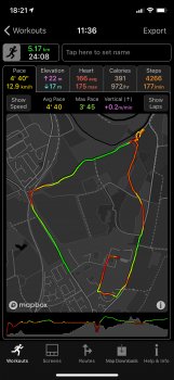

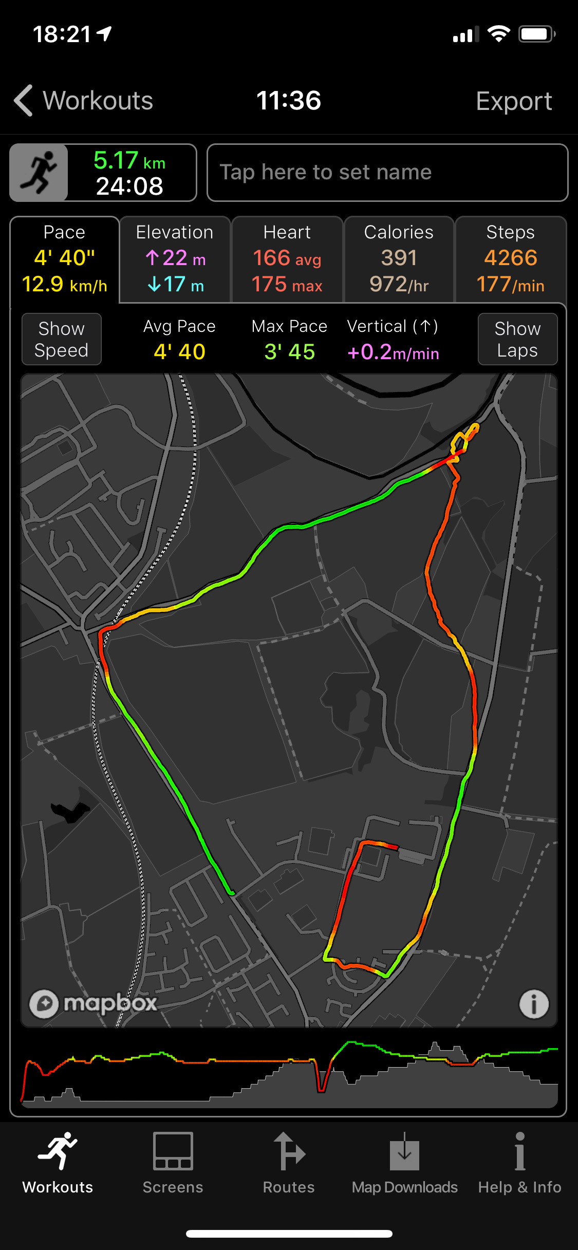

Last question (This one for @cfc). I did my first run with WoD today. It seemed to have a wobble a couple of km in. You can see on the right-hand side of the screenshot that I was running along a road (green), and then it seems to take me left through a field (the red part). In reality, I continued along the road until I got to the junction at the top (approx where it's going a little crazy - which didn't happen). I've done this run a lot of times using the default app and it's never done this. Was this just unlucky? Does WoD have any control over this, or do apps just get the GPS data from the Watch and don't get much say in the data itself?
Reactions: cfc
So I finally decided to buy this app. I don't normally spend money on apps which replicate existing functions, and if I do, I tend to stick to 99p or so. What convinced me to do it is @cfc being so active on this forum, and adding features, responding to requests etc. That kind of dedication should be rewarded.
My first impression was holy customisation batman. This app has options for everything. It also seems to do things by default that more 'professional' apps seem to be unable to do. For example, the Strava app does not draw the map in the Apple Activity app. WorkOutDoors does. So that's nice - I can use WorkOutDoors and don't appear to lose any functionality from other applications.
I do have a couple of questions. I'm currently using HealthFit to export my runs to Strava. It was already setup as I was using the Apple Workout app before. WorkOutDoors provides the ability to login to Strava to export. Is there functionally any difference in doing this compared to what HealthFit does? Does WoD export more details, or are these basically the same thing? If they do the same thing then I'll leave it, as HealthFit is currently setup and working.
Second question: Maybe not completely app related, but you guys will know. What's the best way of plotting a route and exporting to GPX on iPhone? I have an app called Footpath which is nice. Has maps, can draw on them export the GPX. But when imported to WoD, it says the GPX has no elevation data. Footpath does have elevation data but apparently doesn't include it in the GPX. Are there similar apps for drawing a route and exporting, including elevation data?
Many thanks for buying the app. I am glad that you like it. To answer your questions:
The data exported by the app to Strava is actually slightly different to that exported by HealthFit. This is because the app currently sends a GPX file to Strava whereas HealthFIT sends a FIT file. In most situations they will be about the same, but a GPX file just contains a route and cannot contain distances, so Strava has to calculate the distances from the route. If the GPS was poor then the HealthFit version could be more accurate, but if the watch pedometer was poorly calibrated and the GPS was good then the WorkOutDoors version could be more accurate.
The next version of the app will allow you to export to Strava using either GPX or TCX files (which can contain distances), so you can choose what to send to Strava. I hope that makes some sense? In conclusion I would stick with using HealthFit to send the data to Strava if you already have it set up and working, but it's your choice,
I can't recommend any GPX creation tools so would also be happy to hear any suggestions. A GPX file without elevations will still work fine but the route will be shown all in the same purple colour instead of using different shades of purple to indicate the gradient (from red for steep uphill sections through to blue for steep downhill).
I would guess that your "wobble" was just unlucky and simply poor GPS. As you guess apps don't have any real control over GPS signals. They simply request them and receive the updates back. They can specify an accuracy but WorkOutDoors requests the highest accuracy that it should do.
Having said that Apple offer an extra high accuracy which they describe as requiring the device to have an external power source in order to use. The current version of the app does not use this (because it shouldn't really) but the next version will have an option to switch to it if you want.
I have no idea if this will actually affect the accuracy on the watch but I figured that I would offer it anyway. It is probably designed for iPhones doing car navigation when they are plugged in to a car charger and could make no difference for a watch. It could also degrade battery time, which is why it will just be an option and not the default.
You can check if the wobble was GPS related by tapping the Steps tab and then "Show GPS". This colours the route according to the GPS strength using the same colour scheme as the signal bars in the watch app (blue is good, grey is poor, red is bad). So you can check what the signal strength was like at that point. If it is grey or red then the GPS signal strength was probably the cause.
Also if you swipe your finger along the profile at the bottom then all the figures (including the GPS strength) change to show their values at the position you are touching on the profile. This allows you to see the exact GPS signal strength in metres at any point on the route.
