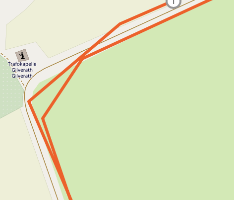

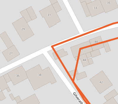

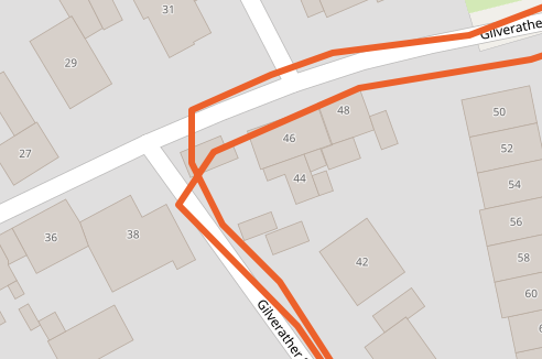

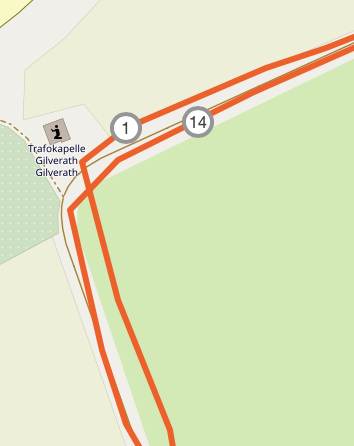

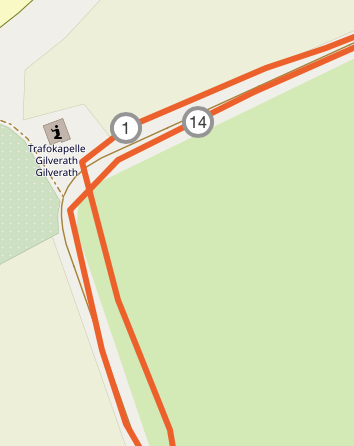

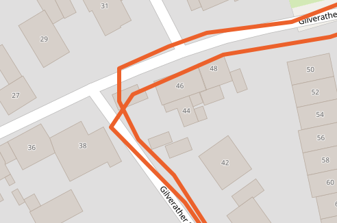

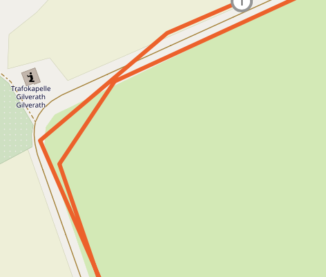

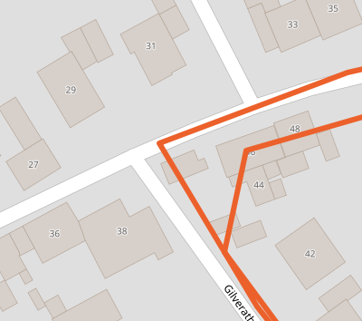

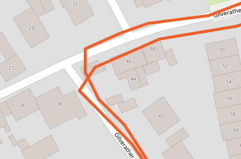

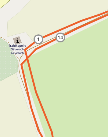

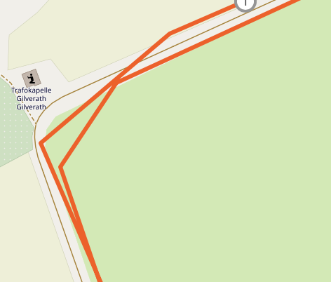

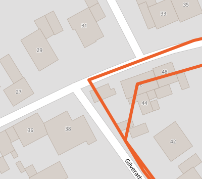

Sure. Screenshots from runalyze in highest zoom level.
WOD previous version:
WOD latest version:
WOD latest version:

Yes, as I am using a Stryd, I also export FIT files now. Not to Strava though. The Screenshots are from runalyze, as I wrote.
And sure, @cfc said, the new version has more data points. If they are also in the TCX files, I don’t know and care.
But don’t understand your point, sorry. Why should I switch back to a slightly worse result?
It doesn't matter whether Strava or Runalyze. In both cases the routes look bad
The displayed routes are the raw data. As I say, smoothed data looks nicer but won't affect the distance and pace because the receiving system is probably smoothing the data to calculate them, even if it is not smoothing it to look nicer on the map. This is what Strava does for sure.
Most devices (i.e. smart watches) that send workouts to Strava etc have a tiny fraction of the processing power and battery size of an iPhone, so they probably send raw GPS data, just like WOD does.
I may offer some smoothing capability in the future, if only for cosmetic reasons, but it is currently not high priority.

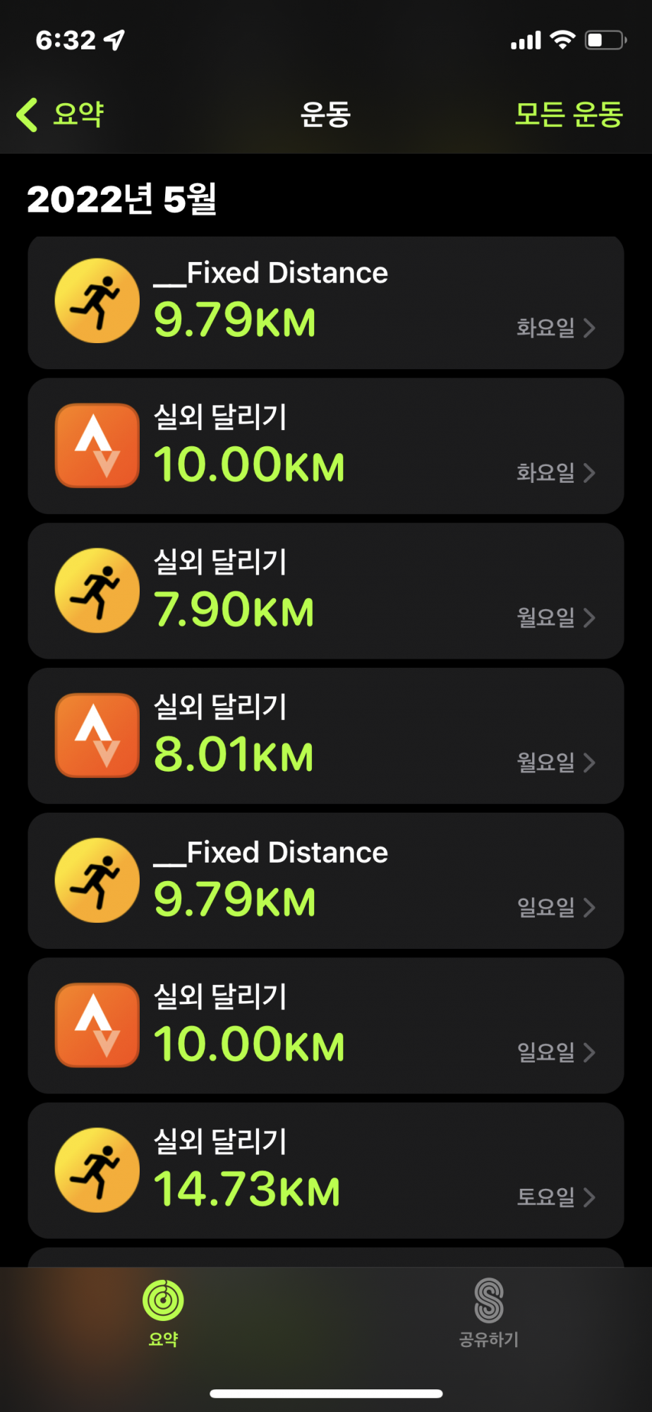

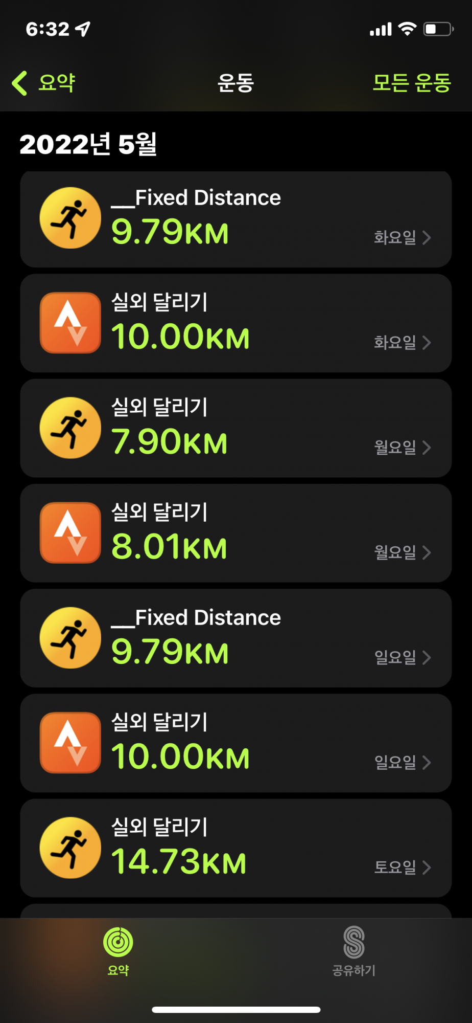

Now I'm using the updated WOD.
There is no change in the distance recorded in the WOD and strava since the update, but the exercise record displayed in the fitness app on the iPhone is marked fixed distance and is displayed shorter than the distance measured in the WOD.
Which distance is the right one?
Is WOD configured to show GPS distances or Apple's calibrated distances?

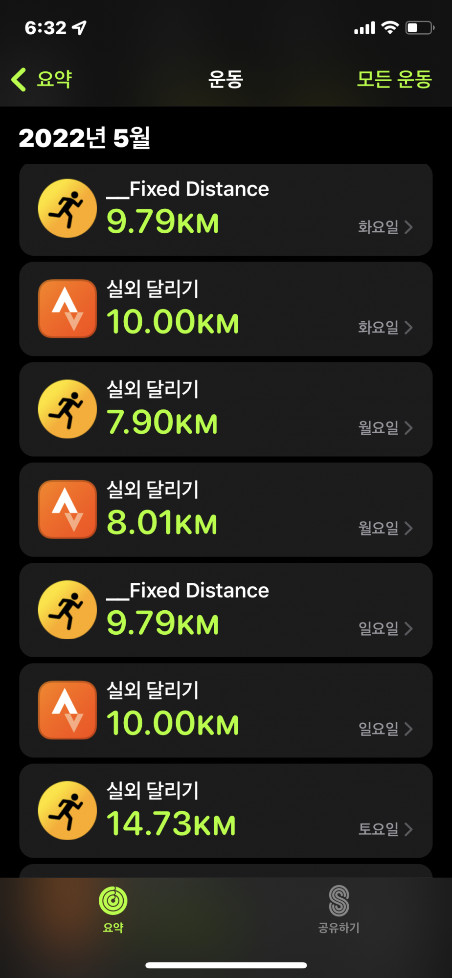

The exercise recorded as fixed distance proceeded distance & average face source with apple. I changed it to gps now. I don't remember what settings I used before the update.

I feel the same symptoms. For example, if you run 10 kilometers, you will be recorded in the iPhone fitness app for 9.8 kilometers or shorter. Which is the more accurate distance?
Apple's fitness app always uses Apple's calibrated distances, even when WOD is using GPS, so WOD will show that you have done 10km according to the GPS (and will send this to Strava etc), but Apple will still show their calibrated distance.
Which is more accurate depends on whether the watch was well calibrated and how strong the GPS signal was.
Reactions: Duffman19
Thank you for the explanation. I hope the distance measured by the WOD is more accurate. I trust my AW7 because I worked out with Garmin user and recorded the same distance as Garmin, but I am very concerned about the distance correction of FITNESS app.
