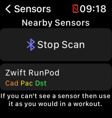

I think I may be able to replicate this:
1) unpair the sensor on the watch,
2) then disable bluetooth,
3) and scan for sensors on the watch, which finds the foot pod - presumably via the watch (connected via wifi?) - since watch bluetooth is off.
4) starting a run fails to find the foot pod, since bluetooth is off
5) once watch bluetooth is turned back on it finds the sensor and starts the activity - but now flashes up connection messages in the footer and shows erratic data with the logs full of the same sensor messages (initialising and connecting over and over).
unpairing and repairing doesn't seem to fix the issue, but terminating WOD and restarting it does seem to work (doesn't need a watchOS restart).
does this suggest some conflict between how the sensor is paired, ie: directly with the watch, or via the phone ?

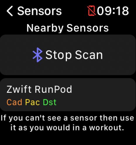

The iPhone app uses the iPhone Bluetooth and the watch app uses the watch Bluetooth. So the watch Bluetooth is always used during a workout.
So did this happen when you were switching Bluetooth on during the sensor connection screen at the start? I haven't checked that. Does it work correctly when Bluetooth is switched on before starting a workout?

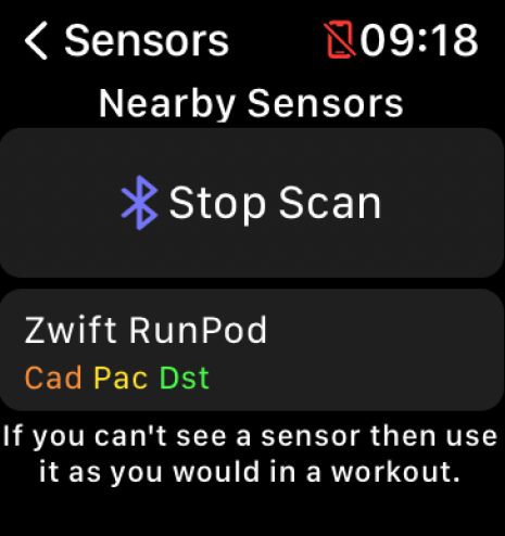

I don't know how this issue initially arose - but the steps above show that you can scan for sensors on the watch even when watch bluetooth is off - and pair the sensor for an activity type - as seen here (phone says disconnected, since bluetooth is off on the watch - but sensor still found?)
With watch bluetooth on again, the erratic sensor behaviour now continues until WOD is terminated and restarted
How does the watch find the sensor when bluetooth is off - is it using the phone via wifi ? or does it temporarily re-enable bluetooth when scanning is requested ?
The app remembers what sensors are nearby. They are only shown there so you can decide whether you want to pair with them, and pairing does not require Bluetooth to be on, because it just tells the app to remember the sensor.
Part of the reason for this is because of a limitation of Bluetooth on watchOS where any devices will disconnect when you lower your wrist, so the app needs to reconnect again when you raise it. This would mean the device would disappear every time you hadn't interacted with the app for a few seconds and then take a few seconds to reappear.
This disconnection limitation does not exist when the watch is running a workout, but that isn't the case when scanning and pairing. Also from what I have read it seems to not be a limitation with watchOS 9, so I may change the way things work when that is released.

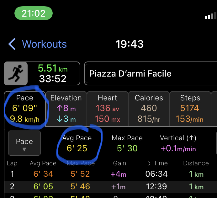

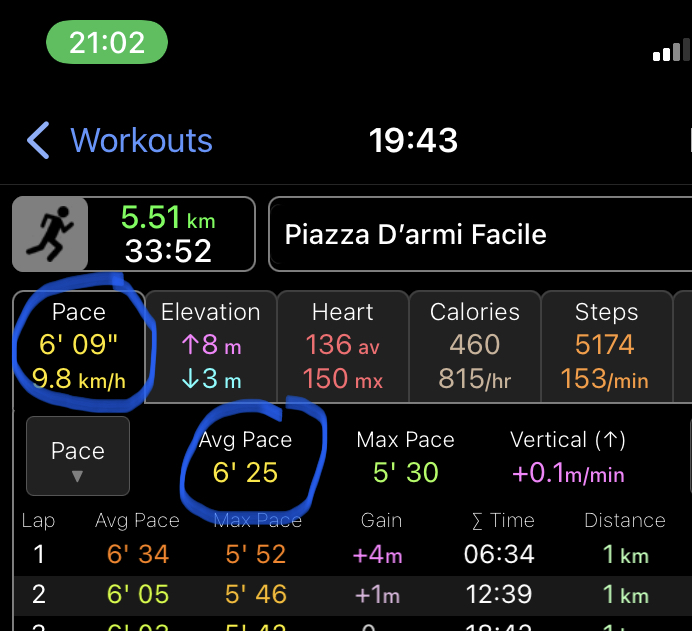

Hi Ian, first at all congrats for the wonderful app!
In the last few runs I have noticed that the two avg pace metrics displayed in the app are different.
Nothing problematic but I'm wondering why, can it be the stryd pod?

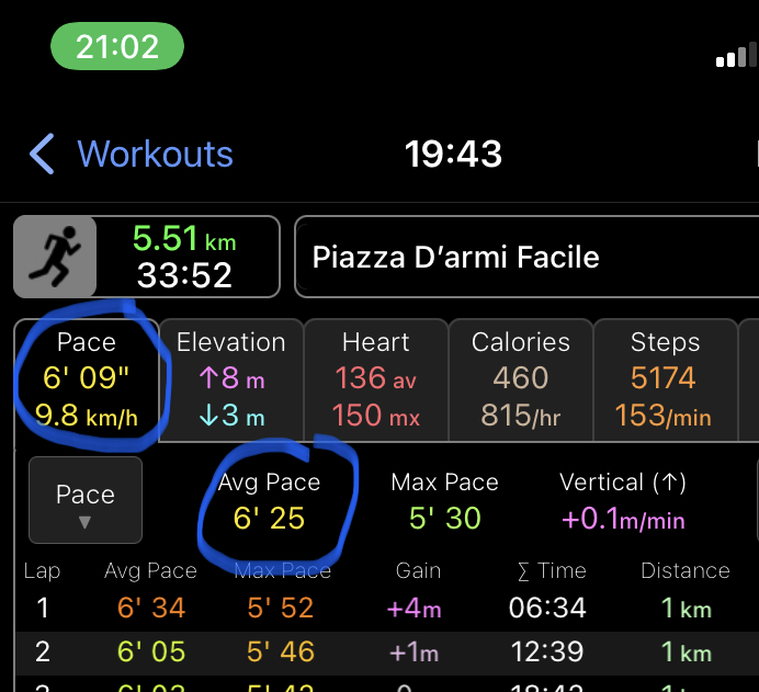

I have seen this recently and should know the answer but can't remember so please could you send the wkt file for this workout to info@workoutdoors.net and I will take a look. To do this tap the Export button 3 times quickly.

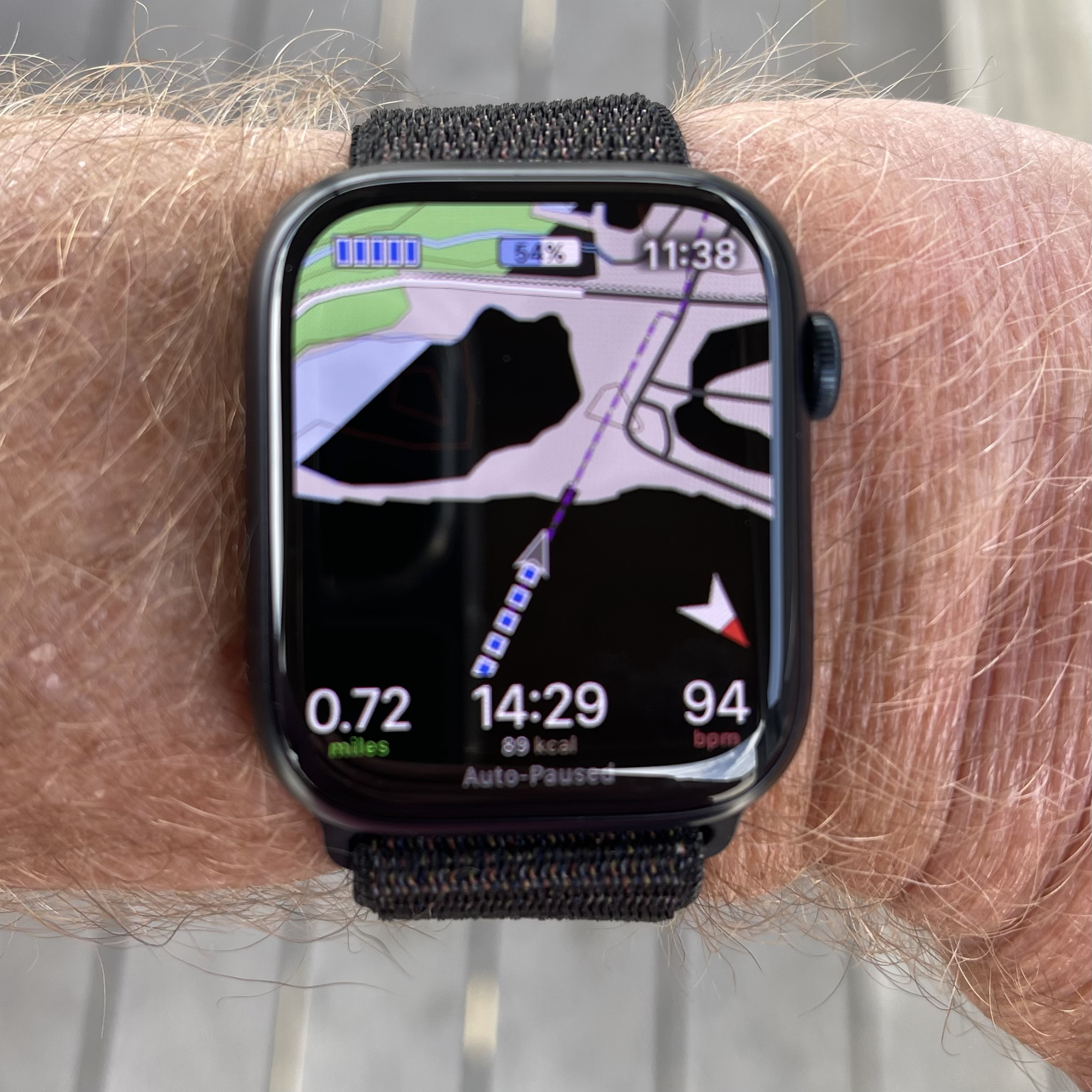

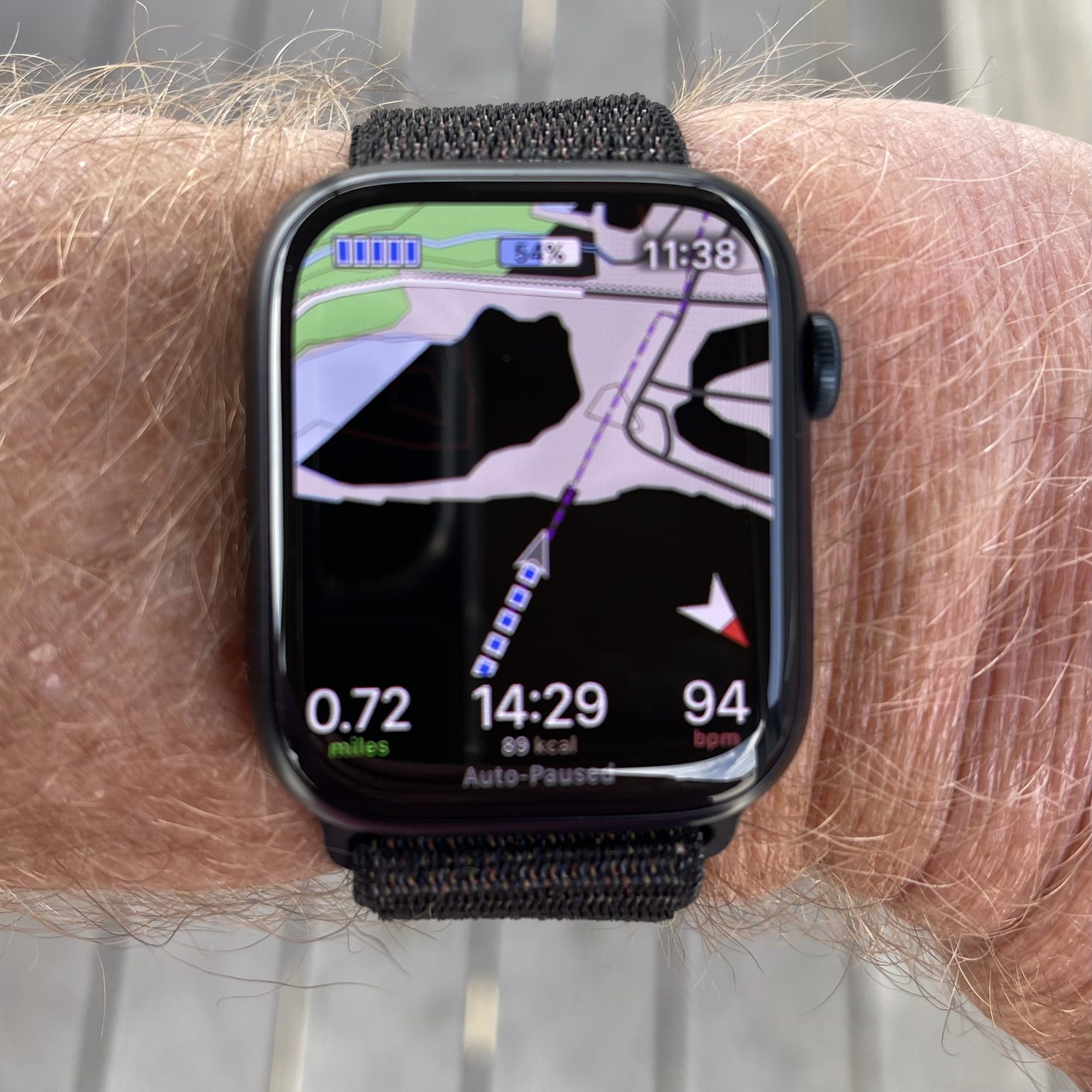

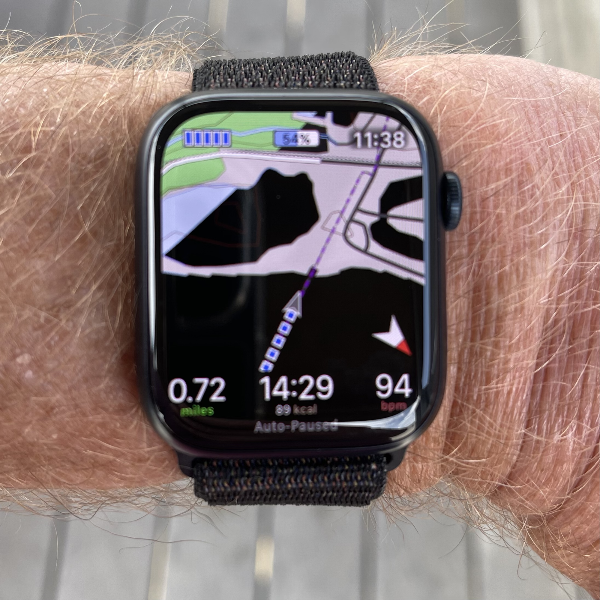

Is anyone else seeing dark colors occasionally in the maps? 2 weeks ago I downloaded offline maps for our campground and 50% of the walks had this problem. I'm also seeing this often with maps that aren't downloaded on walks and hikes. I've cleared my watch map cache but that doesn't help.
I just had it happen on this hike. Weird thing is after my workout was done, I went into map-only mode and everything was fine. I have all of my maps set to the default settings, so they should be light. I'm using Thunderforest maps.
That is odd. I have seen it before but very rarely. Does it go away if you zoom out and in again?
Once during a hike recently the entire map went into a dark mode. I fiddled around with the map a little, perhaps including zooming in and out, and the map changed back to the normal light mode. I have only seen that the one time.
Reactions: cfc

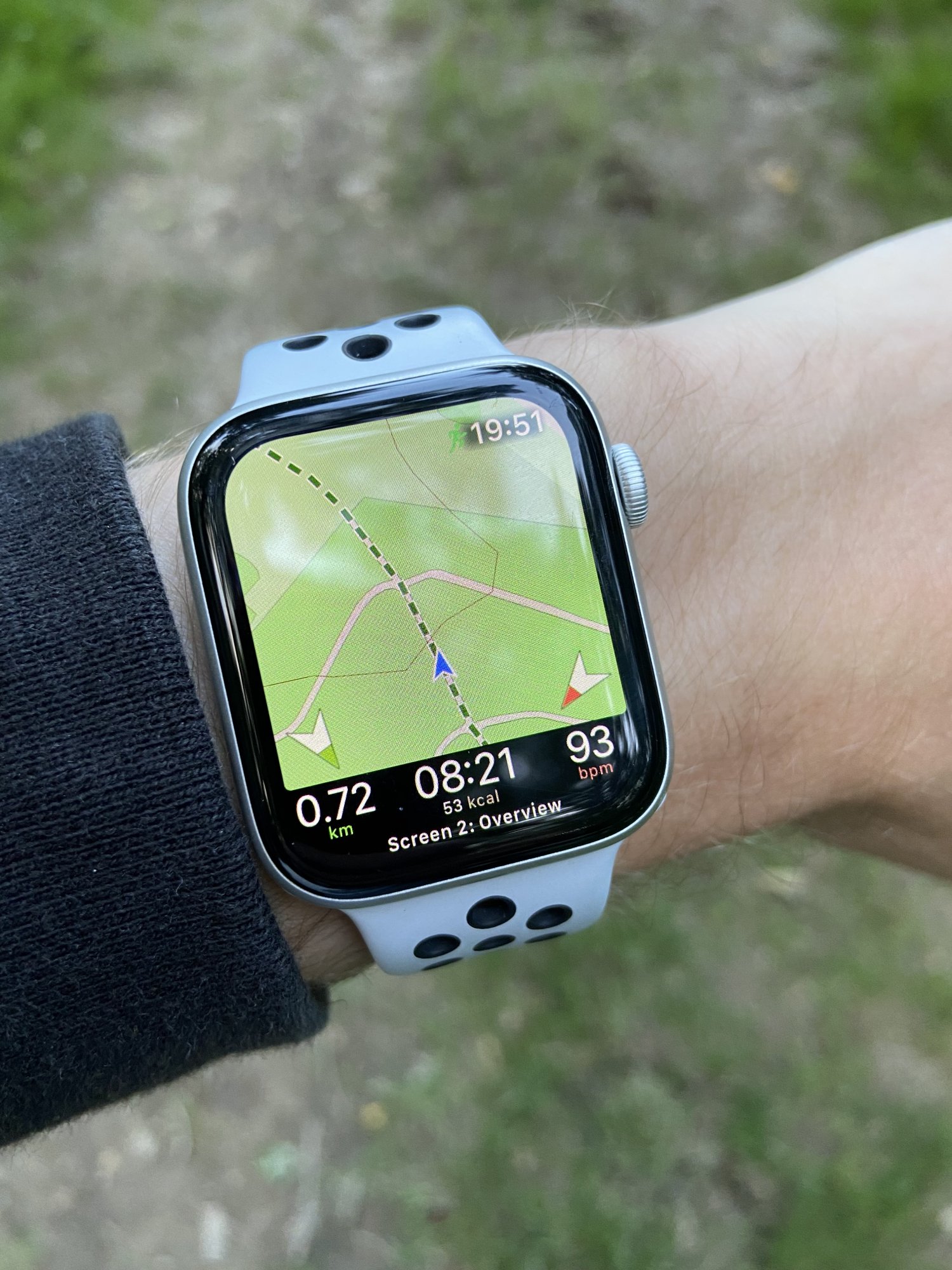

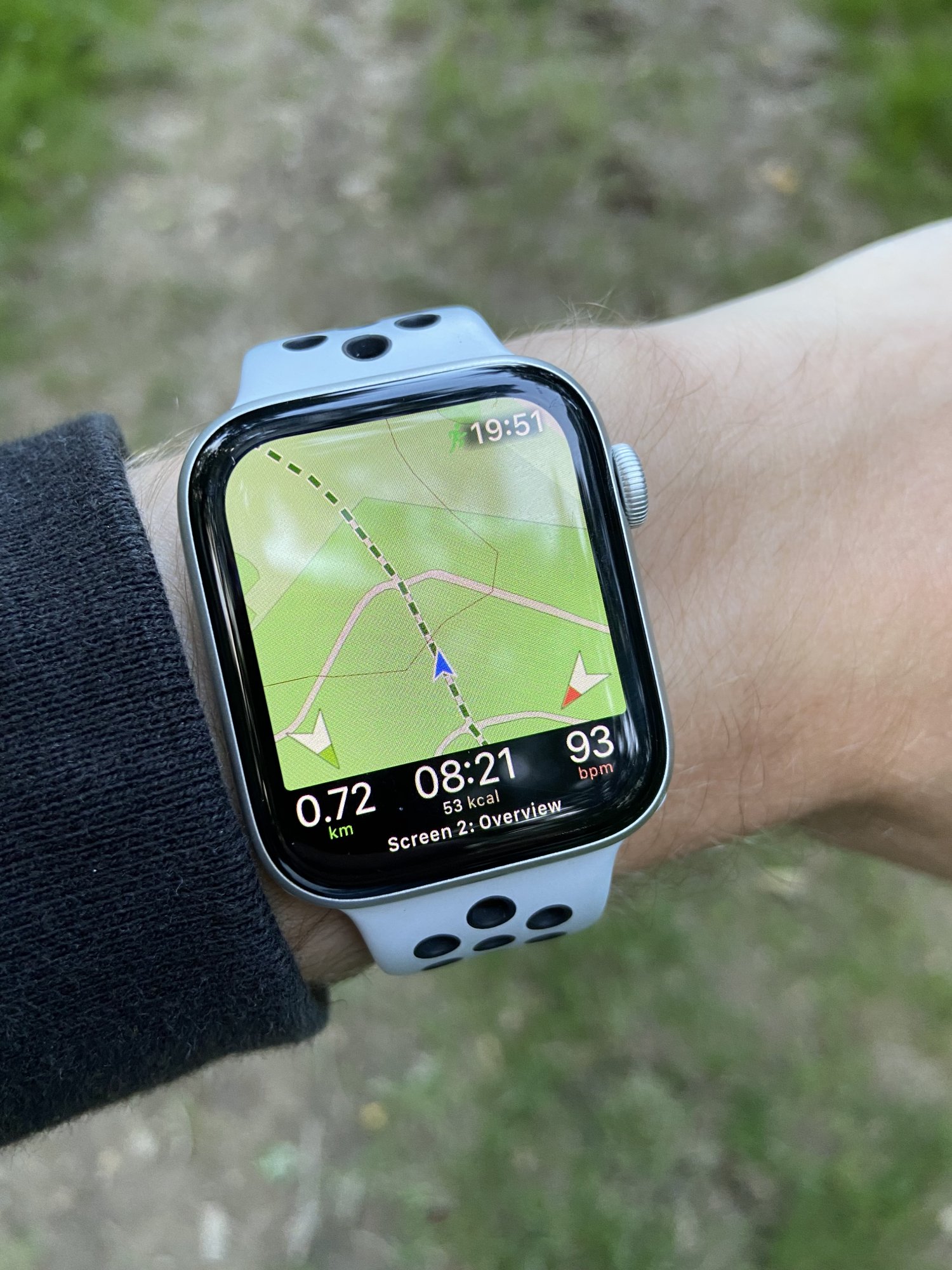

Hey @cfc breadcrumbs on maps don’t appear to be working for me. A bug or something I’ve done wrong?
A couple of people have mentioned that. I couldn’t reproduce it but have found and fixed what may have caused it.
This fix is in the bug-fix beta if you want to try it?
Reactions: NME42
Thanks. Will give the beta a go today.
Version 4.4 (39)?
