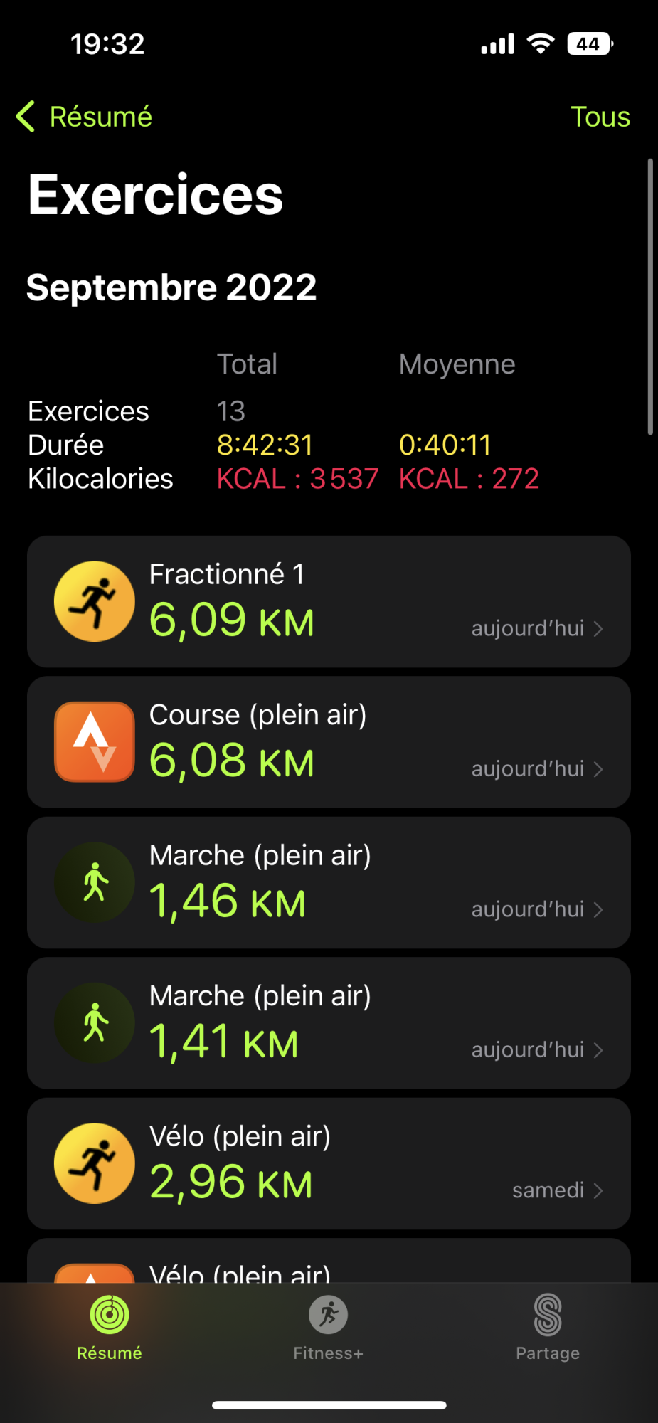

Thanks CFC I try the schedule this evening and it works wonderfully.
I have a question for the community, not only CFC, you should be busy to answer so many time on this thread 😅
I upload my workout on Strava by your option, at the end of workout.
But now I have 2 workouts on Health app, does it count twice ?
watched this very positive review for WOD, which went along way to converting a AWU sceptic
That was an excellent video to watch and very positive about the app (although my favourite part was the lovely dog!). It was probably the best video on the app that I have seen because he covered so many of the features, and was very knowledgable and enthusiastic about them all.
Thanks for the heads up!

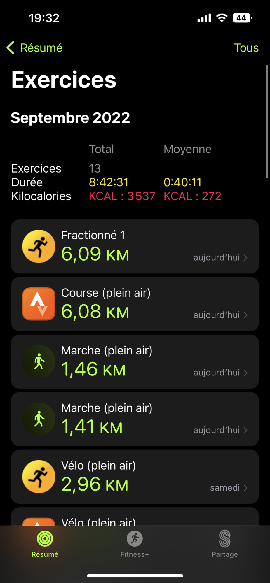

Glad that the interval session went so well. I think the Strava app has an option to automatically save workouts to Apple's health system, so you need to disable that. Otherwise WOD saves it in the health system and sends it to Strava who then send it to their app, which also saves it in the health system.

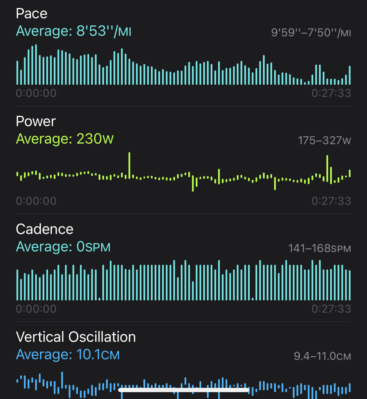

Hi @cfc , I've noticed an issue when I use WOD for an outdoor run where it doesn't seem to show my average cadence properly when I'm looking at the information after the fact in the Fitness app on my phone. It seems to be tracking the information correctly and I've double checked my permissions but for some reason it keeps showing my average as 0 as seen in screenshot below. Have you come across this before? This doesn't happen when I use the native app.
very nice thread!
Quick question - If i am using a stryd pod and I start a workout in WO does it show me my power metrics?
Someone else mentioned that. I assume that it is a bug in the Fitness app for third party apps, because it clearly has the cadence data because that is shown in the graph. So it should be able to calculate an average.
The average is not specifically stored in the health system as far as I know. It is just a series of data "samples", which are visible in the graph, so the Fitness app should be able to calculate the average from them.
