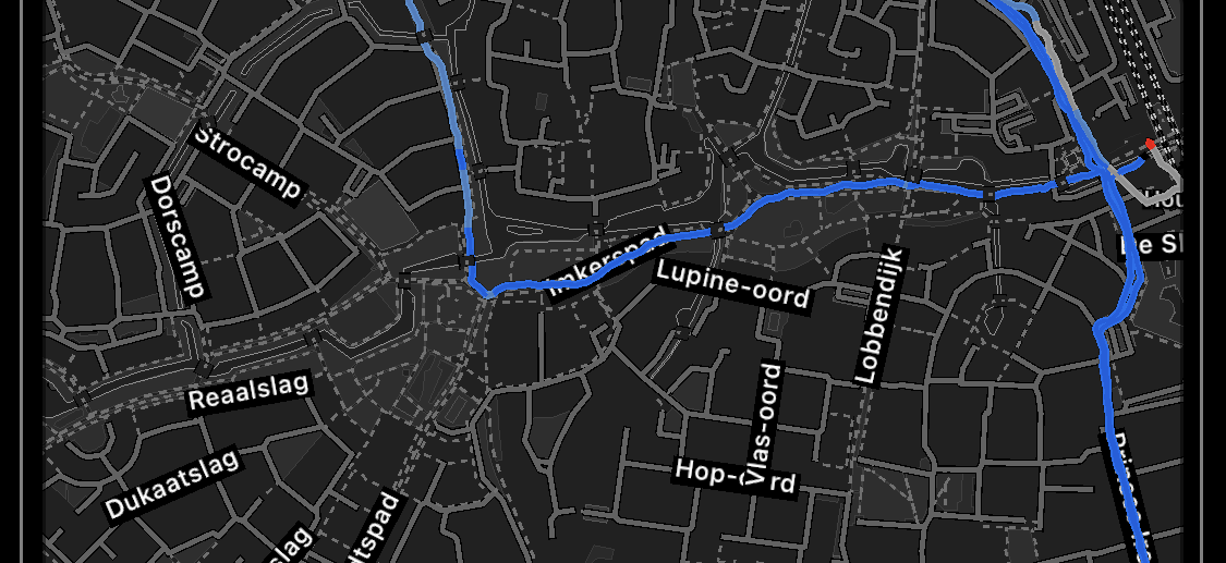

I live in the Netherlands, which is famous for it's cycling paths (amongst other things).
The village where I live is even famous within our country for the cycling paths, so we have a lot of them and they are really good. :)
Today I started an "other outdoor" exercise and cycled around for just over 30 minutes with a moderate speed (18.0km/h avg). When I looked in the WOD app on my phone to my route, I noticed a few short gaps. And when I looked closed, nearly all gaps were at the small bridges where the cycling path crosses water. Those bridges are nearly flat and they only have small railings along the sides, nothing that could disturb gps. One of the bridges where I say this was not even crossing water, it crossed a road (for cars).
Even more strange, it did not happen when I went through a small tunnel.
Around all bridges that had the gaps in the route, the GPS line color is blue (not gray).
I guess it's not GPS causing the gaps, but then what else does cause them?

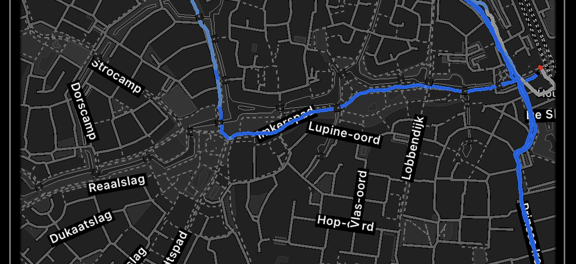

Please email the wkt file for the workout to me at info@workoutdoors.net and I will take a look. To do this tap the Export button 3 times quickly.

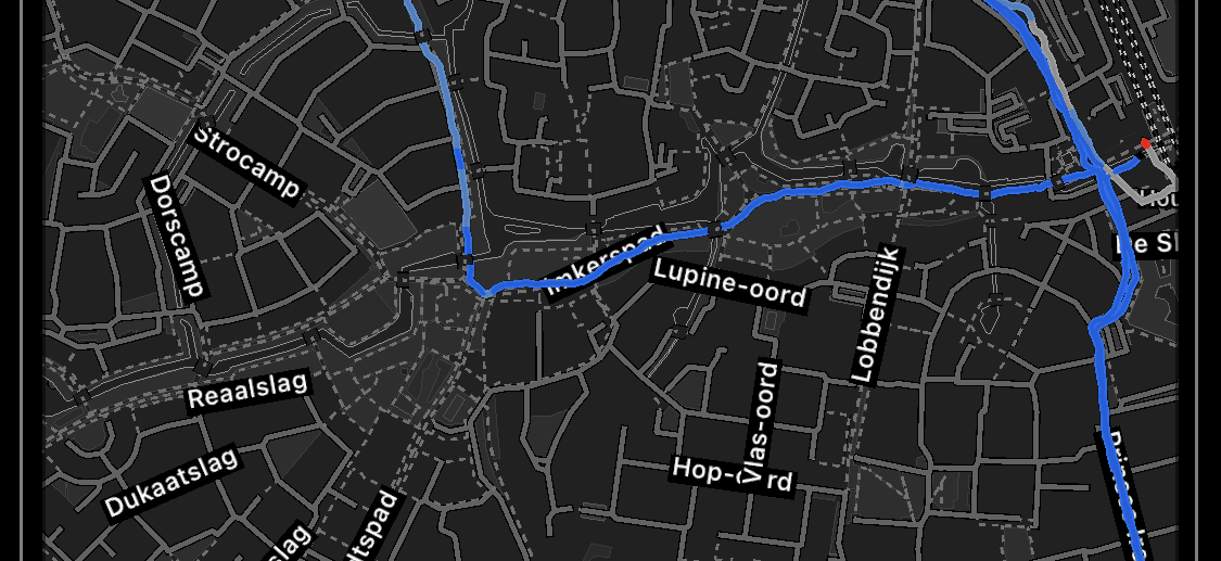

I noticed something similar and I think it is the autopause.
Done.
By the way, this exercise was manually paused 2 times, so total duration is just over 3h.
As far as I know, I disabled auto-pause on all types that have it. And since the bridges are very short and nearly flat, there is no reason for an auto-pause. And even more, I used the "other outdoor" type which has no auto-pause (setting).
(The reason that I used the "other outdoor" instead of "cycling" is that sometimes I combine cycling and walking, but I don't know for shure what I will do in advance)
Done.
Thanks for the file. It is a bug with the map drawing code where the bridges are being drawn too "high" and are appearing above the workout route and therefore covering it.
If you switch to the Thunderforest maps then you won't see the gaps because I haven't made the same error when drawing that map.
Thanks for spotting it. It should be an easy fix and will be ok in the next version.

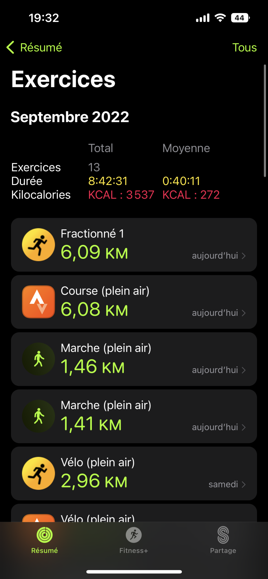

I have a question for the community, not only CFC, you should be busy to answer so many time on this thread 😅
I upload my workout on Strava by your option, at the end of workout.
But now I have 2 workouts on Health app, does it count twice ?
You let WOD upload to Strava + Apple Health and on your system Strava uploads to Apple Health too.
I can't find the exact setting, but I do recall there is a setting somewhere to enable/disable Strava to send everything to Apple Health.
