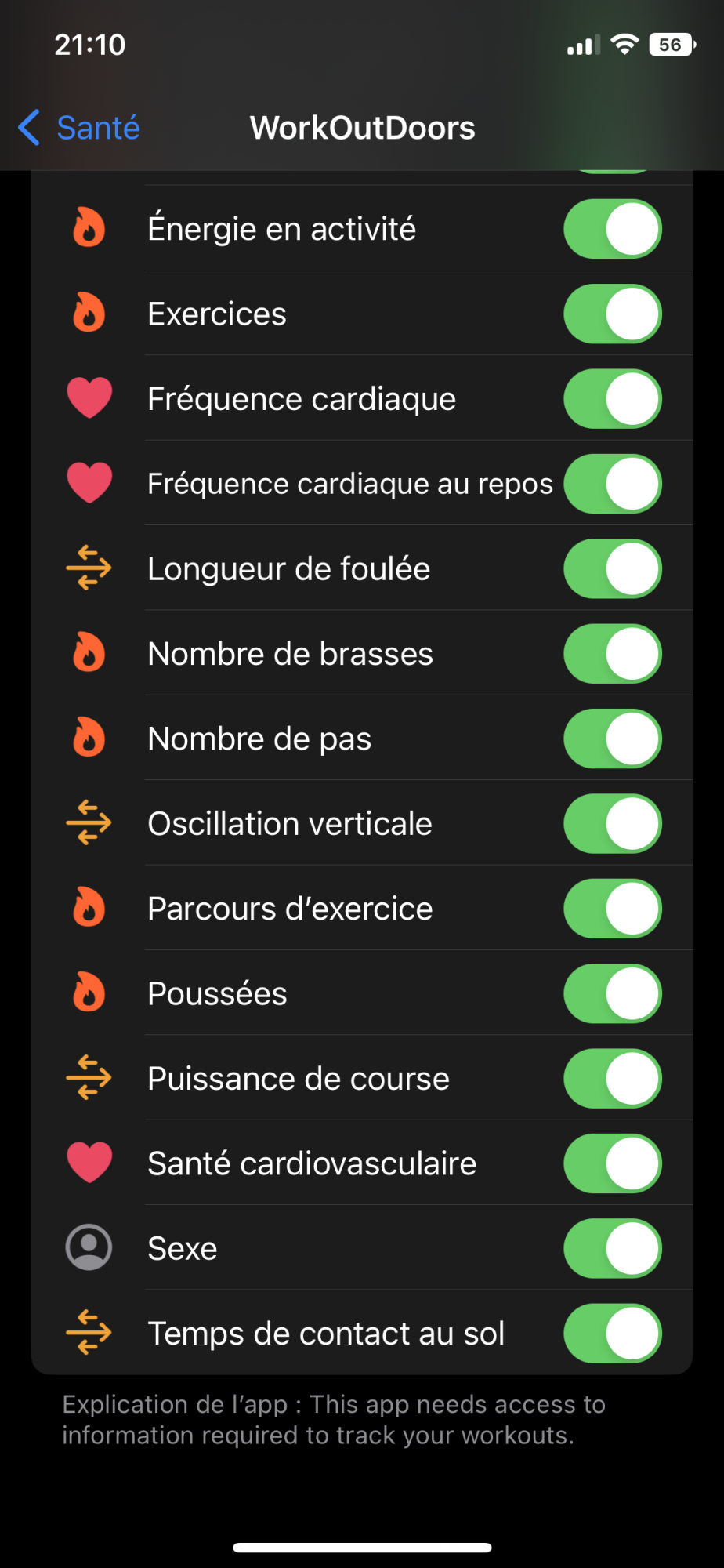

Since the last update (4.7), the vertical oscillation metric and the ground contact time do not show up on Healthfit (nor apple workout).
Before this version 4.7, everything was ok. (I was on the public beta of watch os 9)
Is it a new limitation of apple not to take this information?
I checked the app settings, and everything should be ok.
Am I the only one with this problem?
thanks
Please check that you have enabled these permissions in Apple's Settings app. Go to Privacy then Health then WorkOutDoors and make sure that every switch is enabled. You will need to scroll down to see them all.
All is check :-(
All is check :-(
You may be experiencing a rare bug with iOS/watchOS where the watch seems to lose a permission. To fix this switch that permission off, then reboot both the iPhone and the watch, and then switch it on again. This procedure nudges iOS into sending the permission to the watch.

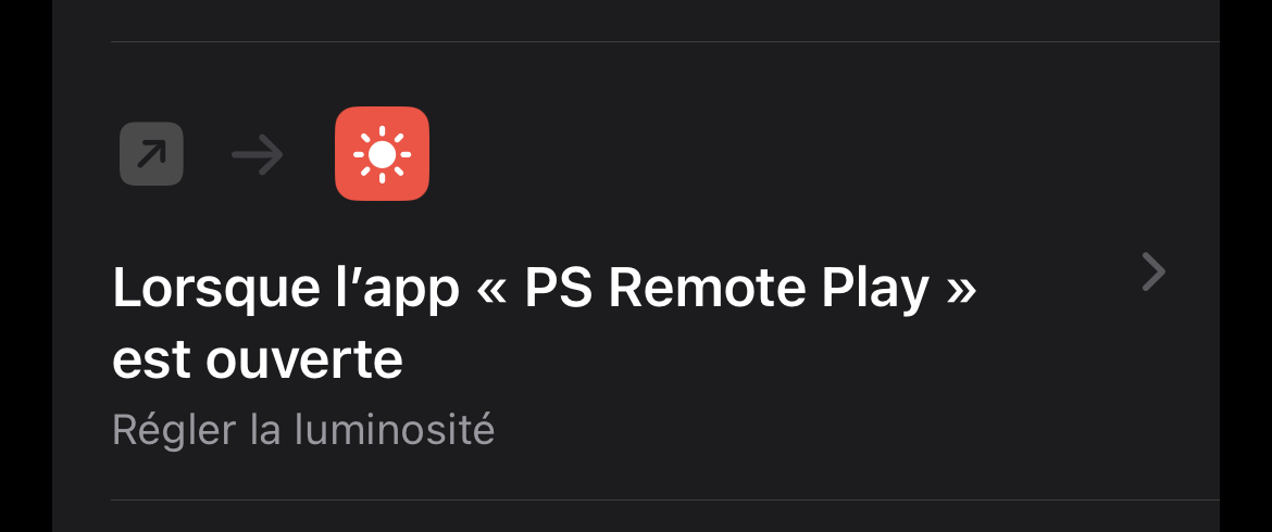

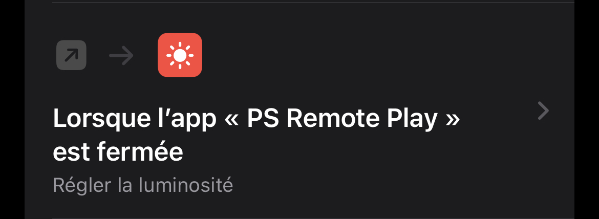

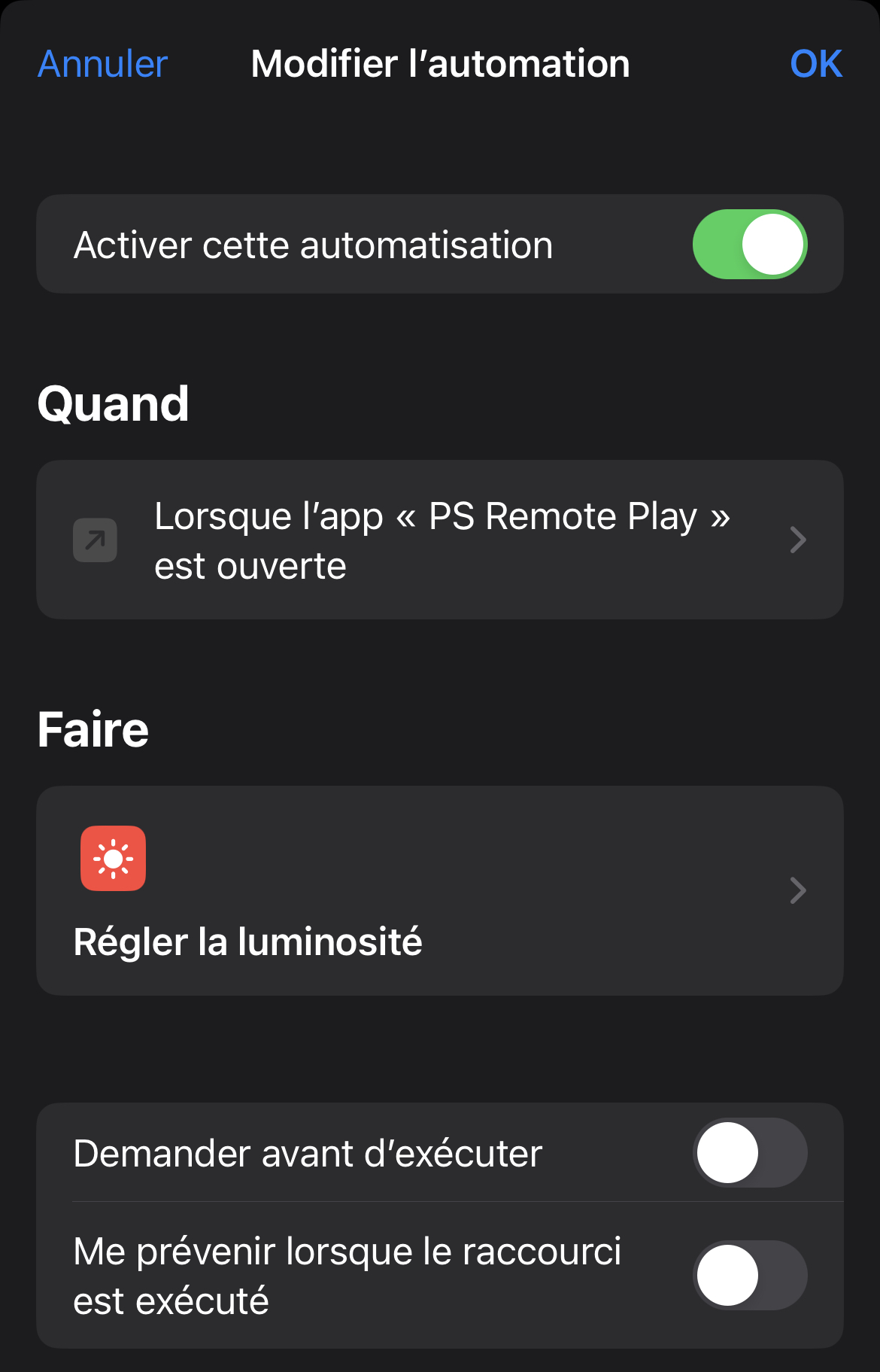

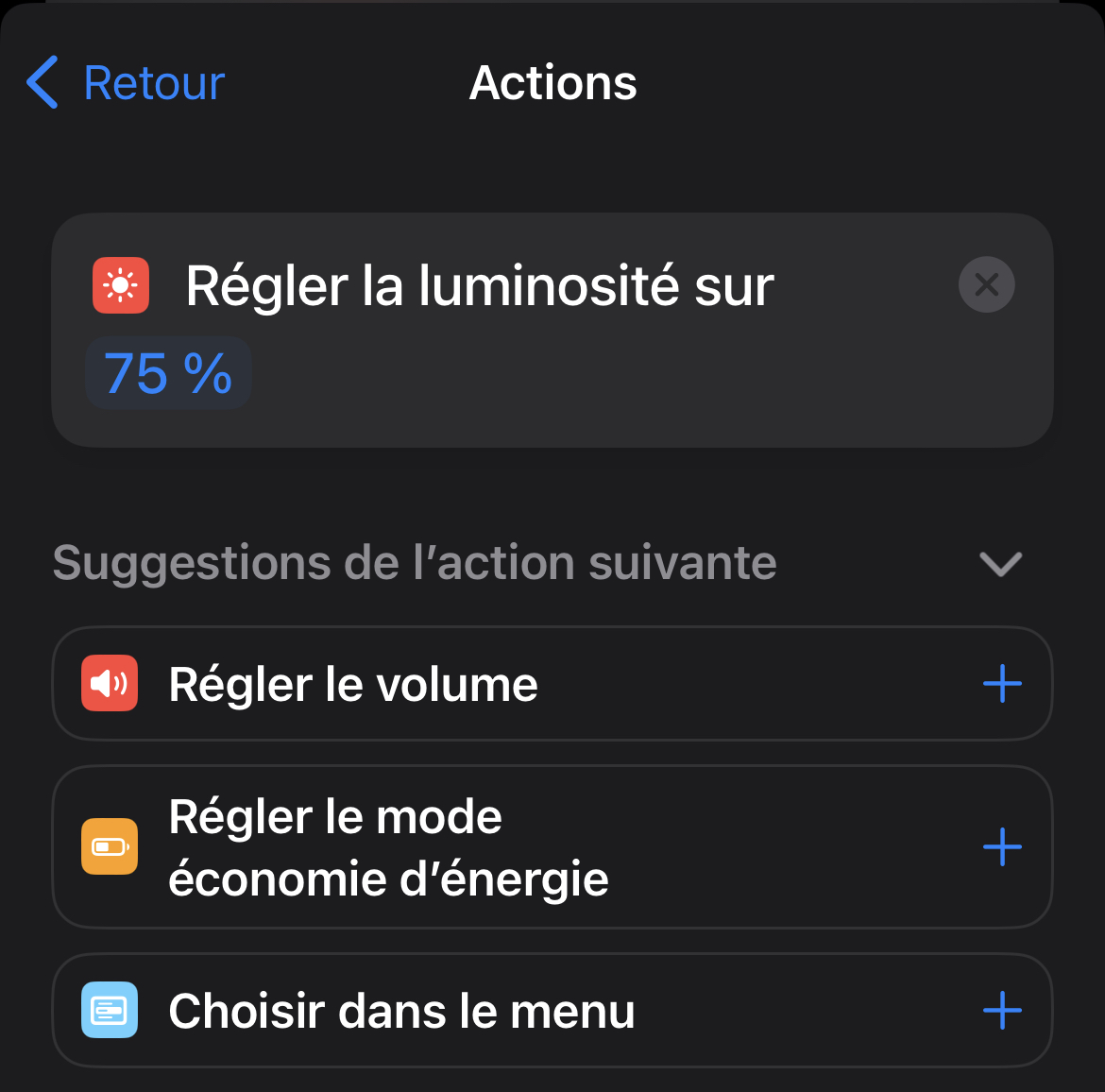

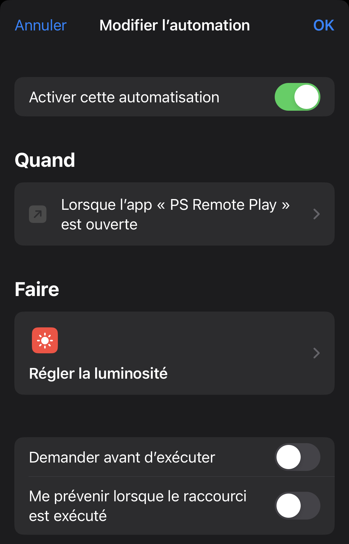

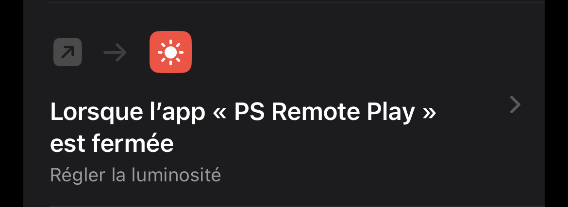

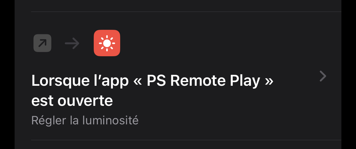

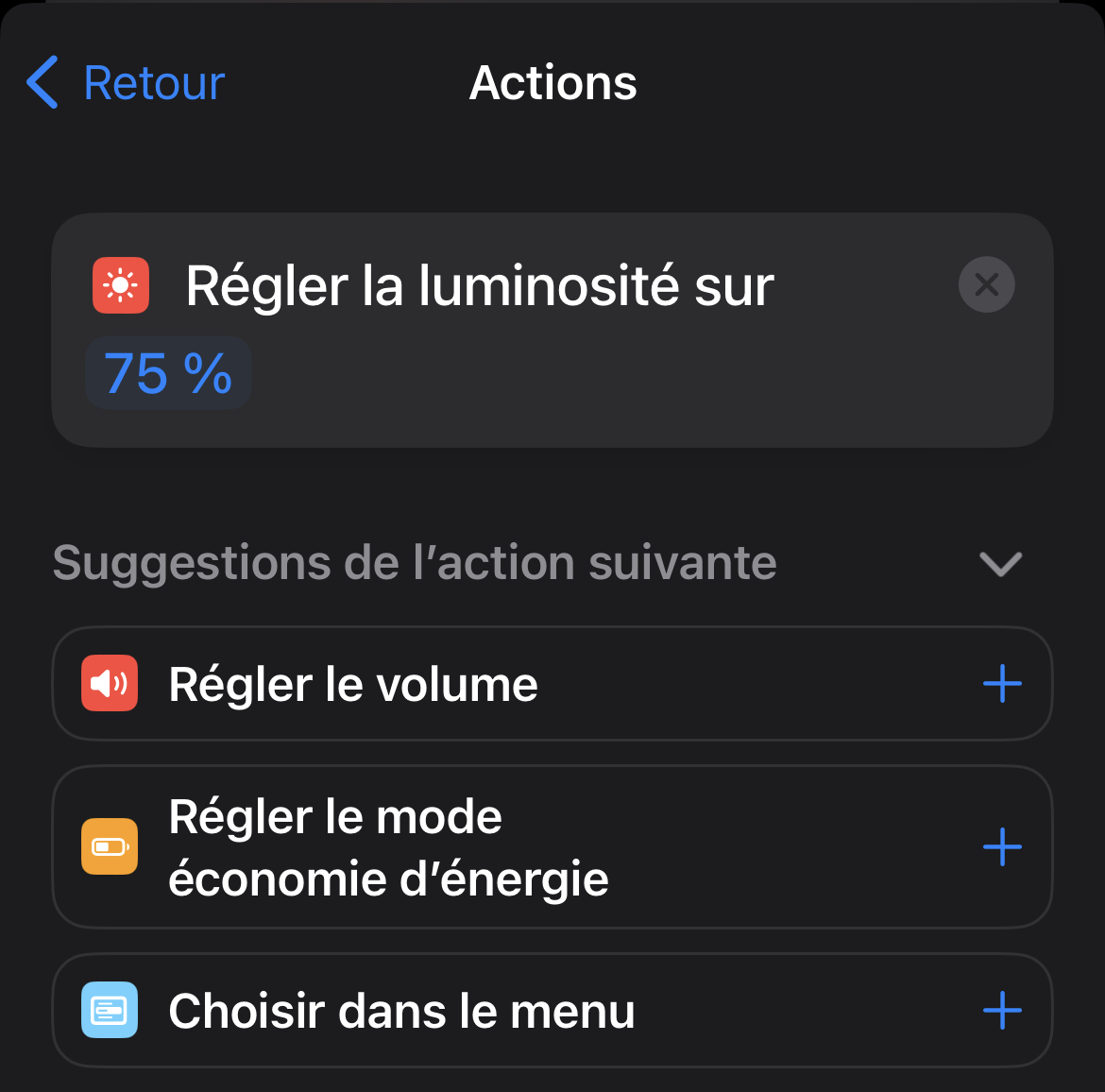

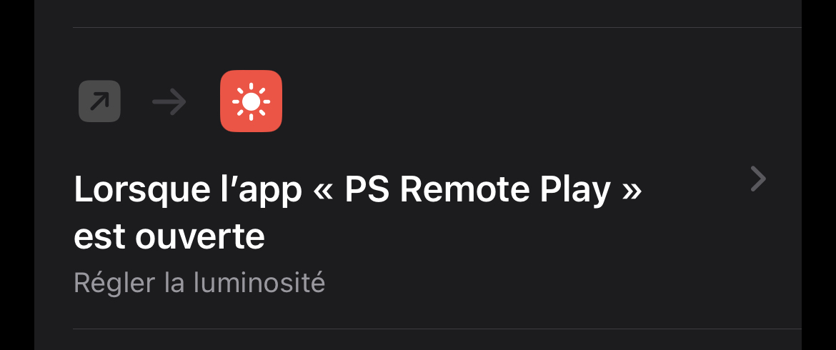

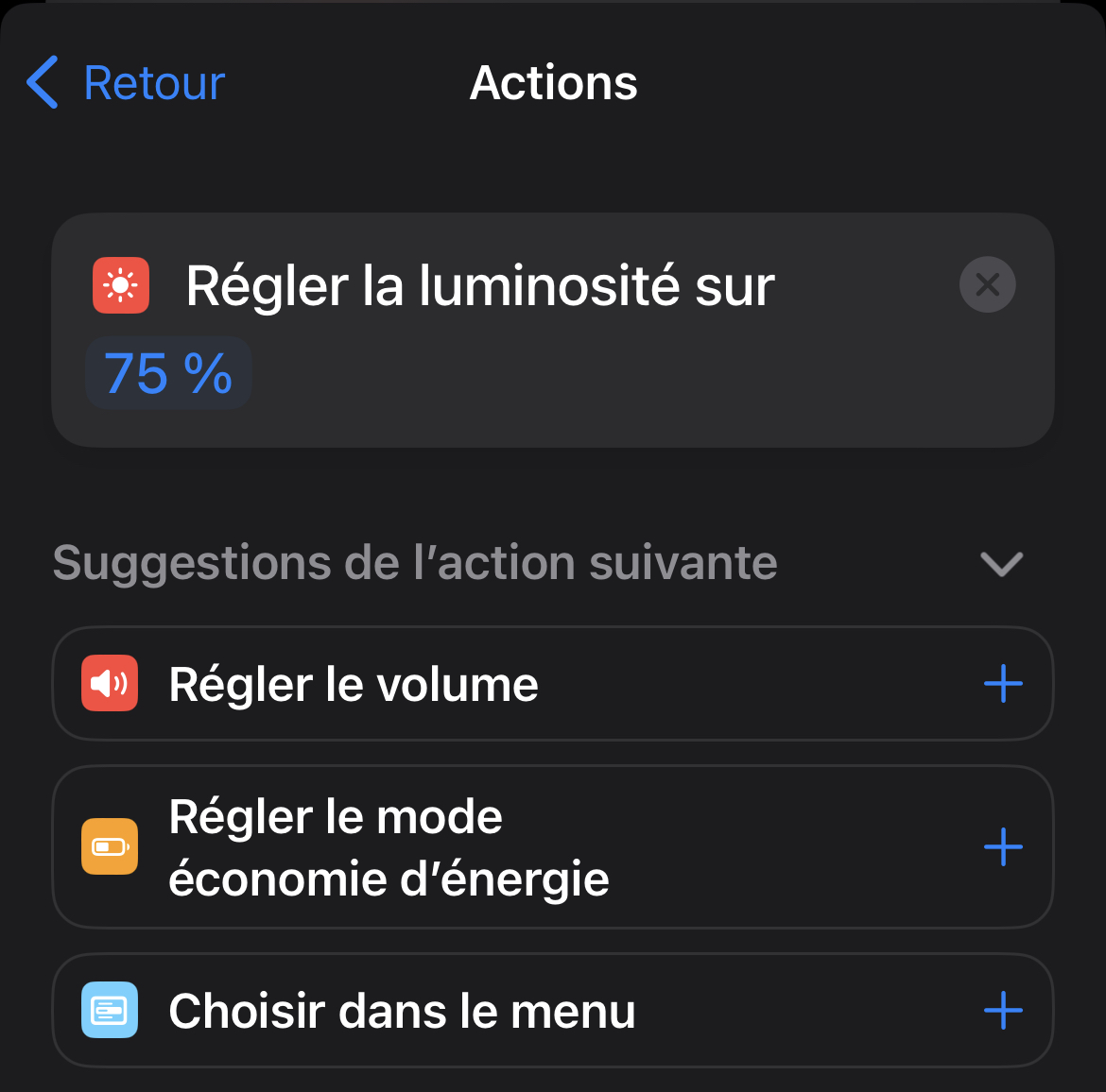

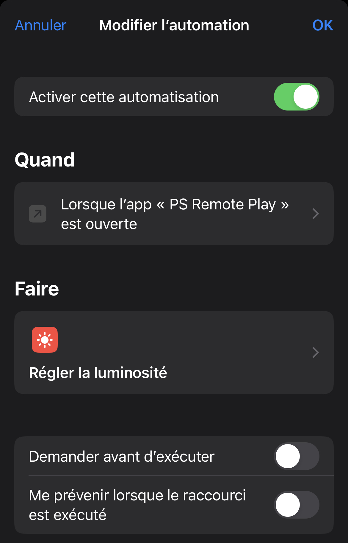

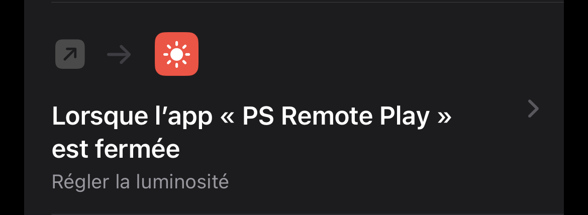

I use shortcuts and automations to do it when I launch certains app
Follow this method :
one for the openning
The other one for the closing
Then
And

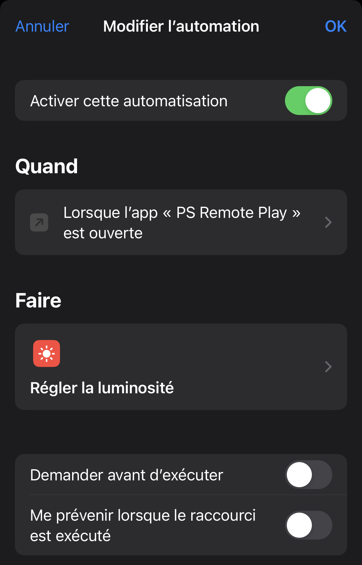

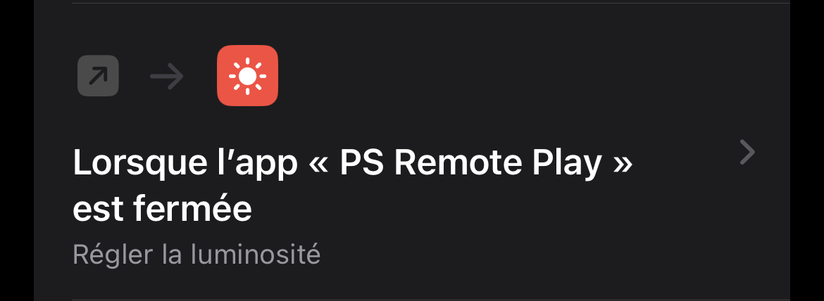

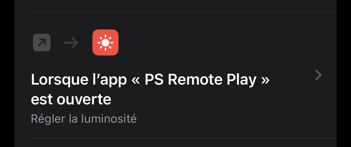

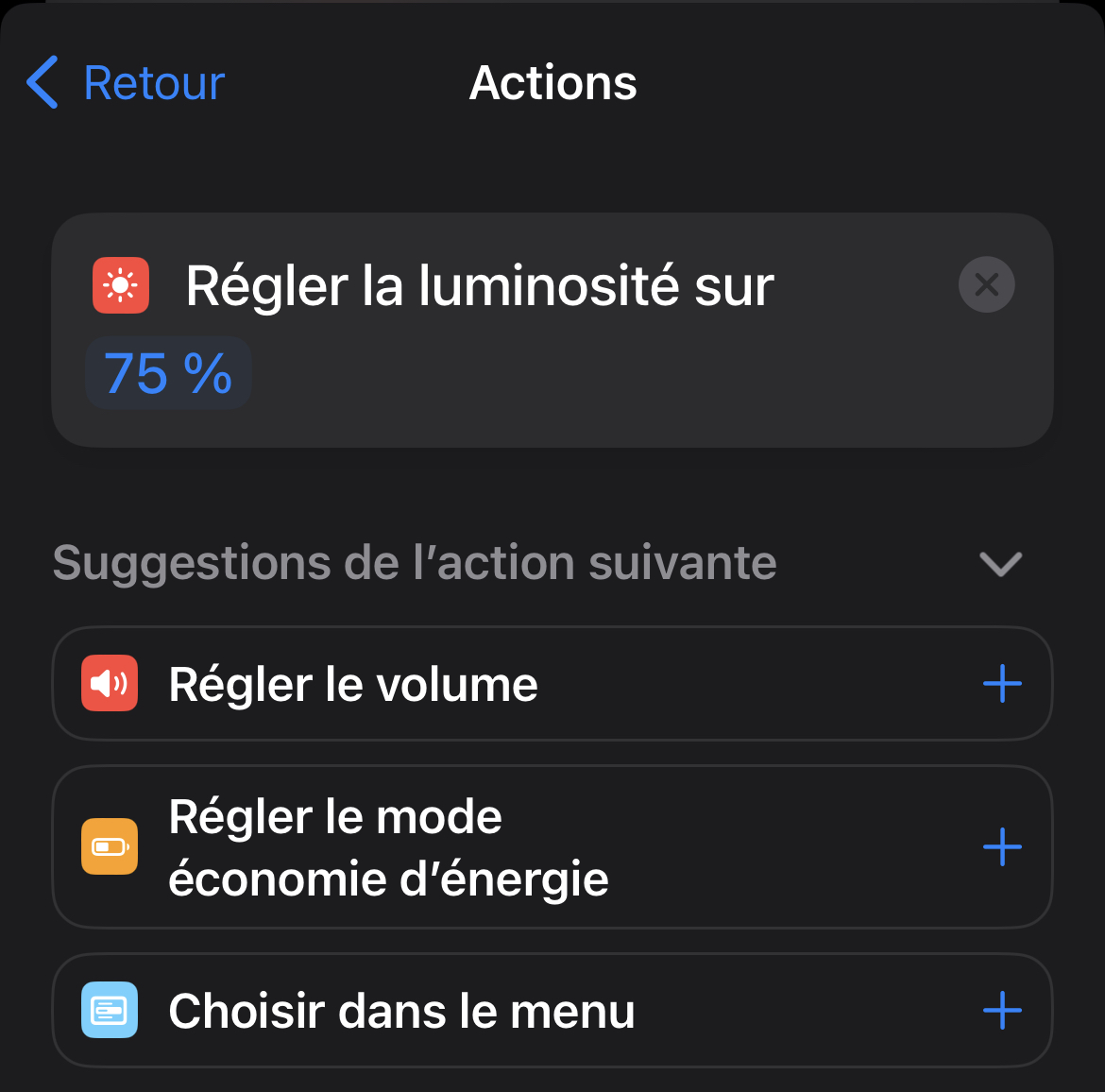

Then
And

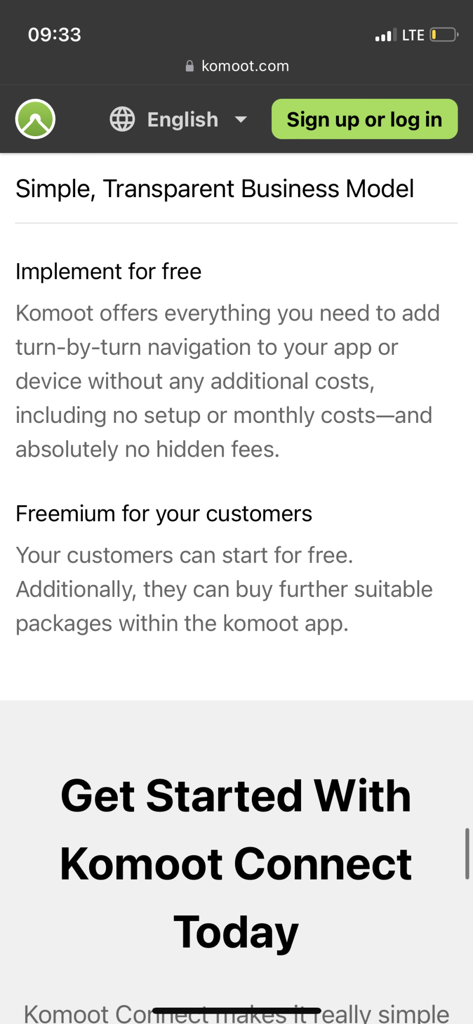

I see in these Screenshot that they offer this service for free.
Reactions: cfc
I think that would only work for Komoot customers. I would want a service that didn't require the user to be a Komoot member.
