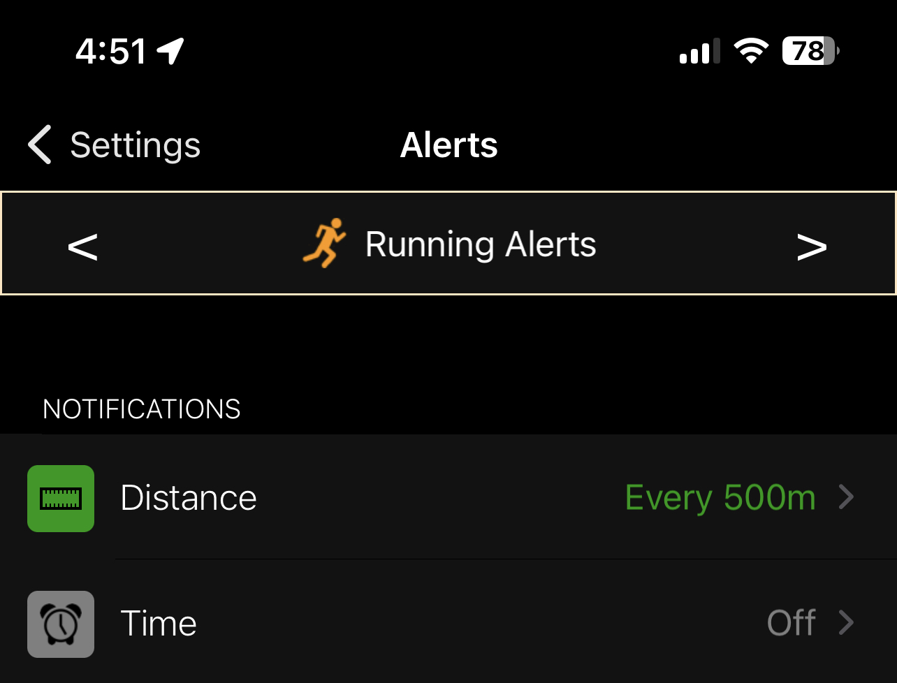

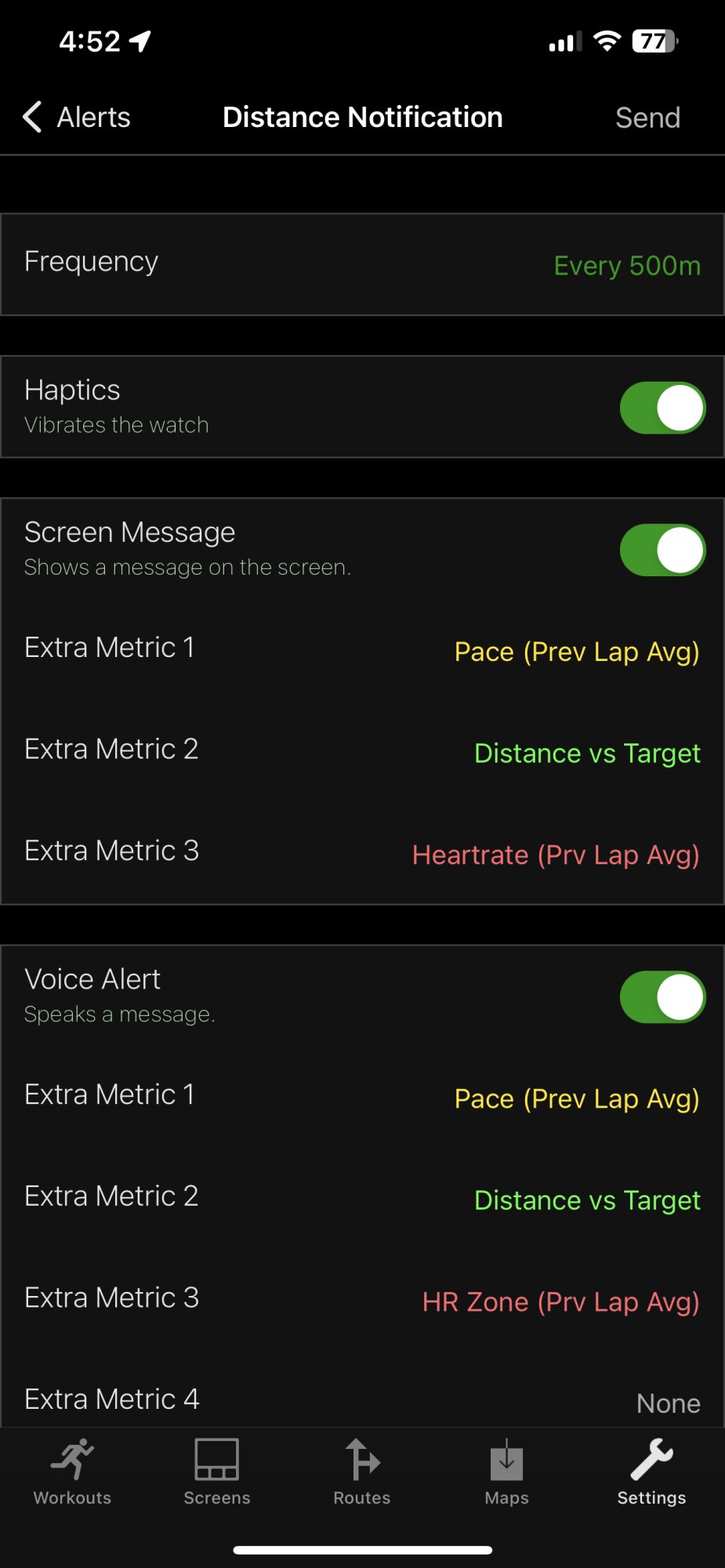

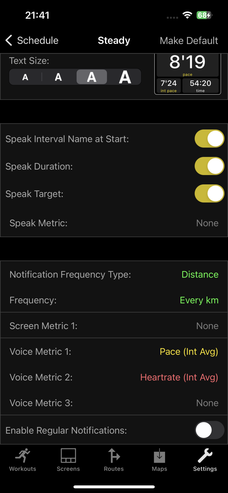

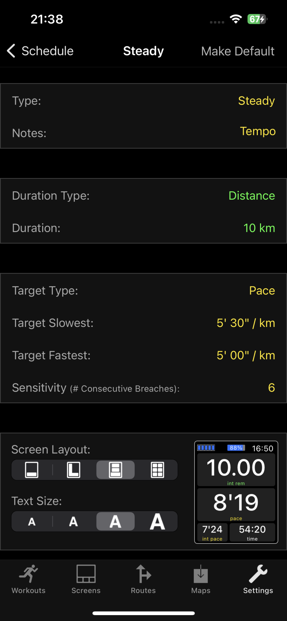

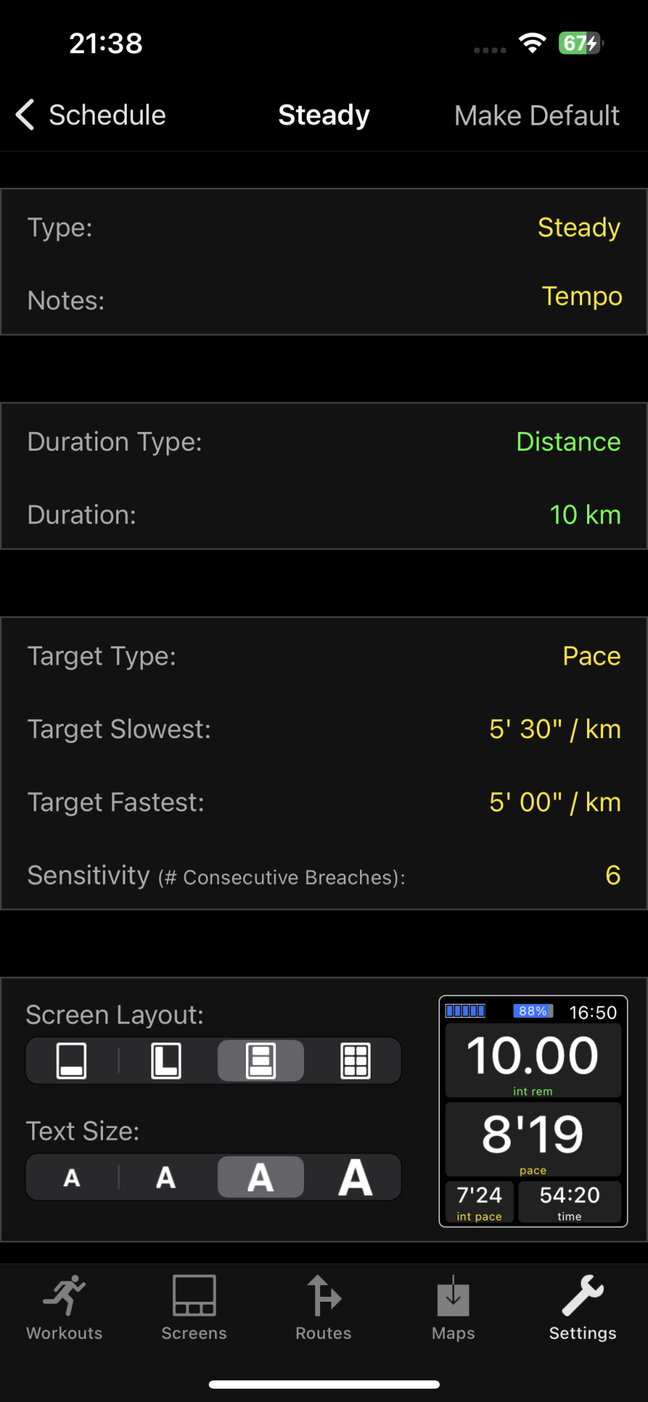

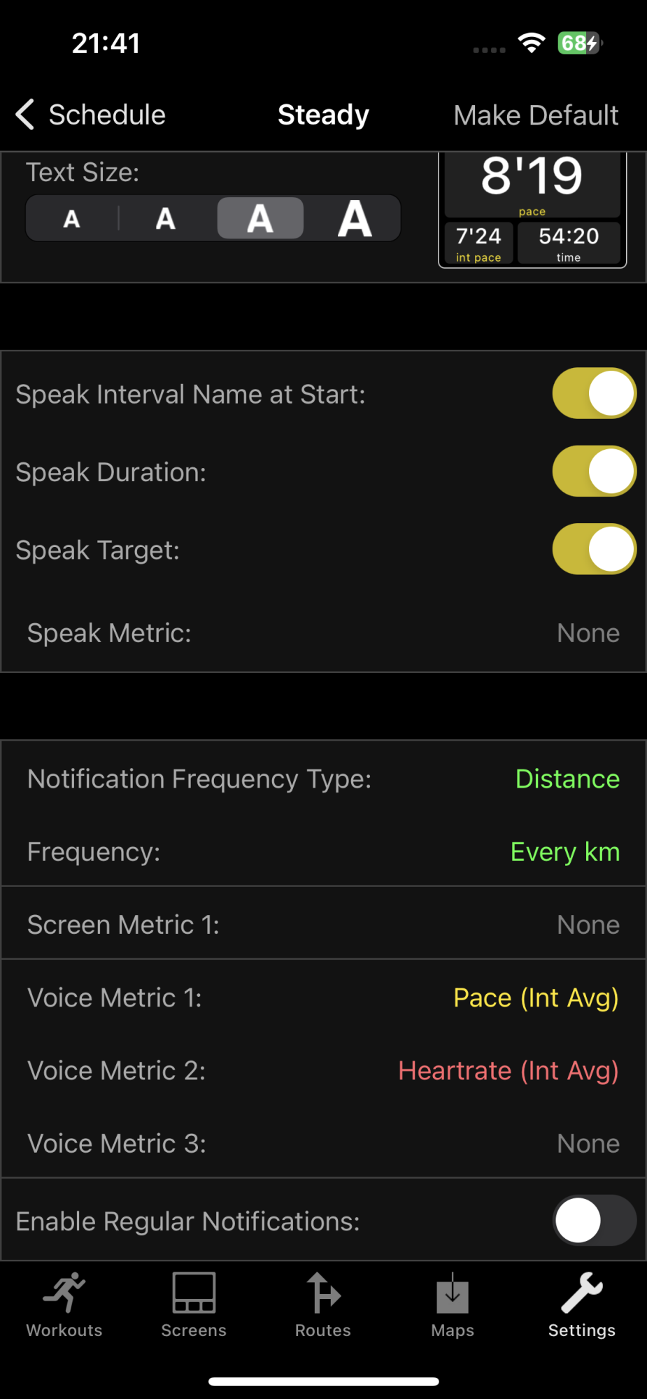

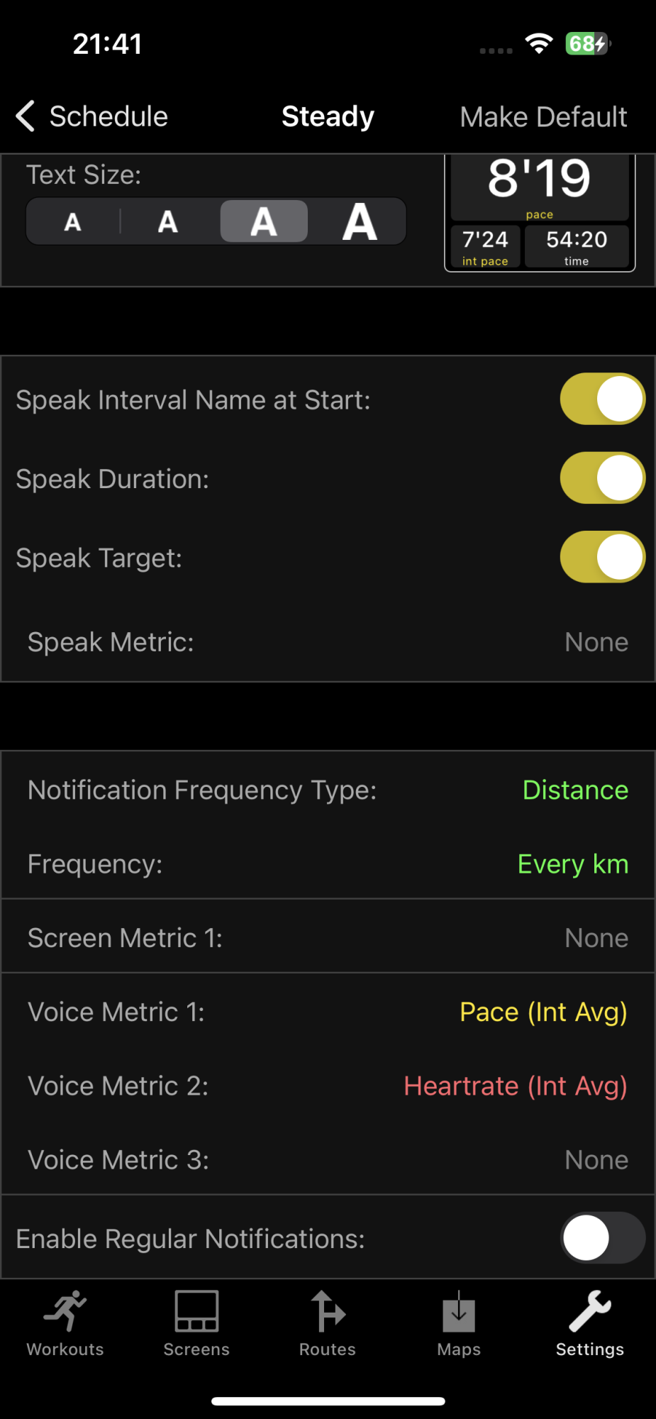

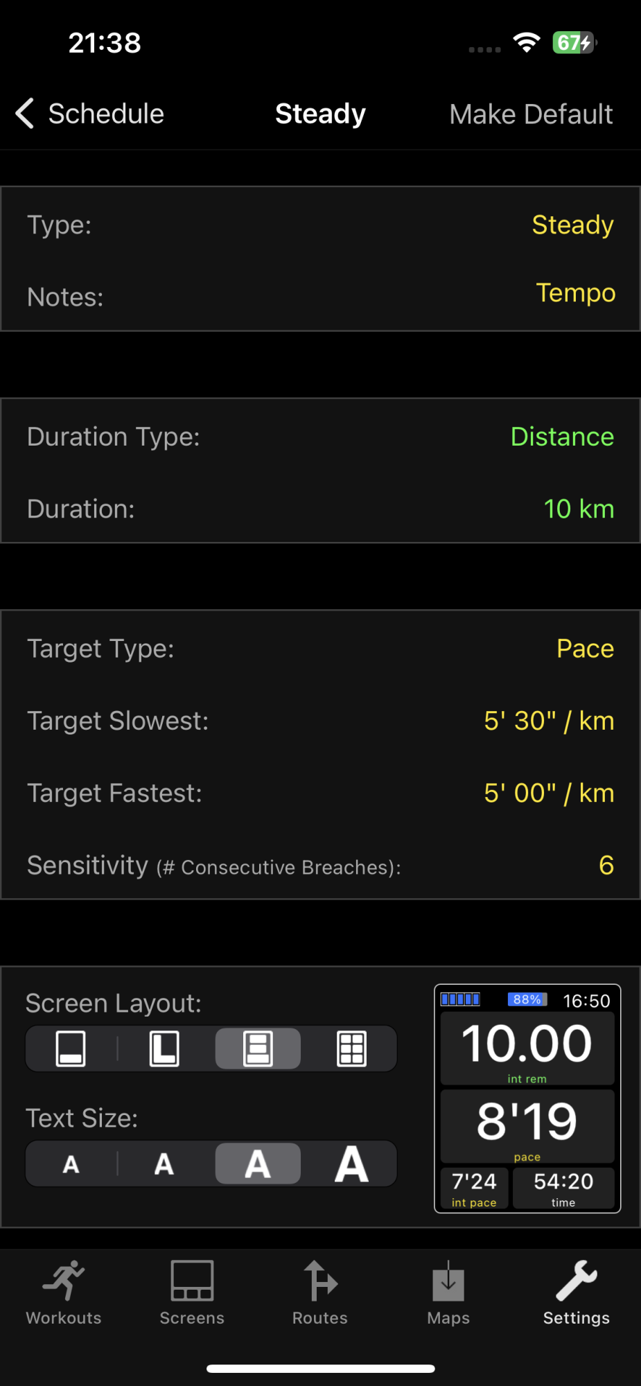

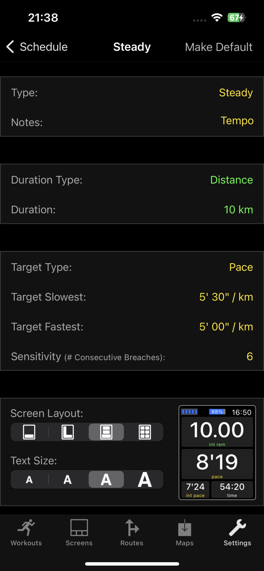

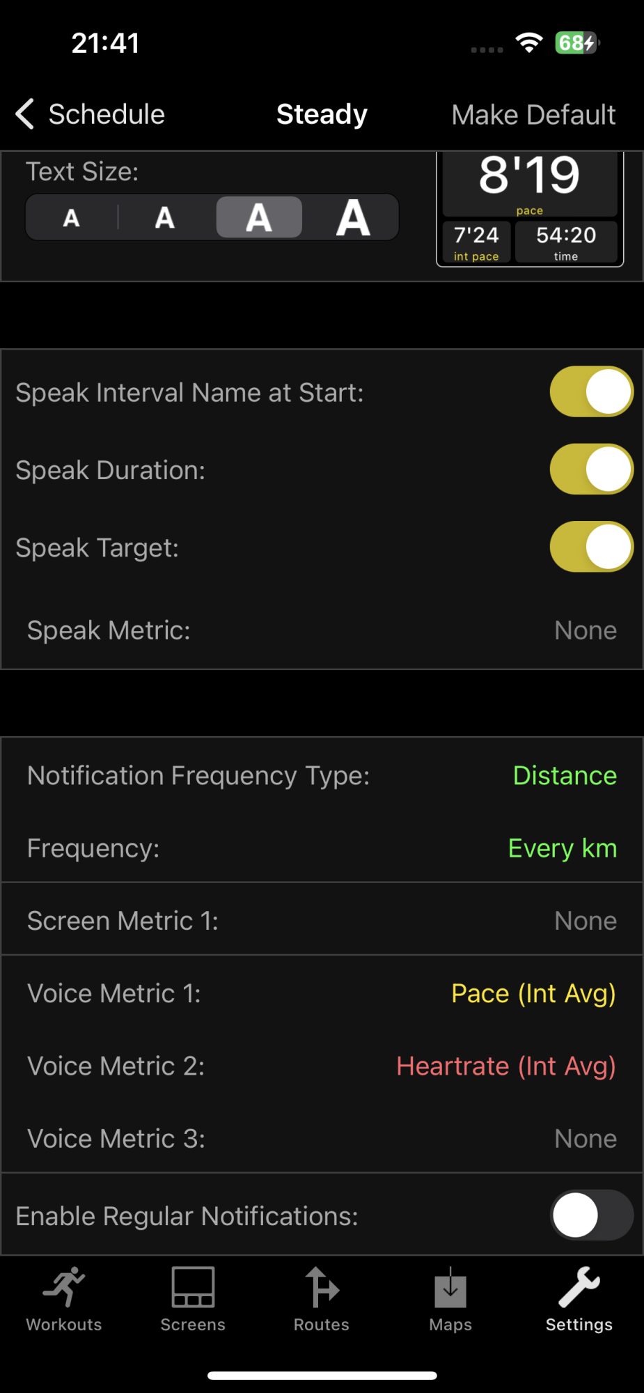

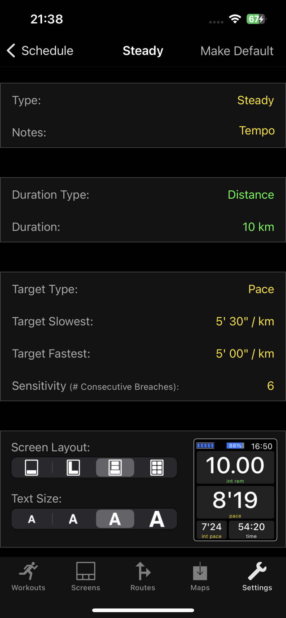

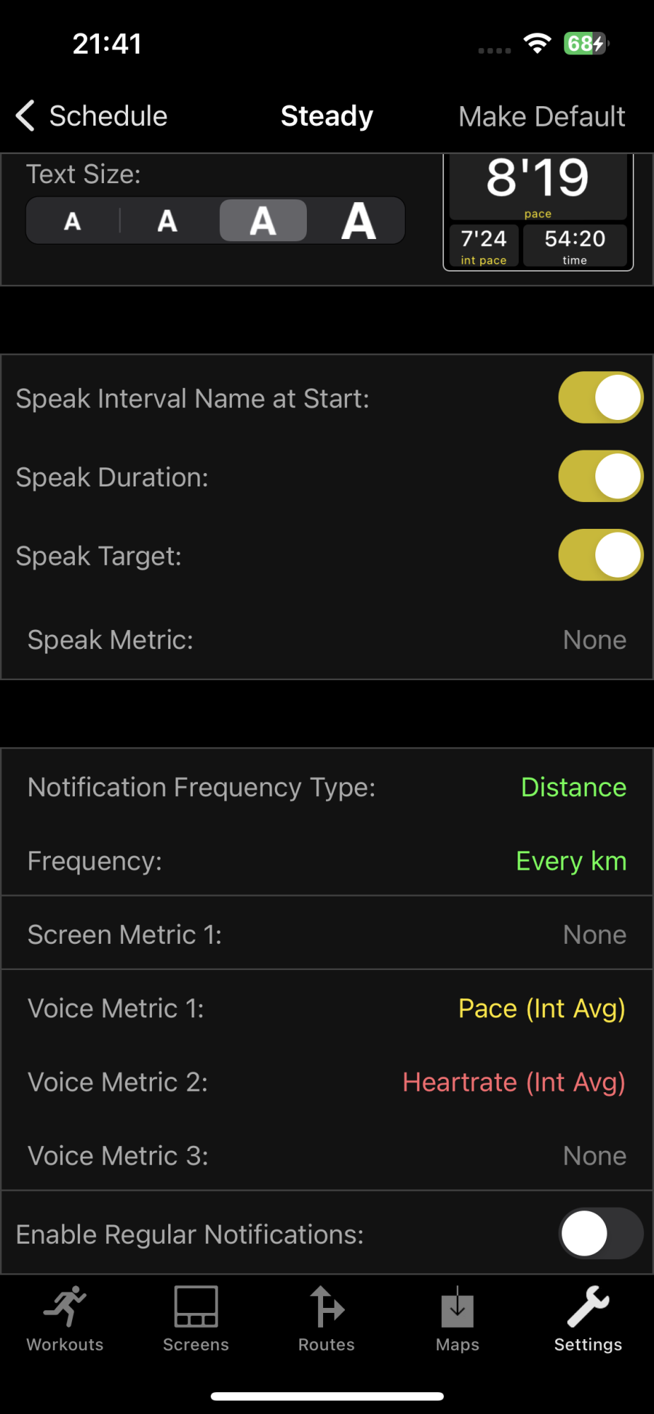

First off, what an amazing app @cfc. It came recommended as a solution to being unable to get Spotify through my headphones along with Strava/Apple Workout announcements. This solved that really annoying issue entirely and brought so much more to my runs!
A quick question for you guys in the know. I'm a very basic runner, have my target paces for runs and enjoy hearing my km splits. As such I set up intervals for my runs as in the attached photos. Can someone kindly confirm if this is correct? i.e. Each time I complete a km, I want to hear my Avg pace and avg HR for that recently completed km?
I had initially selected 'prv int avg' but seem to recall not getting any metrics spoken. I think...
Thanks in advance!
Thanks in advance!
I too enjoy hearing my splits even on my easy runs. Rather than set up an interval for my easy runs, I just set up a distance notification under the Alerts -> Running Alerts section and then use Pace (Prev Lap Average), Distance vs Target (which tells me how far behind or ahead of my target pace), and heart rate zone (Prev Lap Average) which I use to keep me in zone for a longer run. I have set this up to tell me every 500m which is a lot but I like to know this more frequently to keep me on track as my mind tends to wander when I'm listening to a podcast. I also set a reminder to drink every 15 minutes because I also forget to drink 🙂 .
When I'm doing an interval workout I then disable these alerts (Regular Notifications) at the bottom of the interval configuration screen as they get annoying when you are in the middle of a complicated workout.
Also, if you are not hearing any notifications I seem to recall that there was some permission required to allow Siri to speak. You can test that voice is working in the 'Voice' section on the phone or watch.
  • Love
Reactions: grantgam and cfc
Thanks in advance!
As you can see in @Richo5's screenshots, if you change Pace (Int Avg) to Pace (Prev Lap Avg) and the same for heart rate then it should work.
Each 1km split is a lap, whereas intervals are manually controlled by the user, either before a workout by using an interval schedule, or during a workout by using the New Interval command (the default command for the action button on the Ultra). So you want the lap metrics.
The reason you need the Prev versions of the metrics is because you have just started a new lap when you hear the alert, so you want the metrics for the previous lap. It sounds like you had worked that out but the reason the metrics were empty for you was because you were using the previous interval metrics instead of the previous lap metrics. These would always be empty if you never started a new interval.
Sorry it is complicated but it is pretty powerful when you get the hang of it.
Glad you like the app!
Thank you so much @Richo5 and @cfc. I knew I was missing something important yet simple. Confusion around interval and lap.
Have set up as you kindly described @Richo5, now I just need to run without using any intervals and adjust my pace accordingly.
The perfect answer. Many thanks!🙂
