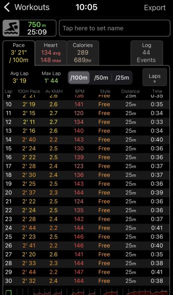

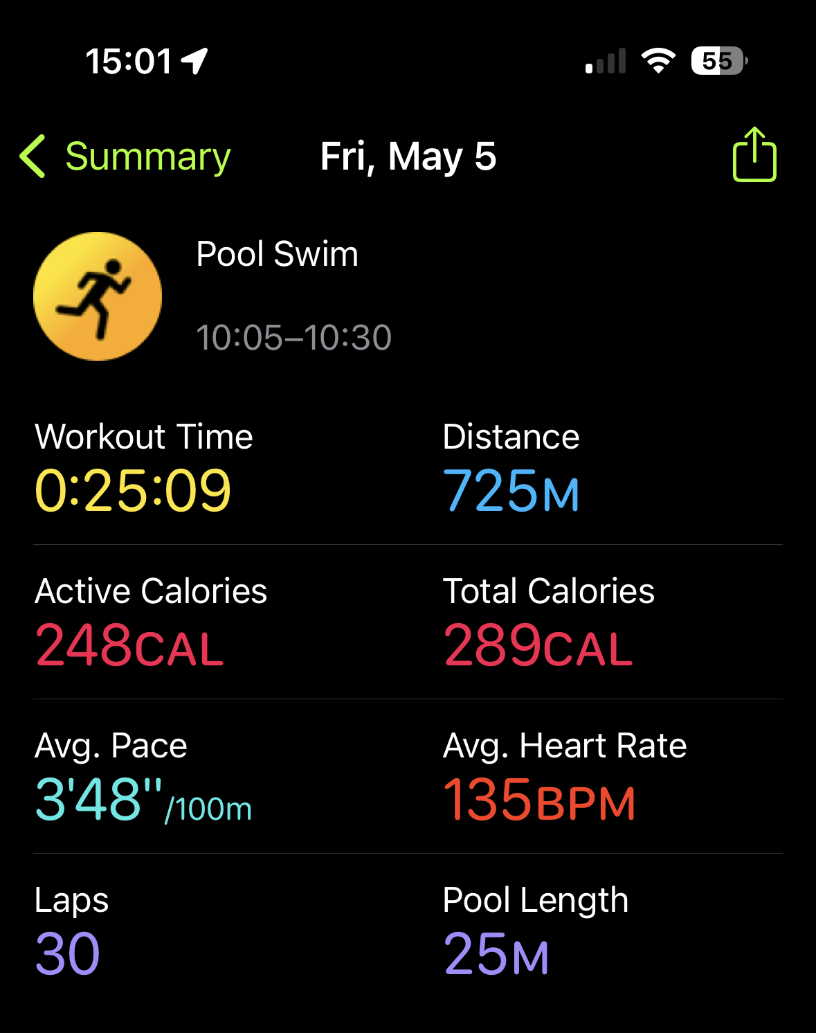

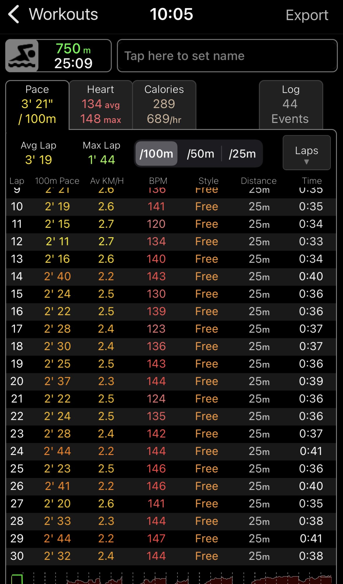

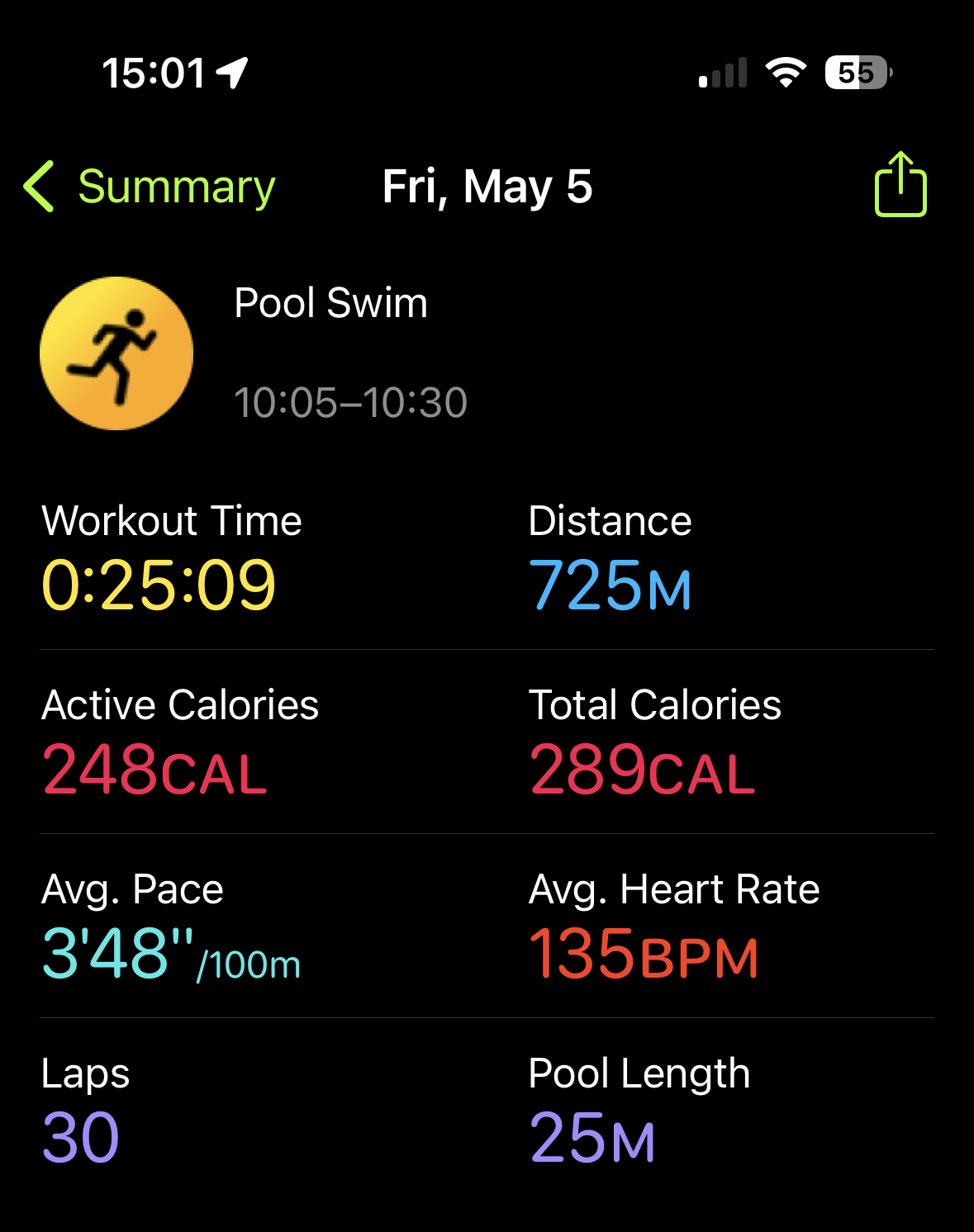

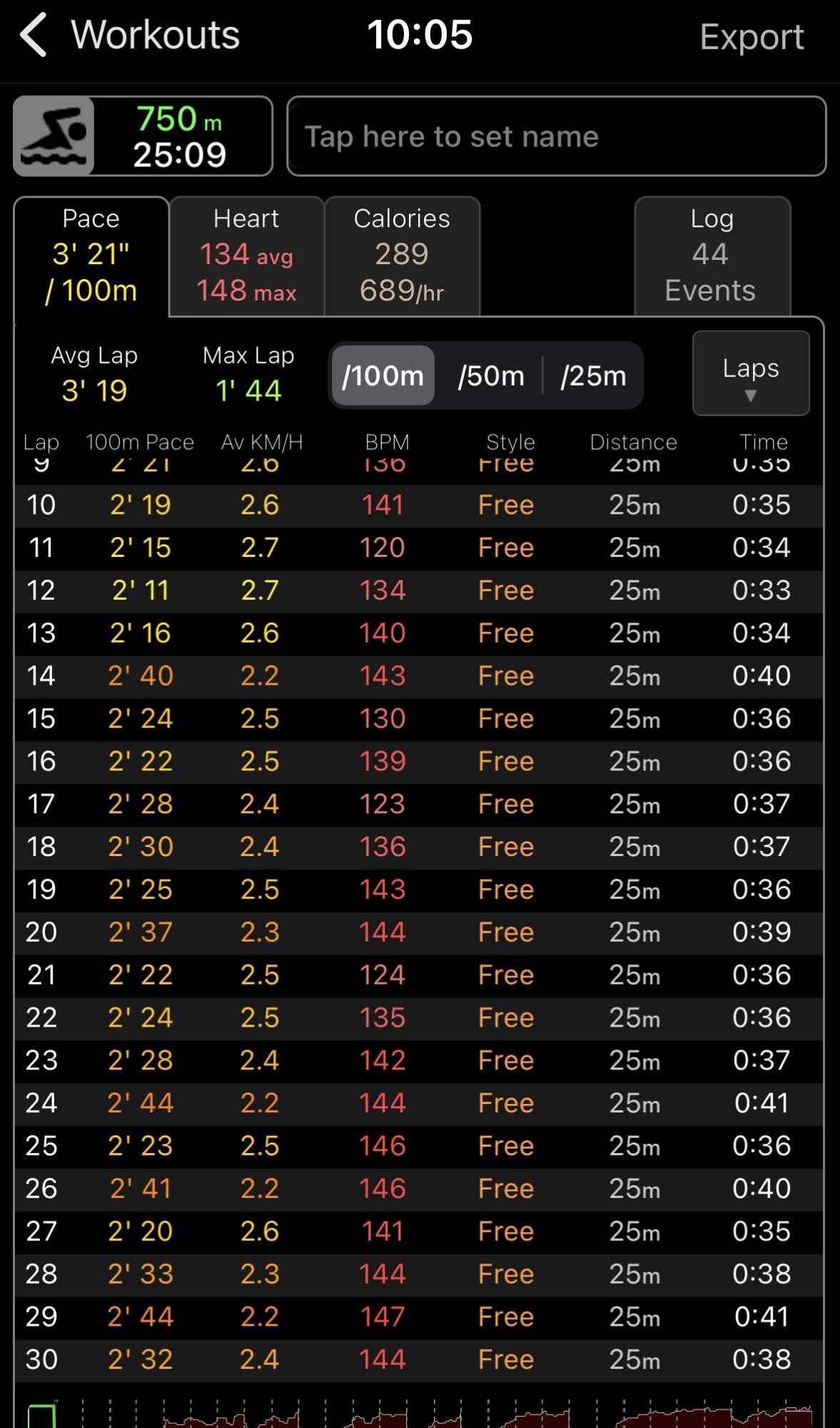

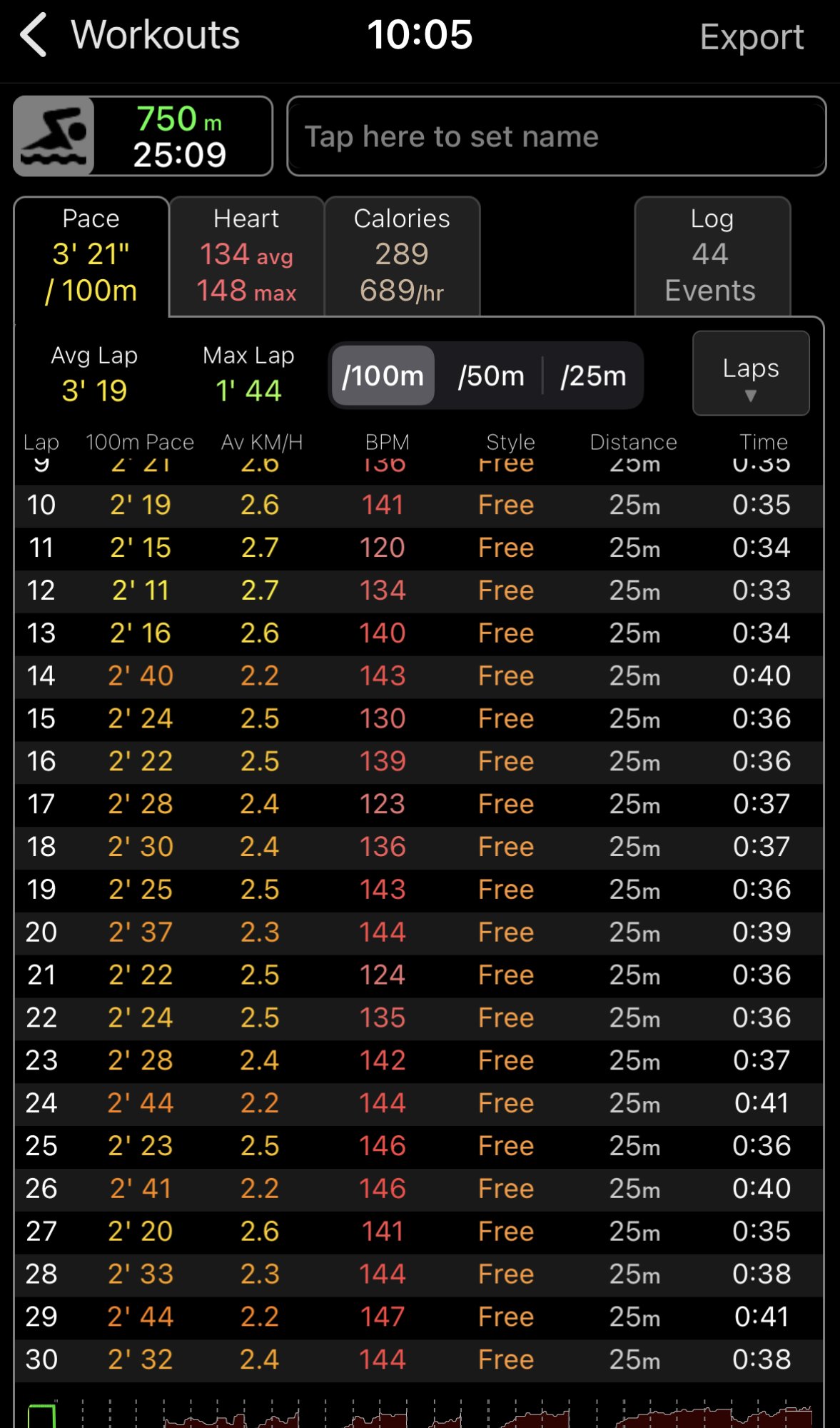

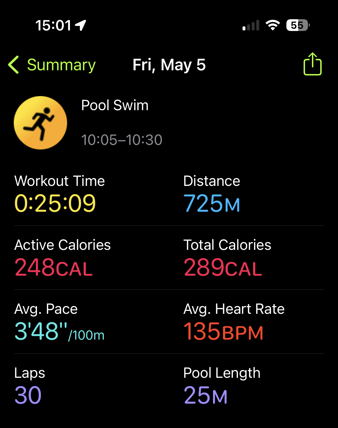

Can you do anything about this?
WorkOutDoors shows 30 laps, 25m each = 750m
Apple workout shows 30 laps, 25m each = 725m
Seems to be the same for other pool swims too
I haven't heard of that before but there is a known issue where Apple's workout system takes a long time to inform the app about a lap (sometimes up to a minute or two). The fix for that is to wait a while at the end of a workout, to give time for the last lap to be reported, so that may also help in this case.
