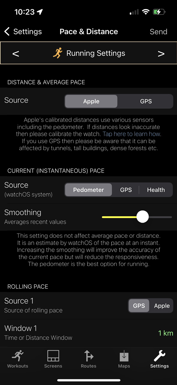

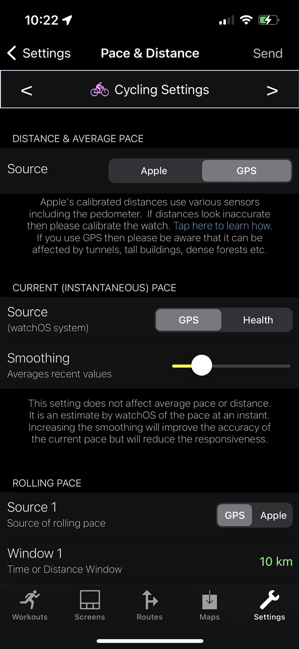

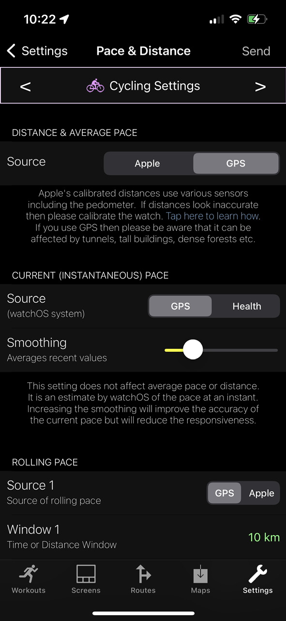

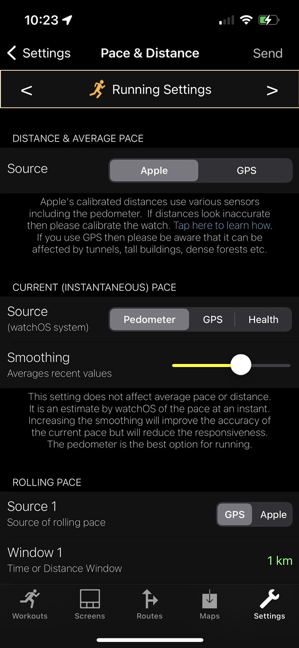

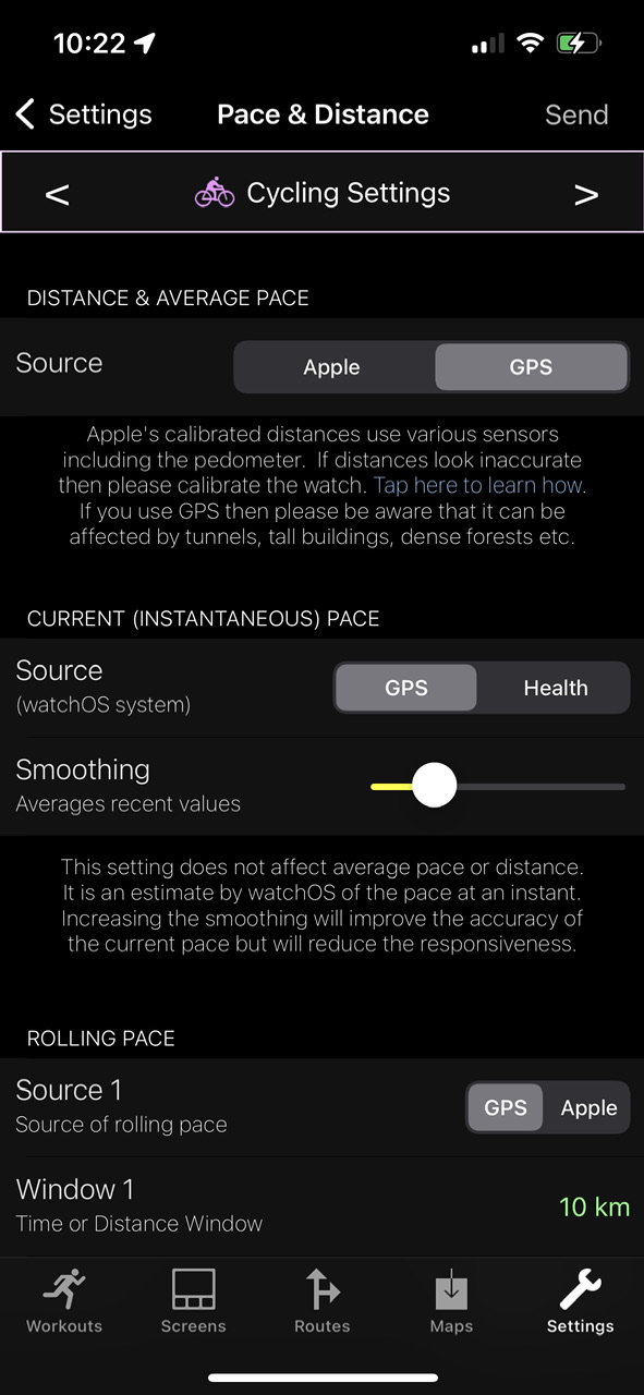

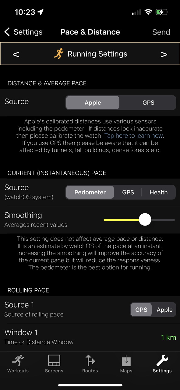

With running, which is what you mentioned before, the pedometer is best for current pace. For distance it's up to you whether to choose GPS or Apple. GPS requires a good signal and Apple requires good calibration. When they were very different like you saw last month then calibration is probably required.
For cycling, which is in your screenshot this time, it normally doesn't matter what you use for distance. This is because I think Apple must use the GPS for their distances, because I don't think there is an alternative. However the app uses Apple by default in case they do anything clever with accelerometers.

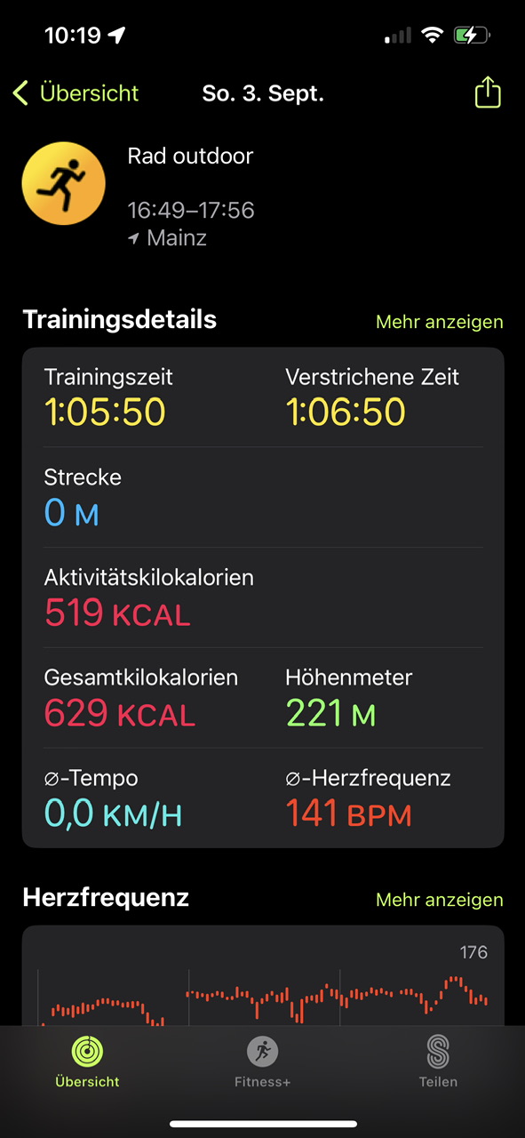

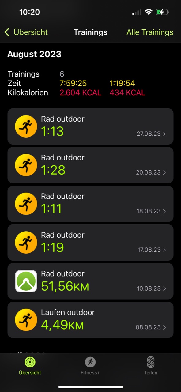

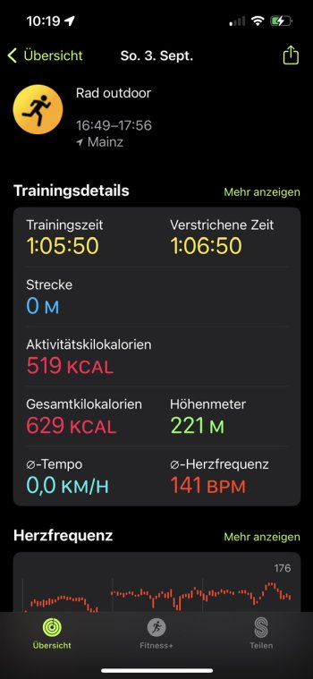

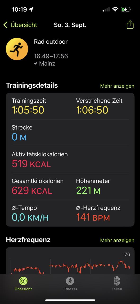

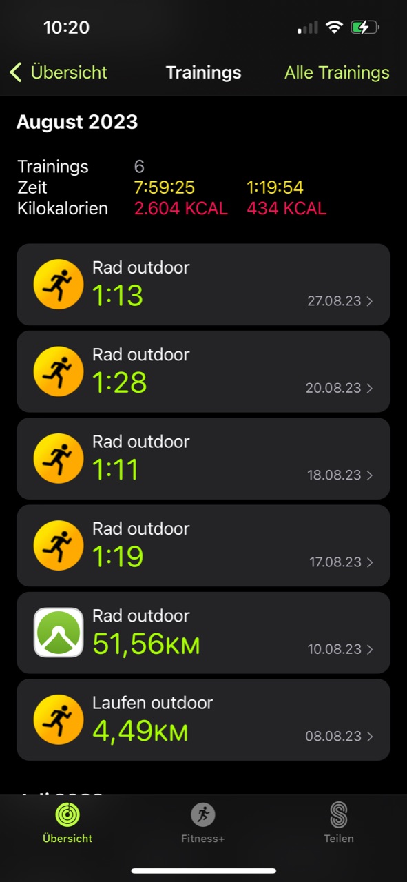

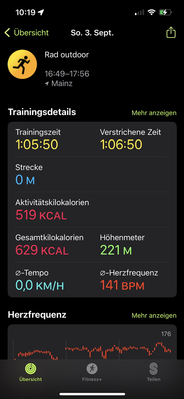

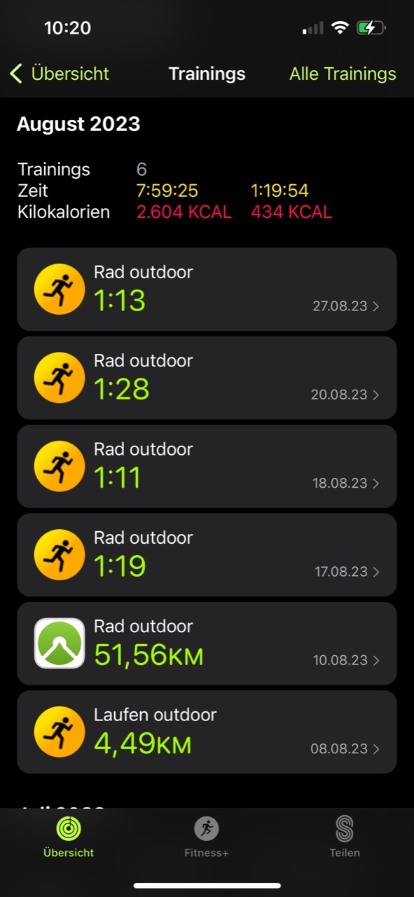

Now i saw, that Apple Health doesn‘t count the distance & speed from WOD when cycling. Running and Komoot ist okay. In cycling-profil was „gps“ selected. But why it do not show distance & avg speed ?? All other data are there, also map with gps position, high.
In WOD are all datas (pace,elevation,avg speed …)
