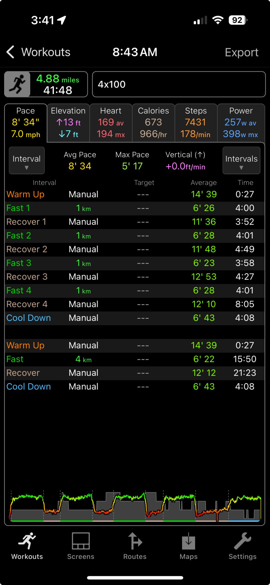

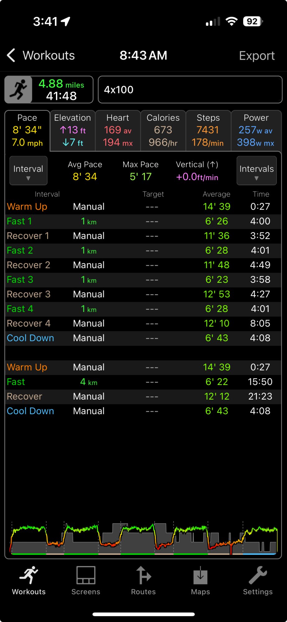

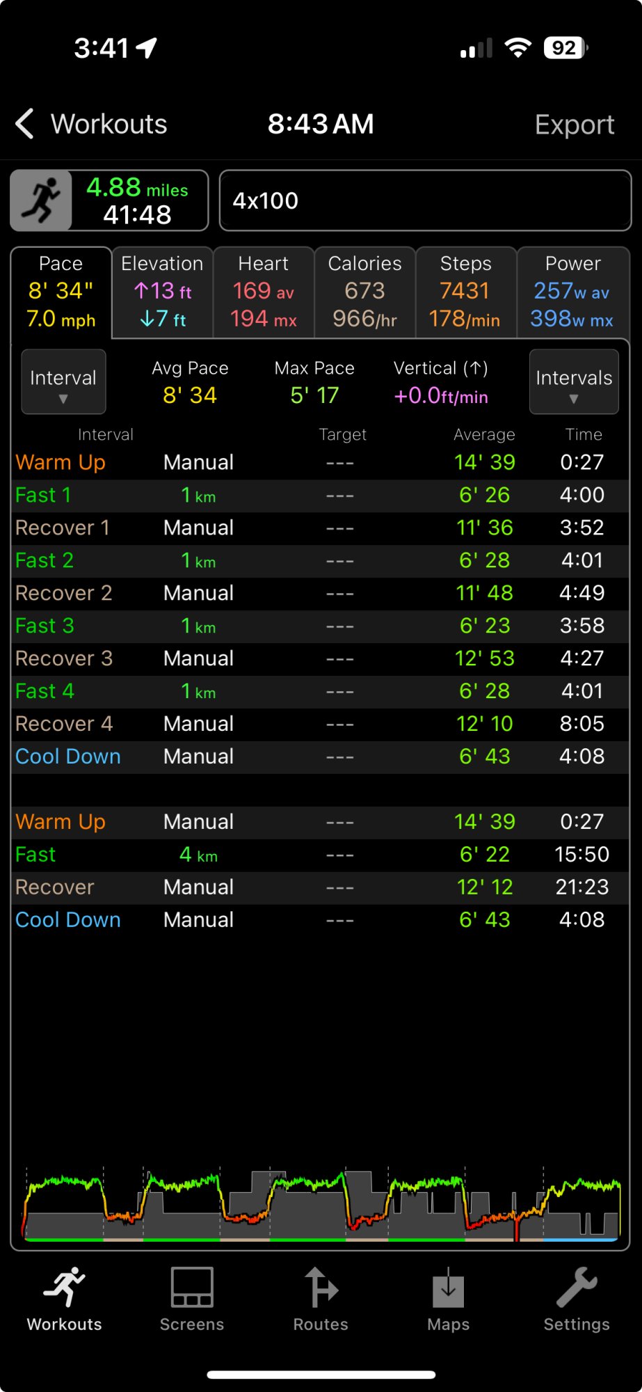

Hey, seeing something funny and wondering if you could shed some light. Just did 5x1k running outdoors (messed up the name, and I did the last rep in my cooldown section).
The individual "fast" intervals pace averages are all above 6:22/mi pace, but in the aggregate data below it shows an average of 6:22/mi pace. How is that possible? Thanks
That is odd. At first glance it looks like the summary row for the 4 fast intervals is showing the incorrect total time: 15:50 instead of 16:00, which would explain the pace being slightly out.
Please send the wkt file for that workout to info@workoutdoors.net and I will take a look. To do this tap the Export button 3 times quickly.
