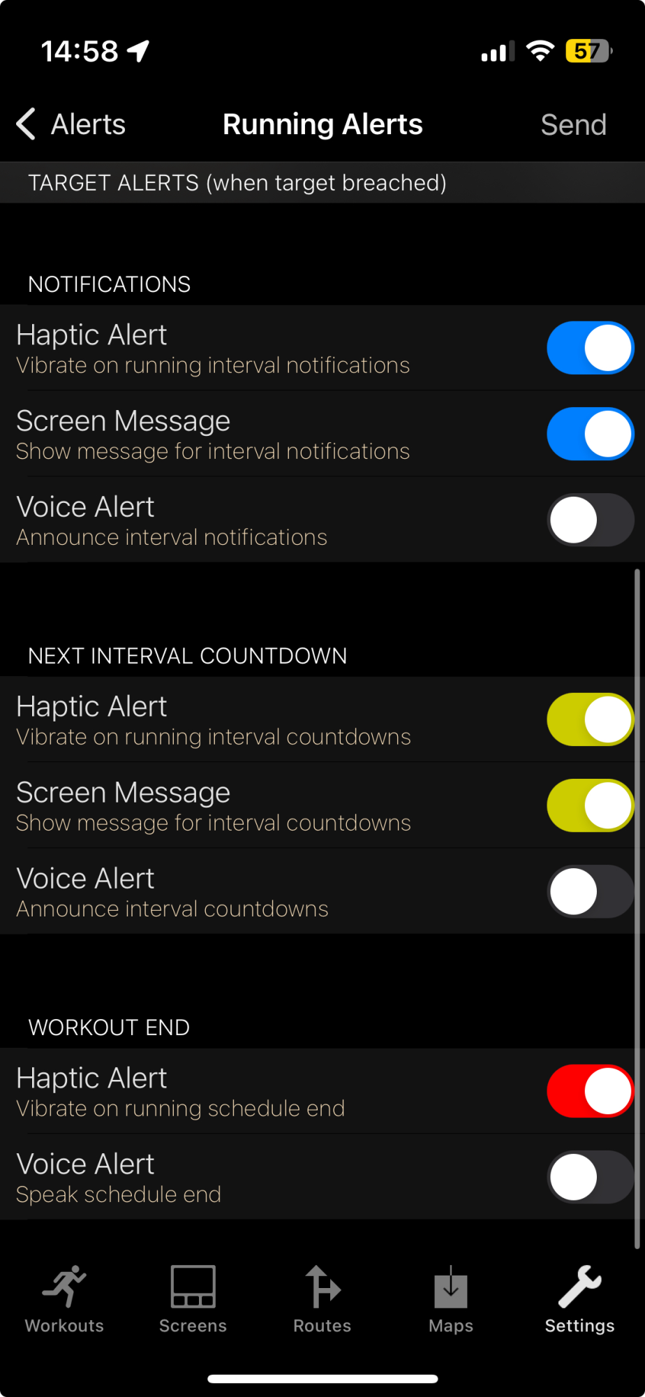

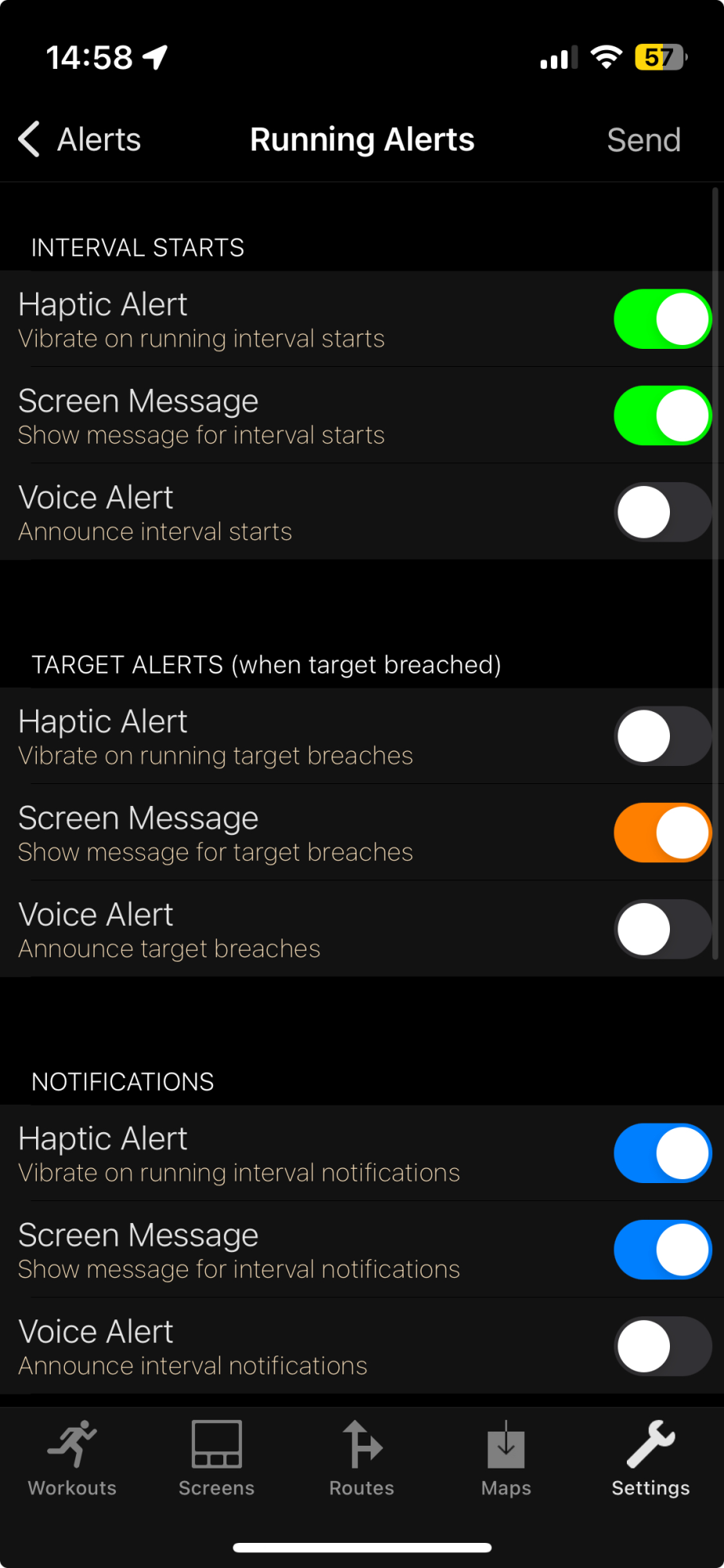

Is that possible to have just a countdown vibration (with or without headphones)? It doesn't need to vibrate 5 times, just an alert when “5 seconds remaining”. I usually use the halfway alert on rest interval, but a vibrate alert when 5 seconds remaining would be nice!
In theory if the interval countdown alert has haptic enabled and voice disabled then you should feel a vibration with 5 seconds to go (with timed intervals).
To configure this go to either "Settings / Alerts / Scheduled Interval Alerts" or "Settings / Interval Schedules / Schedule Alerts".
Well, I think that my settings is right but it still doesn't have the haptic alert. When I enable the voice alert too, the Apple Watch Ultra speaks when it has 20 seconds remaining, 10 second then 5 to 1 countdown (all without haptic). But with voice alert disabled and just Haptice Alert and screen message enabled, it does nothing.
Haptics can be hard to notice when running. It is worth going to Apple's Settings app on the watch and enabling Prominent Haptics (on the Sounds & Haptics screen).
I tested now, not running. I jumped to the recover interval and could feel the half way haptic alert that I enabled but not the countdown haptic alert. Actually, it does not vibrate on countdown even when it has the voice alert enabled.
That’s strange. Sorry that I can’t help.
Thank you!
