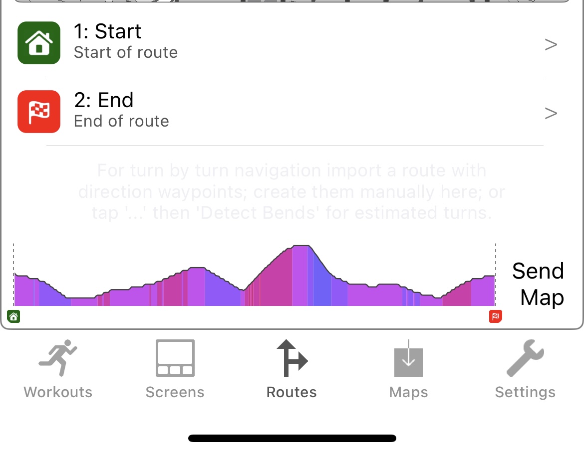

Wow, you tested that fast! The app will only give turn by turn directions if they are contained as waypoints in the GPX/TCX/FIT file containing the route.
I have included a (slightly hidden) "Detect Bends" function to autogenerate waypoints for bends based on the shape of the route. However I am not sure if I will include that in the final version because it is far from perfect.

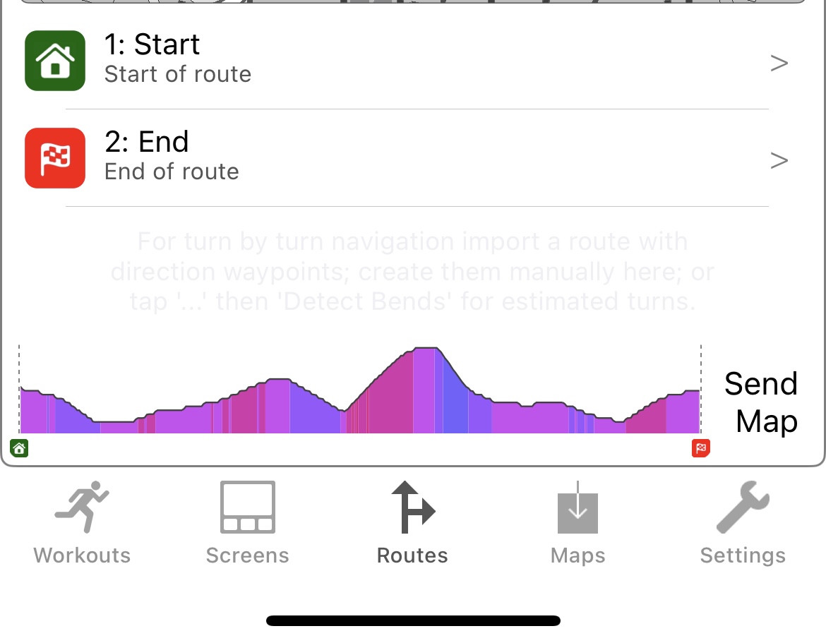

About that “slightly hidden” Detect Bends function… I can’t find it. 🙂
Select a route in the iPhone app then go to the Waypoints tab and tap '...' and it will appear in the menu.
It's not great at the moment (especially for twisty routes) but I aim to improve it during beta testing and then make a decision about whether or not to include it.

Found it! Thanks to the “slightly hidden” help text…🙂

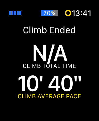

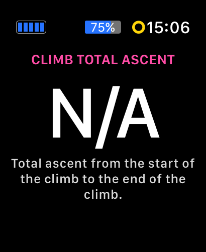

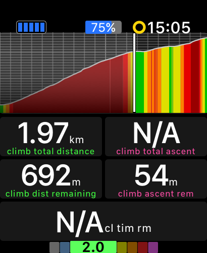

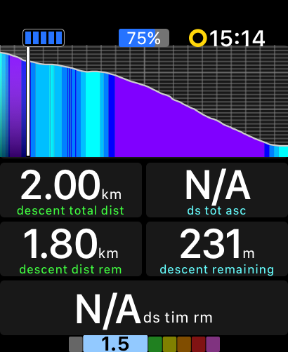

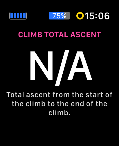

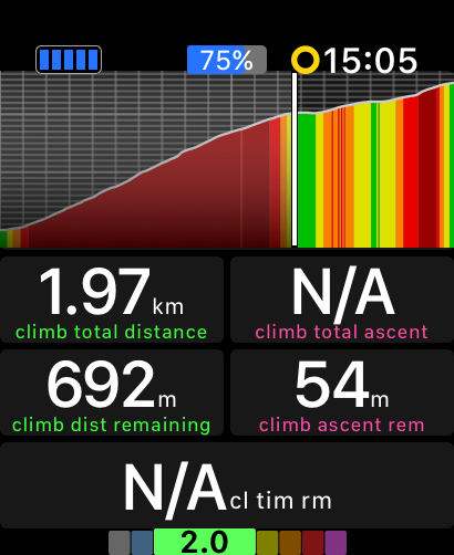

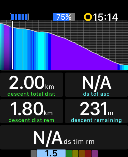

I have spent a total of 53km and almost 6h on three training sessions last week, testing the beta version while running on streets and trail running. I have been testing all the new features and I can say that I couldn't found any severe bug at all. Of course some small bugs (that disappear after closing de app or restarting the device), but the Apple Watch app has not crashed, not once, during activities (what is awesome!), only on the route screen on iPhone I had the app crashing two or three times.
A bout small bugs: I think that I found one on the climb feature, by the way, it's an awesome feature and it working very well. Its really nice how it works on iPhone looking automatically for climbs and descents on sent routes and giving us users the ability to choose the climb difficulty, so we can fine tuning it.
The possible bug: on the customized climb/descent screens below, the metric "climb/descent total ascent/descent" doesn't work. Climb time remaining metric seems to not work either.
Then, when I get to the climb or descent end, the alert screen doesn't show the total time, but shows the average pace. Although it shows this information later on workout summary screen on iPhone
Despite that, I really loving this new feature and again, its working mostly fine!
View attachment 2515718View attachment 2515719View attachment 2515721
Glad the beta is so usable. Thanks for testing it!
I will look into the slope metrics not working.
