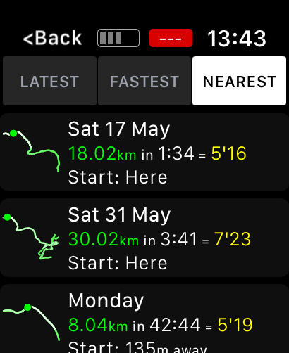

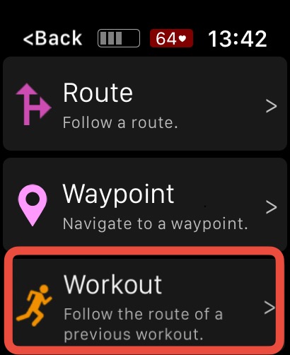

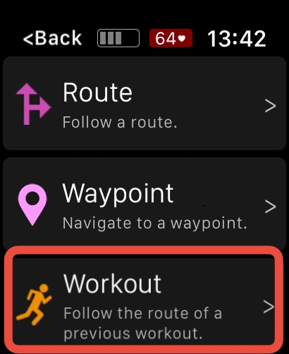

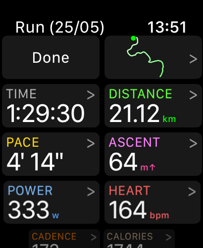

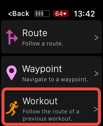

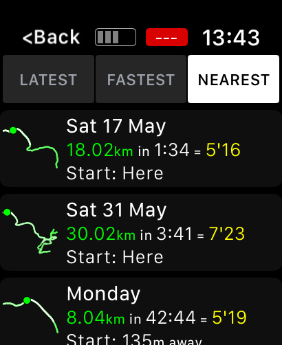

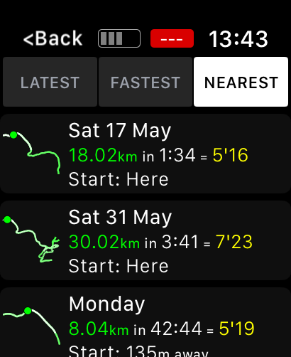

Hello!
I believe I have found a bug, it has been here since the first beta I think. But I forgot to tell, sorry
There’s a new option to navigate and follow a route of a past workout.
Then it shows the available workouts to choose from.
After I choose one, this screen shows and I don’t know what to do…
When I try to click “done”, it just jumps to the prior page and then shows another new workout summary page like before, automatically. And it keeps doing that forever, when I hit “done”, until I kill the app.
Reactions: cfc
Hello!
I must admit that I haven't looked at the target workout functionality for a long time so I may have broken it in the meantime. I will take a look.
Please could you report bugs to my email address rather than posting them publicly: info@workoutdoors.net. People skim-reading this thread may assume they are bugs with the release version rather than the beta. Thanks.

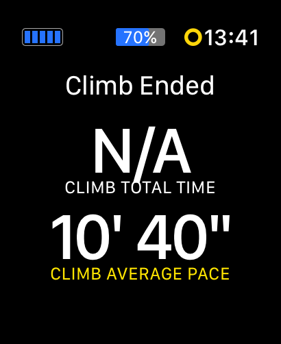

watchOS 26 is totally boring. No innovation or new functions for sports. Thought maybe there would be a map in the running app.
I have spent a total of 53km and almost 6h on three training sessions last week, testing the beta version while running on streets and trail running. I have been testing all the new features and I can say that I couldn't found any severe bug at all. Of course some small bugs (that disappear after closing de app or restarting the device), but the Apple Watch app has not crashed, not once, during activities (what is awesome!), only on the route screen on iPhone I had the app crashing two or three times.

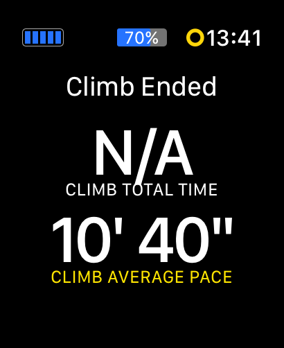

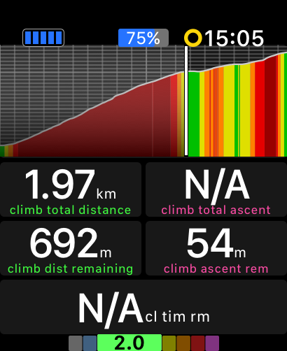

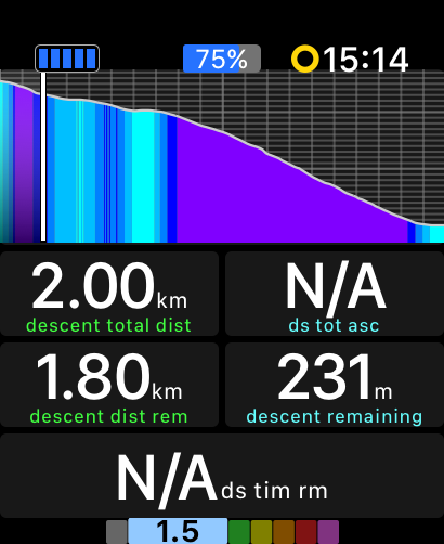

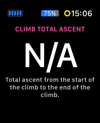

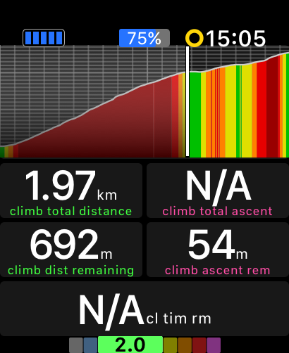

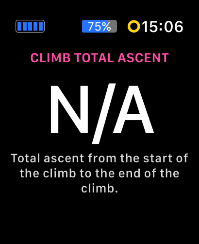

A bout small bugs: I think that I found one on the climb feature, by the way, it's an awesome feature and it working very well. Its really nice how it works on iPhone looking automatically for climbs and descents on sent routes and giving us users the ability to choose the climb difficulty, so we can fine tuning it.
The possible bug: on the customized climb/descent screens below, the metric "climb/descent total ascent/descent" doesn't work. Climb time remaining metric seems to not work either.
View attachment 2515718View attachment 2515719View attachment 2515721
Then, when I get to the climb or descent end, the alert screen doesn't show the total time, but shows the average pace. Although it shows this information later on workout summary screen on iPhone
Despite that, I really loving this new feature and again, its working mostly fine!

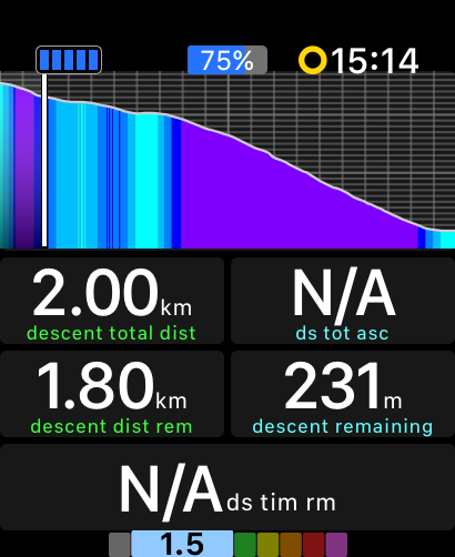

Hello,
Not able to wait until it is released .... 🙂
1749505939390-png.2517921
What does this 2.0 in green, and this 1.5 in blue mean?
How are the colors distributed in %? Green, yellow, brown, red, ....
Regards,
Jon
Regards,
Jon
Hello,
Regards,
Jon
Regards,
Jon
Hi! It’s just my heart rate zones. And it’s not a new feature, it is already available on the current oficial version of WOD.
Reactions: cfc
Ah, ok. At it is just below the altitude chart I thought 2.0 were the distance and green the average grade.
But the altitude chart it is from the beta, no?
