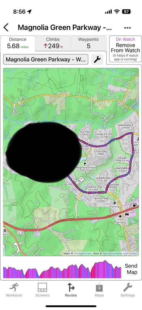

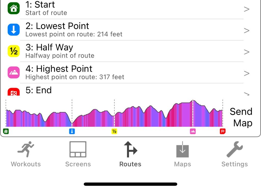

I’m not getting a notification when coming up to a turn point. I get other notifications (e.g., climbs), but not turns. Wondering if this is because I’m using the wrong kind of GPX file. These are my current settings
Does the route have navigation waypoints? To check go to the Waypoints tab for the route in the iPhone app.
If it doesn't then the app has a Detect Bends option if you tap the '...' button in the top right corner. This option looks at the shape of the route to try to determine bends. It is not perfect but probably better than nothing.
It does have the waypoints. That was my first thought, maybe I was using a course as opposed to route.
Wait…. You’re right. Doesn’t have the turns.
Reactions: cfc
Have you looked at the waypoints in that tab? The 5 waypoints shown in the tab title are probably the ones auto-generated by WOD: start, half-way, end, highest point and lowest point.

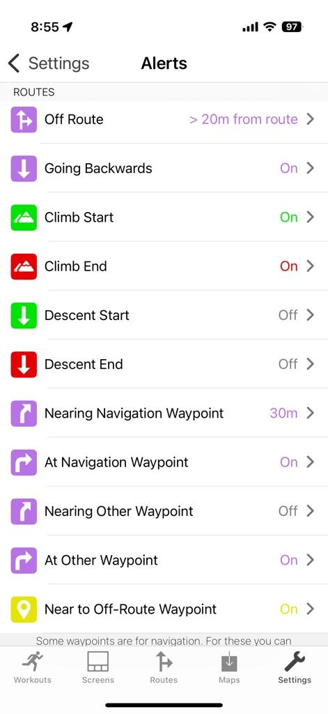

Note that on your settings screenshot you have notifications for "Navi WPs" on and for "Other WPs" off.
Once you will check WPs for the route you will find there sections: All, Nav, On Route and Off Route.
You can just turn notifications for "Other WPs" on and that will do the trick.
Or you can click specific WP and there is a slider to change it form "Other on route" to "Navigation".
Both actions will turn notifications about turns on.
Reactions: zach471 and cfc

Well explained. The idea is that there are some waypoints that you want to be considered higher priority, such as navigation waypoints. So by default you get notifications before turns as well as at the turn. You can also see the next turn and the distance to it in the corner of the map, and at the bottom of the screen if you want.
For other waypoints like half-way, highest/lowest etc you get notifications when you are at them but not in advance. And you don't see them in the map corner because generally you want to look there to see what your next turn is. Although all of that is configurable, which is why there are a lot of new options in this beta.
