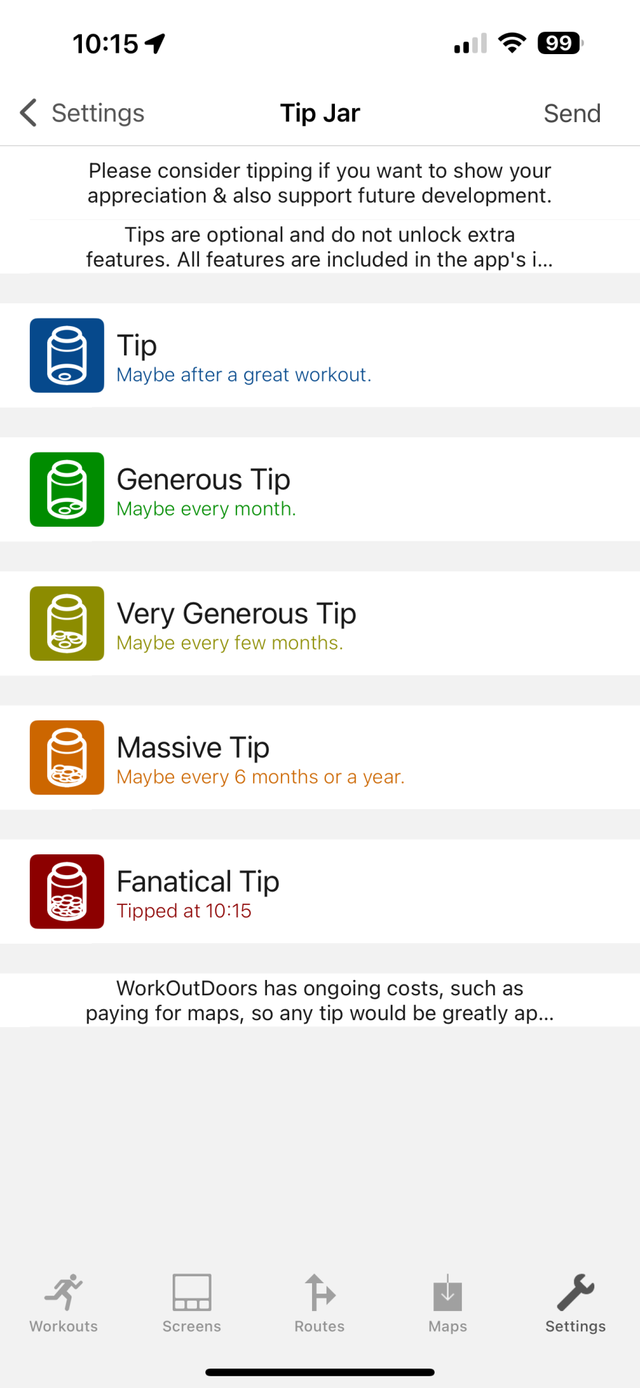

A Fanatical Tip went to the developer — and I strongly encourage everyone who’s satisfied with this app update to do the same to support further development.

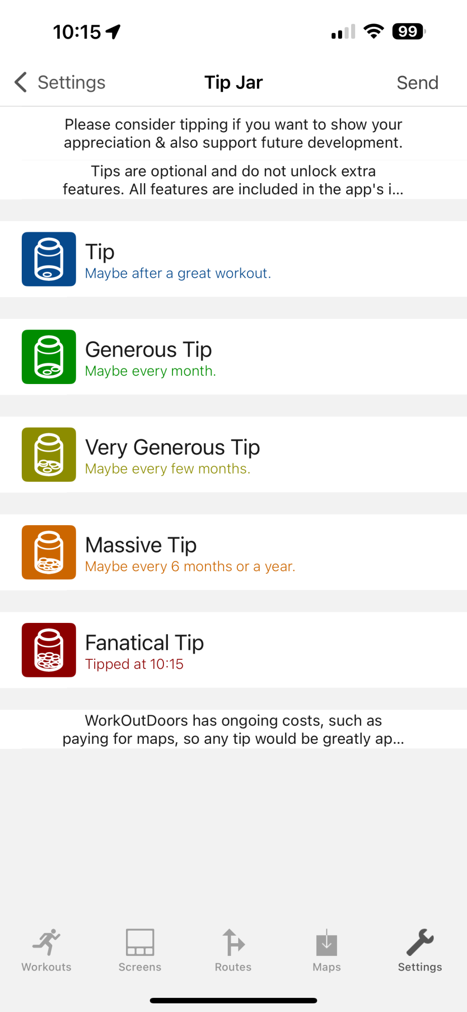

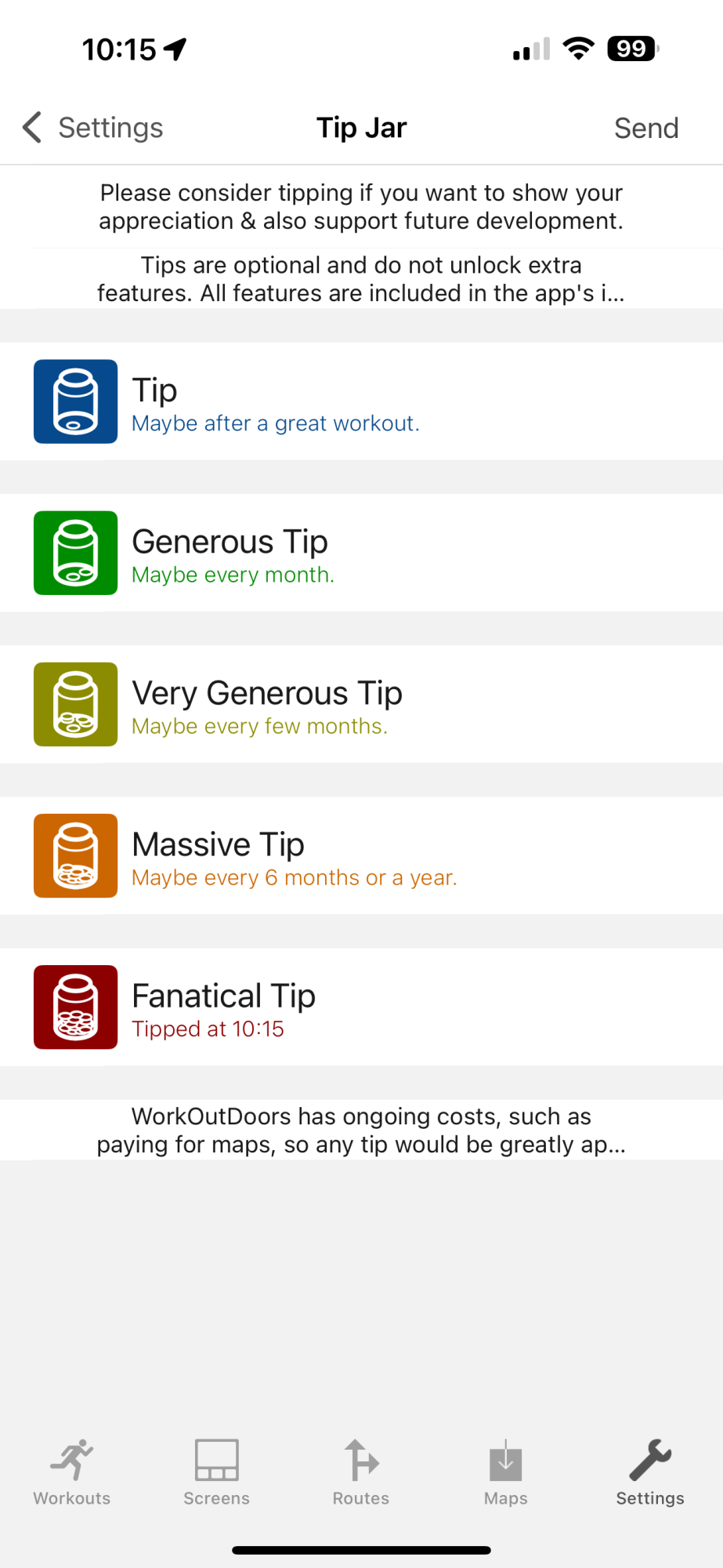

Many thanks for tipping so generously - I really appreciate that!

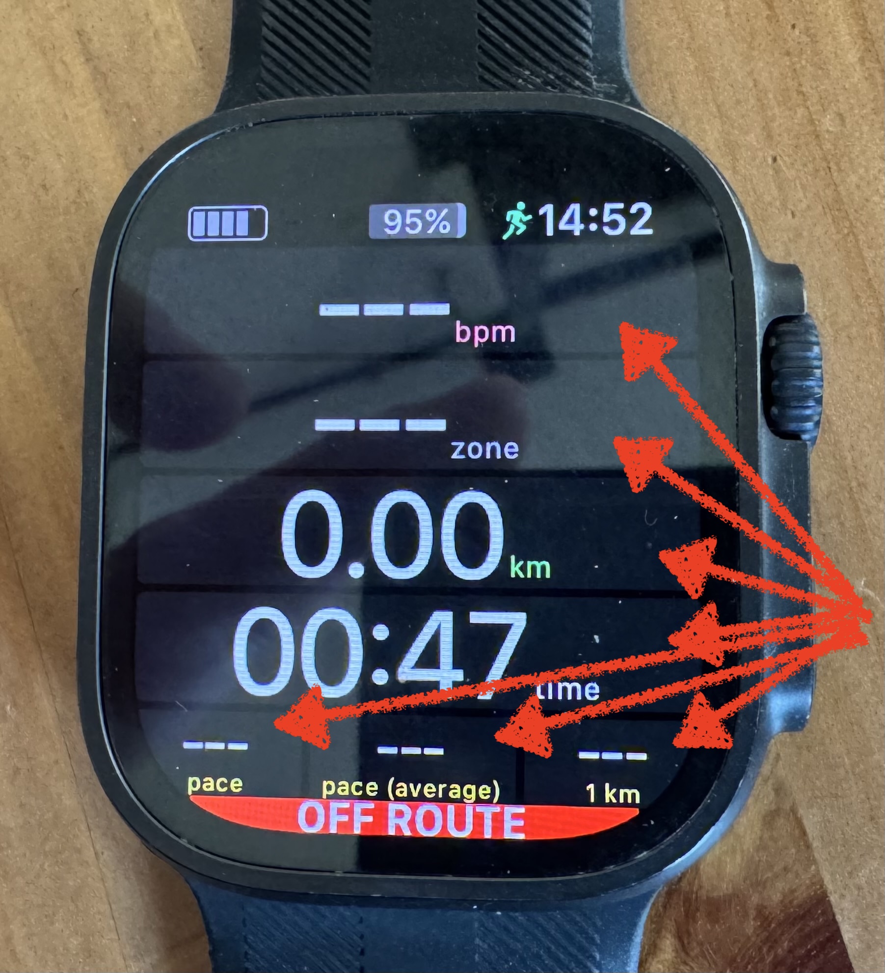

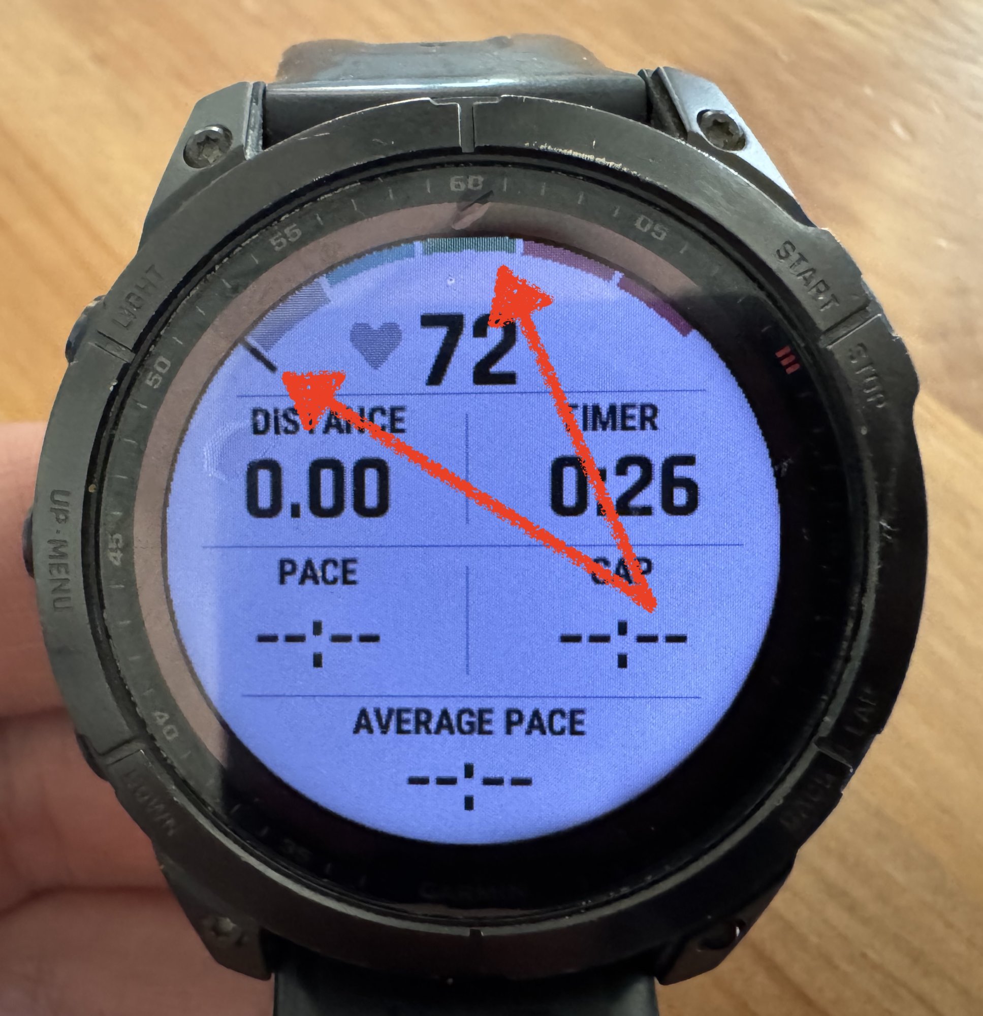

BTW, I was trying to set up 2 things from forever. Could you please tell me if this is possible in WO? (or could you make it possible? 😉)

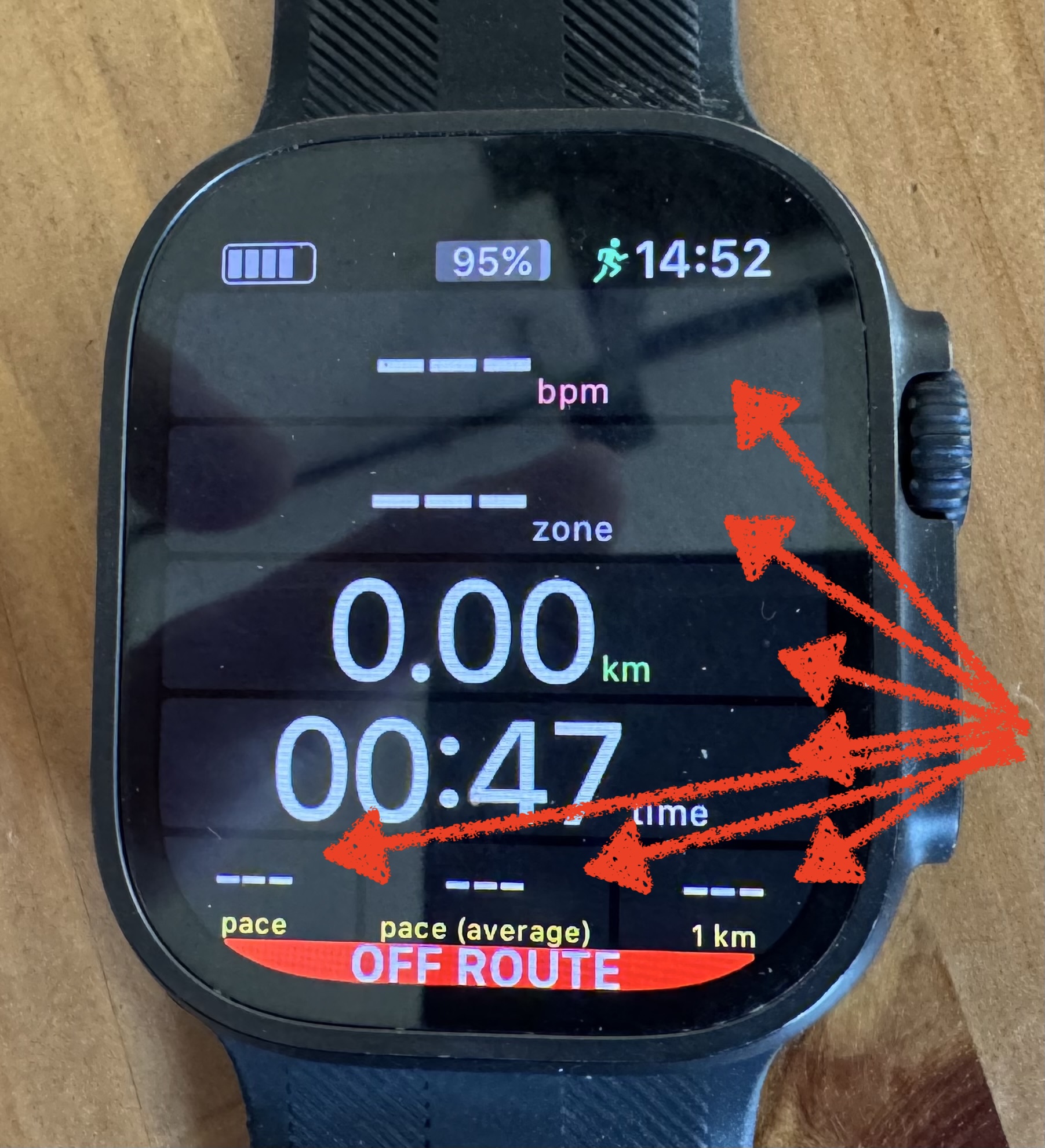

1 - WO AW app screenshot - can I make the datafield background BLACK? Like #000. Not only will it look way better (solves also lack of padding problem), but it will increase battery life on OLED devices.

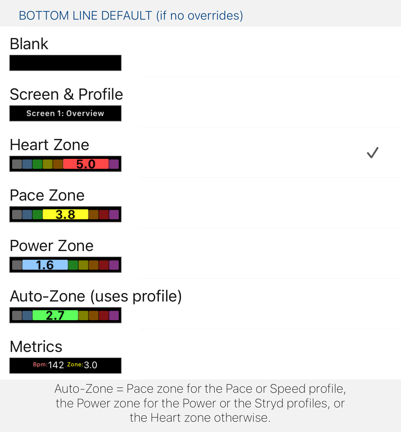

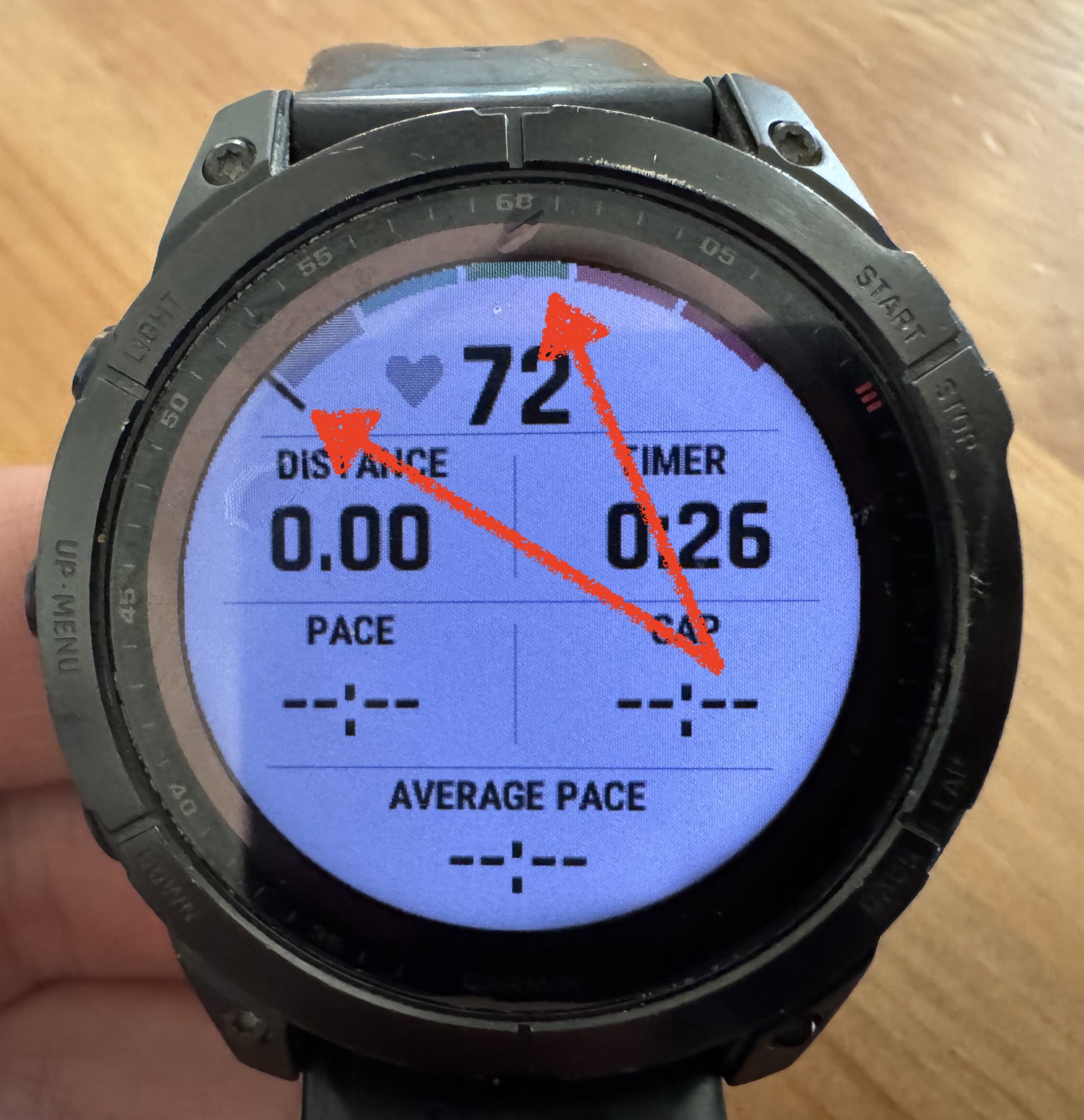

2 - Garmin watch screenshot - is there a datafield that combines both current HR and a simple gauge which zone am i currently in? There is a bottom line widget (WO ios app screenshot) that is almost exactly what I am looking for, but it is a) super small and b) doesn't show current HR.

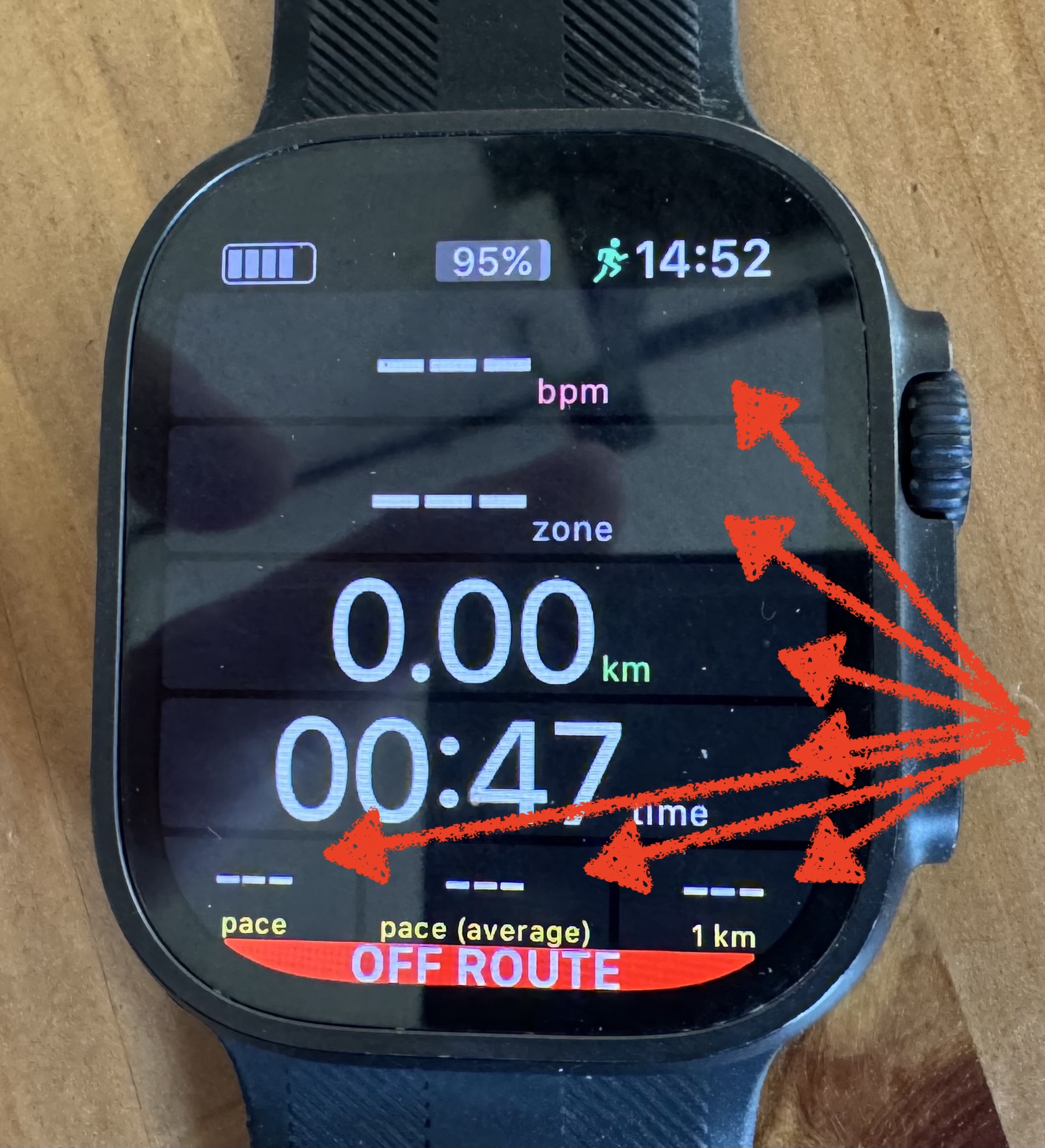

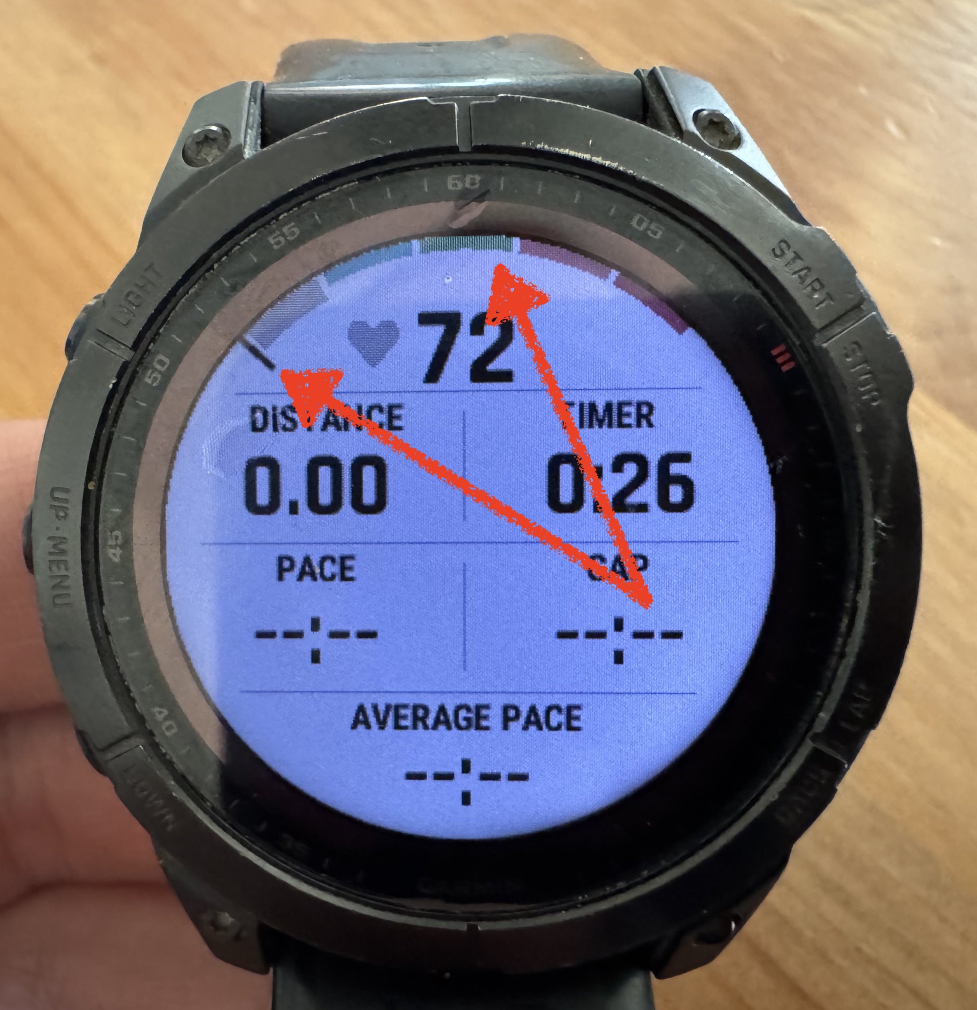

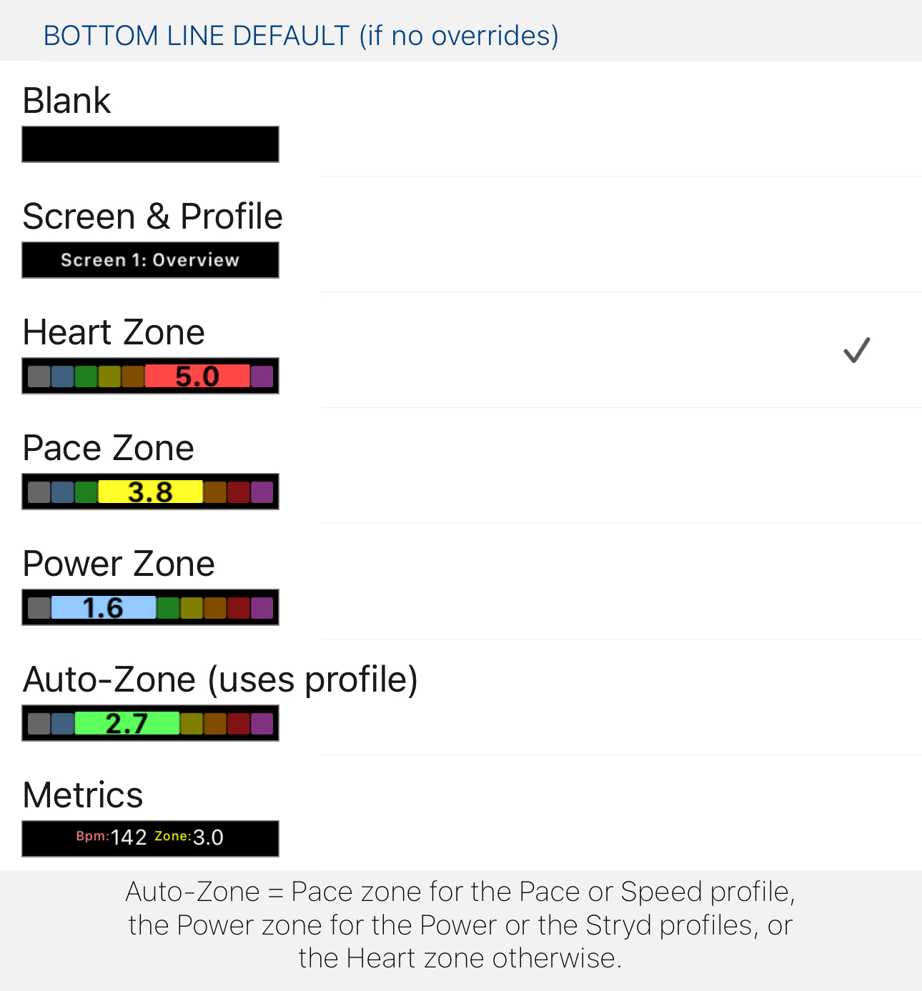

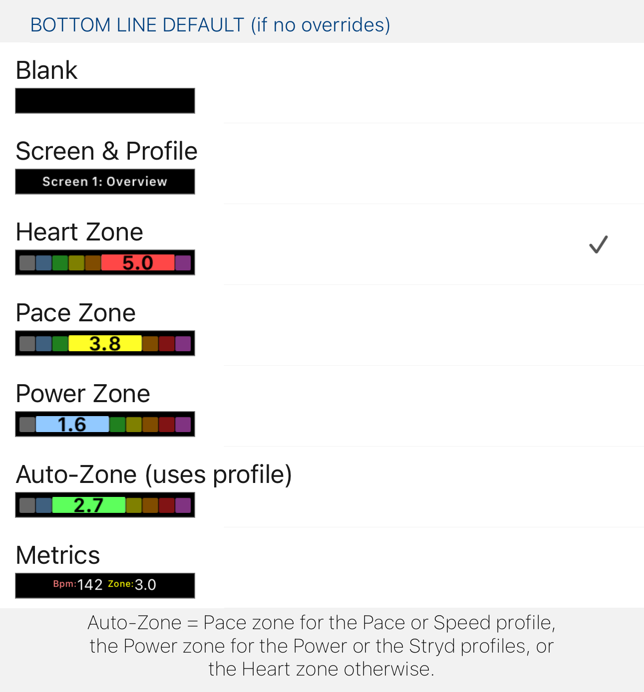

It is not possible to make the background completely black. I may add it if enough people request it though.
There is a new metric in the latest version that shows the BPM with the background colour of the heart zone. To use it go to the Screens tab and configure it in a screen. It is called Coloured HR (Current).
