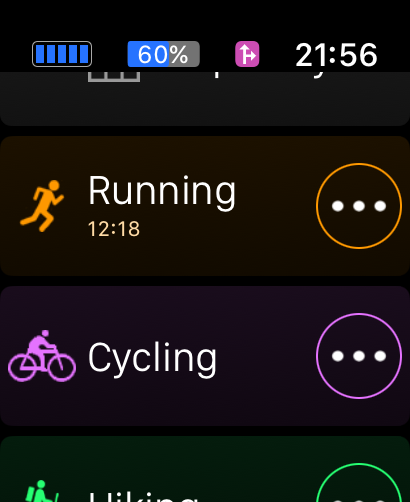

Has anything changed in the layout with the new version? The individual sports used to be much smaller. I thought that was better and clearer.
I can't remember changing anything in that area. No-one else has mentioned it though, so I don't plan on changing anything. Sorry.
Interesting.
I‘m sure that before the update there was less space above and below the sport. In other words, you could see more sports at a glance than you can now
I may have changed it but forgot. This version has taken well over a year of coding so I could have changed it a while ago.
Maybe I figured that most people generally only use a couple of activities so it was better to make them larger and easier to tap so they don't hit the wrong one. It's not as easy for people who do more than 2 activities regularly but they are in the minority. Sorry about that.
I may make it optional in the future if enough people request it.

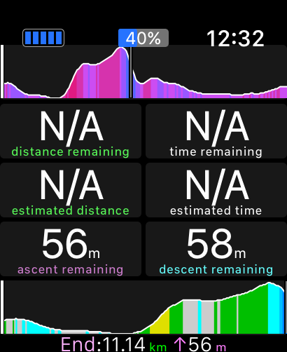

Congrats for releasing the new version and your amazing work. The new routing options are amazing.
While playing around with them the last days I stumbled over an issue when using interval workouts combined with a route.
My hope is that I can use intervals that have no distance defined together with a route.
Till now I have not found a way to make that work. Metrics that use distance seam to have no data even if that number should be available from the route.
So in my case metrics like
- distance
- distance remaining
- time remaining
- estimate time
don’t work.
At the same time other metrics that are ascent or descent related look to be taken without an issue from the route info. The info for the distance seams to be available as the distance remaining is shown in the “bottom line” but not in a metric tile.
See attached screenshot for reference.
Can you give me any hint how to set this up properly to get it working?

It sounds like there may be some sort of conflict between routes and interval schedules for those metrics. Please could you send the wkt file for that workout to info@workoutdoors.net
To do that please tap the Export button 3 times quickly. Thanks.
