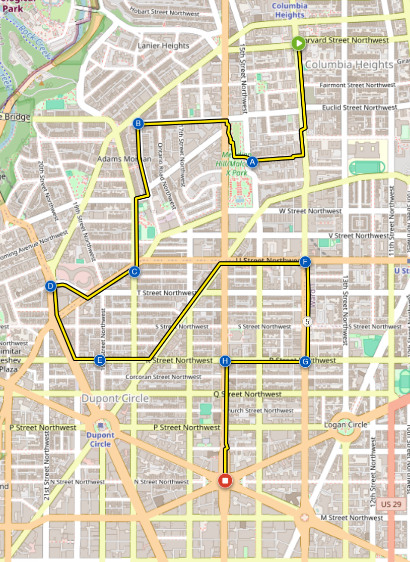

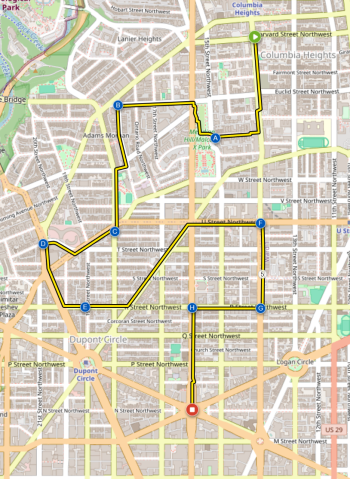

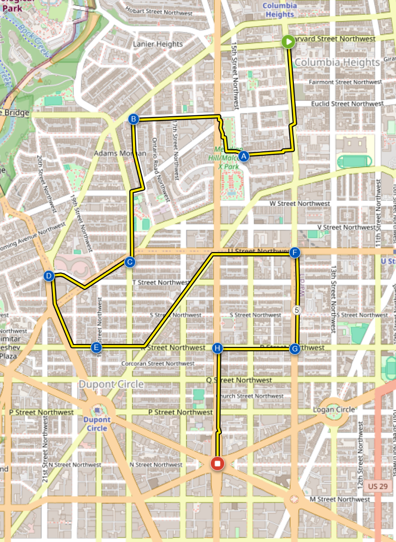

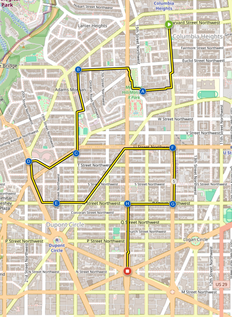

Bikerouter.de is excellent and very flexible. It is focused on cycling, but it also has a "hiking" profile in the menu in the top left, which I use occasionally. I have not had the time to check the navigation waypoints though, maybe later this month.
I tried and it doesn't seem to add Nav waypoints. Could be user error though
@blimundus have you tested out the navigation waypoints yet?
Like @BD1 I also can't get turn-by-turn navigation when I exported the gpx out of https://bikerouter.de/?lng=en
The waypoints (A to H) are all shown as:

The app cannot identify those as navigation waypoints because they don't have instructions like left or right. Maybe I could make it so they are considered navigation waypoints if they say "via" but that may be confusing.
You should still hear an alert saying "via" when you get to those waypoints because the app gives an alert even for non-navigation waypoints. And you can set the route options so that you get all the advantages of navigation waypoints for all other waypoints. i.e. advance warning of "In 60m Via"; an icon on the map with the distance to the waypoint; auto-zooming when you get to the waypoint etc.
Reactions: oric1sg
Thanks Ian. I will give https://ridewithgps.com/ a try instead.
