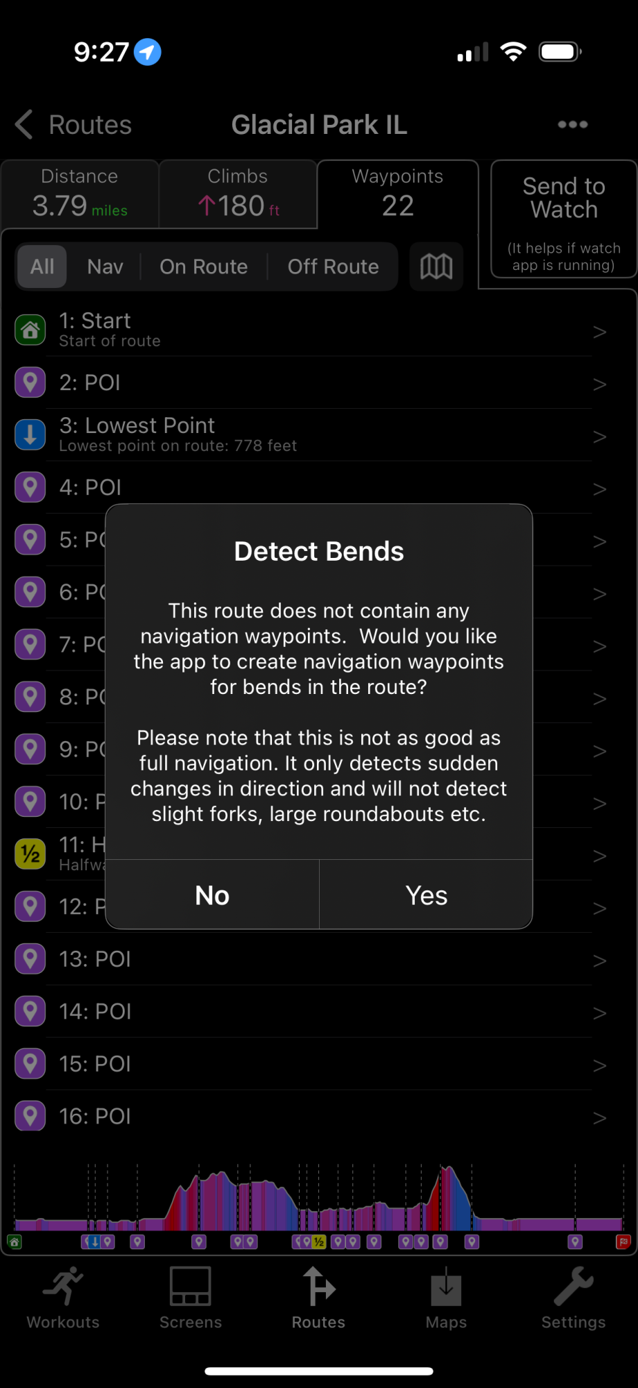

I am using beta version and trying to import a gpx file for route navigation and I get this message that there are not any waypoints and to use bends. But the file contains many waypoints?
I used a different GPX online tool and now it seems to have used the waypoints. Upon closer examination under Nav tab on iPhone it doesn't look right. Sending files.
Thanks. Those files just contain waypoints with a location and nothing else of use to determine if they are navigation waypoints. One file has names of the form "Untitledx' where x increases, but the other one doesn't even have that. No icon, name, description or anything that the app can use determine if they are a turn left or turn right etc.
They will be considered as 'Other' waypoints by the app so by default you will not get alerted when approaching or at them. However you could change this in the settings so it does alert you for Other waypoints as well as Navigation waypoints. You would at least know that the route is trying to tell you something even if you don't know what it is.

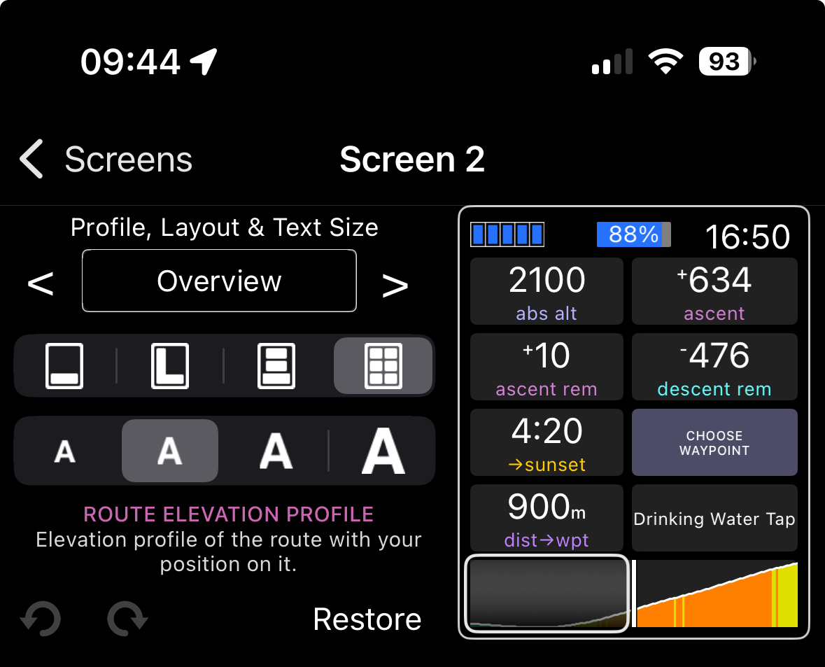

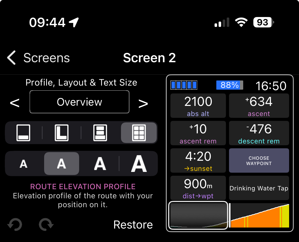

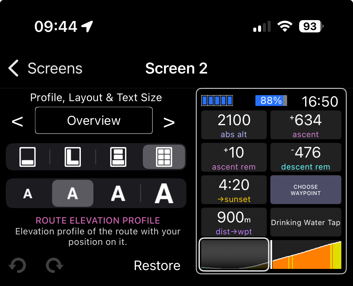

However as a result of your comment I did some testing and have found a bug where it doesn't show that if you are using the grid layout (the default is the L shaped layout). Is that what you are using? I will fix that in the code.
I'm using layout with two segments at the bottom for RouteElevationProfile.
No action when taped.
I thought I had fixed that, and it seems ok when I try it now. Are you using the latest version of the watch app (v.6.0.13)?
To check go to the watch app Settings and tap More and then scroll to the bottom. Don't check the version of the iPhone app as they can occasionally be out of sync.

The bend route feature works great! I think I was overly concerned about not having enough waypoints.

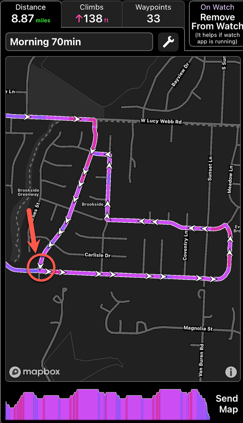

Navigation has been working great using watchOS 26. However, I have experienced abnormalities with routes with repeat loops/laps. In the screen capture below, there is a two-lap loop. At the circle, after the 2nd lap, navigation reset to the first lap, prompting for a left turn instead of a right turn. Is there a modification needed for routes with repeat laps/loops? Also, is it possible to run a route with a target or interval workout simultaneously?

Glad the bend detection works well. You should get a turn notification at the waypoint as well as before it. If you aren't getting that then please check that you haven't disabled it in the settings.
