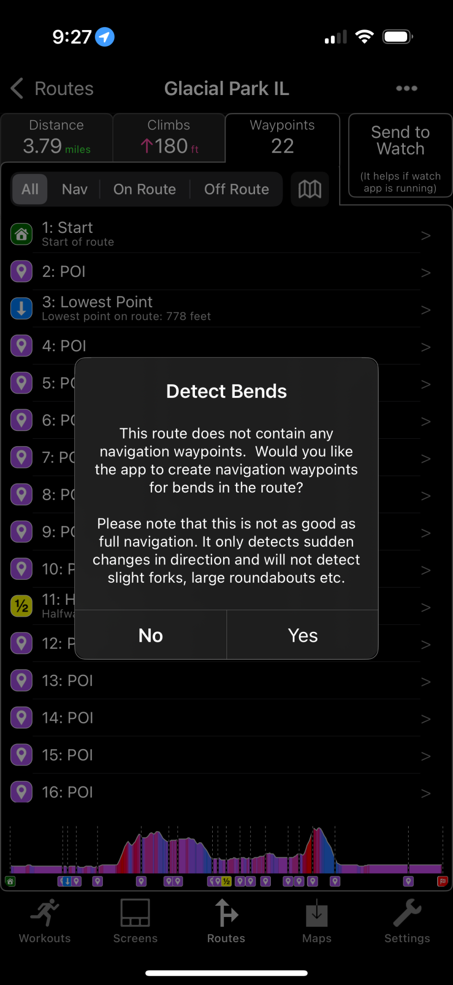

I've created a hiking route in Strava, then exported it as GPX and also tried TCX. Both times the latest Beta says
The route does not contain any navigation waypoints. Would you like to add them.
When I use Strava for biking and send it a Garmin 840 I get routing, am I missing something obvious to do at all?
As far as I know Strava do not include turn by turn navigation in their exported files. I wish they did. They send a different format with their connections to Garmin devices.
Thanks, whatever you've done to magically add them at a click of a button appears to work well from looking at the map, will find out on Saturday!!
The "Bend Detection" is not as good as proper turn by turn directions. It just looks for bends in the shape of the route rather than knowing about junctions. But so far most testers seem to think that it is better than no directions at all.

I am using beta version and trying to import a gpx file for route navigation and I get this message that there are not any waypoints and to use bends. But the file contains many waypoints?
