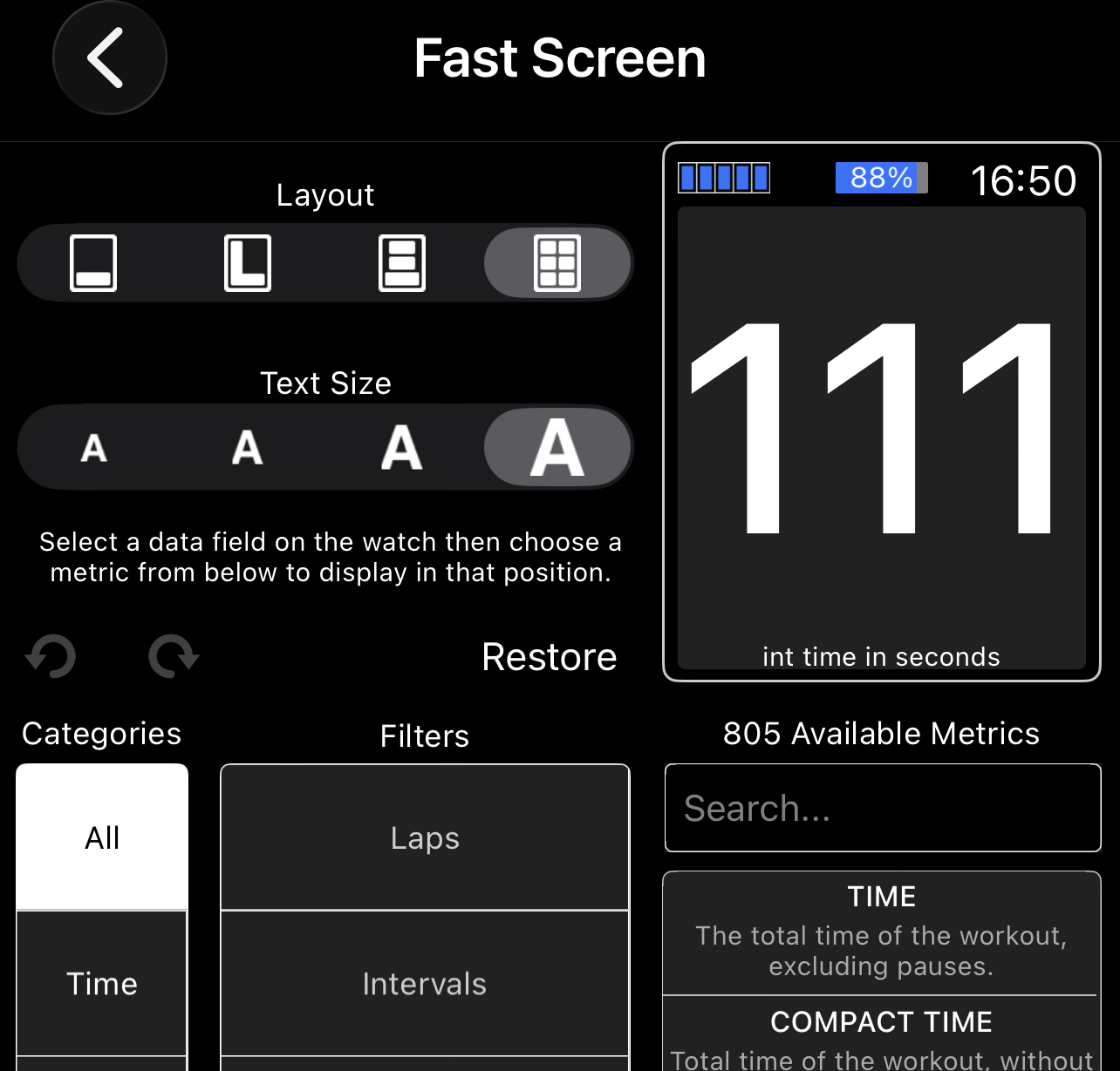

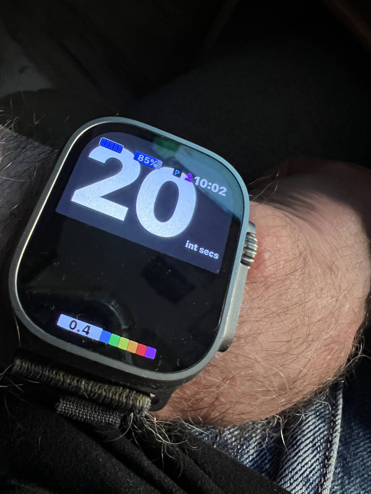

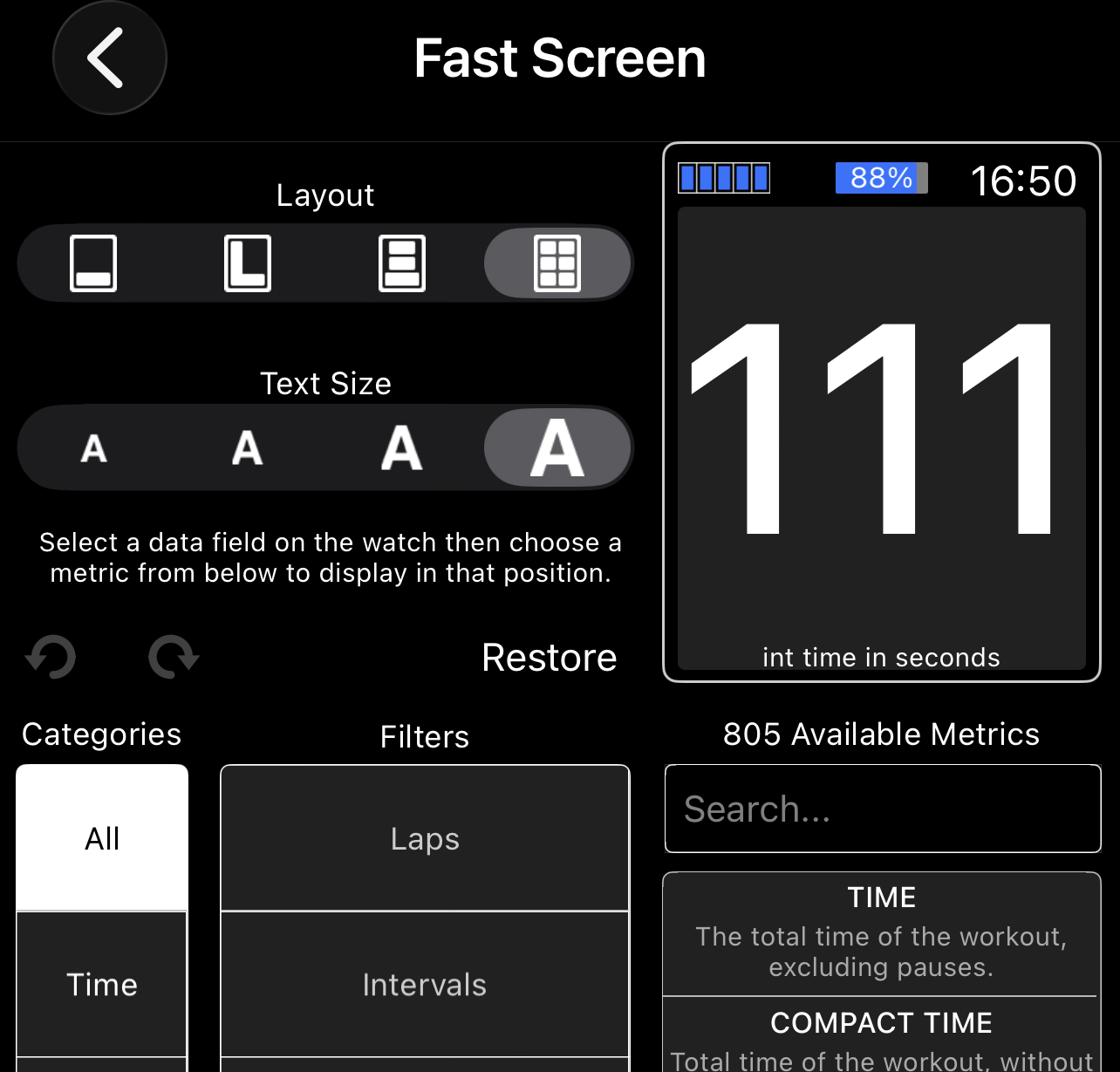

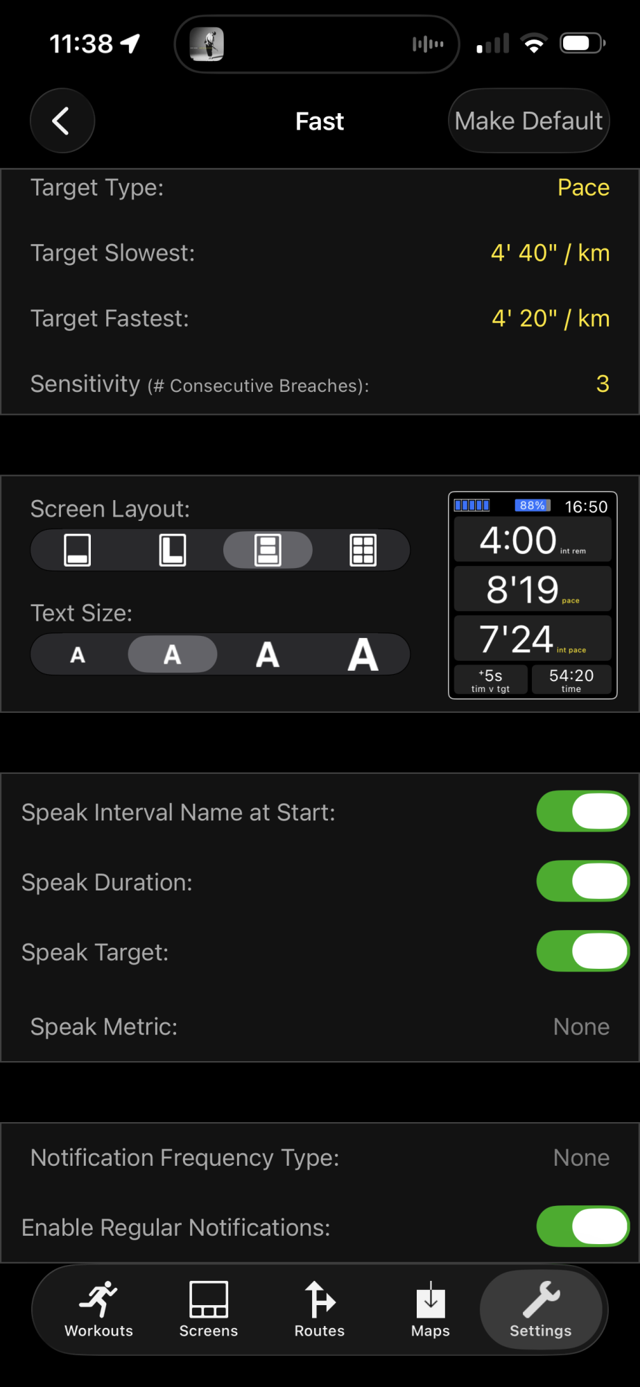

Is this a known issue? Set it up to merge, but only showing in the upper half?
Reactions: cfc

It wasn't known but it is now! Sorry about that.
I am surprised no-one has spotted that before. There are hundreds of possible layout merging combinations to be tested but I probably should have at least tried a single value. I will fix it in a future version.
No worries. You need more older runners with failing eyesight on your betas 😎 heheheh.

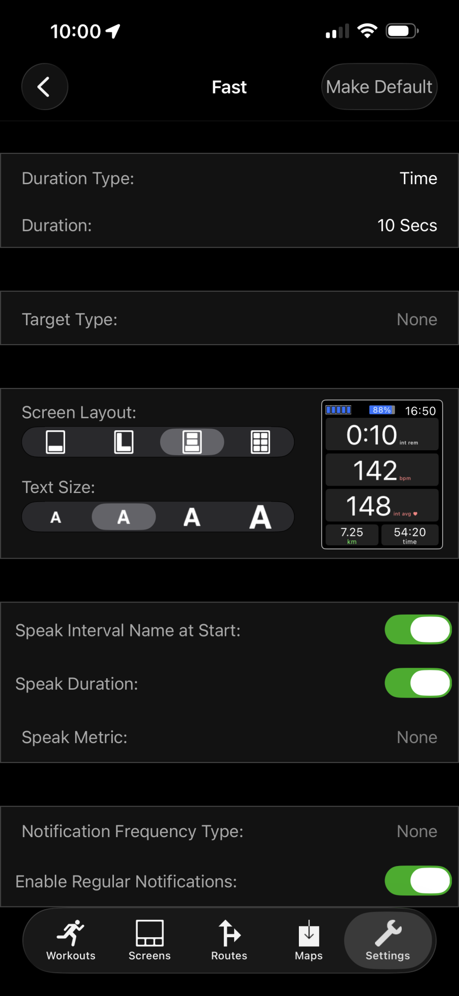

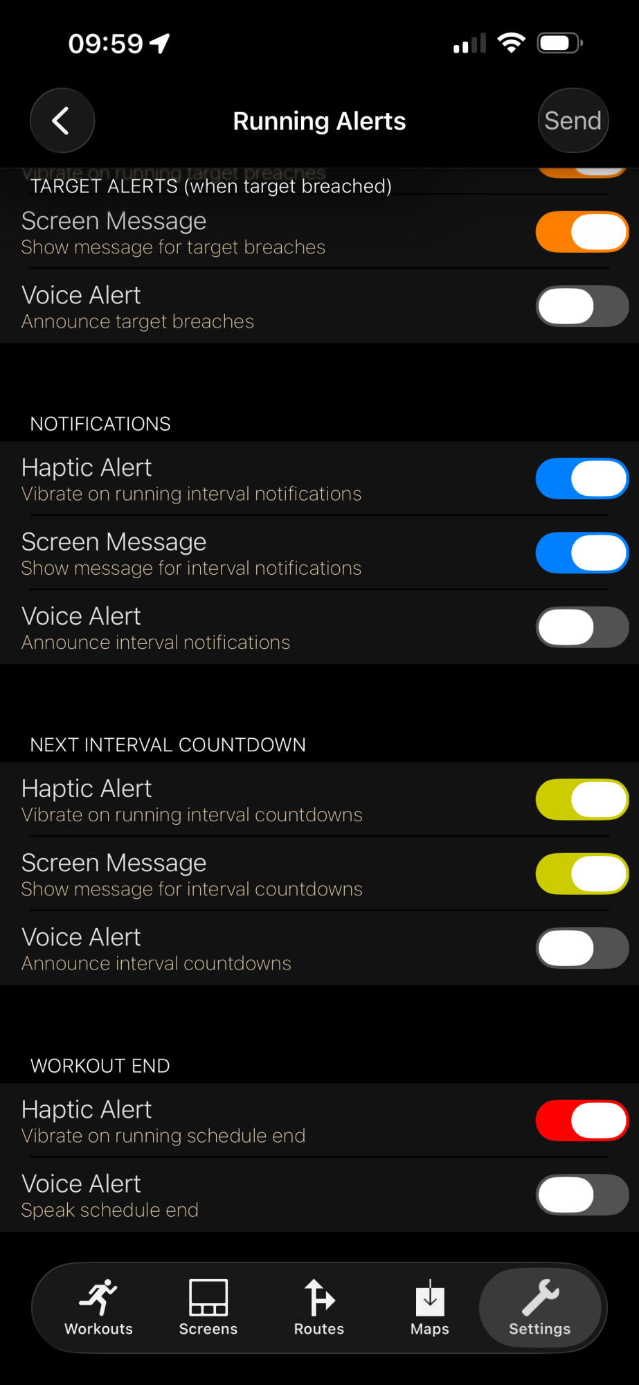

Is there a way to configure vibrating alerts to something like a warning 5 or 10 seconds before the next interval or a 5 second countdown (short vibration every second)?
The app should give a 5 second countdown with vibrations and spoken numbers at the end of a time-based interval. Are you not getting those vibrations? To check go to Settings / Alerts / Scheduled Interval Alerts or Settings / Schedules / Schedule alerts. Then check the switches are enabled in the Next Interval Countdown section.
Note that for distance based intervals it tells you the distance remaining when you are getting near the end of the interval.

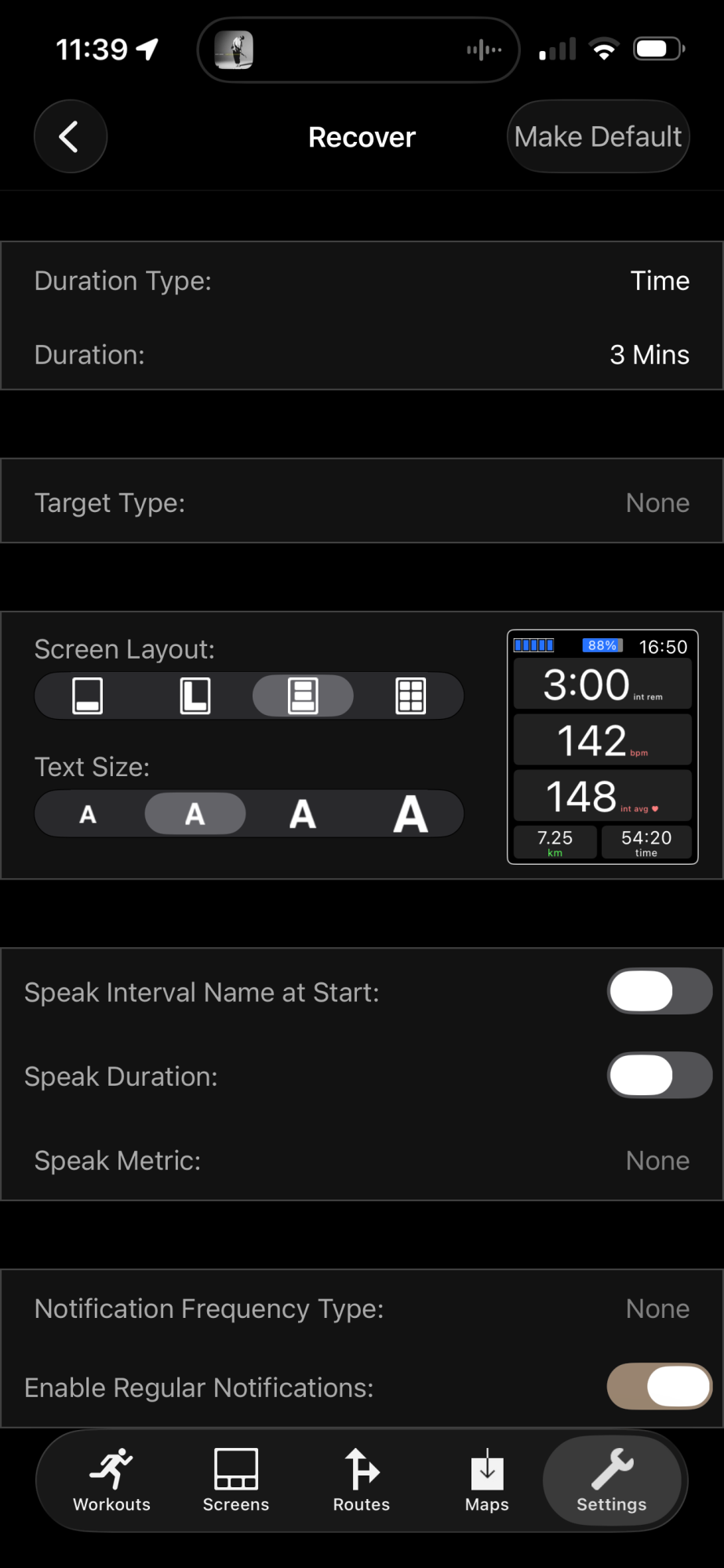

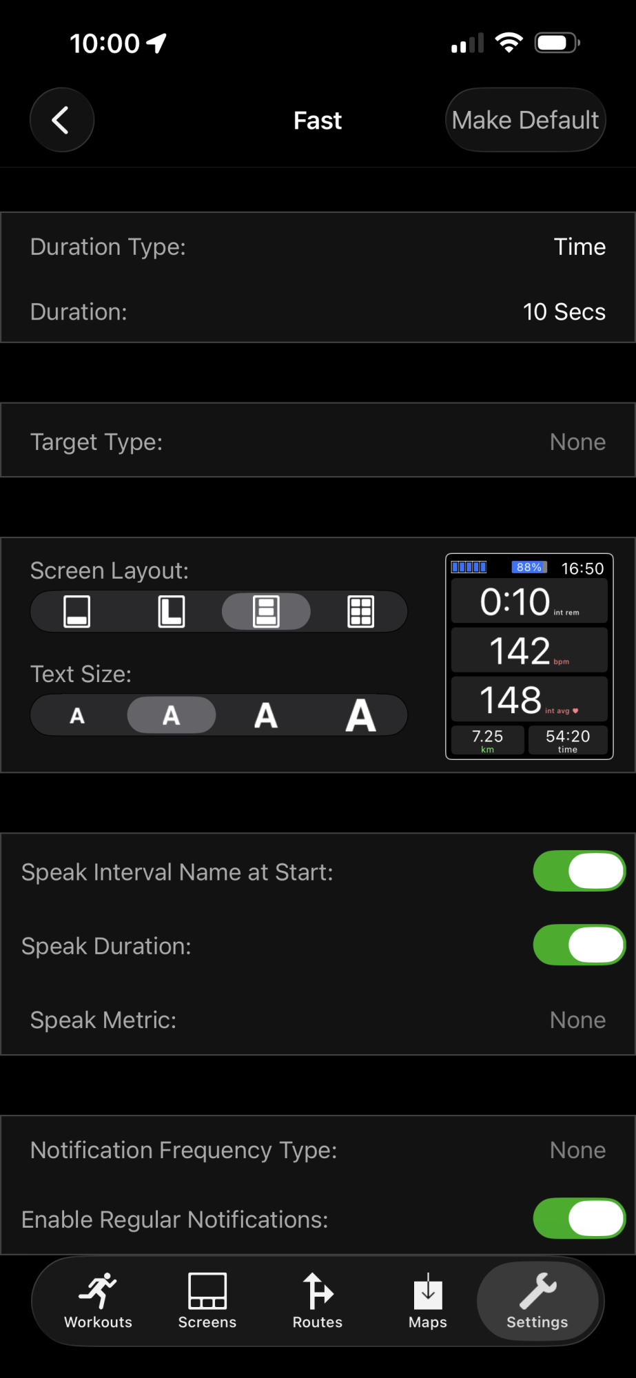

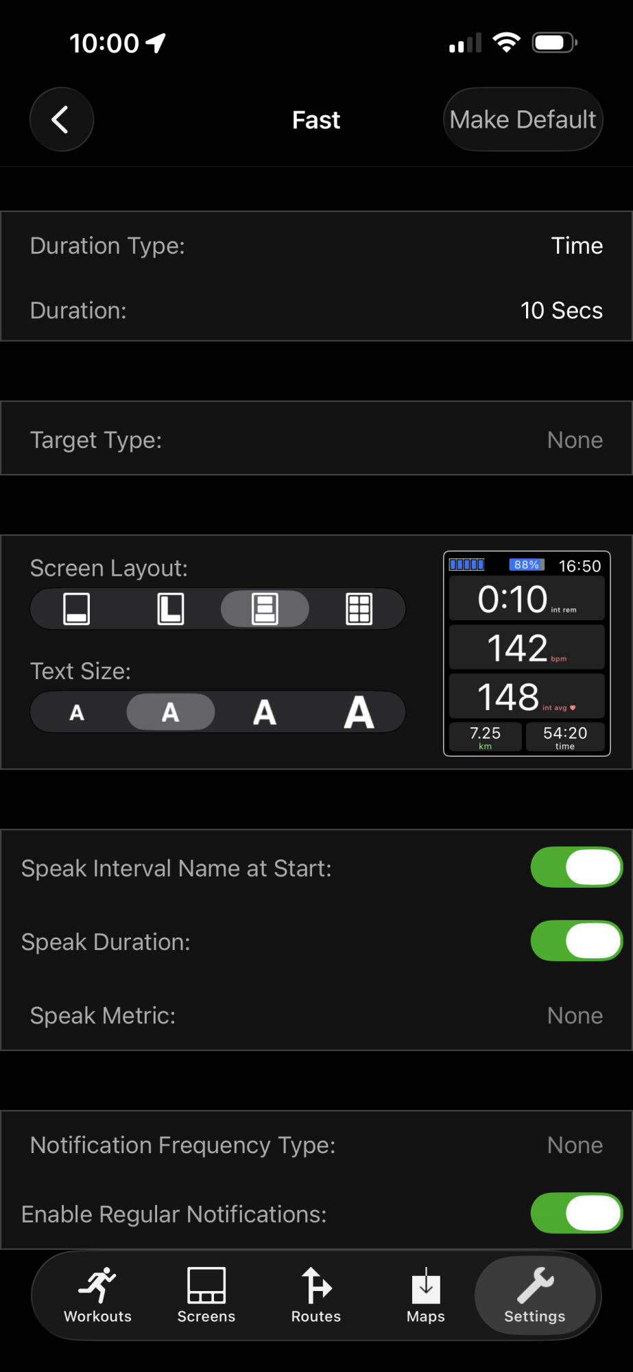

No, I only get a vibration and message at the start of the interval but not before.
View attachment 2601473View attachment 2601474
That is probably because the interval is only 10 seconds. The app does not give countdowns for intervals of 20 seconds or less because you would get overloaded with alerts.
I could change that if enough people request it but I can't remember anyone else mentioning it before. Sorry.

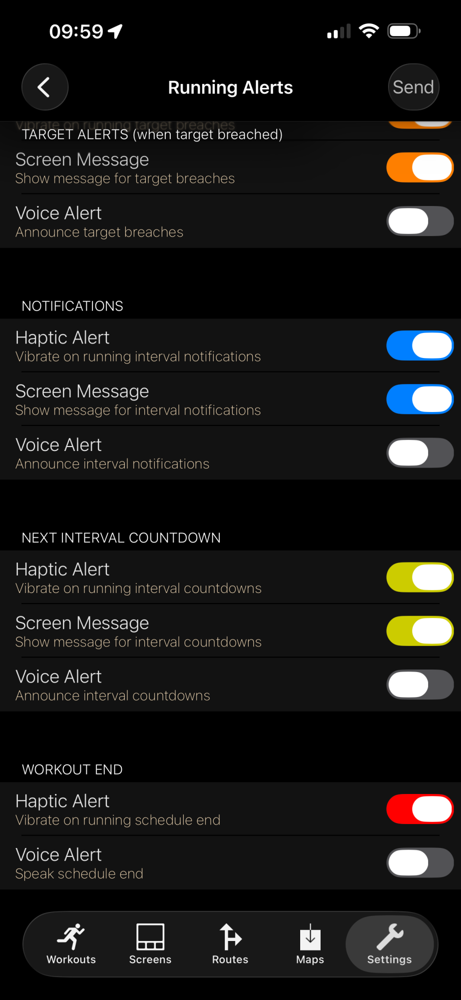

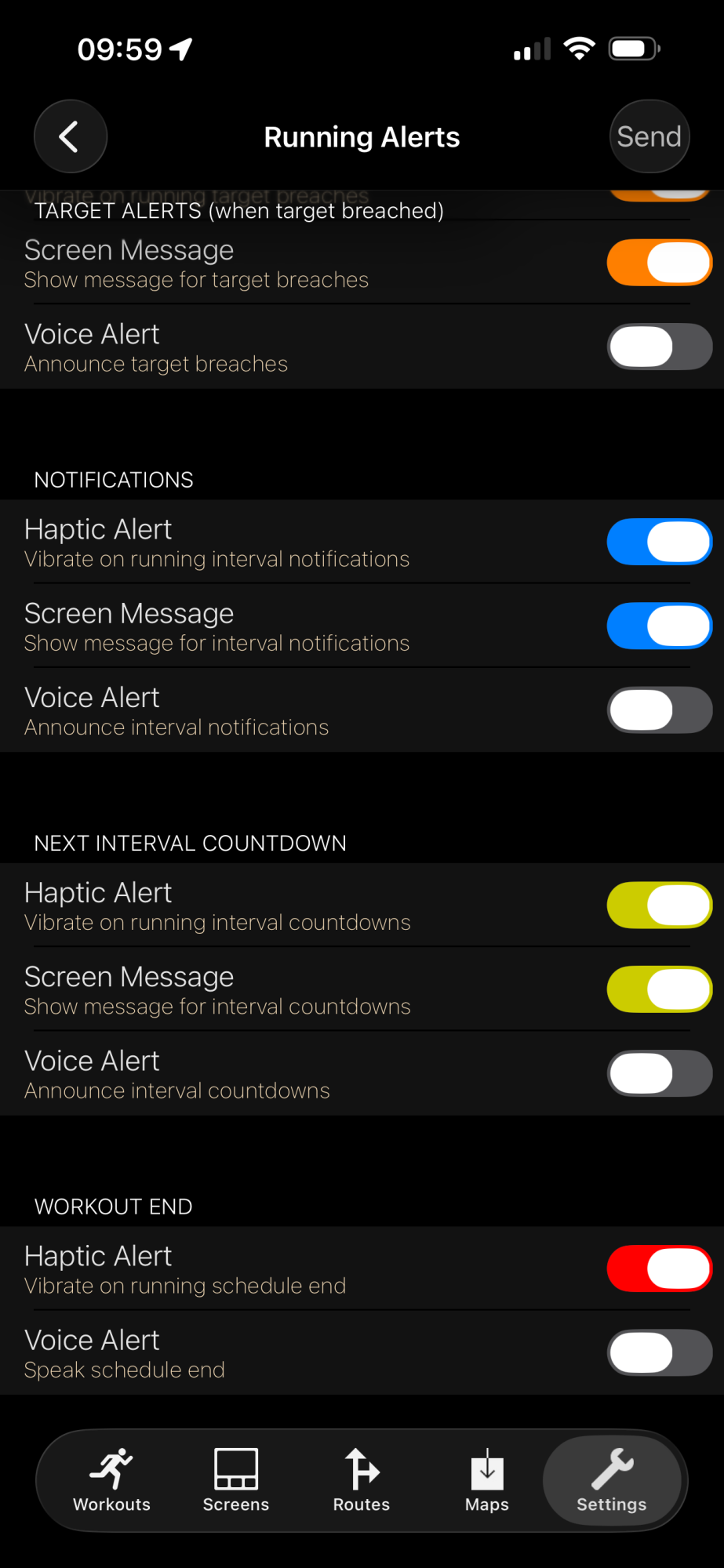

I also don’t get the countdown for longer intervals such as 3 or 4 minutes.
I’ve disabled the haptic alert, enabled it again and now it’s working.
It would be nice to customize the length (5 seconds would be enough for me) but I’m thrilled to have it working now.
So far so great 🙂
Is there a way to customize the length? Now it seems to be 20 seconds.
Glad it is working now.
The app will alert at 20 seconds, 10 seconds and 5, 4, 3, 2, 1. That can't be customised though.

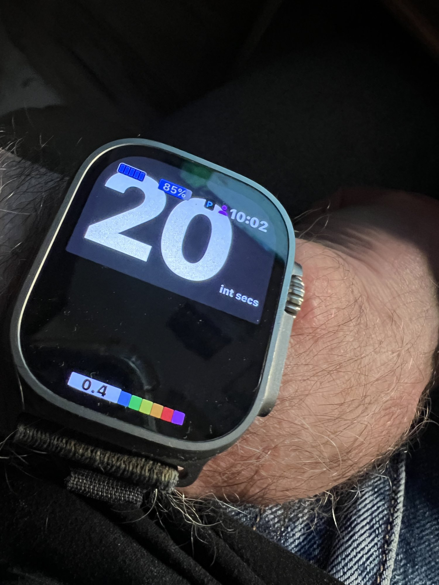

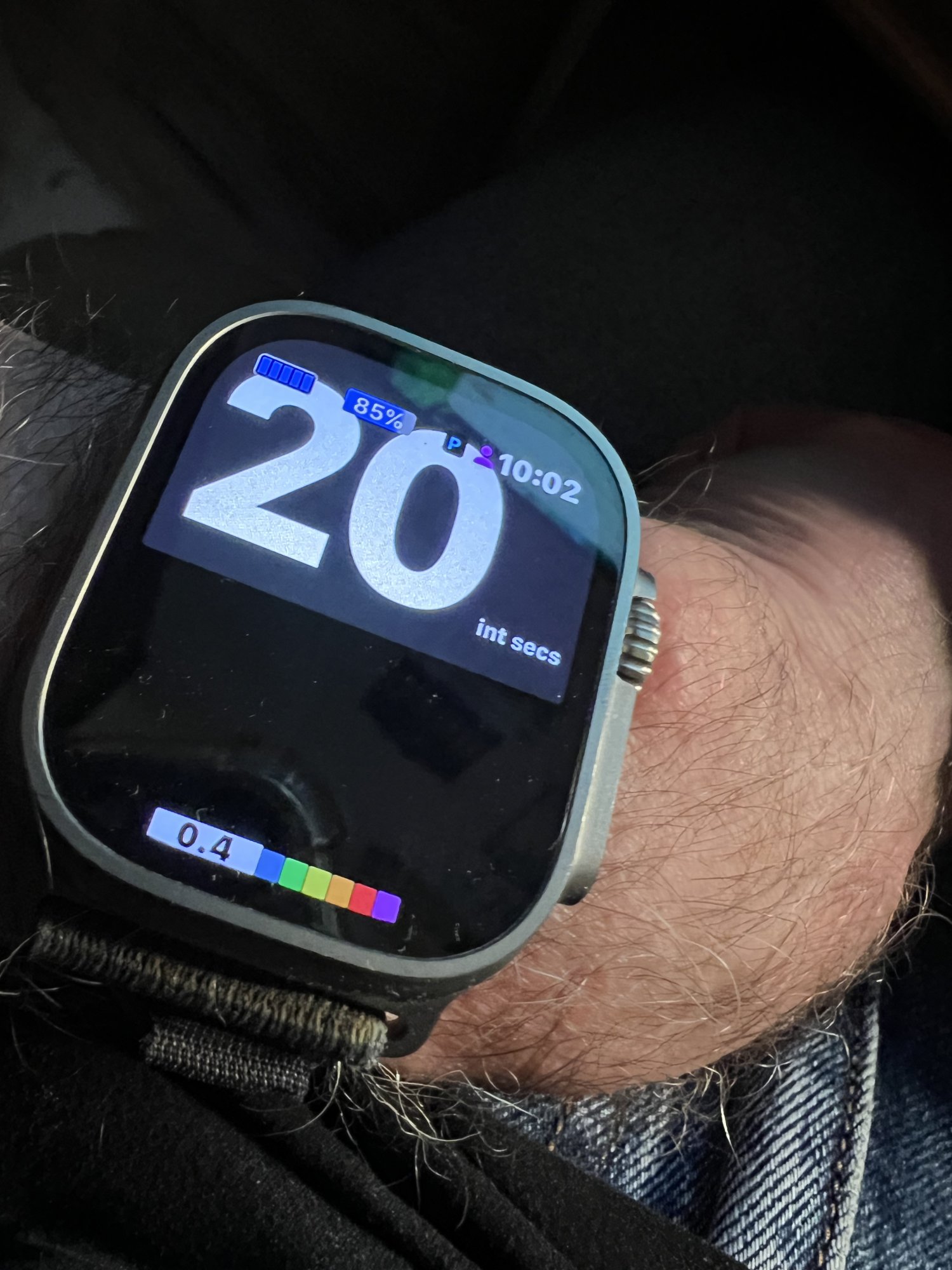

Went running today, it didn’t count down again. Disabled and enabled again. Then it worked again.
Also, the alerts start 20 seconds beforehand but are every second. Not 20-10-5-4-3-2-1.
So you are getting a vibration and a screen message every second for the last 20 seconds at the end of a workout?
I have never heard of that and have absolutely no idea why it would be happening. Sorry.
