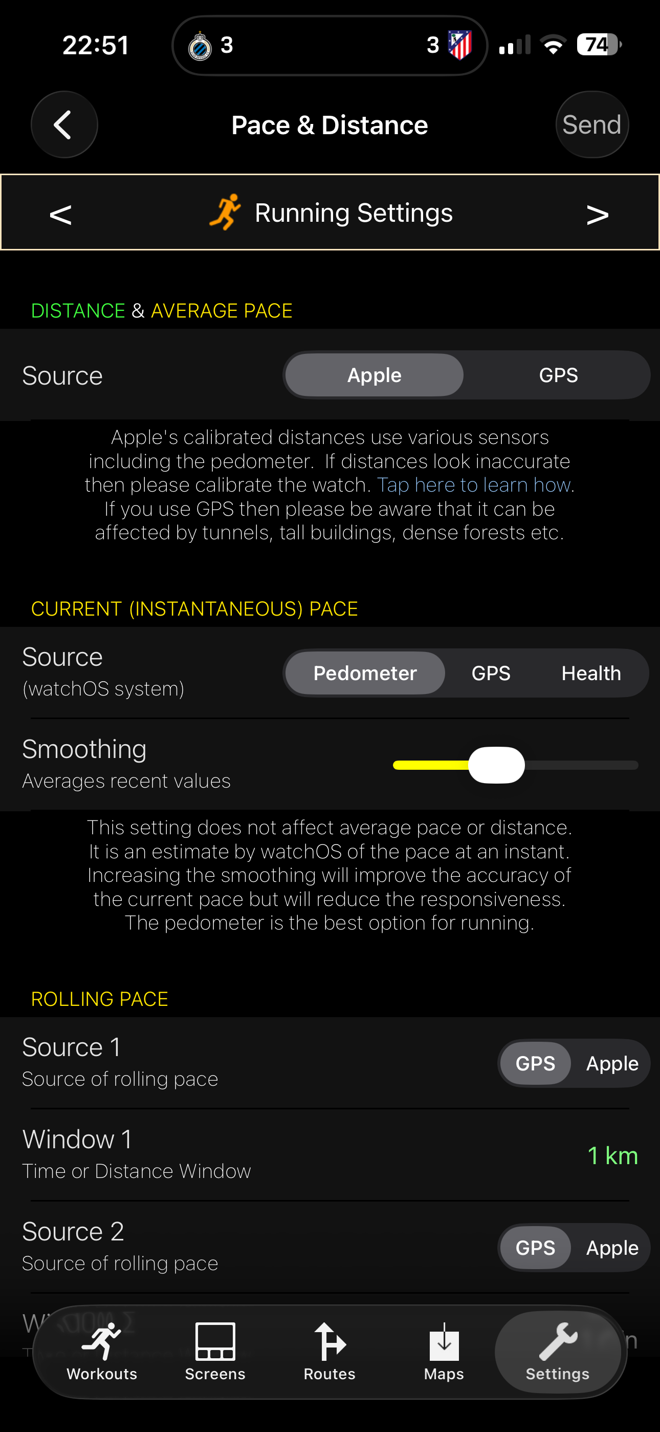

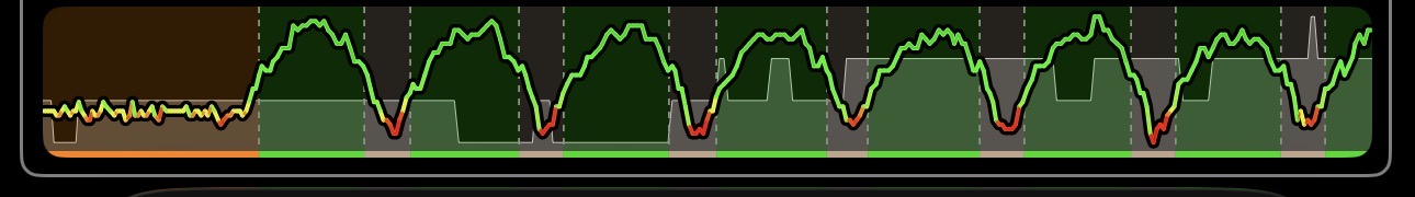

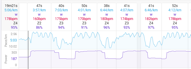

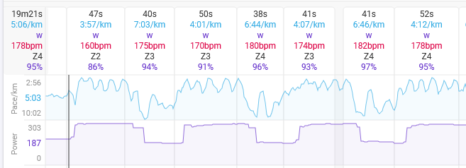

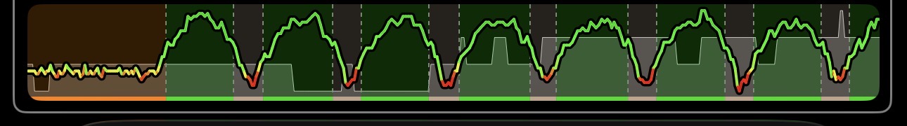

Hello, would you have any tips about reducing the oscillation of the pace measurement for running?
I observe a lot of oscillations when analysing the pace graph from my activities on intervals.icu. Below is an example of an interval session.
It is less visible on the Worktoutdoors app, though the curve looks too "curvy" (in theory it should have more of a trapezoidal profile like the power curve above).
Here is my setup:
-Apple Watch Ultra 2
-Activity uploaded to Strava and Strava synced to intervals.icu
-Pace & Distance Settings:
I was thinking of lowering of disabling smoothing completely, but any suggestions are welcome.

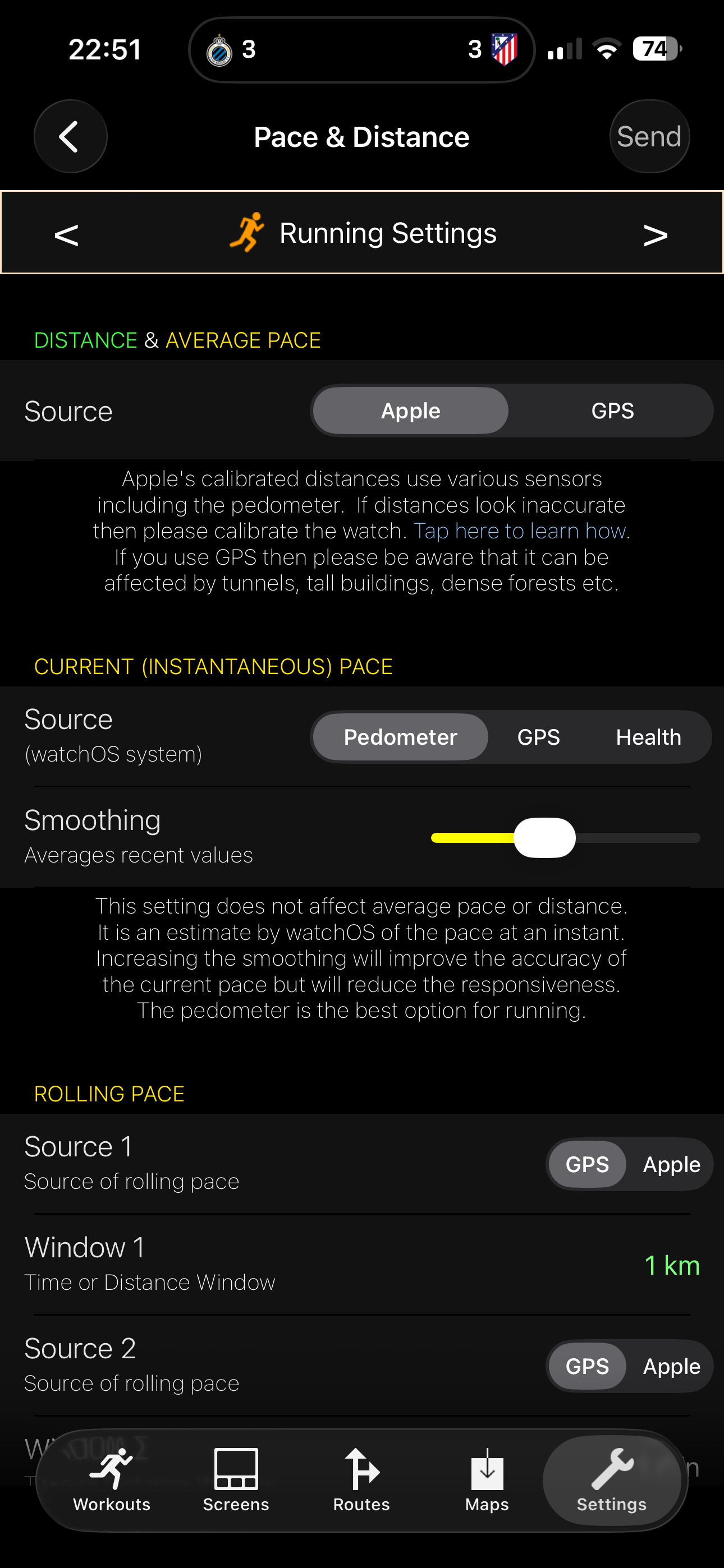

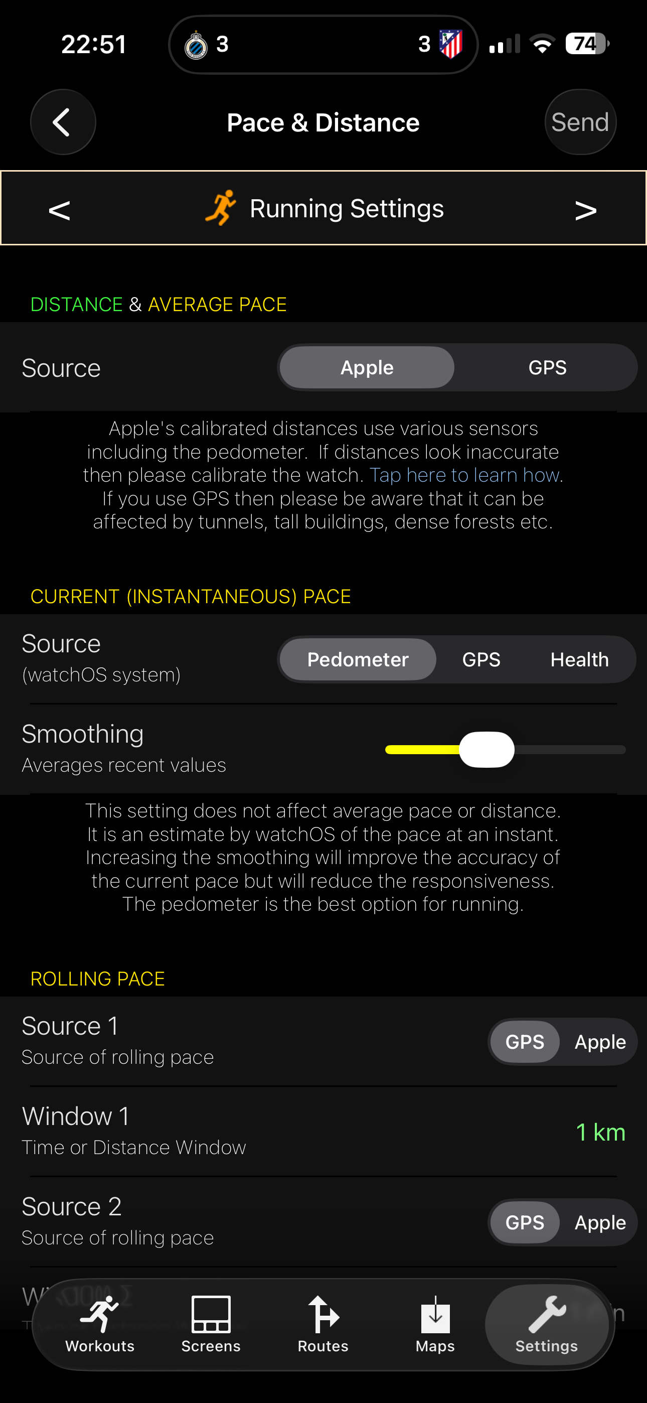

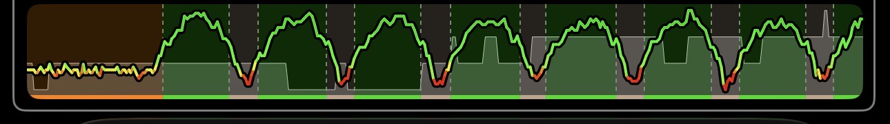

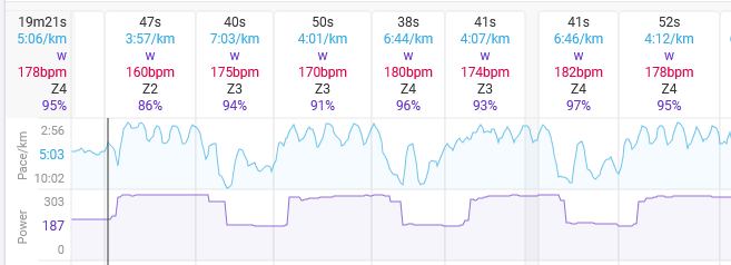

Here is my setup:
The smoothing only affects the current pace, whereas the graphs use the distance and time. There isn't a way to control the smoothing of the pace generated from those values.
Smoothing for pace graphs is subjective. The smaller the smoothing window then the more susceptible it is to rogue values, but the more responsive it is to changes in pace. So the window generally needs to be smaller when using alternating fast/slow intervals than for 'normal' workouts. WorkOutDoors uses a compromise but may try to do something more clever in the future if enough people request it.
However this doesn't affect how it looks in other systems. How are you exporting to intervals.icu? Generally a FIT file from the app is best. If you go via Apple's Health system then the distances only update when Apple sends them to the app, which is every few seconds rather than every second. So the distance could stay the same for a couple of seconds and then suddenly jump. intervals.icu may not be smoothing that out like WorkOutDoors does.
If you export a FIT file from WorkOutDoors then it interpolates the distances between the updates from Apple, so it doesn't show the same distance from one second to the next and then jump suddenly.
Another option is to switch WorkOutDoors to use GPS for distance, because the GPS system updates every second. This won't make a difference in the current version of the app because Apple's workout system will still store its own distances every few seconds. However the next version of the app will overwrite Apple's distances with the GPS distances and therefore will be smoother for apps that read the data from the Health system.
If you would like to try the beta for the next version with the change then please contact me at info@workoutdoors.net
I hope that helps. Apologies for the excessive detail!
