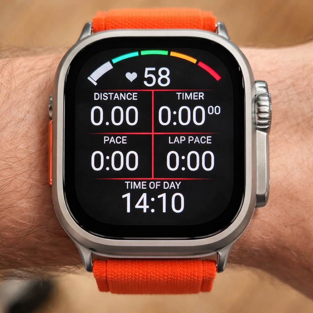

Just revisiting the topic, especially as my Fenix 8 died, (Garmin offered like for like replacement, but many are having the same issue, so I declined and got a complete refund).
You mention that Apple Watch doesn't have a circular display, but then when scrolling through many of its watch faces, I note a lot offer a circular face, within the square/rectangular display.
So I have created a mockup, to demonstrate how good it would look.

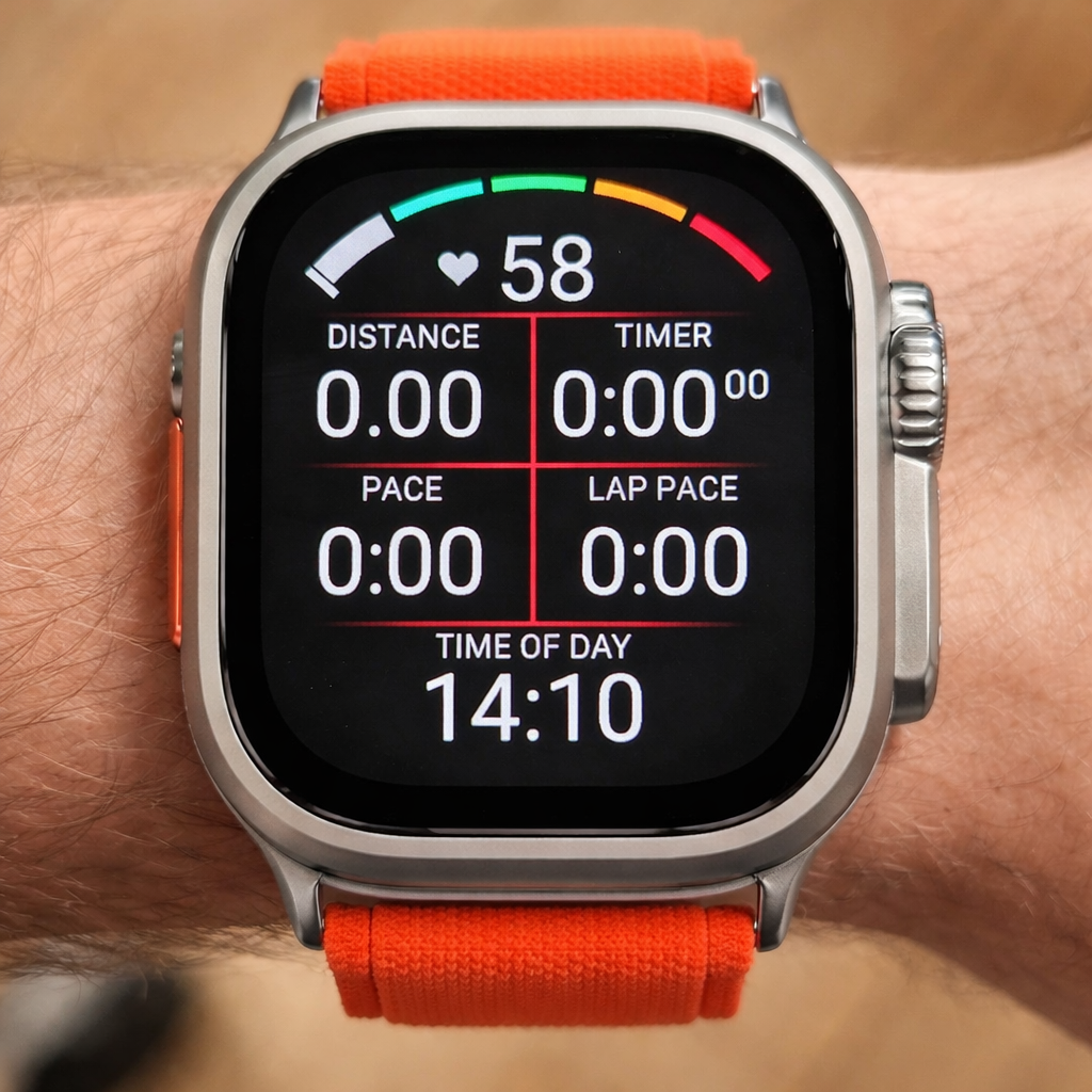

That does look nice but I don't have any plans to change the layouts in the near future. Sorry about that. Maybe when I add mirroring to the iPhone and need to add extra layouts for that.
However your use of red lines to separate the metrics has got me thinking about an option that does that but in the colour of the current heart zone colour (or a toned down version of the zone colour). That would be very easy to implement and a nice way to show the zone without using any extra space.
As you state, it looks nice, and would be a driver for increased downloads and purchases for your app. As many Garmin/Coros/Polar/Suunto users look for alternatives, having an app, that looks good is vital. With Runna/Strava looking at this area too, to tie up their integration with both platforms, and a cleaner, customisable app, that permits workouts to be fed in, and screens similar to mine, the playing field is about to get crowded.

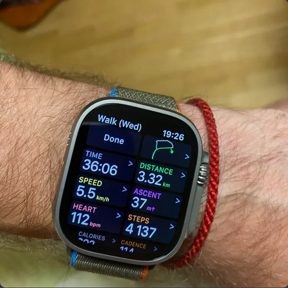

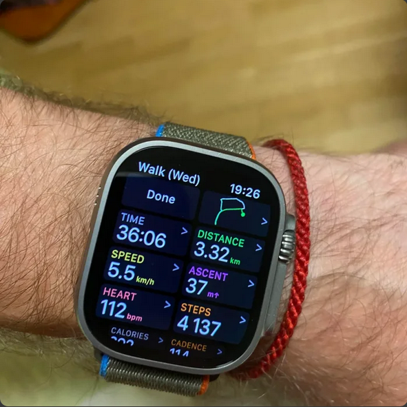

You can get exactly the same data with the current version of WOD? Are you just wanting a 2 field, 2 field, 1 field layout? See quick screenshot I hacked up on the app. Can you get the layout like that screenshot at all @cfc
It’s not the data I’m looking for, but it’s presentation.
All the data options are squared off, industrialised as it where.
The image I mocked up, shows how curves can soften the presentation, to make it look more like a watch, and less like ms-dos

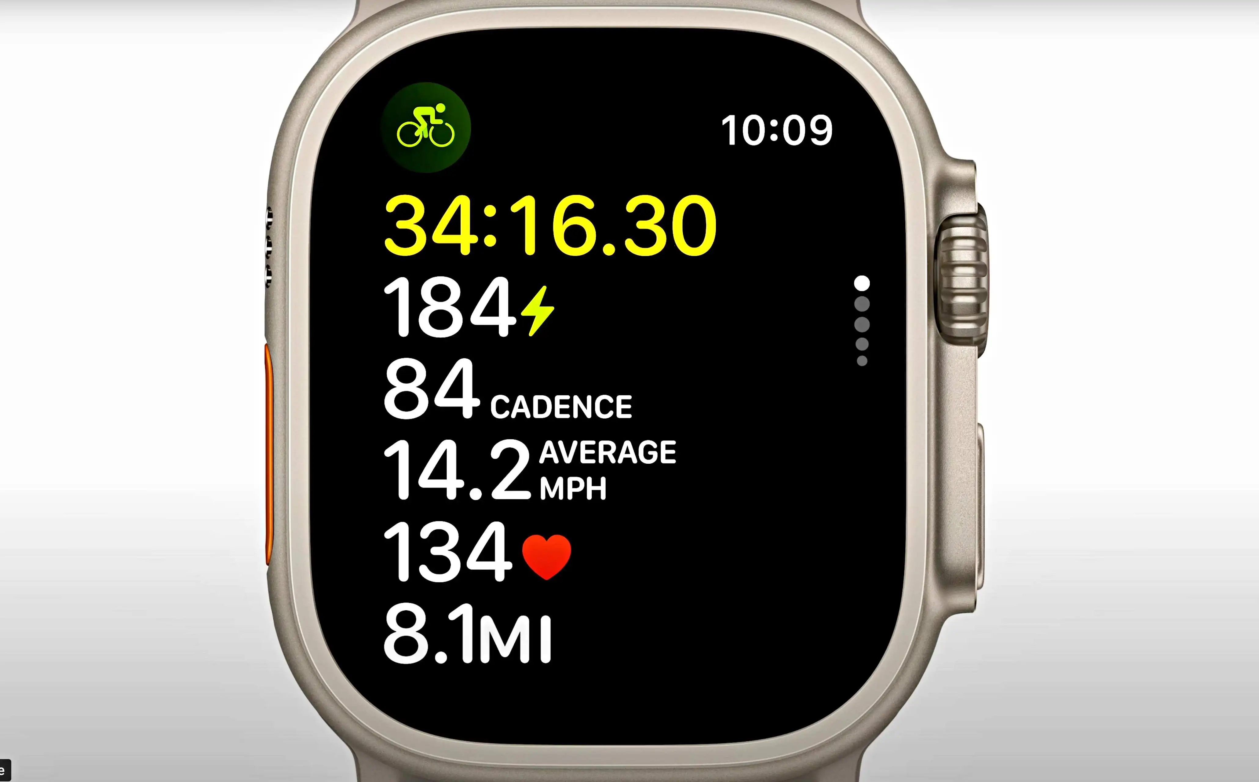

Perhaps that wasn't the best word to use. Readability perhaps. Any how, which would you choose to look down on, when running?
