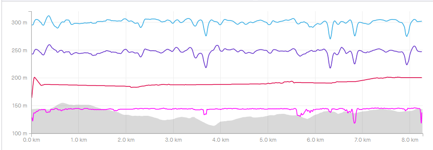

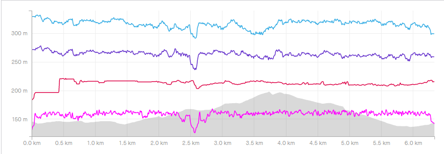

Are any other workoutdoor users uploading their runs to Strava? I'm seeing really spiky pace and cadence displayed in Strava and was wondering if it was just me or not?
This is from a run using WOD last night
This is a run from the apple app on Sunday

Apple app produces smoother results that look cleaner, WOD is more "raw".
But at the end, the average speed, distance ... is similar

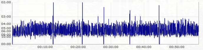

Just checked some runs on Strava and the charts there look all very smooth. As I am currently in the process of leaving Strava, I only use it as a secondary data store that is synced automatically from Garmin Connect which I am also in the process of leaving ;-).
My data source is always Apple Health and I supply runalyze and Garmin Connect with RunGap from there. So my theory that Apple Health is doing the smoothing is not valid.
This is my run from today in runalyze (the wild fluctuations are auto pauses):
https://runalyze.com/shared/7d8uj

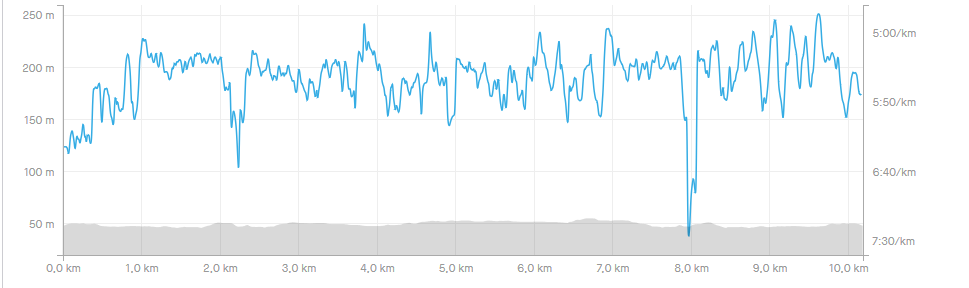

Checked back about 2-3 weeks and all pace graphs in Strava look smoother than in runalyze.
But guess your setup is doing something differently than my overly complex environment: WOD->Apple Health->RunGap->Garmin Connect->Strava.
Never synced directly from WOD as Strava is as mentioned only a secondary or tertiary data sink for me, will be left by year end and RunGap is my central distribution tool as I am recording workouts from other sports with a variety of apps and devices besides WOD.
Do not think this is your watch.
[automerge]1575034393[/automerge]
An example how Strava smoothes...
Seems I did not check the pace graph from this particular run from iSmoothRun in runalyze:
But as this is the WOD and not iSmoothRun, I stop now.
Forgot: cadence graphs from my AW are independent from which app I produce them are awful. Typically they alter between two values or stay at one value for minutes. No idea what the AW is producing there. But I do not care too much about this metric.
Edit 2: fiddled with runalyze settings on training view (there are plenty) and with the correct settings it can also smooth out the terrible iSmoothRun pace chart.
