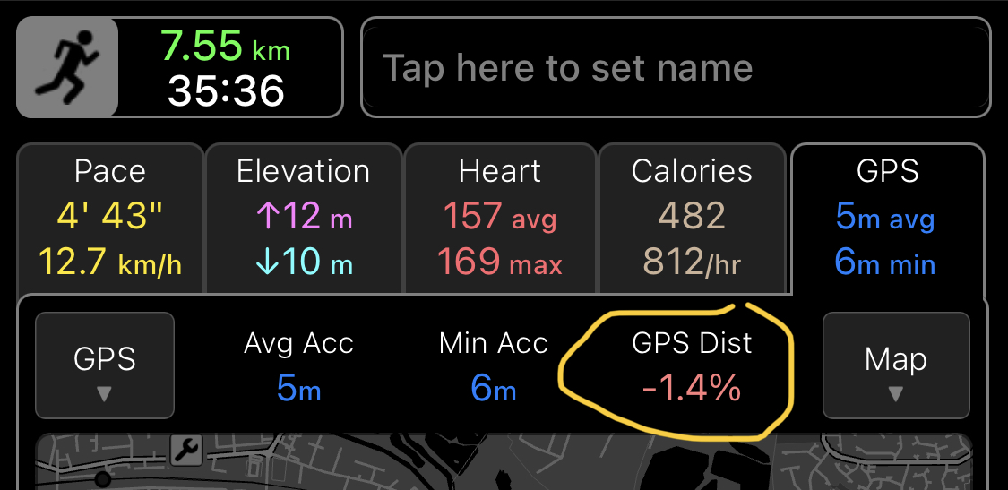

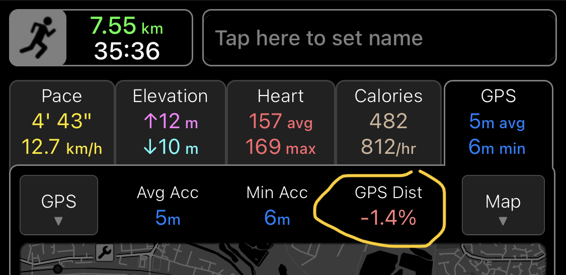

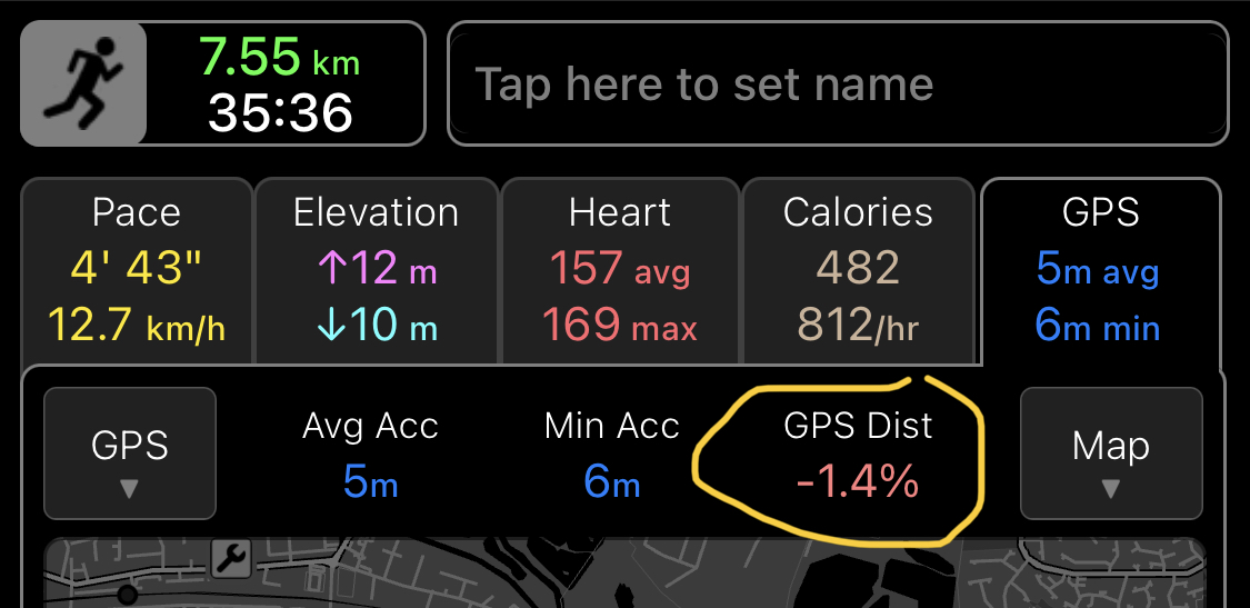

Another quick question, what does means the GPS Dist in this workout pageView attachment 959868
The app measures the distance in two ways. By default it uses Apple’s distance estimates, which use the calibrated pedometer. But it also calculates the distance purely from the GPS positions. This metric shows the difference between the two estimates.
If you find that the GPS distance looks more accurate then it is worth calibrating the watch as described here: https://support.apple.com/en-us/HT204516
If the calibrated distances really don’t work for you then you can switch to the GPS distances. To do that press the watch screen hard (or long touch for watchOS 7) and tap Settings then More, and then switch off the Use Calibrated Distances option.
