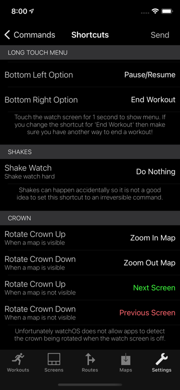

I have added four new shortcut gestures for rotating the crown up and down both with and without a map visible. This will be in the next version. I also added a couple of new commands for zooming in and out so the default is that the app will work as it does at the moment.
In this screenshot I have changed the commands for rotating the crown when no map is shown to change screens:
I have also added a new 'shake' gesture, to see how that works.

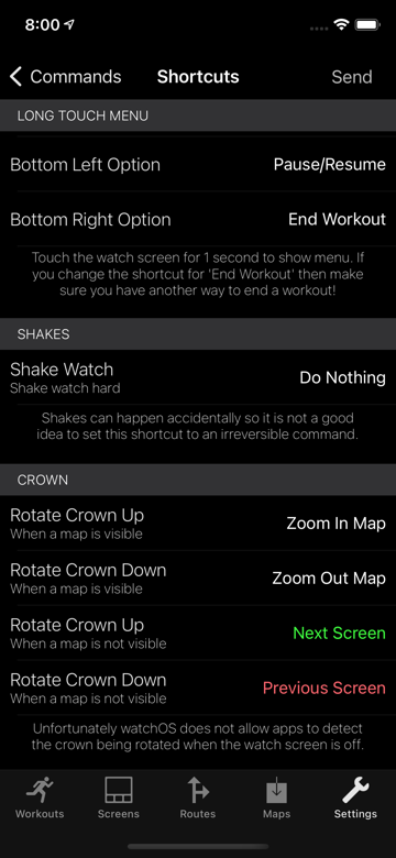

Ian, sorry to dig out this old thread.
How come I can't find the Crown & Shakes option when I in this screen? Has it been removed recently?
I'm currently on WOD 4.3.6, iOS 15.2 & WatchOS 8.3.
Thanks for this wonderful app and your superb support :)
That will be in the next version. That post was back in March, but the current version on the App Store was released in February. The next version will be a year's worth of full-time work on the app, and will include lots of little changes like that as well as the headline changes of topographic maps and bluetooth sensors (both of which took far longer than I expected).
