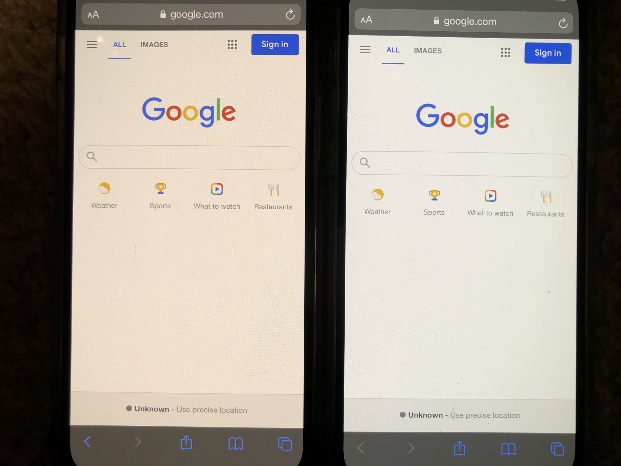

When I first got my iPhone 12 about 3 weeks ago, I immediately noticed it had a yellow tint, without having another phone next to it. I just chalked this up to me needing to get used to OLED (I previously had an XR) and tried to live with it. 3 weeks later, I’m still not completely used to it and I don’t know why I didn’t do this earlier, but today, I decided to compare it to my wife’s iPhone 12 (see attached picture, hers is a few weeks older than mine). Mine is the one on the left. Both phones have auto brightness off, True Tone off, night shift off, and the brightness at 100%. Oh, and no color filters. In person, the yellow tint is even more apparent. Once you turn on True Tone and night shift, the difference is even more stark. Needless to say, it still bugs me a lot, even more now that I’ve seen it next to my wife’s phone.
I know this post is probably very redundant in this thread, but sifting though 242 pages of posts to find an answer got a bit tedious. Seeing how I’m out of the 14 day return window, should I still try to exchange it? Would it help if I bring my wife’s phone with me into an Apple store?

If that’s with True Tone and night shift both turned off, I’d be returning it ASAP, that’s way to yellow for my liking.
Shouldn’t be that yellow, reckon you got a faulty display.
Yeah, I was pretty shocked when I finally compared the phones side by side. I mean I already could tell it was yellow even when they weren’t side by side, I just didn’t realize it was that bad.
Anyway, I just found out all the Apple stores are still closed in my area so I don’t know if, how, or when I’ll be able to exchange it for another one. Any ideas?
Call apple, tell them your story, send them the photo, pretty sure they’ll tell you to send the phone back to them in the mail once you’ve received the replacement unit.
