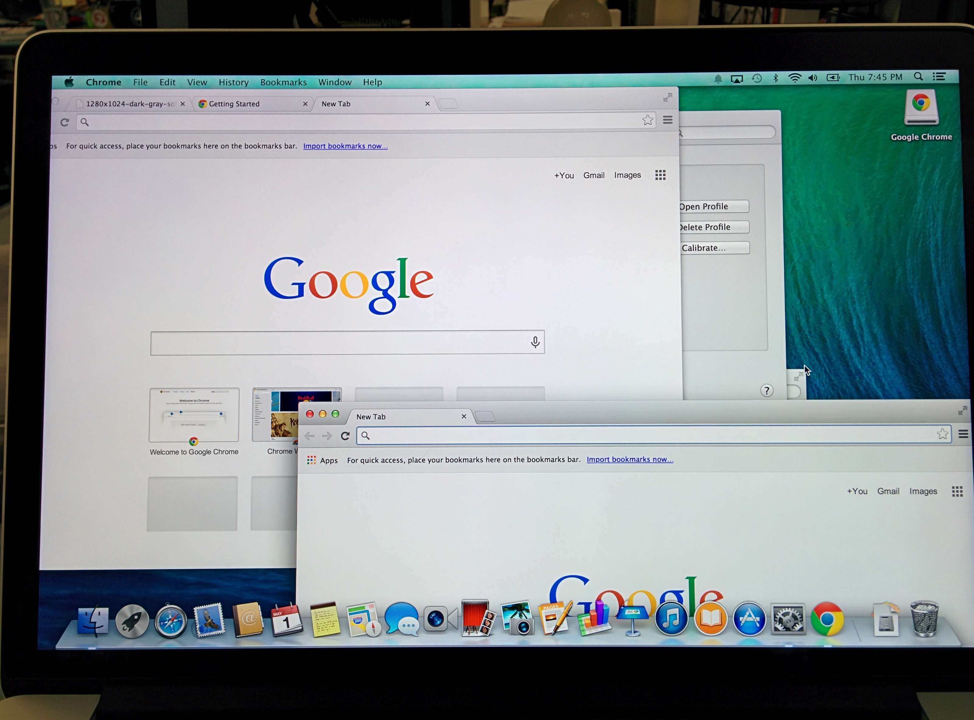

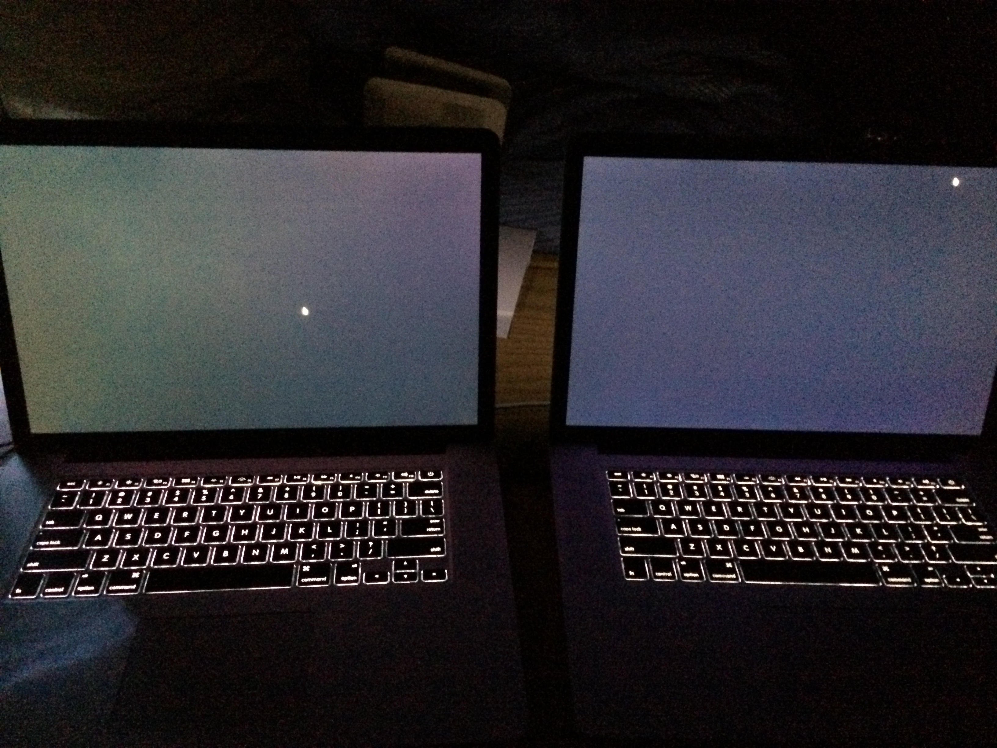

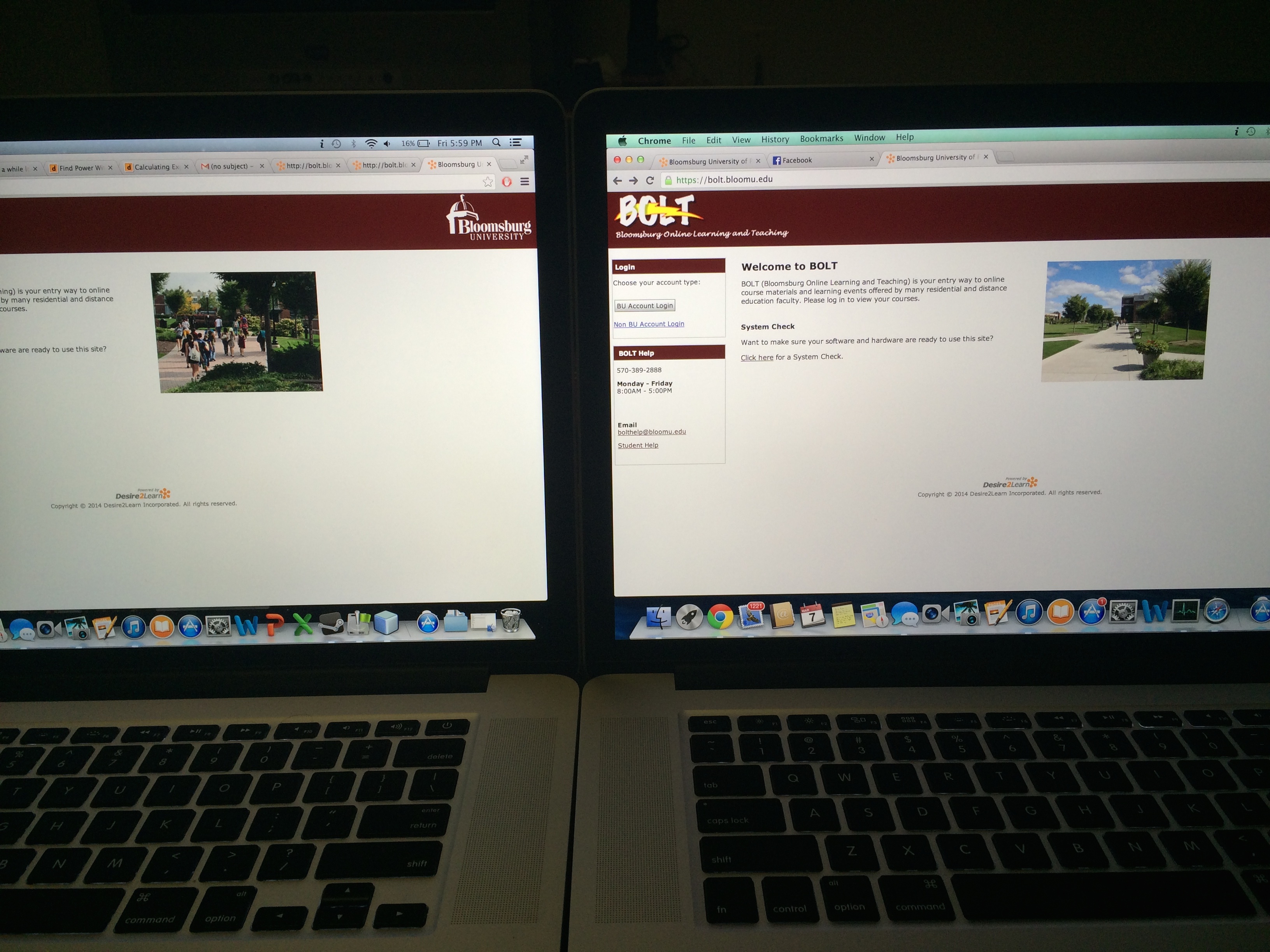

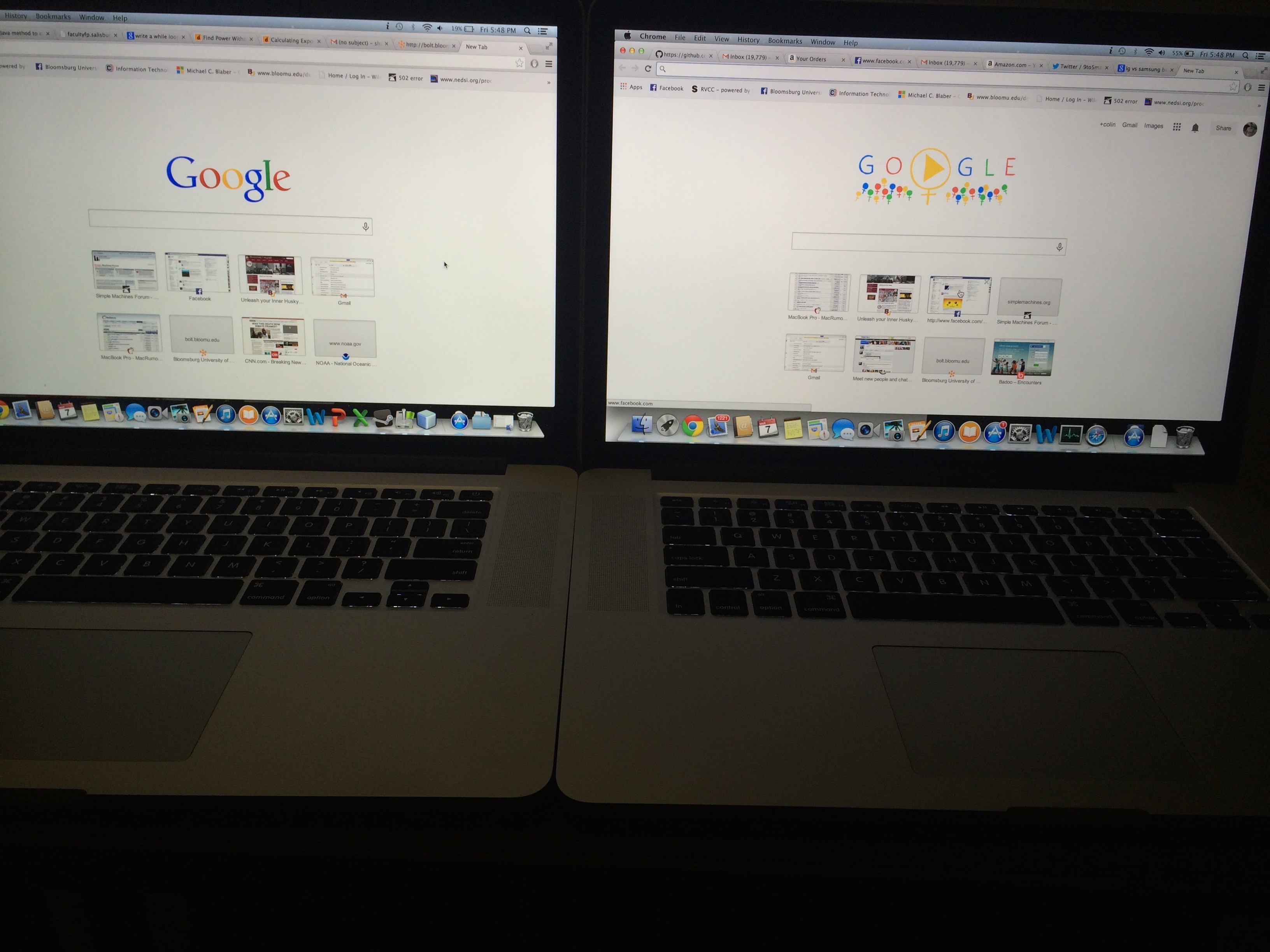

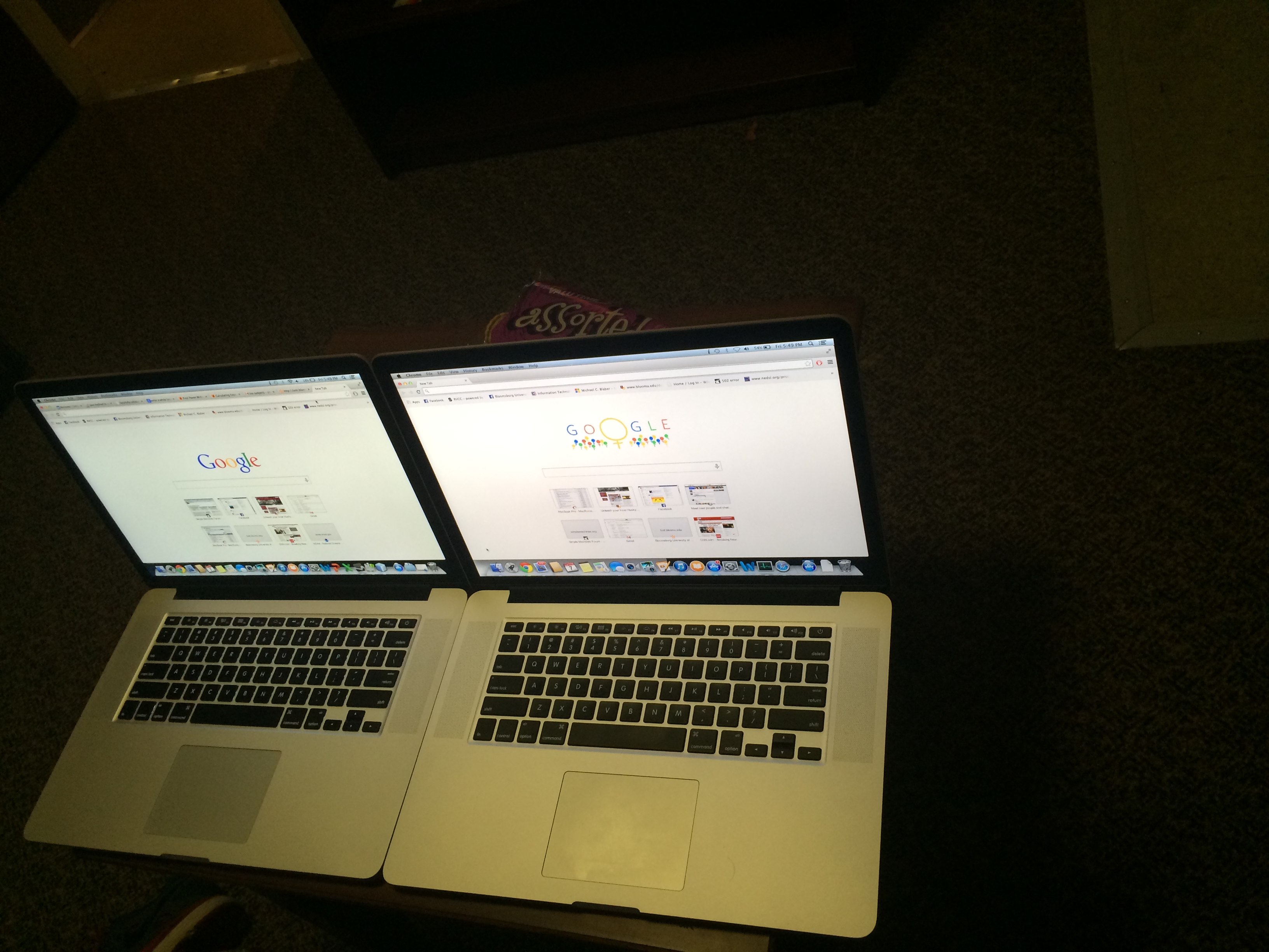

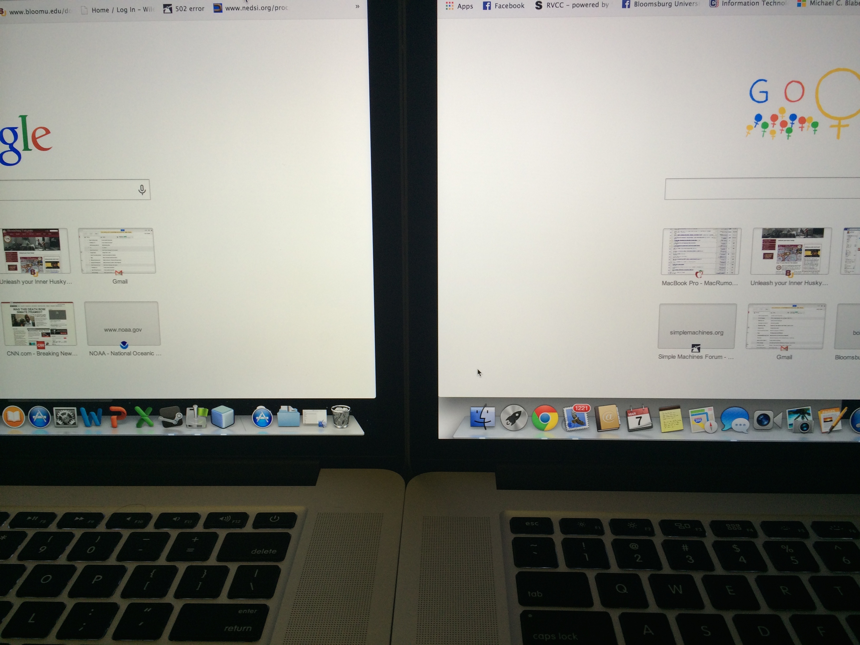

So for the sake of it I'll, post my observations with these screens...I went through 6 replacements and have experienced 6 different screens. Maybe it will add some insight somewhere.
<< LG on the left || Samsung on the right >>
ETA - for some reason it makes both screens look a bit duller than what they are, sorry that's my camera.
Your Samsung screen certainly appears more uniform than the LG, judging by the two last pictures.
I probably should of clarified, the white levels seem much more uniform on the LG. When it comes to a black background the Samsung does have an edge because there isn't the color tinting. It's not major in person, they both have a very slight backlight bleed but isn't too noticable in most situations.

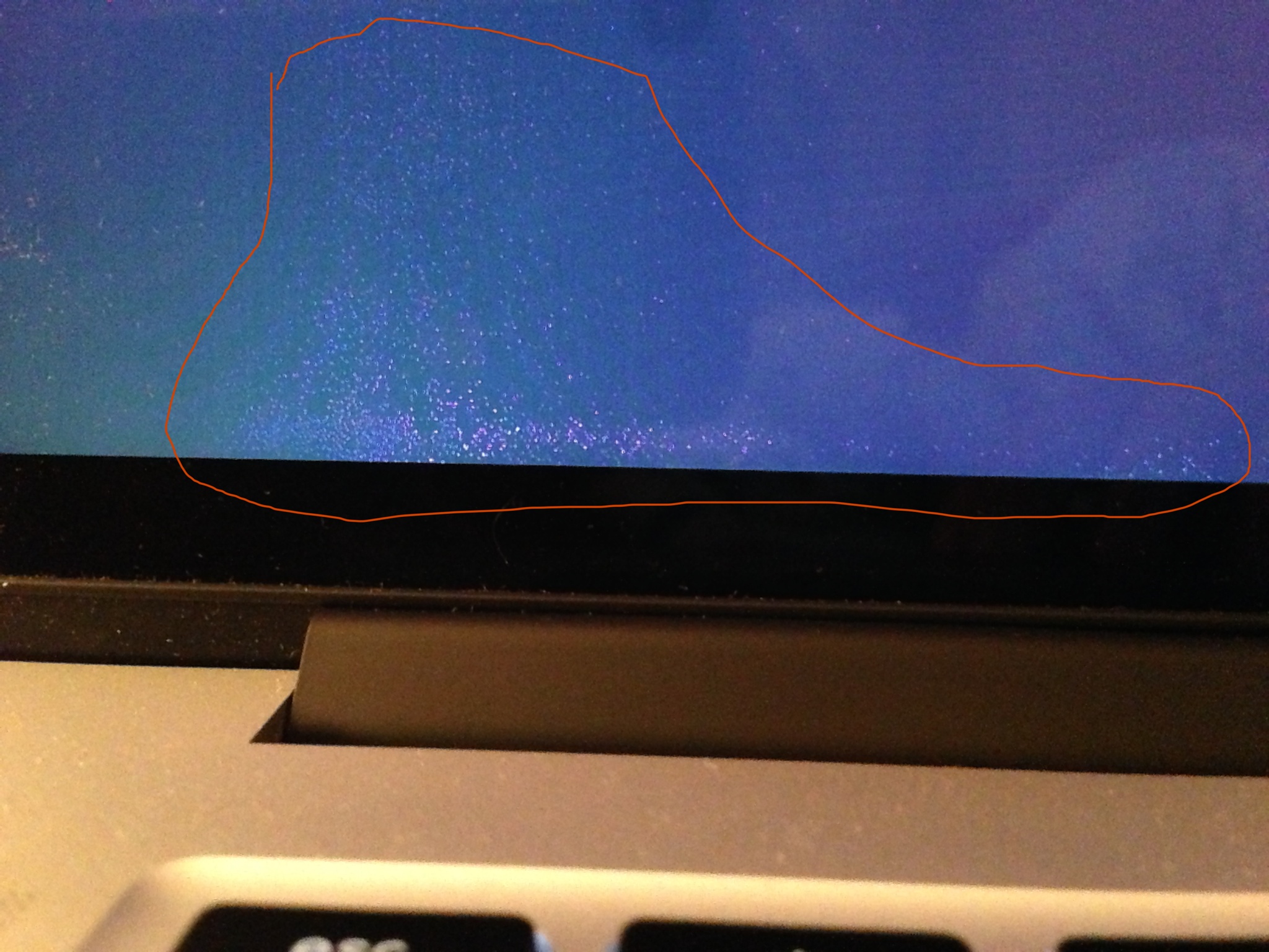

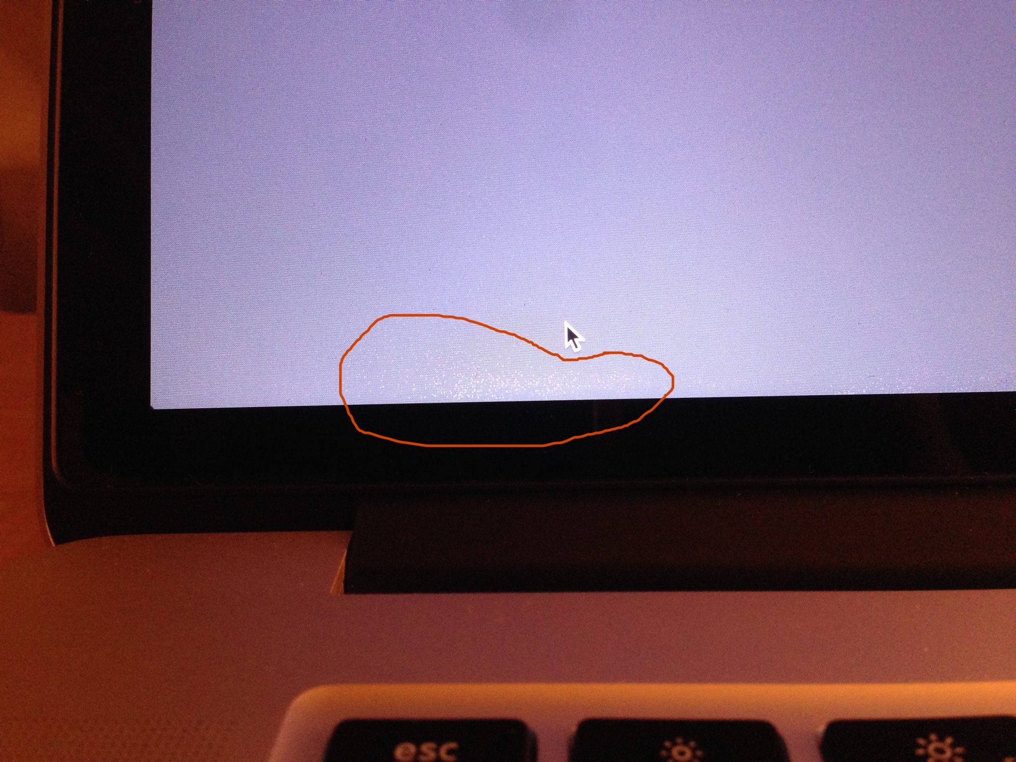

I have a new display problem with strange pixels. It's not stuck pixels; it's not muras; it's a bizarre pattern of pixels. I have attached two photographs below. Has anyone seen this before or can guess its cause? Here are some notes:
— They appear in the lower-left corner
— They are very difficult to see on full white or full black; they are best seen on a dark colour like dark brown or dark blue
— They are fixed relative to the physical display and don't move when I slide horizontally with Mission Control
— I've been using screen cleaning wipes and they started appearing after I started using the wipes; I will stop using the wipes to see if it goes away
— The display is on a 15" Retina MacBook Pro late 2013 Haswell LP154WT1-SJE1 A019 which has a medium degree of overall yellow tint with a yellow blotch in the lower left and a blue region in the lower middle and I run it at 7500 K
— I have not been in to the Genius Bar yet
— I've had this display since November 2013 and I've only noticed it in the past 2 weeks; I'm sure it wasn't there from the beginning
— They don't go away after a reboot
— It's not something physical on the screen; I've tried wiping it off
— I haven't been abusive to the display or hit or damaged it

Definitely take that to apple, its not normal. I do find it odd that they just all randomly appeared at once though

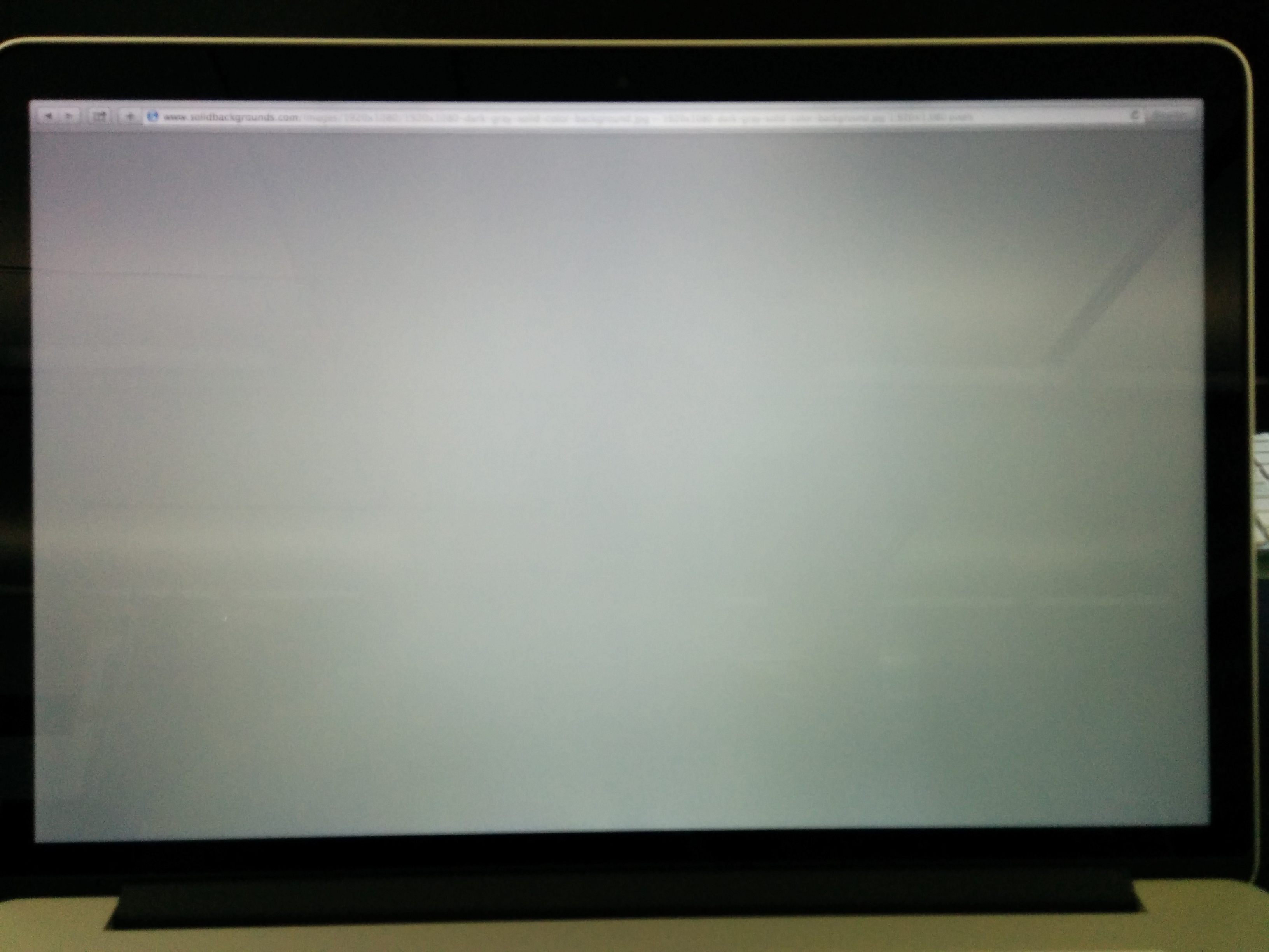

I've had three 15" Retinas and a couple 13" Retinas. All three of the 15" are a bit uneven as far a backlighting goes, compared to the 13", probably because there's more room to be uneven. Duh.
I also have been noticing uneven backlighting on a lot of Samsung desktop monitors, some worse than others.
It's a curiosity. If it doesn't interfere with Video, Graphics, entertainment usage, than I don't see what the problem would be (unless i'm overly sensitive)
I wouldn't return anything unless I would be totally comfortable knowing that the tech person at an Apple store would agree with me completely (assuming they are reasonable). All three of the 15" don't fall into this category. However, some of those Samsung desktop monitors are real dogs, which is surprising maybe :D
Samsung (had 1 screen)
- White's aren't as white as white as LG (but still really white :p)
- The fonts seem a bit smoother, I haven't heard anyone compare this yet but if I look closely the fonts on my Samsung definitely have an edge
- More vibrant(?)
- Pretty uniform backlight bleed +- small areas
- Bottom right seemed to look a bit dirty/yellow
- In comparison to the LG it appears to have a yellow tint, but standalone you don't notice it
- SLIGHTLY brighter but just about on the same level as the LG screens
- Better viewing angles
LG Screens (had 5)
Surprisingly there was a big range in my LG screens. All of them were the same model too, LP154WT1-SJE1 but generally:
- Whites were whiter
- They have the magenta right hand corner when viewed at a certain angle. Some screens were worse than others
- Some screens had some bad backlight bleed, some didn't
- Contrast is slightly better and colors seem more accurate
Right now on my laptop that is practically flawless, the whites have been the whitest I've seen in any LG or Samsung display. I've attached some photos comparing the two. You can be the judge. :)
<<Samsung on the left || LG on the right >>
