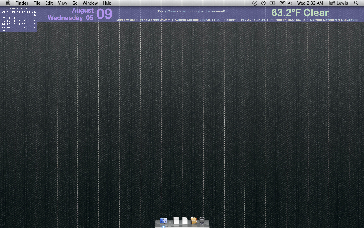

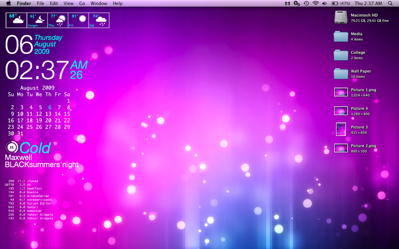

I'm very green to this.😱 This is after some tweaking....please don't be too mean. btw- Not sure if it was posted here yet but I found this Youtube video extremely helpful.
nice setup! can i get your horizontal calendar script. mine seem to all be messed up since it turned august.
cal | sed -e '1d' -e '2p;2p;2p;2p;2p' | sed -e '$!N;s/\n/ /' -e '$!N;s/\n/ /' -e '$!N;s/\n/ /' -e '$!N;s/\n/ /' -e '$!N;s/\n/ /' | sed "s/^/ /;s/$/ /;s/ $(date +%e) / $(date +%e | sed 's/././g') /"
There you go. Also at post 730.
