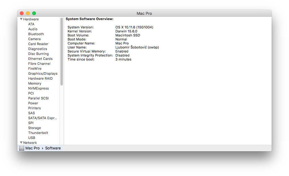

Does the new security update Apple released today break the install of El Capitan on my Mac Pro 1,1????
Hesitant to install the security update. Currently running 10.11.6
Ill let you know in a few minutes. It's just a question will i write next message from El Cap or Lion, hahaha!
Update:
Everything went OK, fast and painless.

Now for the big question.....
Worked.. I waited 12-15 minutes with a black screen.. (Nvidia GTX 620) It did break my Nividia driver and switched to the OSX Nvidia driver . Nvidia usually puts out a new driver in less then 24 hours after an OSX update.. So I'll just wait..
On the aside.. The last few updates broke the Nividia driver and the OSX one did not work.. This time it worked..So I did not have to pull out the old Radeon X1900.
Sounds like good news then. The update should work on my machine as well :) So, I guess I'll give it a try after I get done with my current task. Hopefully my video will be unaffected since it's an 8800 that didn't require the web drivers.
Apple has a way sometimes of restoring roadblocks, so updates can be kind of concerning sometimes.
Great to hear that it worked for both of you. I'll be trying mine soon
Installed today's security update on my Mac Pro 1,1, and it went smoothly. Still working :)
Thank you for your input. Didn't want to be the first one to blow up my install... lol..
