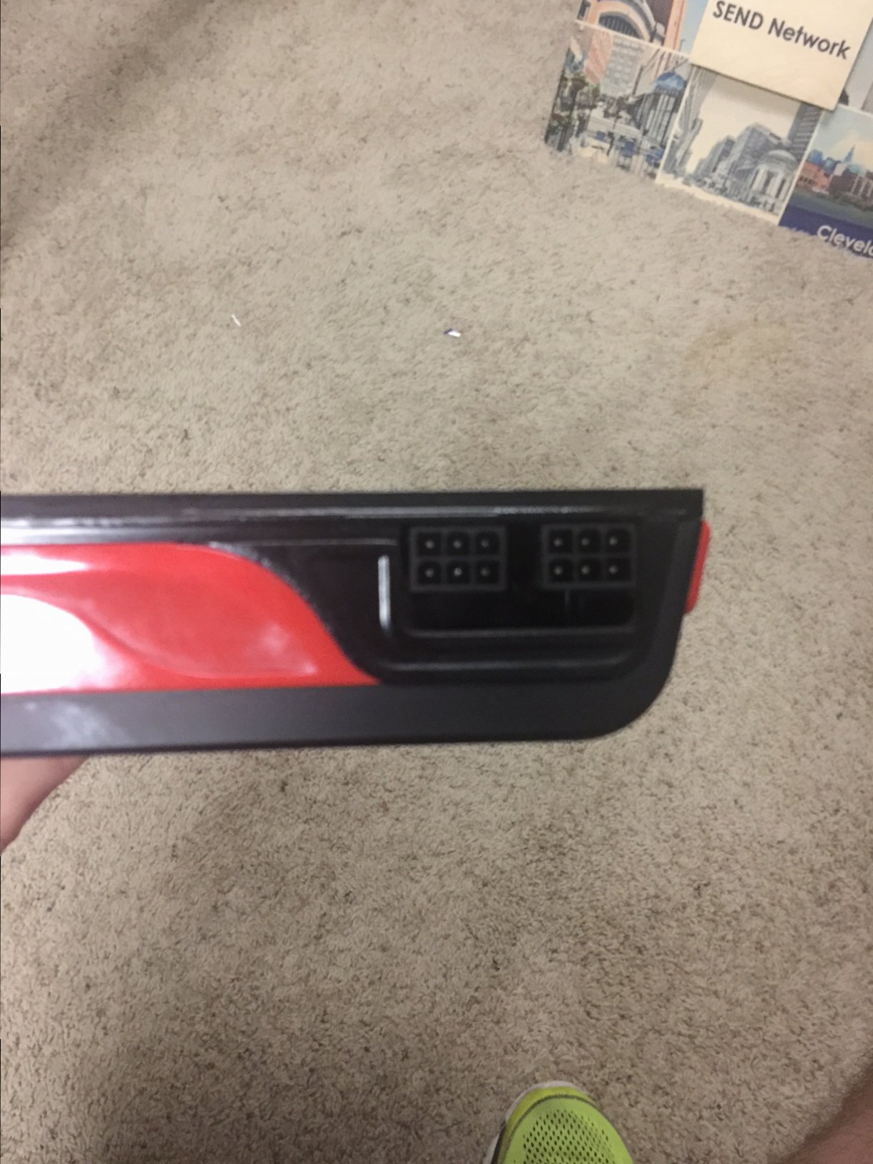

When I install the HD 5870 there is a loud continuous beep and the screen stays black - any ideas on that one? Thanks.
Sounds more like a RAM issue to me but I could be wrong. Usually beeping sounds from any Mac refers to faulty/disconnected RAM. Also, is there power running to your GPU?

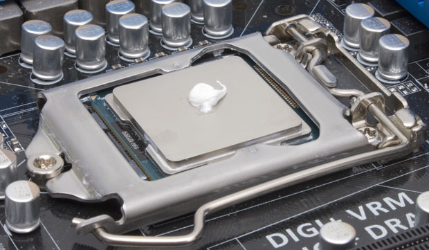

[doublepost=1471898939][/doublepost]So far my Mac Pro is running well. I have been using the 'Macs Fan Control' application to keep an eye on my CPU temperatures and there seems to be a 10C offset between the two CPU's every single time. At idle I'm getting 41C (CPU1) and 51C (CPU2). Are these figures normal? I'm not sure if it has something to do with how I applied the thermal paste to the CPU's. When I installed them. I cleaned off the existing thermal paste from the heatsinks and CPU's, and I put a pea sized dab of thermal paste on each CPU before placing the heatsink (I was told this was the best method). Does that all seem normal? I've attached an image showing an example of how I applied thermal paste to the two X5365's.
The temp difference probably is the one cpu's heat flows across the other before being exhausted by the fan.

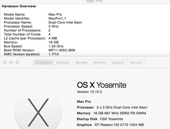

I always wait a long time before doing one of these upgrades, in the believe that I will have an easier time by learning from the hard work of others. That approach work great will all previous OS X upgrades, but not with El Capitan. I created the pikify drive successfully, but it crashes before the installation begins. I then used a new iMac to create a 10.11 external HD. Tested it in the iMac, change the boot.fi files and tried to boot my MacPro. No success, it crashed will booting. As you can see in the attached picture, my mac pro is 1,1 version with and Apple brand 5770 graphics card. Yosemite runs great, but i still have hope that 10.11 can be installed. I want to thank all of you that have worked hard at keeping our systems current all these years (especially pike-alpha).
When using the pikify method, are you booting from the pikify drive? Does it boot, then enter the Installer?
Do you start the installation?
Referring to the video I attached at post 1390, where in the sequence do you experience the crash?
