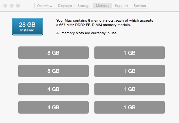

on a slightly different theme.
I intend to upgrade ram with x2 8G or x4 8G DIMM's..
how would I install another x2 8G if my current configuration is the following in the attached pic?

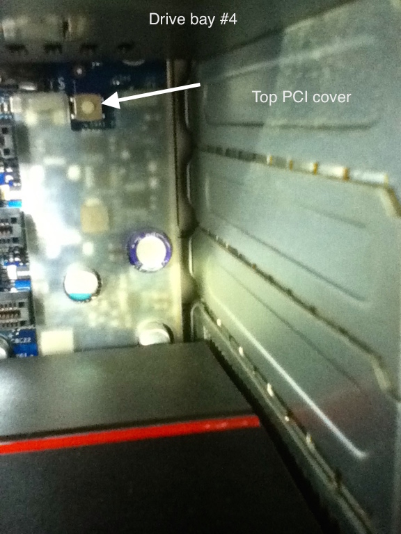

If that doesn't help, try an SMC reset. Turn the machine off
Remove the power lead (absolutely no power)
Open the side panel
Look below disk bay 4 near the rear of the logic board (between the disk bay and the top of the memory cage), there's a small push switch (@jbarley posted a picture a few posts further on)
Hold the push switch in
Count slowly to 10
Release
Reassemble
Boot

hello all. can you please upload a pic of this location. I cannot see such a thing on my 1.1.
i have tried the sms reset without the push button and do not know if it has worked.
