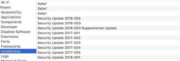

Something strange happened here.
My Mac Pro 1,1 had enabled auto update so I got the 2018-001 security installed and got screwed in the loop boot.
Luckily, I still have my 2007 Macbook Pro running, so I connected the MP in Target Disk mode do the MBP. From there I started the new El Capitan installation on the MP SSD drive without erasing the drive. The installation took almost an hour and when rebooted, before I was aware, the 2018-001 was once again downloaded (because of the auto update settings I had on the MP) and was asking for the reboot to apply the changes.
My first thought was, oh no, I need to reinstall El Capitan one more time...but before rebooting, I right clicked on the 2018-001 update and selected Hide This update and then rebooted. While still in the target disk mode, I replaced the Boot.efi files. I disconected the MBP and booted the Mac Pro alone and it worked.
The strange thing is, when I go to my Mac Pro's system installations, the 2018-001 update is there like it was installed.
It’s not strange, you did install it the first time. The App Store keeps track of that.

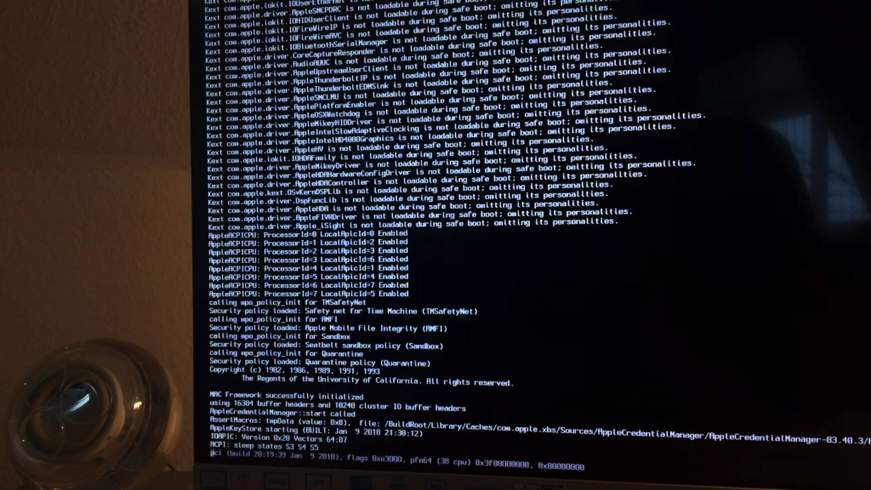

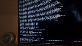

I am still keen on understanding why the kernel of the 2018-001 security update does not work. However there is no retrievable log-data anywhere to find (syslogd is obviously not loaded at the time of crash and the kernel ring buffer gets flushed on the following regular boot). Using verbose mode also does not give much further hints. :(
The last line I can spot on the screen-recording I did with my iPhone says "AppleIntelCPUPowerManagement Enable", but the process causing the reboot may be already the next in-line during the boot-sequence.
The Power Management capabilities of the Xeon 5355 are rather limited and there is no entry in X86PlatformPlugin for either of the early MacPro models. The entries in ACPI_SMC_PlatformPlugin are all dated from 2016, so no recent change there.
BTW: it does not matter if you install with pikify or through a compatible mac in target disk mode. Safe Boot does also fail at the same spot - without the latest kernel compiled with debug options activated, this seems to be the end or my options.
